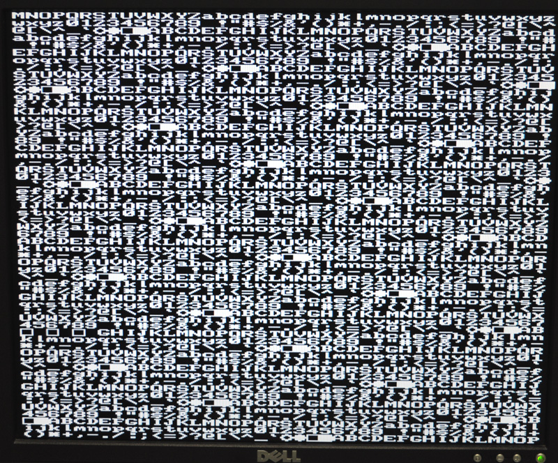

I probably don't explain things all that well!
By single pixel, I am referring to a vertical band created in the overscan era by the positive USART polarity.
Here is a nice looking screen of text that seems to have nothing wrong with it...
A crisp 40x60 Character Display coming from my 2 Chip Computer.
But due to the way the AVR ASART works, a positive pulse happens on the buffer being empty.
Most monitors simply regard this as a "glitch", and auto adjust the band off the screen.
One very high end monitor I tried actually included this as part of the image.
Here is the hidden band shown by tweaking the clock phase and H position on the monitor...
Oh look, a hidden line in the overscan area. You bad USART!.
I am just too picky to live with the hidden line. 1 out of 10 monitors would require adjusting.
Currently, I am looking into a few solutions, including stuffing the buffer during the blanking.
I also tried PWM from another pin to "kill" the video, but this left a tiny artifact. Not cool.
Either way, my 2 chip computer will display something by the time I am done!

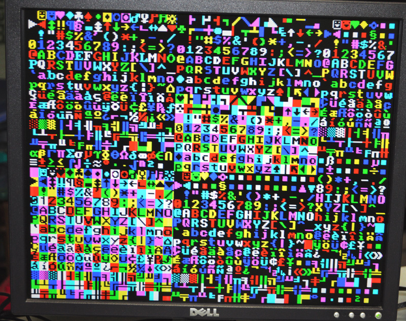

Ok, I made some compromise in order to balance simplicity with usability, and added one logic chip.
Now I have a 3 Chip Computer (65C02, AVR1284, and 74HC574).
I was just not happy having a hidden vertical line in the video stream, so I added a buffer / latch.
This also added the ability to have a 256 color text display.
Now the display has 40 x 30 characters with 256 colors available (1 color per character).
The background can also be set to any one of 256 colors.
Oh, and the entire screen can be bitmapped 320x240! This is the killer feature for sure.
It's not amazing, but graphics nonetheless!
The entire screen can be bitmapped as a 320 x 240 image, with color mapped as 40 x 30 squares.
It's not perfect, but not bad for a 3 Chip System. Not as good as a C64, but much better than a Vic20.
Currently, I only have 3 of the 8 color lines connected, so it's only showing 8 colors.

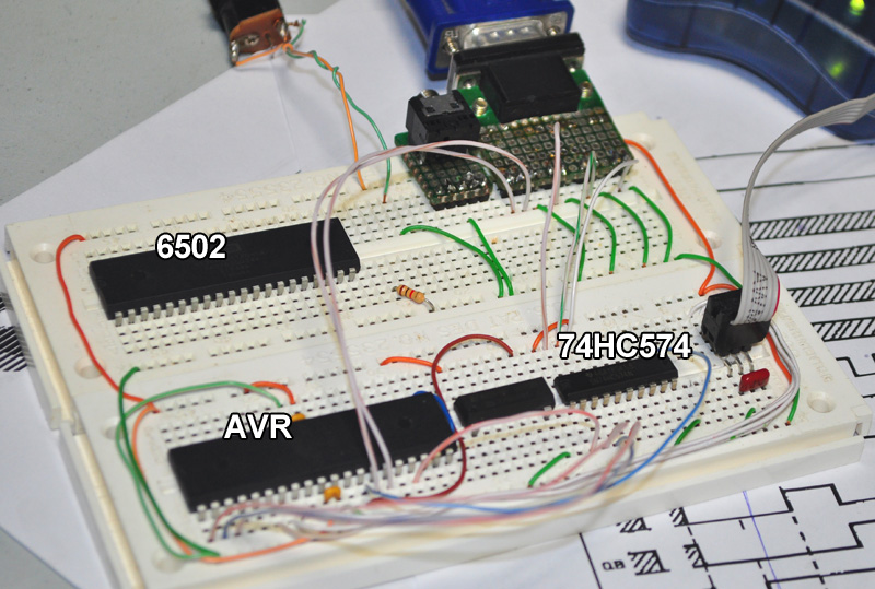

Here is the hardware now...
Now it's a 3 chip Computer. Still a low parts count.
Looks like the competition just opened up wide again!
Anyone out there with a DIP PIC32MZ? yeah... it could be done with just 2 Chips.
Ok, I will now wire up the 65C02 and convert my FPGA clocking code to work on the AVR.
If I can get even 2MHz out of the 6502, I will be happy indeed.

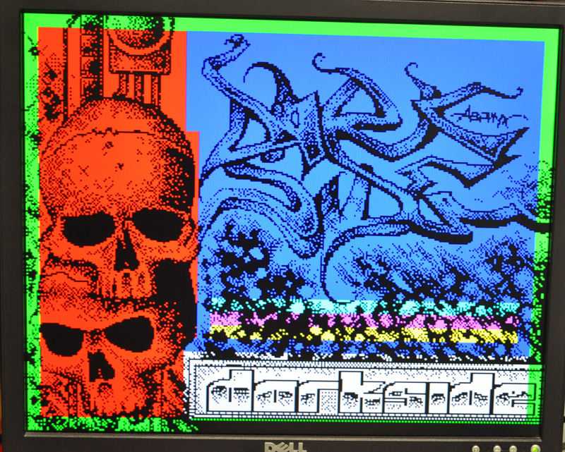

Here is an example of a bitmap screen...
A 320x240 Bitmap with "sort of" colorizing done.
Since there is no external RAM or ROM, the AVR memory is used like this...
// PIXEL MEMORY FROM 00000 TO 09599 = 9600 BYTES
#define PIXELMEM RAMSTART
// COLOR MEMORY FROM 09600 TO 10799 = 1200 BYTES
#define COLORMEM RAMSTART+9600
// 6502 ZERO PAGE MEMORY FROM 10800 TO 11055 = 256 BYTES
#define ZPAGE RAMSTART+10800
// 6502 STACK MEMORY FROM 11056 TO 11311 = 256 BYTES
#define STACK RAMSTART+11056
// 6502 SRAM MEMORY FROM 11312 TO 16383 = 5072 BYTES
#define SRAM RAMSTART+11312
// 6502 ROM MEMORY FROM 16384 TO 65535 = 49152 BYTES
So much like the way the C64 bitmap mode works, Pixels are one layer, and color is another.
Since color is only a 40x30 map, it's not exactly hi fidelity to color a bitmap!
Here is the image I stole for the bitmap...
http://www.demoscene.nl/pouet/cga1.png
I just randomly tossed some color to it. It certainly could look a lot better if made from scratch.
So that leaves the 6502 with 5K of RAM, and almost 50K for ROM.
This will work ok, as most Games / Demos are mainly stuffed with graphics and music.
Consider the 5K to be variables, and there is still the Stack and Zero Page available.
Ok, next step will be to get the 65C02 talking to the AVR, running code from the AVR Flash.

Every last one! 32 IO lines used here.
I even have to tristate the 6502 to drive out the color data.
Here is the IO utilization of the ATMega1284 I am using...
// SETUP PORT A
sbi DDRA,0; 6502 ADDRESS BIT 00
sbi DDRA,1; 6502 ADDRESS BIT 01
sbi DDRA,2; 6502 ADDRESS BIT 02
sbi DDRA,3; 6502 ADDRESS BIT 03
sbi DDRA,4; 6502 ADDRESS BIT 04
sbi DDRA,5; 6502 ADDRESS BIT 05
sbi DDRA,6; 6502 ADDRESS BIT 06
sbi DDRA,7; 6502 ADDRESS BIT 07
// SETUP PORT C
sbi DDRC,0; 6502 ADDRESS BIT 08
sbi DDRC,1; 6502 ADDRESS BIT 09
sbi DDRC,2; 6502 ADDRESS BIT 10
sbi DDRC,3; 6502 ADDRESS BIT 11
sbi DDRC,4; 6502 ADDRESS BIT 12
sbi DDRC,5; 6502 ADDRESS BIT 13
sbi DDRC,6; 6502 ADDRESS BIT 14
sbi DDRC,7; 6502 ADDRESS BIT 15
// SETUP PORT B
sbi DDRB,0; 6502 DATA BIT 0
sbi DDRB,1; 6502 DATA BIT 1
sbi DDRB,2; 6502 DATA BIT 2
sbi DDRB,3; 6502 DATA BIT 3
sbi DDRB,4; 6502 DATA BIT 4
sbi DDRB,5; 6502 DATA BIT 5
sbi DDRB,6; 6502 DATA BIT 6
sbi DDRB,7; 6502 DATA BIT 7
// SETUP PORT D
sbi DDRD,0; HORIZONTAL SYNC
sbi DDRD,1; VERTICAL SYNC
sbi DDRD,2; AUDIO OUTPUT
sbi DDRD,3; PIXEL DATA
sbi DDRD,4; 6502 RW
sbi DDRD,5; 6502 PH2
sbi DDRD,6; 6502 BE
sbi DDRD,7; REGISTER CLOCK
Since the 6502 just thinks that is is jacked into a 64K RAM, it requires 27 of the IO pins to control!
