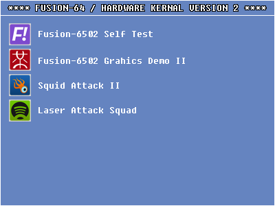

PostPosted: Wed Oct 12, 2016 6:23 pm
Posts: 693
Well, it's harvest time out on the ole Homestead, so my time in the basement lab has been very limited.
With snow on the way soon, I may soon get at least a day a week to work on Fusion-6502 again.
As of now, I did manage to get a basic Boot Menu up and running...
This is the Boot Menu, driven by the 6502. Joystick controlled.
This screen is generated fully by the 6502, based on code stuffed into program memory by the FPGA on startup.
Every program on the SPI Flash Memory has an Icon of 32x32 in size as well as a filename.
The user navigates up and down using the joystick to highlight an Icon. Pressing Fire loads that program.
Up to 512 Icons can be loaded from each Flash memory, and are navigated page by page using the joystick.
Icons are loaded and stored in the Working Memory as Sprites, read at whatever location the file table points to.
The basic 8x8 character set is also built into the FPGA, and the 6502 just asks to print text or characters.
The rest of the menu graphics are just basic lines and boxes, drawn by the GPU under 6502 control.
The text shadow effect is done by laying down 8 copies of black text shifted +/- 1 pixel under white text.
The first program "Self Test" is also built into the FPGA ROM, and always available.
Self Test shows a palette and some graphics to allow centering / tuning of the VGA screen.
Since LCD has a "fixed" resolution, and Fusion puts out 800x600 VGA, a small tweaking of "Phase" or "Pixel" clock can sometimes offer a more optimized image when displaying on a monitor that is not 1600 or 2400 pixels wide in its native resolution.
And the icons... yeah, I just stole them for now! Will make proper Icons when I have time.
At this point, I just "emulate" the flash memory using an FPGA block ROM, but it will work the same way when I get around to ordering an actual SPI Flash chip. I also have not decided on how the PC will talk to Fusion when it comes to loading the memory. At this point, I am thinking about dropping on an AVR 90USB to make Fusion-6502 show up to the PC as a mass storage device to my Loader program. It's either that, or I just use an FTDI USB <-> serial chip and let the FPGA handle the serial stream.
For now, I will keep fine tuning the Boot Menu, as this also tests the 6502 and GPU functions and my ability to write optimized 6502 assembly.
I also have a few more Graphics Commands and Sound Commands to fine tune or add as well.
Will post a video of the loader running soon.
Fusion-6502 is coming to life!
Radical Brad

PostPosted: Thu Oct 13, 2016 11:57 am
Posts: 693
Yes indeed, 9 pin C64 / Atari style joystick and connector!
These are easy to find, and easy to make.
I did up a tutorial on how to convert a SNES / Playstation joystick to 9 pin style as well.
To navigate the Boot Menu...
Up / Down : moves the highlight cursur to the previous or next icon.
Left / Right : scrolls t the next / previous page of icons if there are more.
Fire : load the highlighted program.
I will demonstrate this in a video when I have the chance.
Brad
