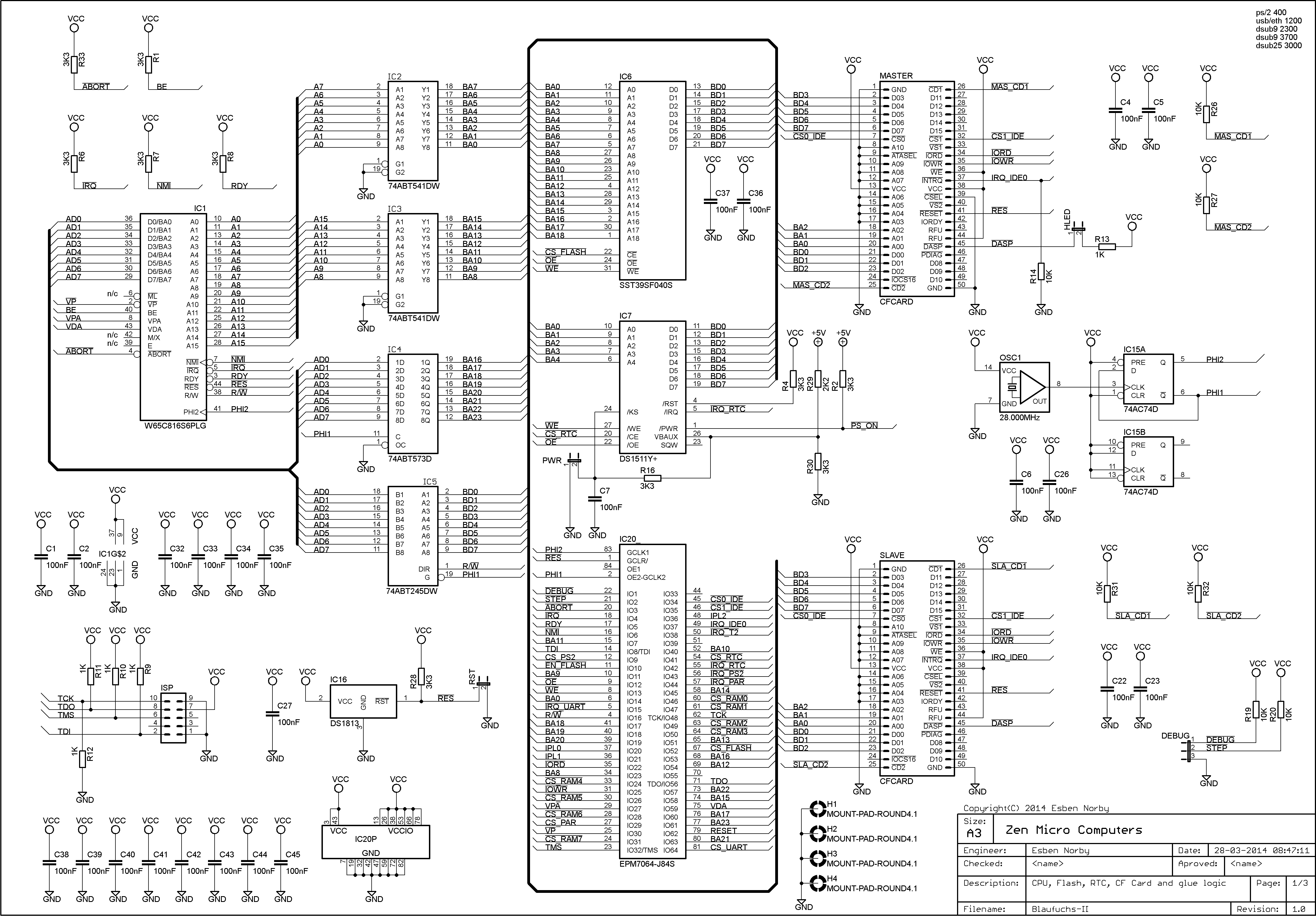

norby wrote:
Incidentally, I see some connections on the '245 and your '573 bank latch that don't seem to go anywhere.
Which ones? The /GOE and ALE signals? They are connected to the CPLD...
The G (output enable) input on the '245 should be driven by your /PHI2 (Ø1) clock signal, not by the CPLD. It's okay to enable the data bus during "dead" MPU cycles (that is, when VDA || VPA is false), assuming you are qualifying chip selects with VDA and VPA. With G driven by Ø1 and DIR driven by RWB, the '245 will "follow" the MPU with a worst-case lag of 3-4 ns.
The C (latch enable) input on the '573 should also be driven by Ø1. You want the lag between the rise of Ø2 and the closing of the latch to be as small as possible to avoid any glitches on BA16-23. As it stands now, you've got the prop time of the CPLD being added to the (very small) time required for the '573 to respond to a state change at C. The result is that Ø2 will be high for as much as 10ns before the latch closes, opening the door to the possible corruption of the bank bits. The only thing the CPLD needs to do is determine which SRAM gets its chip select asserted. That should be qualified by VDA and VPA.
Speaking of the '573 brings up a question. You could synthesize its function in the CPLD and have the latter generate BA16-23. Did you not go that route due to a lack of resources/pins in the CPLD?
Please understand that I am not nit-picking your design. I'm only concerned that you have a functioning device when you go to build it.
First of all I renamed /PHI2 to PHI1 :-)
Looking at firgure 5-1 p46 in the 65c816 datasheet, I was trying to implement the PHI2 inverter inside my CPLD. After you showed the way with the '74, I can now clearly see that the only good way to do this is by using the PHI1 signal for this. I keep forgetting the propagation delay in all of this, but I see your point. The '74 will produce a perfect PHI2 and PHI1 signal in sync.
Actually that was part of one of my early designs, this is what they do in the WDC DEV board schematic. But as you mentioned it uses up a lot of pins on the CPLD.
I did not consider that for a moment, all your input is much appreciated. With all the help I get in this forum there is a chance it might actually work when built ;-)
Attached is the latest schematic (sheet 1).
Not sure how "perfect" it is but on my 275 MHz 'scope viewing the Q and /Q flop outputs on POC V1.1, the two signals appear to be dead even. So I guess from the perspective of the 65C816 and its friends, the Ø1 and Ø2 signals are perfect. :lol:
Looks like it's time to get 'er done. BTW, how did you come up with the Blaufuchs name for the project?

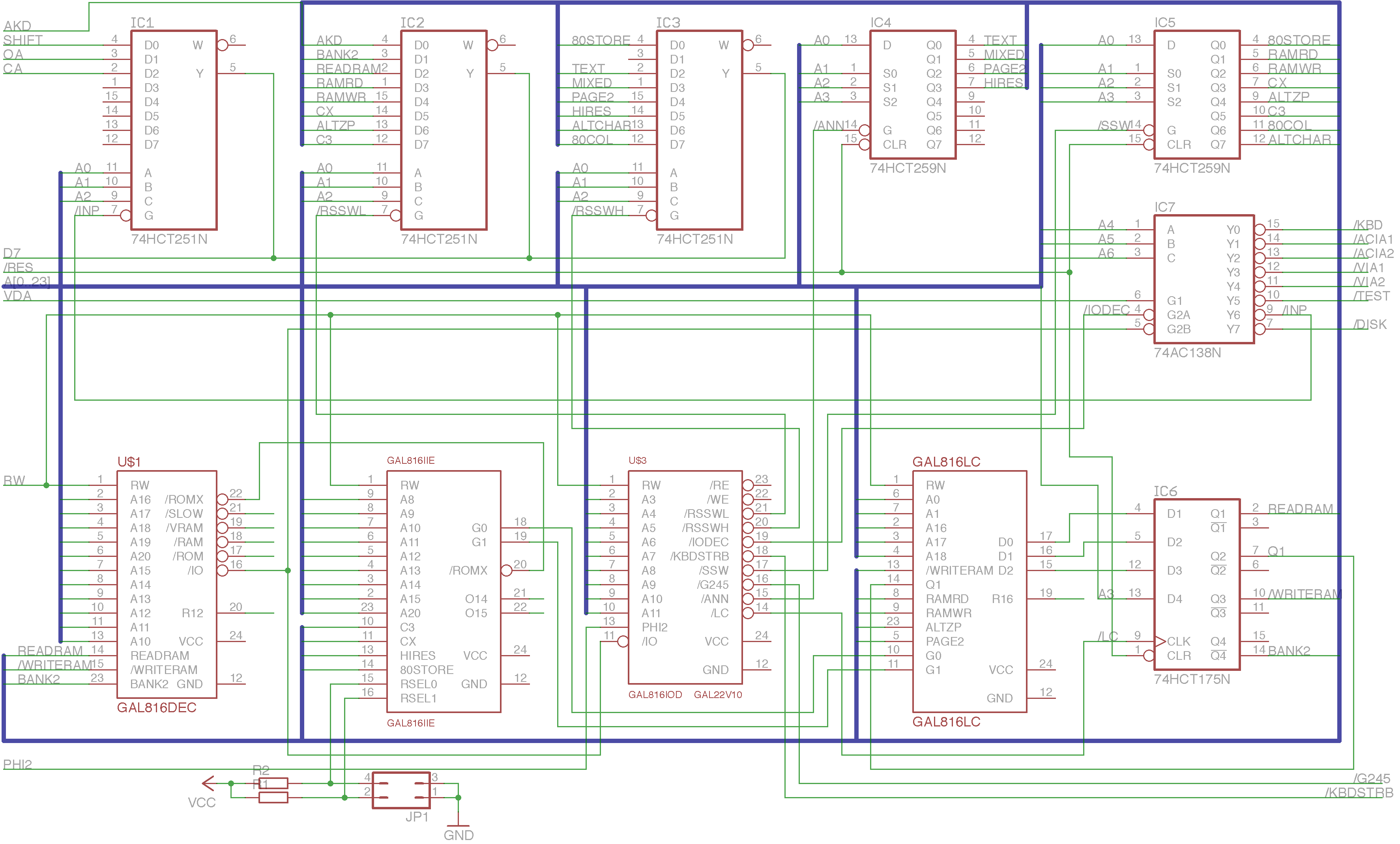

first let me elaborate on the last point. Here a drawing on which I base the explanation
File comment: Fake a DMA using one Bank
/REG-CF is the normal select signal to access the registers of the IDE Task File and is only asserted (low) when you normally access the registers in PIO mode. The /BANK-CF is asserted whenever you want to access the DATA Register. /BANK-CF is asserted for one entire bank, but due to the AND gates whatever address within the bank is accessed it always selects the Data register of the Task File. So you can use the MVN or MVP instructions to transfer the sector buffer to/from memory.
As for busses in Eagle I used them, but only for signals with suffixes, so I named the Bus like A[0..15]. But did not know you can specify a free list of signal names, separated with comma, and even mix and match both, signals with suffixes and individual names in one bus. That's really a cool feature. Then together with the labels it makes even a complex schematic neat and clean. Thanks for the hint.
I did not find the time to redraw all signals and busses using your trick. But nevertheless, so you don't have to wait too long, here the preliminary drawings of my design
First the core with the CPU, Memory, Keyboard, DP-RAM (Video), Clock and Reset circuit
File comment: SBBC Main Parts
As next follows decoder, the internal IO required to emulate the Apple II and other logic packed into GALs
File comment: SBBC Internal IO
And the last drawing contains the IO connected to the IO Extension slot
File comment: SBBC External IO (IO Expansion Bus)
The two SC2691 (UART) are not drawn yet, but are not required to get an idea of my design. I use GALs instead of a CPLD (I have not yet jumped into this cold water) and as it is at the moment they are used very inefficiently. You could achieve the same result with just 3 GALs. This is mainly because I built the SBBC step by step before I had the final design and made many design changes during the soldering sessions. However it does have all the features I wanted it to have from the beginning. These were PS/2 Keyboard, VGA Display and a mode that emulates an Apple IIe. E.g. I never wanted to decode the full 16Mbyte address space (I need only 512kbyte RAM). Even better, instead of a real 16-bit IDE I use the CF-Cards in 8-bit IDE mode which made the interface a piece of cake.
Regards
Peter
