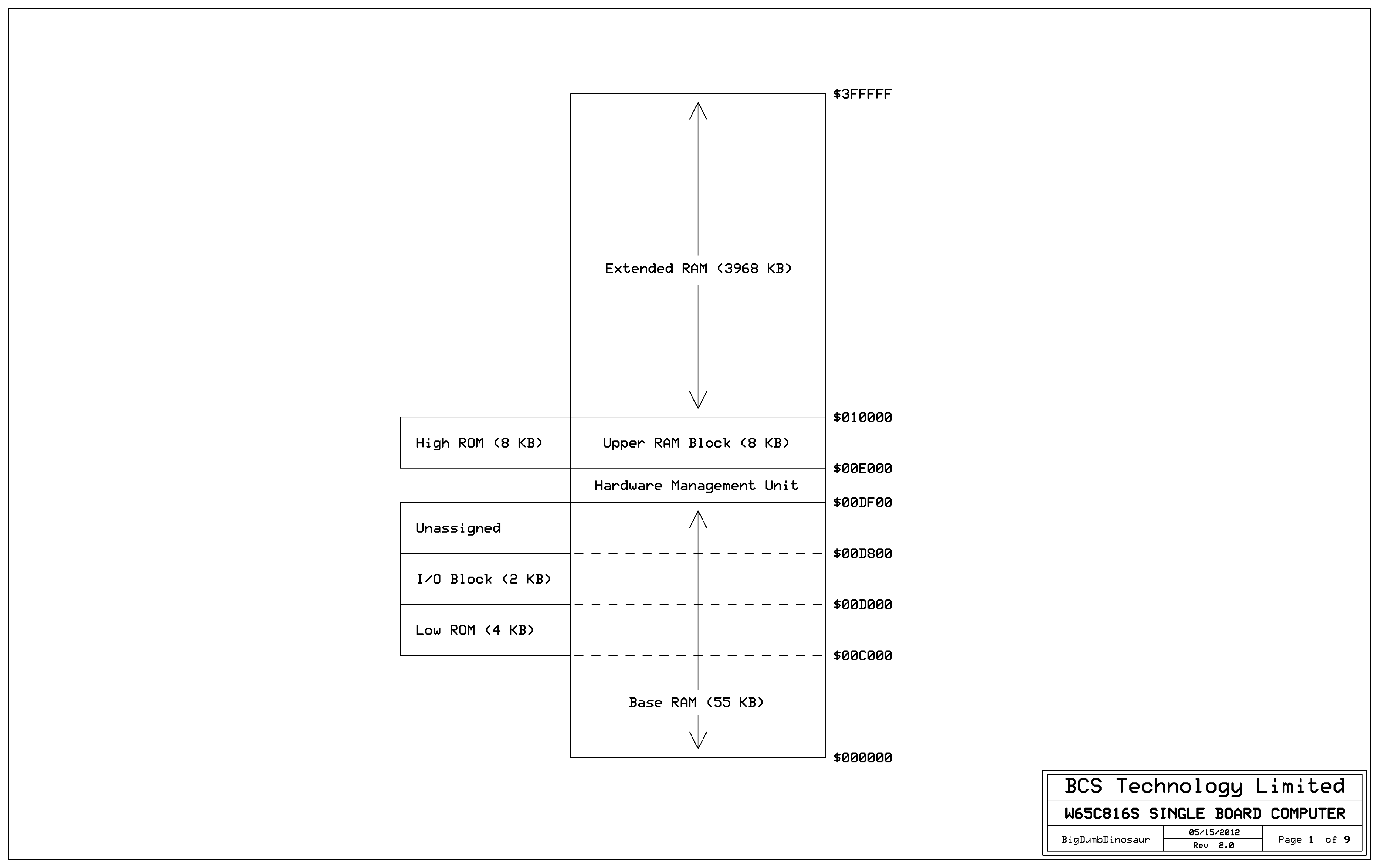

Here's what I'm working toward in POC V2.
The primary goal is to create a "protected mode" hardware environment, in which memory protection and bank $00 remapping rules would allow the execution of a preemptive multitasking kernel. There will also be a "real mode" environment, in which no restrictions whatsoever would exist on accesses to RAM, ROM and I/O. Real mode would be used by anyone wanting to run a real-time environment, like what Garth does with his workbench unit, where hardware access and interrupt response must be as quick as possible.
At power-on or following a hard reset, the default configuration will be real mode, in which no memory protection exists, and I/O and high ROM are mapped in. After an OS kernel has been loaded it will be able to change configuration from real to protected mode. As soon as that happens, the characteristics of the system will change and the following features will be enabled. All of this will be via some CPLD trickery, part of which I have already worked out and simulated.

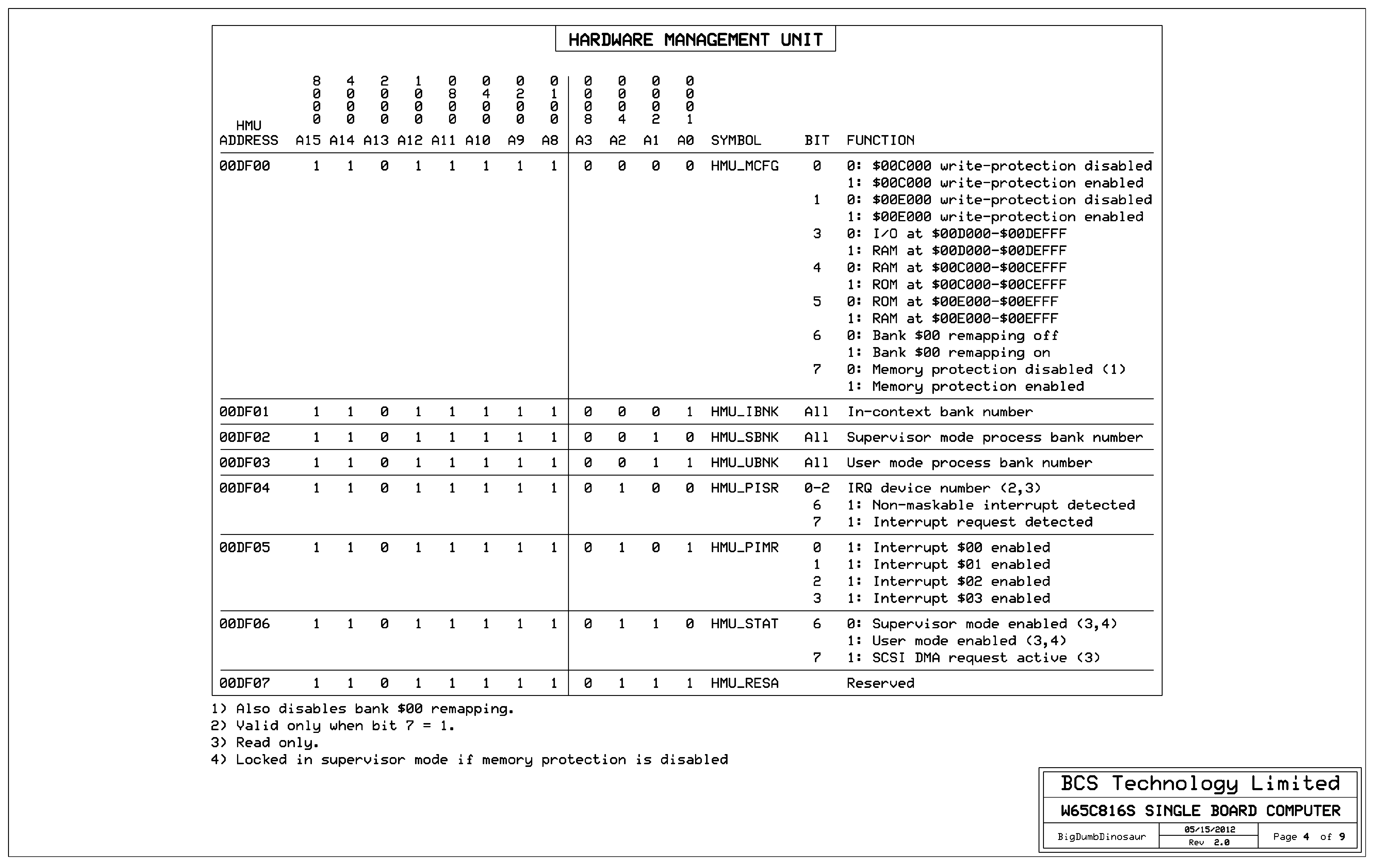

When operating in protected mode, the system will have a user mode and a supervisor mode. User mode is what ordinary processes (e.g., a text editor, an instance of BASIC running, etc.) will see, whereas the operating system kernel will see the supervisor mode. I modeled some aspects of this feature after what is supported by the Motorola 68K family.
All user mode processes will be confined to one non-zero RAM bank and will not be able to access any other bank except via kernel calls. As all user mode processes will run in a non-zero bank, each such process will have 64KB of contiguous space for code, data, direct page (DP) and a stack. If the architect of the OS kernel wants to do so, he could arrange to provide access to RAM outside of the process' bank, in a fashion that would mimic the UNIX/Linux sbrk kernel call. Such an arrangement would be very useful with EhBASIC, for example, as it could be arranged for the interpreter to run in one bank with its own DP and stack, using its data space to load BASIC program text. Another bank, made available by the kernel, would be where variables would be stored—and accessed via [DP] and [DP],Y addressing, which support cross-bank transfers.
Supervisor mode will allow the OS kernel to get unrestricted to the entire address space, including the I/O block and the hardware management "unit" (HMU, discussed below), both of which will appear in bank $00. The implication, of course, is that when operating in protected mode, user mode processes will be prohibited from touching the hardware and possibly causing fatality. User mode processes will have to make defined kernel calls to carry out I/O.
In user mode, any direct page (DP) or stack access will be transparently mapped to the corresponding address in the in-context user mode bank, not bank $00, without the MPU being aware of anything unusual going on. In other words, if the currently-executing user mode process is running in bank $3A, the stack pointer is currently at $FFFF and the user mode process pushes a word, the word will be found at $3AFFFE-$3AFFFF, not $00FFFE-$00FFFF. Similarly, the instruction LDA $7F would actually get a byte (or word) from $3A007F, not $00007F. The result will be that individual processes will not have to share bank $00 for DP and stack space, thus solving part of the puzzle of how to keep user mode processes out of each others' way.
An interrupt (including BRK and COP) will cause a hardware context change from user mode to supervisor mode, but will not automatically turn off the bank $00 remapping feature. Hence the register pushes that occur during the early part of an interrupt service routine (ISR) will be to the user mode process' stack. Later on, the ISR can turn off bank $00 remapping so the kernel can access its private DP and stack in bank $00 for internal processing purposes. When a return to user mode was to be made, the bank $00 remapping would be re-enabled so the register values that were pushed to the user mode stack could be restored. The context switch back to user mode would be triggered when the RTI instruction is executed.
The HMU will be a virtual device inside the glue logic CPLD (see below drawings for architecture, etc.) responsible for enforcing protected mode hardware access rules. The HMU will be where various combinations of RAM, ROM and I/O can be made to appear in bank $00, bank $00 remapping can be controlled, interrupt status detected, etc. As supervisor mode is the only mode in which the HMU can be accessed when hardware protection has been enabled, a rogue user mode process will not be able to get to the HMU and wreak havoc.
This is only a summary. Obviously, there is more to it, but you should be able to get the basic idea.
File comment: POC V2 Architecture

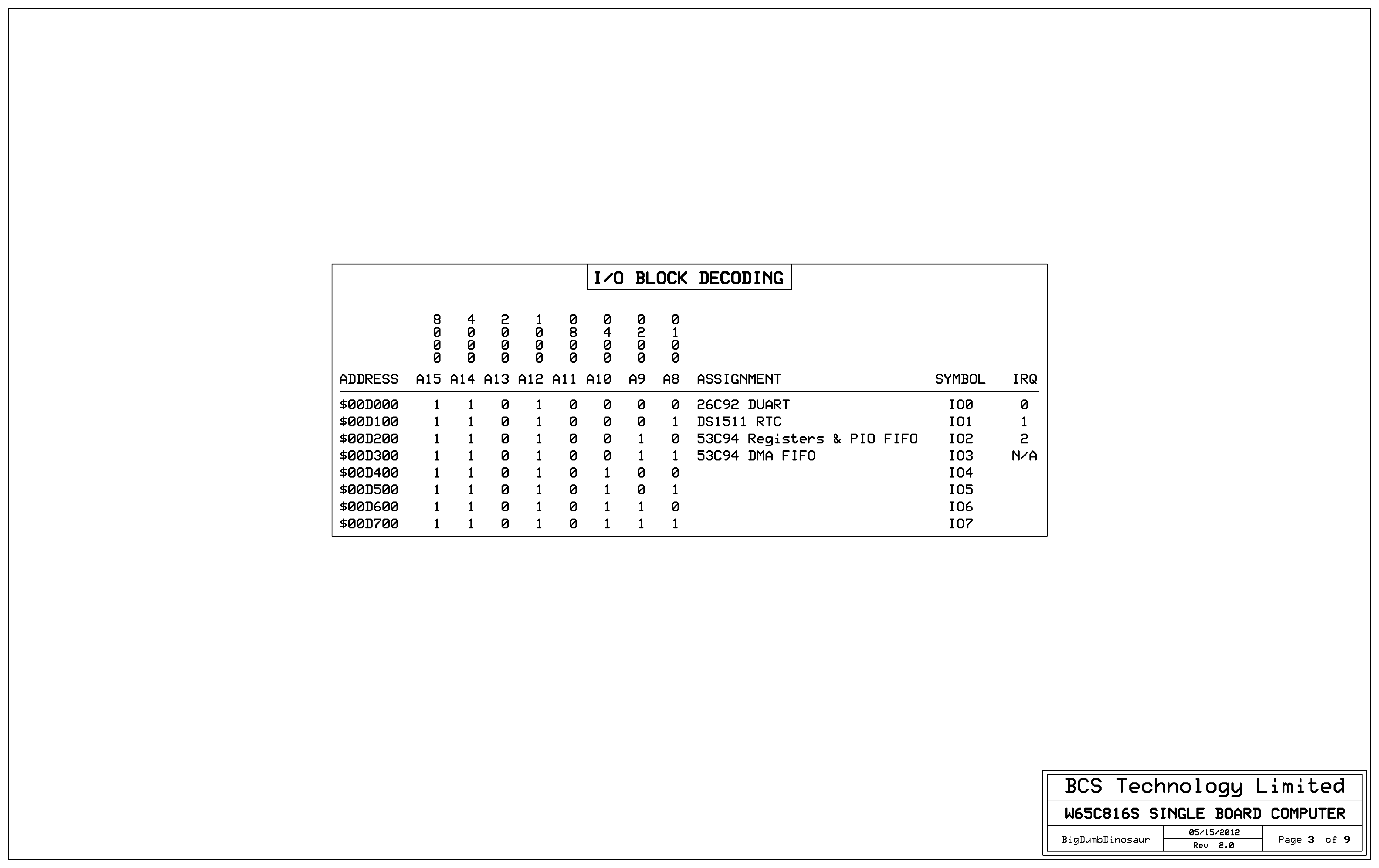

File comment: POC V2 Memory Map
File comment: POC V2 I/O Map
File comment: POC V2 Hardware Management "Unit"

I usually just let the I/O decoding appear in all 256 banks. It does waste a 2k or 4k block in each bank but it make access of IO from each bank much easier.
That would be good in a real-time environment, but would pose problems where a kernel is controlling the system. I don't think you'd want programs randomly touching I/O hardware.
