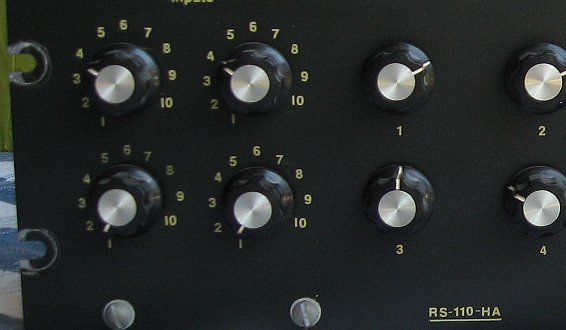

BTW, how did you silk-screen the control panel? Looks professional.
I used dry transfer lettering, then I put Varathane (similar to varnish) over it to keep it from flaking off. It has yellowed over the years. It was whiter when it was new. This is the left end of the front panel:
On the next piece of equipment I made to go in the same home-made rack, I ran out of patience, and the lettering was not nearly as neat.

I don't think my hands would be steady enough anymore to get the dry transfers to line up. When I have to label things I use clear adhesive labels in the laser printer. The tricky part is getting the lettering to contrast with the background.

Yea, try as I might, I can never get that white ink to work...

This is awfully off-topic, but since there's interest:
You can see and read a little about dry transfers at https://en.wikipedia.org/wiki/Dry_transfer. Craft stores always have it in black and sometimes white, in different fonts and sizes. Other colors are available but less common. You can microadjust the position of the letter over the desired surface before beginning to burnish it from the transparent backing onto the desired surface. The backing goes down against the surface and of course has static friction, so shaky hands make it harder but not impossible. There's no liquid involved, and the letters are not adhesive. They don't stick to the other surface until you burnish them down; so touching the letter surface before it is positioned correctly will not make it stick where you don't want it.
