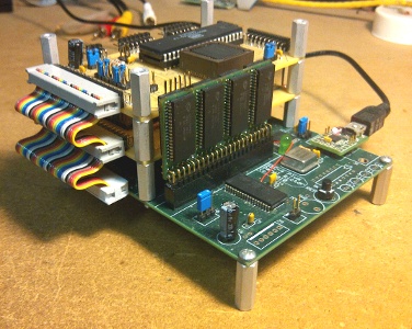

The problem with the stripboard is that it doesn't have so many strips to fit all of the bus lines and ground strips. Actually i barely managed to fit the data bus, control lines and 4 address lines. For the rest i use ribbon cables, and since not all modules require extended address and since it goes in only one directions, that should be a smaller problem that the backplane. As for the slew rate, could i try adjusting it with small capacitors if it is too steep?
Actually the ribbon cables is the route the Daryl took on his SBC-4 pictured here:
You can get ten signal conductors per inch plus grounds between them, the ribbon having 20 conductors per inch total, meaning twice what the strips on the proto board give.
That's what the 1488 RS-232 line driver did for bringing the slew rate down to avoid the reflection problems with super long cables; but at faster logic speeds it would result in more groundbounce, ie, the heavier load on one output pin switching will develop more voltage across the IC's ground or Vdd inductance which affects other outputs that are not supposed to be switching. So I wouldn't recommend it.

For start ill try to use just BDD-s ABT ic, that i already ordered, and if i spot any issues, ill try to implement terminators or something to try make it more stable.
PostPosted: Fri Aug 31, 2012 8:07 am
Posts: 8460
You will have sockets, right? so you can try different parts and swap them out with minimal effort.
