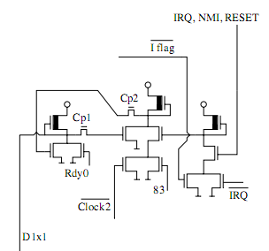

Just a little more on this. We'd need to redraw this section
of Balazs' schematic, because there's a missing NOR gate: a signal we've called C1x5Reset comes into play, although it's not active in these simulations.
I've traced a few more signals of interest here.
Node 480 signals that an interrupt is pending, and node D1x1 signals the imminent replacement of the next fetch with a BRK. For the logic in between, the crucial point remains that the machine waits for one of two situations:
    - pipe-T0 in visual6502 terms, or not-Clock2 as marked on the schematic
    - op-T2-branch in visual6502, or PLA signal 83 on the schematic
This is my take on the story:
If you were designing a machine from scratch, your first revision might just wait for T0 in every case. At some later point you optimise the branch sequence so that a taken branch misses out T0. At that point you'd want to find a way to make sure that a succession of taken branches still can be interrupted - in this case, T2.
(Pedantic point: I think this observation should only be called a bug if the original 6502 datasheet tells us what the interrupt latency is. If it doesn't, then it's just an unexpected deviation from the simplistic rule that each instruction can be interrupted at such a point in all cases. The true rule is that the maximum latency is a little more. Later implementations improved this latency.)

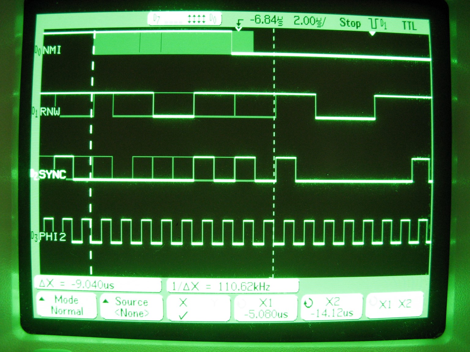

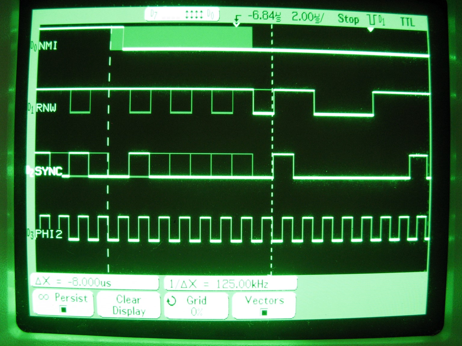

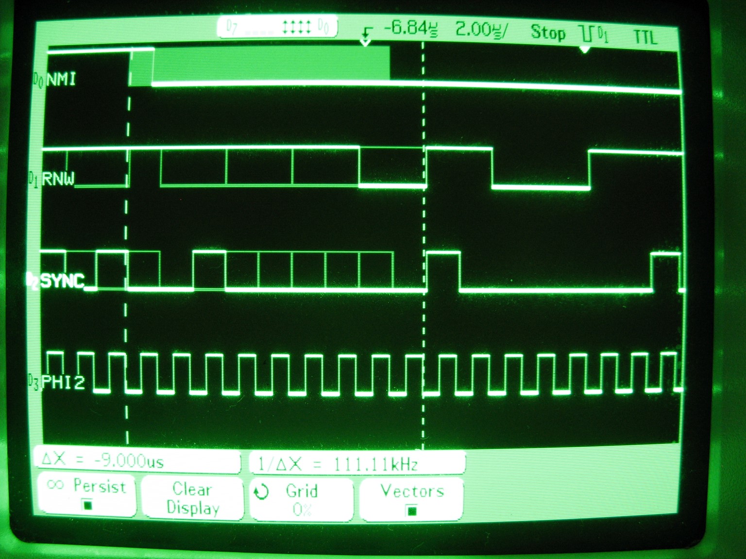

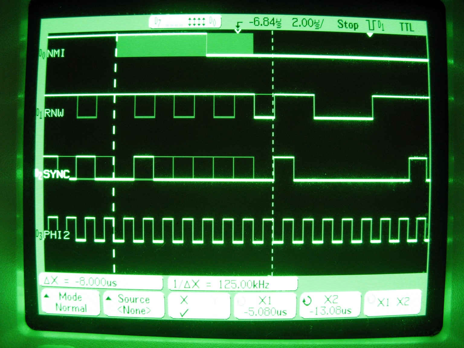

Hi all,
Over the weekend I did a some measurements to experimentally determine the range of NMI/IRQ latency values of:
- an NMOS 6502 (a Synertek SY6502A)
- a CMOS 65C02 (a Rockwell R65C02P2)
Both processors are genuine from original machines.
I did the experiments on an Acorn Atom, as this has a 1MHz clock, with no use of clock stretching or wait states, and also no normal use of IRQ/NMI by the Acorn MOS ROM.
I used the Atom's 60Hz VSync output as an interrupt source, as this comes from a different oscillator so is truly asynchronous to the CPU. For testing NMI, Vsync was connected directly to the 6502's NMI input pin. For testing IRQ, VSync was connected to CA1 of a 6522, and the 6522's interrupt output connects to the 6502's IRQ input pin.
The foreground program that was running was:
        org $7F00
.loop   INC $8000,X
        LDX #0
        NOP
        BNE loop
        BEQ loop
The program should exhibit the worst case interrupt latency, as in includes a 3-cycle taken branch followed by a 7-cycle RMW instruction. (The 6502 does have instructions that take 8 cycles, but these are undocumented)
I'm triggering the scope on the 3-cycle write from the 6502's interrupt sequence, which is very stable. The NMI/IRQ is measured directly on the 6502. The scope is in persistence mode and results were accumulated over about a minute.
The interrupt latency is measured from the interrupt signal going low to the falling edge of Phi2 just prior to the sync that marks the start of the 6502's 7-cycle interrupt sequence.
Here's NMI with a NMOS 6502:
Here's IRQ with a NMOS 6502 (signal labelled NMI is actually IRQ):
Here's NMI with a CMOS 65C02:
Here's IRQ with a CMOS 65C02 (signal labelled NMI is actually IRQ):
In all cases the minimum interrupt latency is exactly one cycle and:
- for the NMOS 6502, the maximum interrupt latency is exactly 9 cycles.
- for the CMOS 6502, the maximum interrupt latency is exactly 8 cycles.
I don't observe any difference in latency between IRQ and NMI (this is slightly surprising, I was expecting to see some evidence of a required setup time).
So it would appear that the "taken branch delays interrupt handling by one instruction" issues only affects the NMOS 6502, and it's effect is to increase the maximum interrupt latency by just one cycle. i.e. It appears from an interrupt perspective the 3-cycle branch on an NMOS CPU behaves like a two-cycle branch with one extra cycle tagged onto the front of the next instruction.
If change the address of loop so that a page crossing occurs on the final branch:
- for the NMOS 6502, the maximum NMI latency is 8 cycles.
- for the CMOS 6502, the maximum NMI latency is 8 cycles.
If I replace the BEQ loop with JMP loop:
These are as expected I think.
Dave
