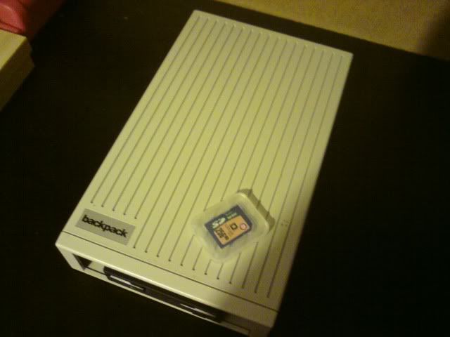

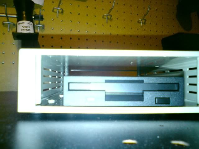

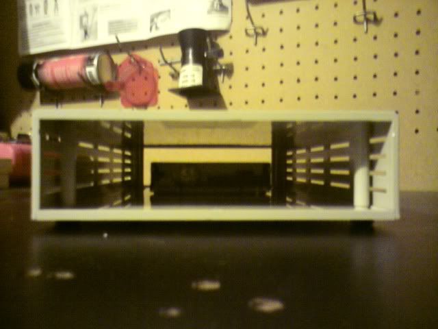

PostPosted: Sat May 01, 2010 1:12 am
Joined: Mon Mar 08, 2010 1:01 am
Posts: 142
Figured I would not have to mention but the above chips are free. They are just taking up space here.
None the less how does this look for the projects case.
I installed the Panasonic drive to test for spacing, the motherboard so to speak will be on the top of the case and the bottom is for the FDD & Power Supply circuit.
And that 256MB SD card will serve as a HDD of sorts.
Dimitri
Then Maxim's SD-card ap. note at http://pdfserv.maxim-ic.com/en/an/AN3969.pdf will be of interest to you.
Depending on your application, you might find you need a lot more access space for I/O connectors than what you can get with a case like that which has only a small panel front and back.
