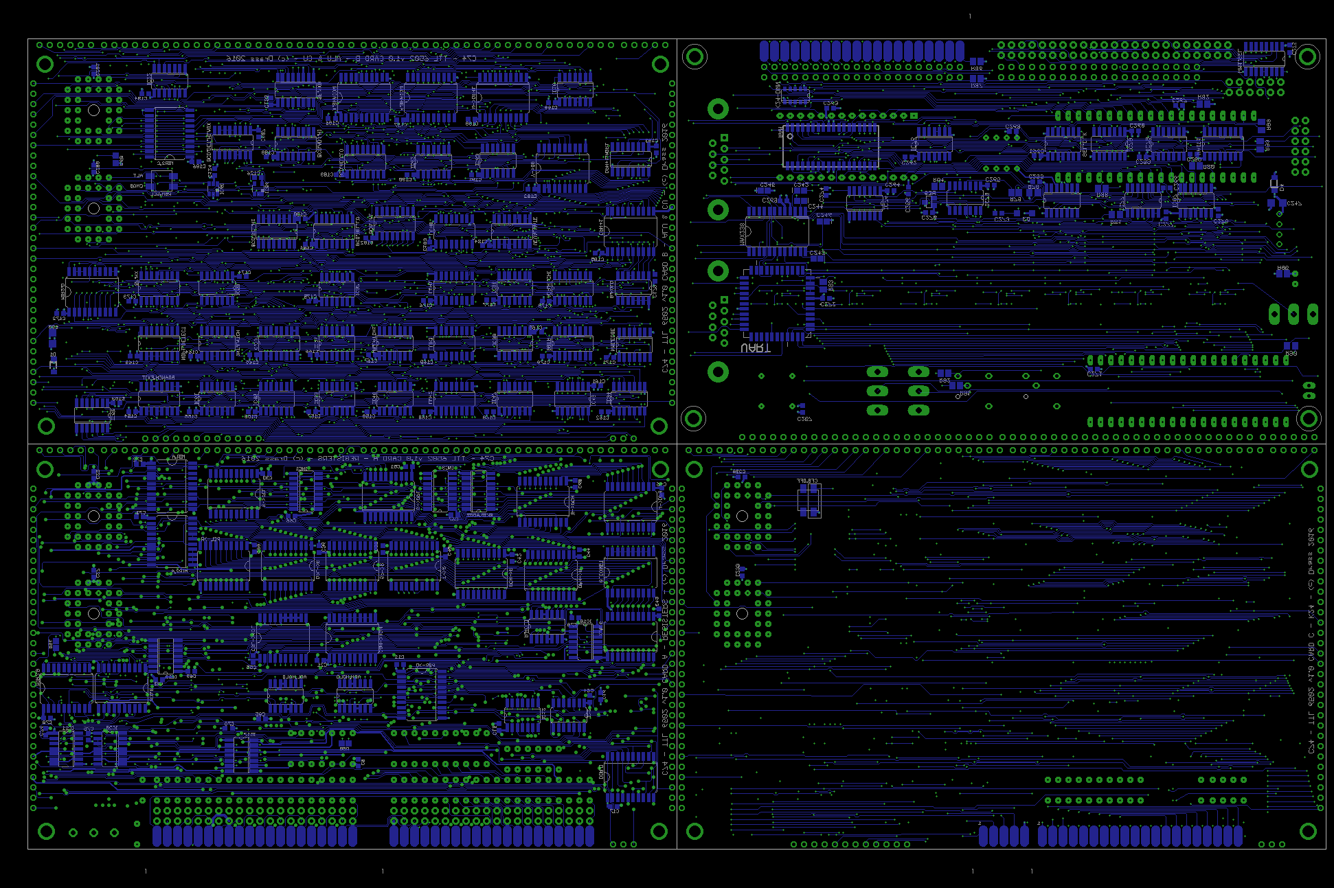

And speaking of helpful, ttlworks was very kind to merge the 4 board files of the CPU into a beautiful panel (unfortunately not something I could do myself without the full version of Eagle CAD). Thank you ttlworks!
It's been a long time coming, but it's sure exciting to finally get here. And now it's off to the board house .. ahoy! :D
Attached are the op and bottom layers of the panel.

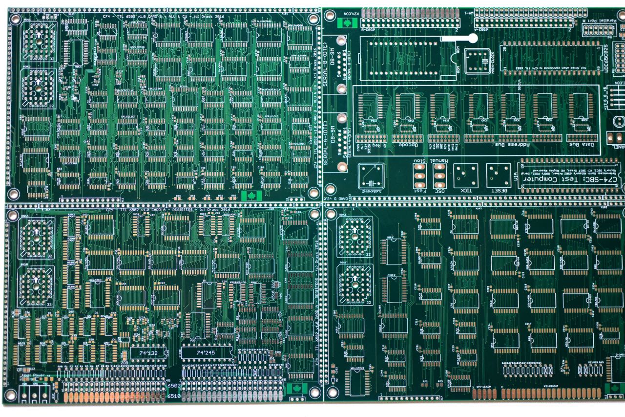

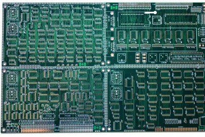

It's here !!! :D
Man, oh man ... it's a beast:

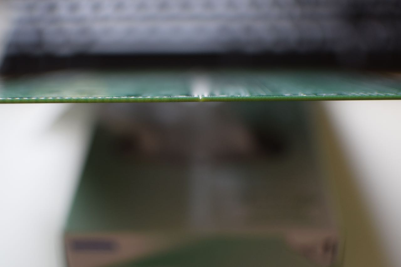

Card A: Registers, Card B: ALU & CU, Card C: K24 and Card D: SBC - all in one panel. I had a quick look and noticed some vias were uncovered (I specified tented vias). That may prove to be a problem, since some of these vias are quite close to adjacent pads and I may bridge them when soldering. We'll have to see about that. The more immediate issue, however, is the v-scoring ...
The board house description is that a "V" shaped groove is "scored" into the panel on both the top and bottom surfaces along the boundary lines between each board (the groove is just visible in the pic above on the edge of the panel). The idea is that the individual boards can be snapped apart along these grooves. Sounds straight forward enough, but in fact the cuts in this instance are on the top-side only and enough material remains to make the panel flex unnervingly rather than snap. I'm thinking an exacto knife and a ruler may help cut a deep enough groove for a clean snap, but any suggestions on this 'score' are most welcome. :)

I'm not sure what you're saying the problem is; but our company has gotten loads of boards with the scoring, and the snap-apart feature has always worked perfectly. Never a problem. That said, there are times we get them routed instead, particularly when we need all usable the room we can get on the board, and the exact dimensions are more critical.
PostPosted: Wed Sep 13, 2017 2:59 am
Drass wrote:
It's here !!! :D
Wow! Congrats! (Now the fun really starts! :P )
"Flex unnervingly" sounds like a large-radius bend. For best chance of a clean break you want a small-radius bend. In other words confine and concentrate all the bending stress to the region within a millimeter or so of the score.
Maybe I'm stating the obvious, but the material NOT in the bend zone can be held flat (held un-bent) by use of an improvised clamping apparatus. For example, lay the PCB on a countertop (or the edge of a table saw, if you have one) then lay a piece of lumber on top, with downward pressure applied to create a sort of vise which clamps the PCB. The jaws of the "vise" should grip should fairly close (1-2 mm) to where the score is. Then use another piece of lumber to press down on and break off the unsupported half of the PCB. Again, to keep the bend radius small you wanna do your best to apply the downward pressure fairly close to where the score is.
(Probably the absolutely ideal tool for this job is a bending brake, as used for sheet-metal work. But even an improvised apparatus may be overkill, judging from Garth's remarks.)

I had to trim some PCBs a while back and used a small keyhole saw for the purpose. After cutting off the excess of the PCB I used a fine-cut file to clean it up.
