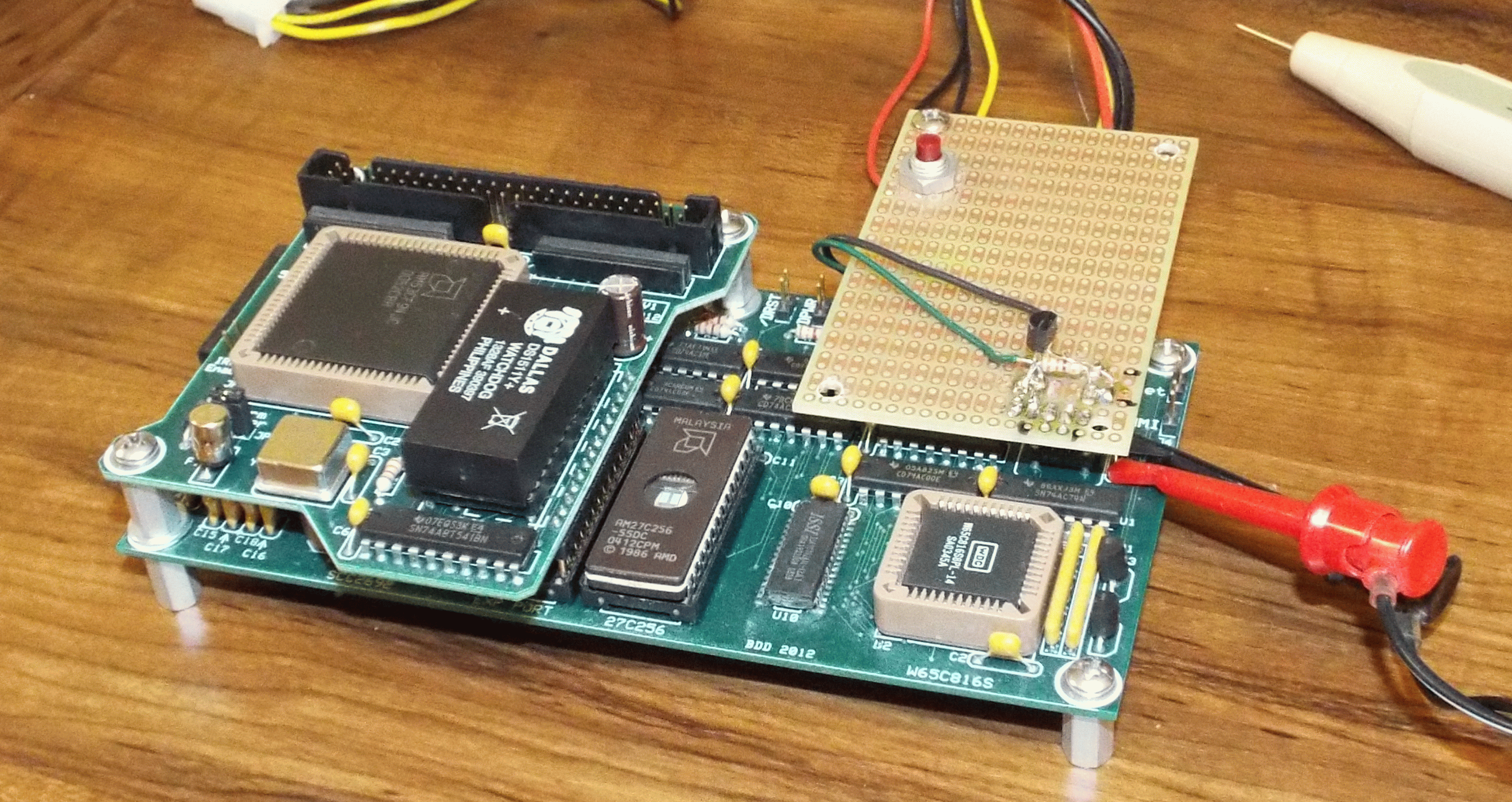

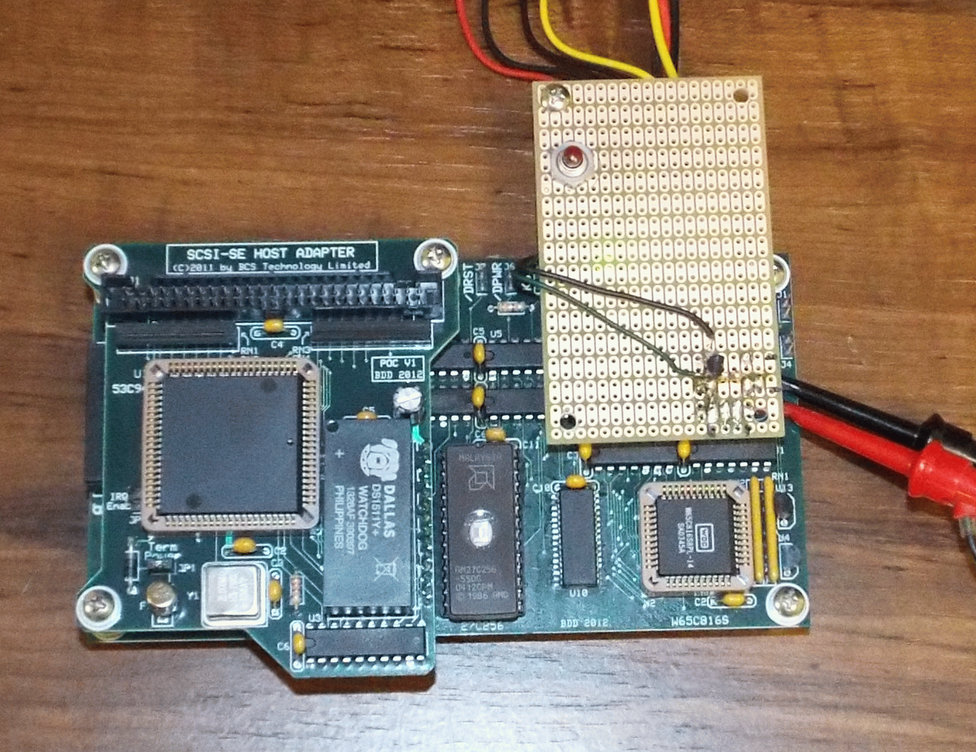

I got my little clock single-stepper built and tried it out. Right off the bat I could see where the Ø2 clock might be an issue.
Recall that Ø2 is the output of a flip-flop driven by an oscillator. The single-stepper does nothing more than imitate the low/high output of the oscillator, pulling the flop's CLK input low when a push button is pressed and then bringing CLK high shortly after the push button is released—a DS1813 reset generator debounces the push button. Each time CLK goes high the flop's Q output, which is from where Ø2 is derived, should change state. So, the theory goes, two push button press/release cycles would produce one complete Ø2 cycle, which would allow me to look at various logic levels with Ø2 held in either state.
For initial testing purposes, I put my logic probe on the flop's Q output just to prove that my stepper was stepping. Several times I noted that the probe didn't always say Q was high when it should have been. First thought was perhaps the flop was defective. Then it occurred to me to switch the logic probe (a BK Precision DP-21) from CMOS to TTL mode, which has the effect of changing the probe's notion of what voltage level constitutes a logic 0 or logic 1. Now the probe consistently indicated when Q was low or high.
The logical progression with this would be to replace the 74ABT74 flop with a 74AC74 equivalent, since the latter's outputs when high are very close to Vcc. I don't have any 'AC74s in SOIC14 so I had to order one. That will be the easy part. Replacing it...well, I still can't see from my left eye...
PostPosted: Sun Sep 18, 2016 9:59 pm
Posts: 8389
I tried out the clock stepper on POC V1.1, whose Ø2 clock is derived from a 74AC74 flop. The logic probe, set for CMOS mode, indicates that Ø2 positively changes state with each press of the push button. It looks as though the 74ABT74 flop on POC V2 is going to have to be replaced with the 74AC equivalent. :cry:
