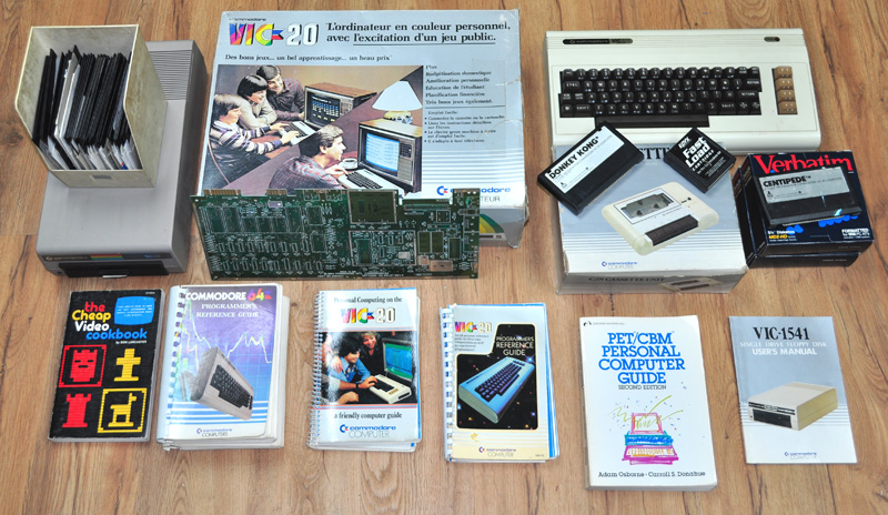

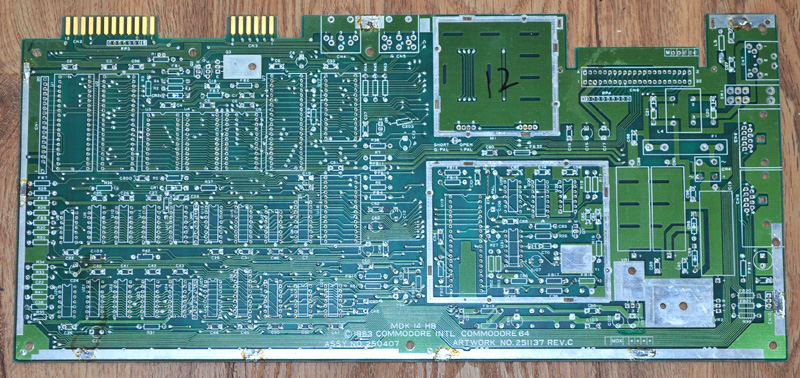

While I was exchanging the lawn tractor with the snowblower, I found a tote in the C-can that contained a bunch of Commodore stuff!
A few Vic-20's, one still boxed, a dataset, a boxed C65 and disk drive, manuals, cartridges, and an unpopulated C64 mainboard.
Although my oldest working Commodore item is my Pet 4016, it was cool to see these items still functional!
A bunch of stuff I forgot I collected!
This C-64 needs a few parts!
Looking forward to getting back to doing something useful on my Vulcan-74 Project!
I have contacted WDC to ask why the toolset seems free (on their website), yet is asking for a license.
If it works as claimed, and can call ASM from C, then I have no issue with the cost.
The last few days forking around with CC65 in DOS was NOT my idea of enjoyable.
Way too many Yaks lost their hair, and I now worry that PETA may show up at my place!

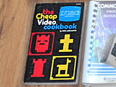

PostPosted: Mon Nov 02, 2015 2:02 am
A classic from the 70's! But I guess this book by Don Lancaster didn't sway the design of Vulcan-74. (Nor should it. Different techniques for different goals.)
Vulcan is all about dedicated video hardware to offload the CPU. With Cheap Video even a 1 MHz CPU can be the video hardware! :D
PostPosted: Mon Nov 02, 2015 11:45 am
Posts: 642
I did reference CVC when learning 6502 assembly. Some great tricks in there for sure!
Once Vulcan is done, I will probably to a minimalist 6502 bit banged VGA system next.
At 20Mhz, some of the CVC tricks will really work well!
Brad
