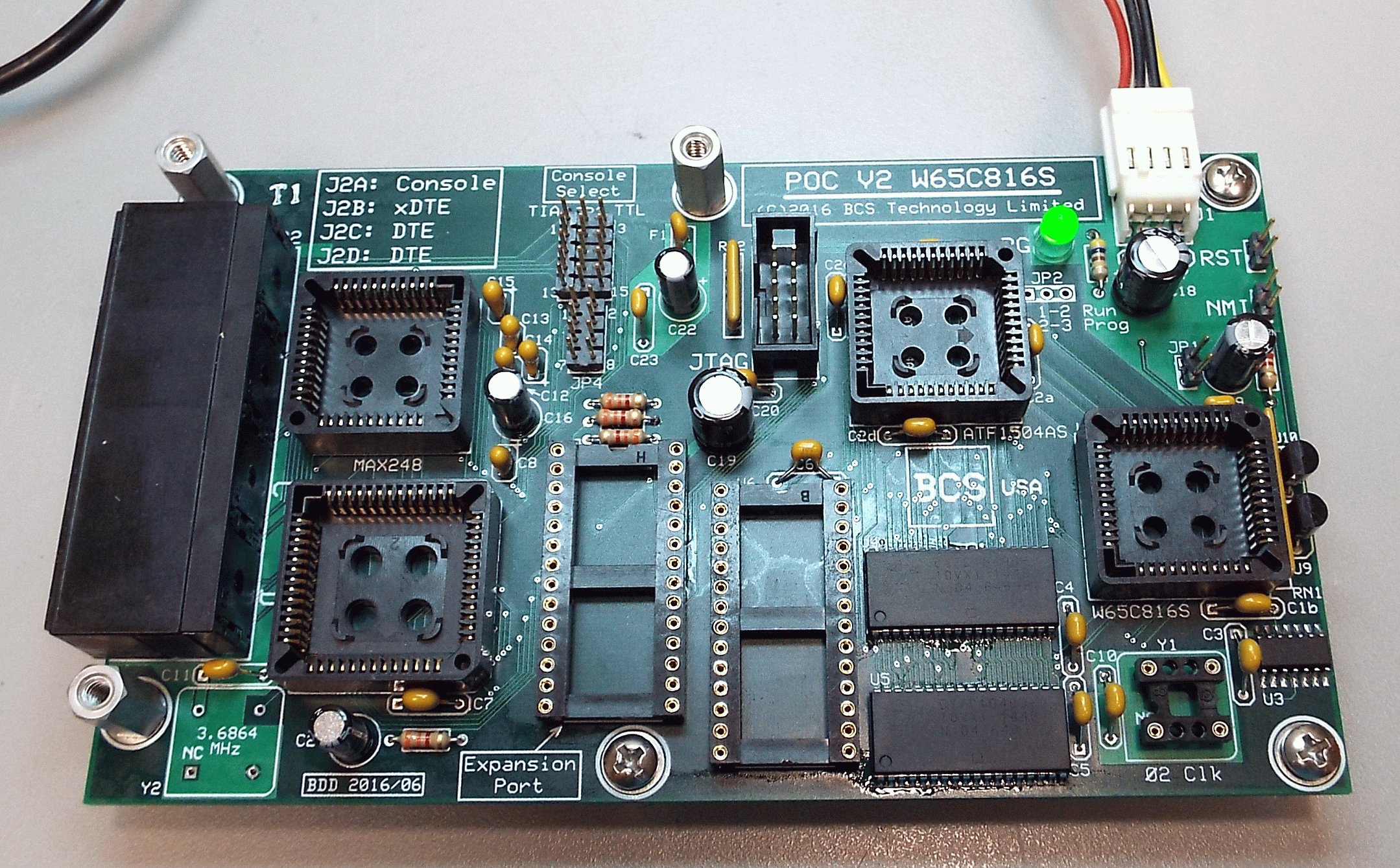

I spent yesterday afternoon at the bench bolting POC V2 together. I have a procedure in which I add a certain number of passive components, check for faults, add some more passive components, check for more faults, and when all passives are installed, apply power to see if something is going to go "bang"—such as an electrolytic that is in backwards (been there, done that :oops:). This initial test is with no active components installed.
The first power-up went okay and the shop was not filled with vile-smelling smoke. :D With that out of the way, I installed the two DS1813 econo-resets and applied power again. I can see /RESET being held low and then released at power-on, as expected. Shorting the NMI header caused /NMI to go low and then return high, also as expected. So far so good.
That is as far as I have gotten as of right now. Working with vision in only one eye makes for some...ah...interesting challenges, as I have no close-up depth perception and sometimes just can't seem to get components leads and socket pins to go into their respective holes. :( Progress tended to be slow, but I just plugged away at it until it was done.
Next step will be to install the Ø2 clock oscillator to check for the presence of a Ø2 clock signal at the MPU and CPLD. Assuming the clock is running, I'll install the CPLD, hook up the JTAG port to my PC, power the unit and see if I can read the CPLD's contents, which I had previously programmed in the Atmel test rig. A successful test will prove that the JTAG port is working and the CPLD is functional.
Here's what POC V2 looked like last night as I was doing the second power test. The two DS1813's are installed (extreme right side of the board in TO-92 packages).
File comment: POC V2 Undergoing Initial Power Test

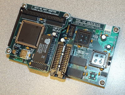

During the firmware development for POC V1, I had the original ROM socket go bad from repeatedly removing and installing the EPROM. Not wanting to again have to go through the agony of replacing a 28 pin socket, I positioned V2's ROM so there would be sufficient room to insert a ZIF socket into the permanent socket. The below picture shows the ZIF socket in place, along with the SCSI host adapter. It all fits—barely. :D
File comment: POC V2 w/ZIF Socket & Host Adapter

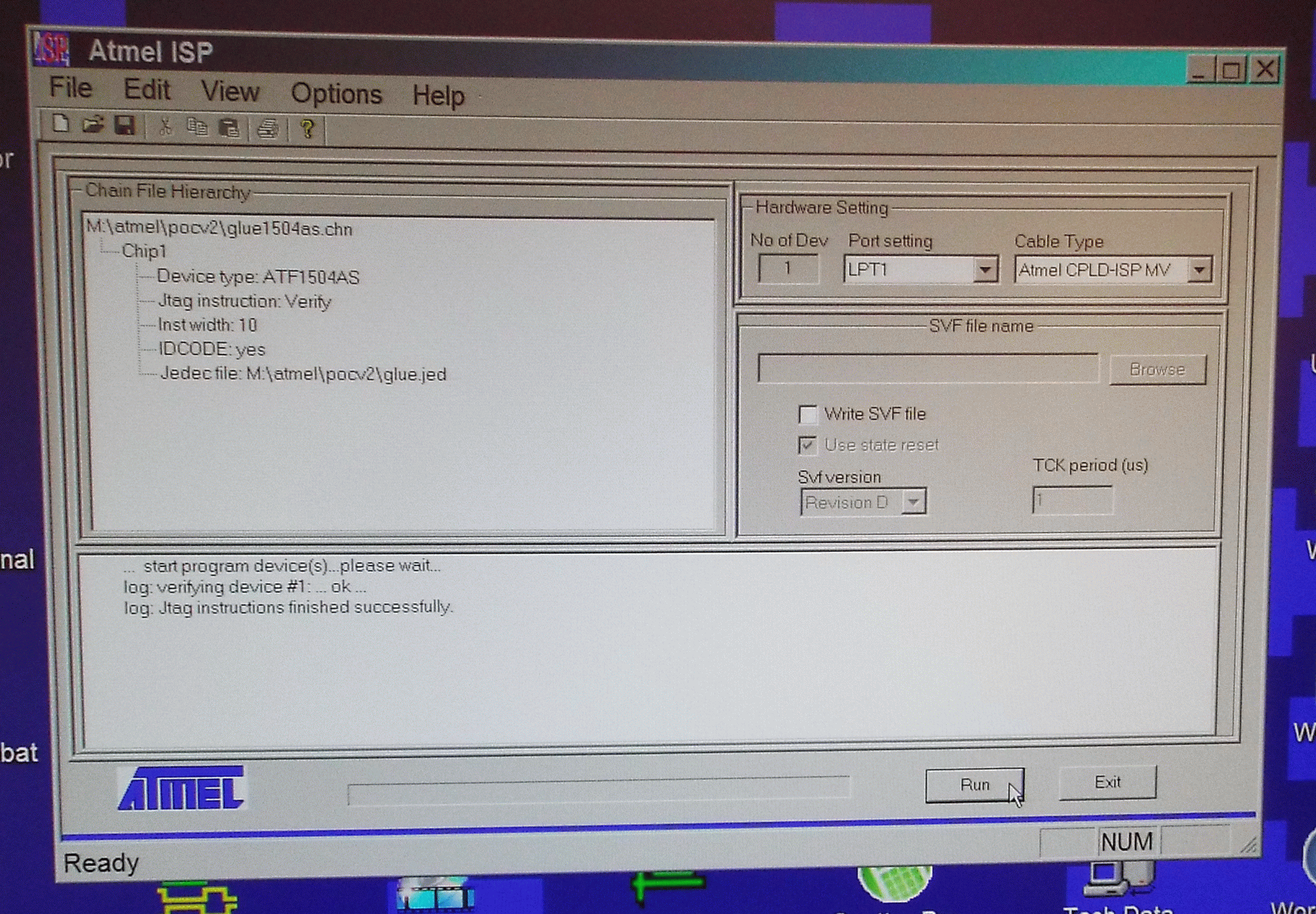

The next step in getting POC V2 up and running was to see if the JTAG port worked. The plan was to program a CPLD (Atmel ATF1504AS) in the Atmel test rig, install it in POC V2 and do a verify on it. If the verify operation succeeded then that meant the Atmel ISP software was able to read the CPLD while installed in POC V2, proving that the JTAG port was working.
After programming the CPLD, I installed it into its socket on POC V2, connected the JTAG cable and powered up.

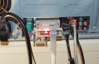

At the risk of stating the obvious, the JTAG cable is that 10-conductor, grey ribbon cable hanging over the left edge of the desk—the CPLD is immediately to the right of the JTAG port. The cable that ships with the Atmel test rig is relatively short. As the JTAG interface doesn't run real fast a much longer cable can be used without compromising reliability. I made up a six-foot (1.83m) cable so it would reach from the back of my PC to the desk where POC V2 was waiting.
The power indicator on the Atmel programming adapter (plugged in the the PC's Centronics port) illuminated, which was a good sign—the adapter gets its power from the JTAG port on POC V2.
File comment: Atmel JTAG Programming Adapter w/Power Applied

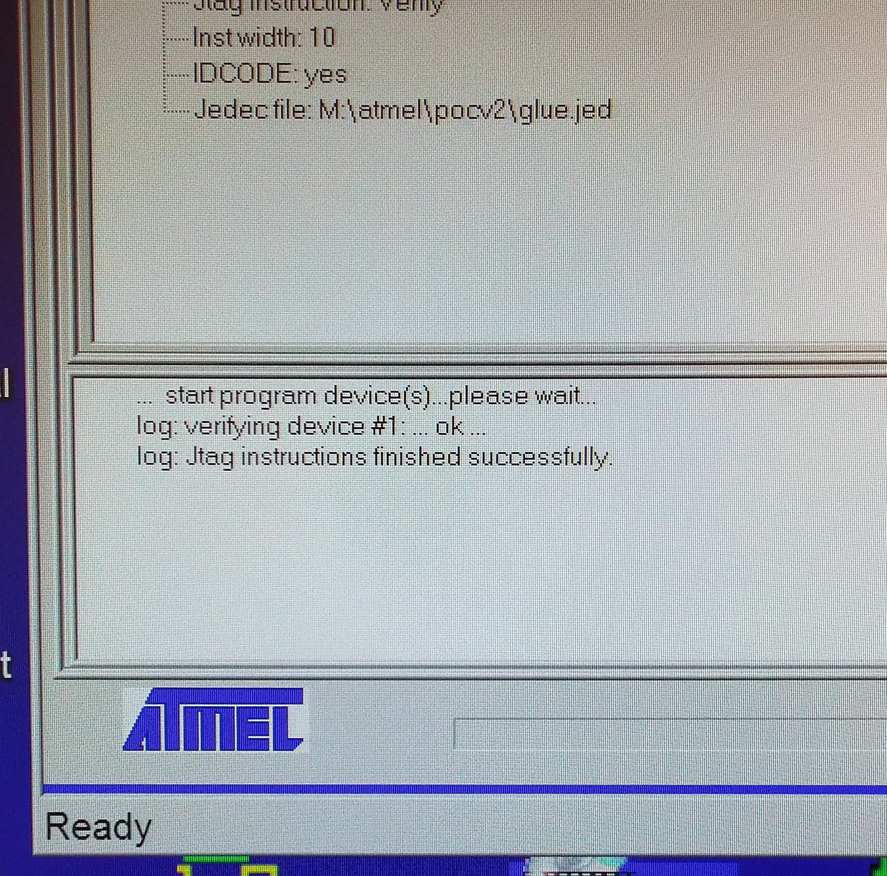

The next step was to fire up the AtmelISP software and tell it to verify the CPLD against the JEDEC file from which it was programmed while in the Atmel test rig. AtmelISP reported that verification was successful, proving that the CPLD could be accessed through POC V2's JTAG port.
File comment: AtmelISP Set Up to Verify CPLD Via JTAG
File comment: AtmelISP Reports Successful Verification of ATF1504AS
With this out of the way the next step will be to finish populating the board, burn an EPROM with some test code and see if she'll "go or blow."
