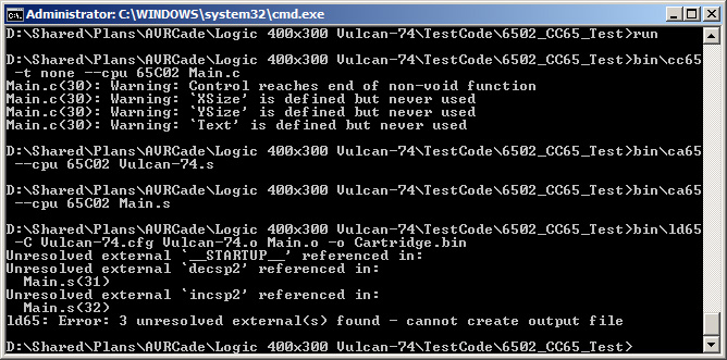

PostPosted: Sat Oct 31, 2015 6:02 pm
Posts: 642
For entertainment purposes, and perhaps to help someone else with my lack of C and ancient DOS apps experience, I shall present my learning curve in graphic detail.
* Note : I am not asking for guidance here. I want to see how long it will take me to figure this out in my own way.
I have read the documentation here in great detail several times, and printed out every page available...
http://www.cc65.org/doc/
So now I mostly get how all of these command line programs work, CC65.exe, CA65.exe, and LD65.exe.
Of course, docs are written for those coming from this era, whereas I come from an era where the tool-chain is ready to use out of the box.
Xilinx, ATmel, Microchip, etc... These IDEs install and work without fiddling under the hood.
As a side note, I only started with C a year ago to help make my AVR game systems easier to code, so last week was my first introduction to several new terms such as linker, object file, and all of that stuff I really don't care to learn more than I need to about. AVR GCC (Studio) worked out of the box.
Now my goal here is to strip CC65 down to the absolute minimal state needed to generate an output file for my hardware.
I do not require multiple platforms, memory maps, etc. I only need to go from Main.c to Cartridge.bin.
I have moved the required files (or so I think) from their directories to a new folder, and have created a simple batch file...
bin\cc65 -t none --cpu 65C02 Main.c
bin\ca65 --cpu 65C02 Vulcan-74.s
bin\ca65 --cpu 65C02 Main.s
bin\ld65 -C Vulcan-74.cfg Vulcan-74.o Main.o -o Cartridge.bin
This will later be done live by calling the EXEs from my Vulcan-74 Toolbox Software.
I know I am getting close now, because there are only a few errors, not the original 2 pages worth...
Looking into the docs, there is a reference to something called crto.s or crt0.s (can't tell if it's zero or letter O in my printout!).
It seems that this files is important, although oddly it is missing from any directory (searched the entire cc65 folder).
I am now doing my research as to what this is, and why it is missing, and why it is only half-ass explained in the docs.
I shall report back when I move to the next string of errors!
Again, please don't help, I know that this will seem so damn basic to many, bit for me, spoon fed knowledge is tasteless.
Back to hacking...
Radical Brad

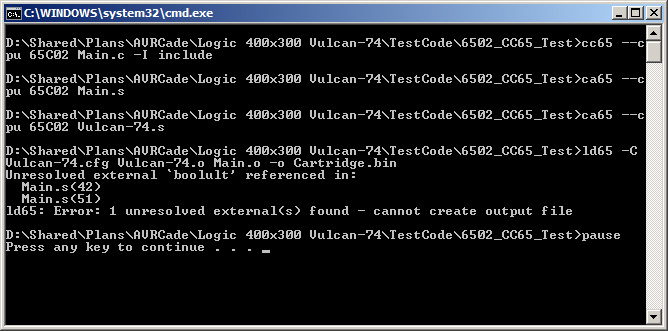

PostPosted: Sat Oct 31, 2015 7:35 pm
Posts: 642
Micheal, seems that once I replaced the version of CA 65 you supplied in the example (V2.13.3) with the one I had downloaded (V2.15), things are working better.
Somehow I ended up with a newer version, and it has the code "GIT" appended to the version number. not sure what that means... Author initials perhaps??
Anyhow, most errors are gone now.
...might have been fighting that one all night!

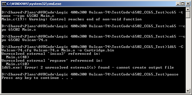

PostPosted: Sat Oct 31, 2015 11:28 pm
Posts: 642
Progress has been made with the CC65 journey.
I managed to at least get my ball bouncer test program into the 6502 Program Memory using the CC65 toolset.
The program code was placed in an endless loop in the .SEGMENT "STARTUP" just to make sure my Binary was correct.
At this point, I do not have any C code written, and I know the journey has only just begun.
Here is what I have done so far....
1) Deleted everything but the CC65 executable files. Don't need any of the other stuff!!
2) Made a batch file based on help from the example posted by Michael...
pause
exit

5) After running the batch file, I get a file called Cartridge.bin, but it is 512 bytes shy due to limitations in CC65.
6) I run my Vulcan-74 BIN to AVR converter, which makes an AVR loadable image and pads back the missing 512 bytes.
7) This is then loaded into the AVR that boot loads the 6502 Program Memory, and the balls begin to bounce!
As soon as I get all the required C foo under control I will then make this all automated within my Vulcan-74 ToolKit.
Things I know (less than) nothing about (yet) are the definitions for a C program to run. BSS, Heap, etc.
If time permits, I will have this all working tomorrow.
The goal will be to remove the ball bouncer from the Library, and have it working as a C program, calling the assembly routines.
Ok, back at it.... there are at least dozen more Yaks that still have hair!
Radical Brad
PostPosted: Sun Nov 01, 2015 12:17 am
Posts: 642
I added some code to the Main.c file, which will be the only C code used as the game logic.
Just something simple that I can check against the assembly output...
int x;
int y;
int main (void)
x++;
y=y+3;
After running the batch file, it is apparent that the real fun is about to start!...
Looking at the compiled Main.s file, it seems to be calling other routines now...

I am now looking through all of the other files I hoped to not need in order to find something called "regsave" and "incax3".
These must be code fragments or some kind of alias? Not sure yet as I don't know a hill-o-beans about C compilers (yet).
Found a bunch of files ending in ".h" and others I cannot open in notepad with a ".lib" extension. The answer must be lurking in there someplace.
It will come together soon enough.
Funny, I think I have as many hours beating around in CC65 as I do designing the entire board!!
Later...
Radical Brad
PostPosted: Sun Nov 01, 2015 2:44 am
Posts: 642
Ok, I think I am getting close now.
Managed to make an assembly call to some of my assembly routines (Kernal).
Found a missing file called longbranch.mac and it cleared a few other errors.
This seems to be a macro, so I will be promptly absorbing it into the code and deleting it once everything else is working.
Something is still barfing though, and I am not sure if it's the Compiler or the Linker...
Here is the Main.c Code...
void __fastcall__ VIDEO_FLIP(void);
unsigned char x = 0;
unsigned char y = 0;
// START OF MAIN
int main (void) {
// SIMPLE DELAY
for (x=0; x<200; x++) {
for (y=0; y<100; y++);
// SWAP VIDEO BUFFERS
VIDEO_FLIP();
// END OF MAIN
return(0);
and here is the compiled Main.s code...

It seems that the hamster turning the compiler wheel wants to call some routine called "boolult", which does not exist!
I have yet to find this chunk of code, and I am getting too tired to continue tonight.
Web scouring for "boolult" brings up nothing coherent to me.
So far, trying to get a C compiler to work has been by far more challenging than any part of coding assembly or making the Vulcan-74 board.
Today has been the single longest span of time I have put into this project, and it was also the most futile!
For now, I will admit that I have lost. Perhaps some sleep will help with the battle if time permits tomorrow.
Until the next bloody battle...
Radical Brad
PostPosted: Sun Nov 01, 2015 4:56 am
Posts: 1948
Yeah, Brad, you may have been a bit hasty in your aggressive pruning job from 1) above. Some of those files you deleted might come in handy from time-to-time.
Mike B.
PostPosted: Sun Nov 01, 2015 6:17 am
It should be part of the C library that came with CC65, just like crt0 (C Run Time) you mentioned earlier. Those are routines that the generated code calls to perform things that are too big to generate in assembly every time you use them, or in case of the crt0, set up the environment before calling main().
PostPosted: Sun Nov 01, 2015 2:01 pm
Posts: 642
Thanks.
Yes, it would appear (after looking at other examples), that my Initialization Sequence is lacking...

.IMPORT _main
JSR _main
If I only make assembly calls in Main, it works!
If I try to add anything as simple as X++; then it fails!
In other examples, there are a bunch of calls to routines like "zerobss", "initlib", etc.
I am guessing that these are part of my missing crt assembly code.
I went back and downloaded the entire package again... twice from 2 different locations.
A search did not reveal anything with even the letters *crt* in it.
Knowing Win7 search is crap, I even downloaded UltraSearch to make sure. No crt*.* file.
Out of frustration, I dropped a filed called Supervision.lib into the root, and added it to the batch file.
The batch file finally run, and made the Cartride.BIN file.
I am not sure if it will work yet though, nor do I know what other foo it added.
Looks like that .lib file had enough of what was missing. Too bad it is not readable.
I will probably step back today, as this is the first time I have not enjoyed this project.
It was NEVER my goal to fight a toolchain. The fight should only happen on the board!!
I just want to code in a simple language like C, not become a DOS expert.
