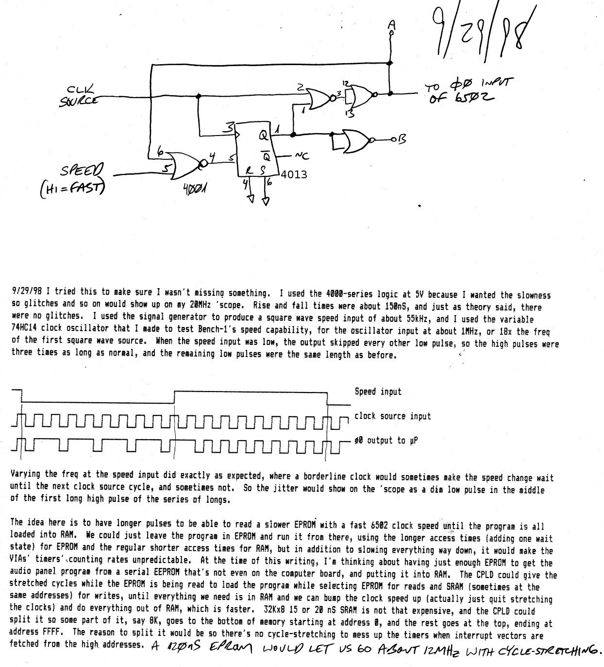

PostPosted: Thu Sep 23, 2010 8:56 pm
Here's a scan of something I did 12 years ago for a project that got cancelled before I finished. I had emailed it to Electric_Eye but decided to post it. It does not use RDY.

I'll be honest guys, I don't like slowing down a cpu "artificially" with wait states. My view may change in the future when I learn more, but right now I'd prefer to set a "speed" bit than wait states...
But after looking at Garth's last post, I am questioning a "cycle stretcher" vs. a "synchronizer". A synchronizer is what I posted yesterday. It takes 2 asynchronous frequencies and based on a select signal smoothly transitions without any spikes or runt signals between either frequency.
Is this the same as a cycle stretcher?
Quoting from Garth's last post where it's handwritten, "a 120nS EPROM would let us go about 12MHz...". A 120nS EPROM, assuming your address decoding logic is 0nS, could be addressed maximally at no more than 8.333MHz...

I think in terms of speed only to keep it simple. If I know my EEPROM has an access time of 200nS, then max speed without any artificial hardware tricks is close to 5MHz. Right now, I push no more than 1/2 of that. Instead of figuring delay cycles, it's easier for me to think in MHz. So I set the speed bit for 2.5MHz when I need to read from the 200nS EEPROM. Right after the copy program is done reading from the EEPROM, I throttle the speed back to as fast as the WDC65C02 will go, which is nowhere near the speed of a 2M 10nS SRAM...
Hence my last question, how does one run a 120nS EPROM at 12MHz without using the RDY signal?
12MHz is the frequency of the oscillator. With the speed input to my circuit low, you actually get 6MHz, but instead of being symmetrical, it will be high 75% of the time and low only 25%, giving you three times as long a phase-2-high time to work with as you get at 12MHz with a symmetrical square wave.
In your application, you can do with a single oscillator (fewer parts), and start with the speed input to the circuit low until you're done loading the RAM from ROM, then set that input high (which you can do at any time without producing a glitch), and leave it high full-time until the next boot-up. The job of giving the ROM more time to spit out its data is then only on this circuit and not on the processor.
I used 4000-series logic only for the low speed, to make sure I would be able to see any glitches or runt pulses on my inexpensive oscillosclope. I would never use 4000-series stuff on a computer board. The idea was that once the idea is proven, I would move it to at least 74HC if not faster. Actually for that project, I was going to put this and a bunch of other logic in a Cypress CPLD. 4000-series logic is very slow at 12V and ultrasuperslow at 5V. I only use it for interfacing to 12V analog stuff where speed is not an issue.

Here's one reason to go with clock stretching, i.e. extending Phi2 high when accessing slower devices.
If the device's select lines are qualified with phi2, it is much easier to work with a stretched phi2, than to separately extend the select signals when RDY is asserted
