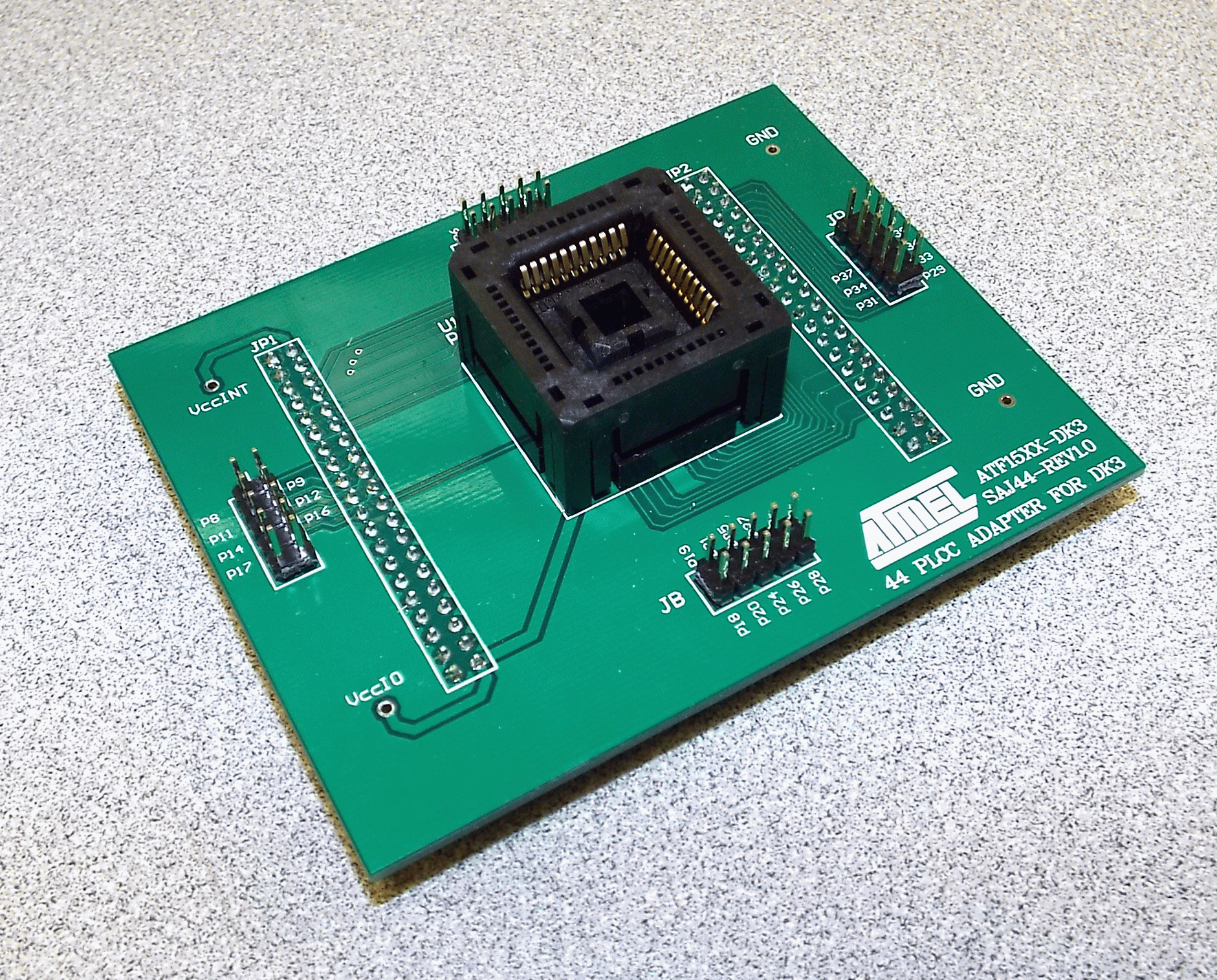

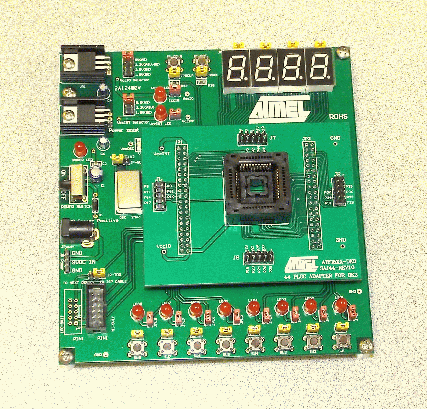

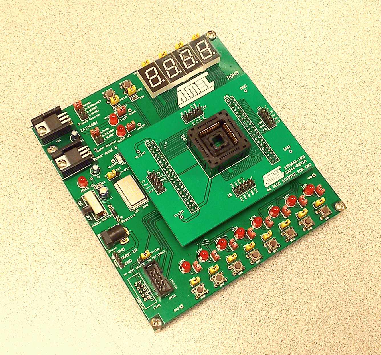

Okay, I've run into a problem. I have here the Atmel programming/test rig for their CPLDs...POC V2 is going to use the smaller 1504AS, which is in a PLCC-44 package. So a while back, I ordered the PLCC-44 adapter and waited for it to ship. And waited and waited and waited and...
Anyhow there's a snag at Atmel and it doesn't look like I'm going to get this adapter anytime soon.
I received an update from Mouser that my order for this adapter will be fulfilled the middle of next month. Evidently Atmel is producing them again. So...it appears I will be able to build POC V2 as originally designed with the ATF1504AS CPLD, which is a much better fit on the EPCB Proto-Pro board layout than the 1508AS's PLCC-84 package. Ergo I'll sit on this a little longer and see if the programming adapter arrives as promised. At least I have a ship date, which I didn't have before.
BTW, I placed the order for this adapter in January 2014. :?
Well, guess what? I received yet another update from Mouser and now the expected ship date has been changed to October. Geesh! :evil: At the rate this is going, my grandchildren will be retired before the adapter arrives.

Hi BDD,
why do you wait for the adapter? Build your own JTAG to PLCC-44 Adapter. You don't need the test board, you only need the download cable. The download cable that comes with the test-rig provides a standard JTAG port. You only need to connect the supply pins (GND VCC) of the ATF1504AS and connect it to 5V and then connect the GND and VCC with the 4 JTAG signals TMS, TMO, TMI, TCK to the JTAG port. This even works when you just use some Dupont wires. I did the same for the first tests of my USB download cable. You could even build a small strip-board with a 10-pin header and a PLCC-44 adapter and a 5V Power Connection and that's all you need with your download cable to program the ATF1504AS, and when you put a PLCC-84 Adapter on the same strip-board and make the correct connections then you can program both, as an ultimate solution you could even cascade the adapters and provide jumpers to short cut the adapter without a CPLD (just connect TMI to TMO of the empty adapter). You should also consider a JTAG pin-header on your POC, so you can even program the ATF when it is inserted in the board. Just connect the down-load cable with a 10-pin ribbon cable and that's it.
Peter

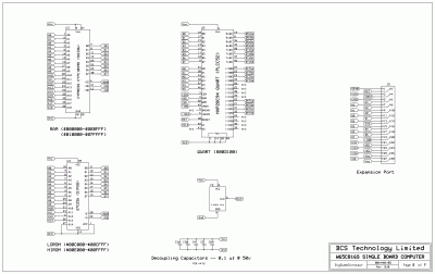

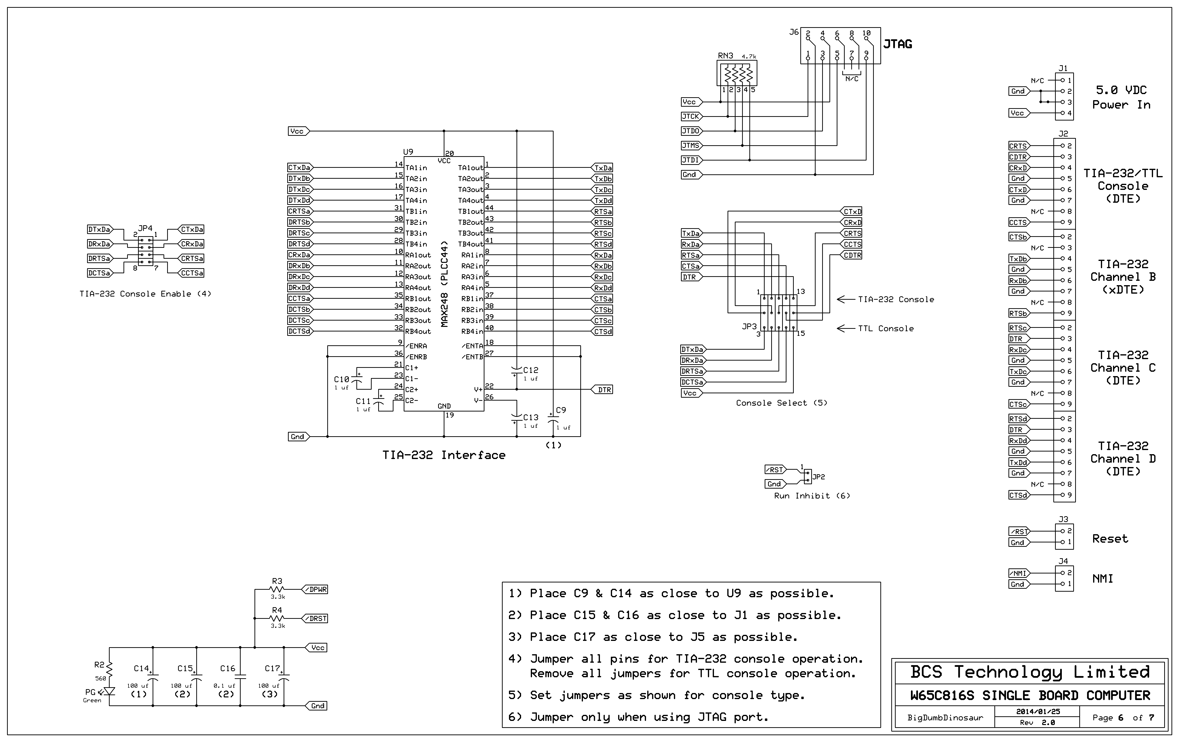

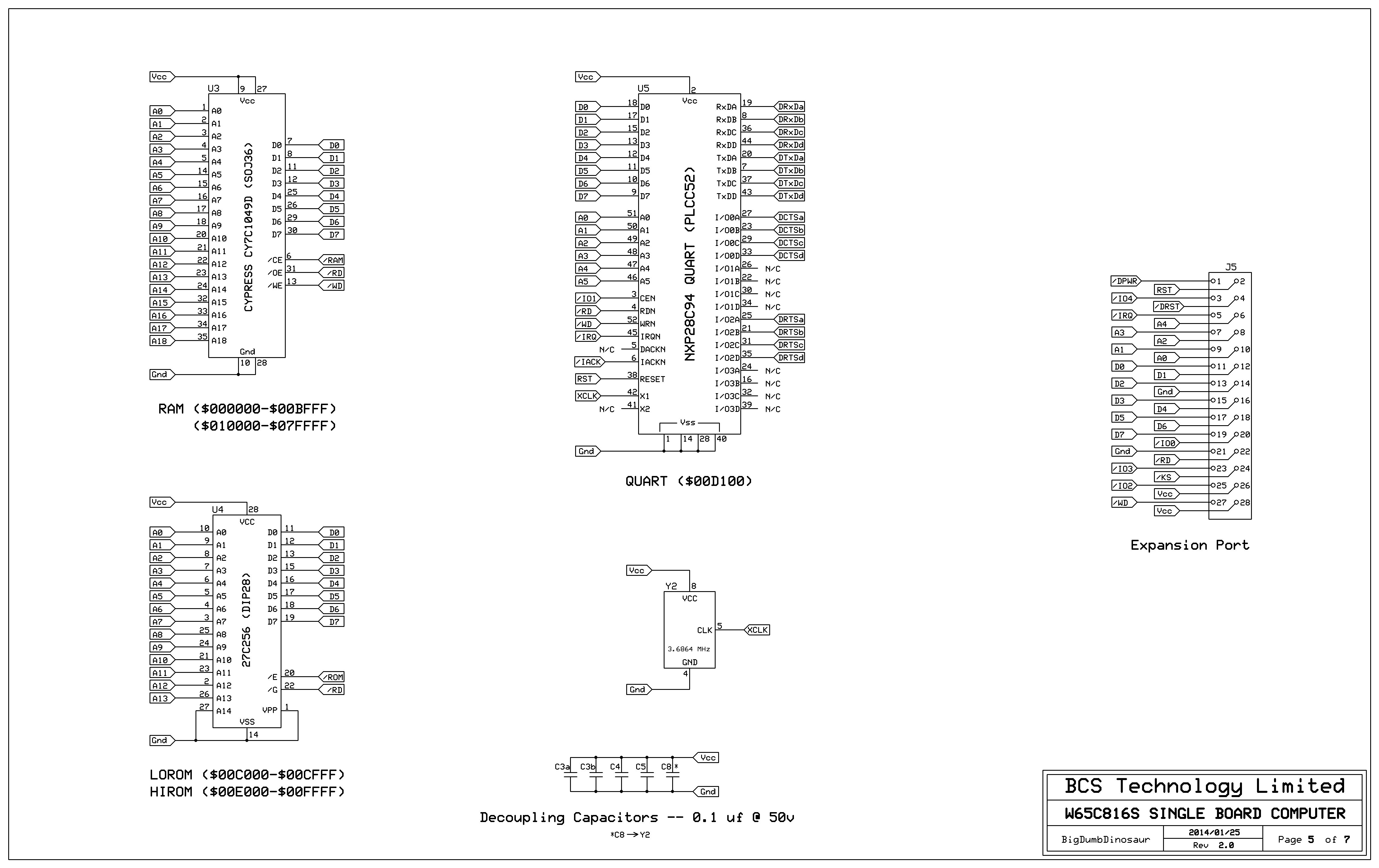

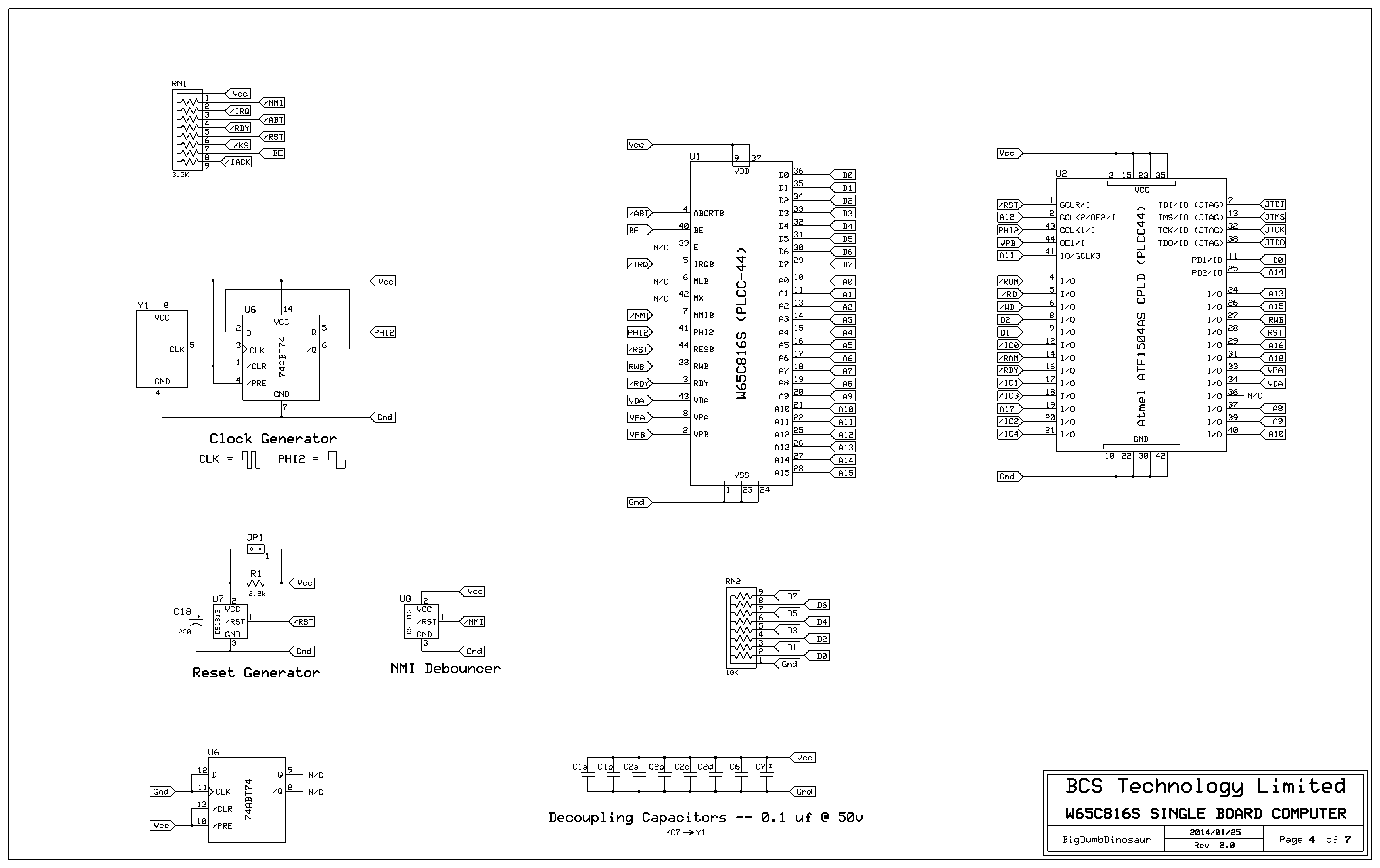

I went over the whole of POC V2's design and reverted it to the Atmel ATF1504AS CPLD, which is in a PLCC44 package. A JTAG port has been added and new logic written. Unless a mistake in design or PCB layout is found in the next few days, this will be the "production" design, and PCBs and parts will be ordered.
Illustrations follow in this post and the next one. Some additional commentary will follow the last illustration.
File comment: POC V2 Schematic, Page 1: Architecture

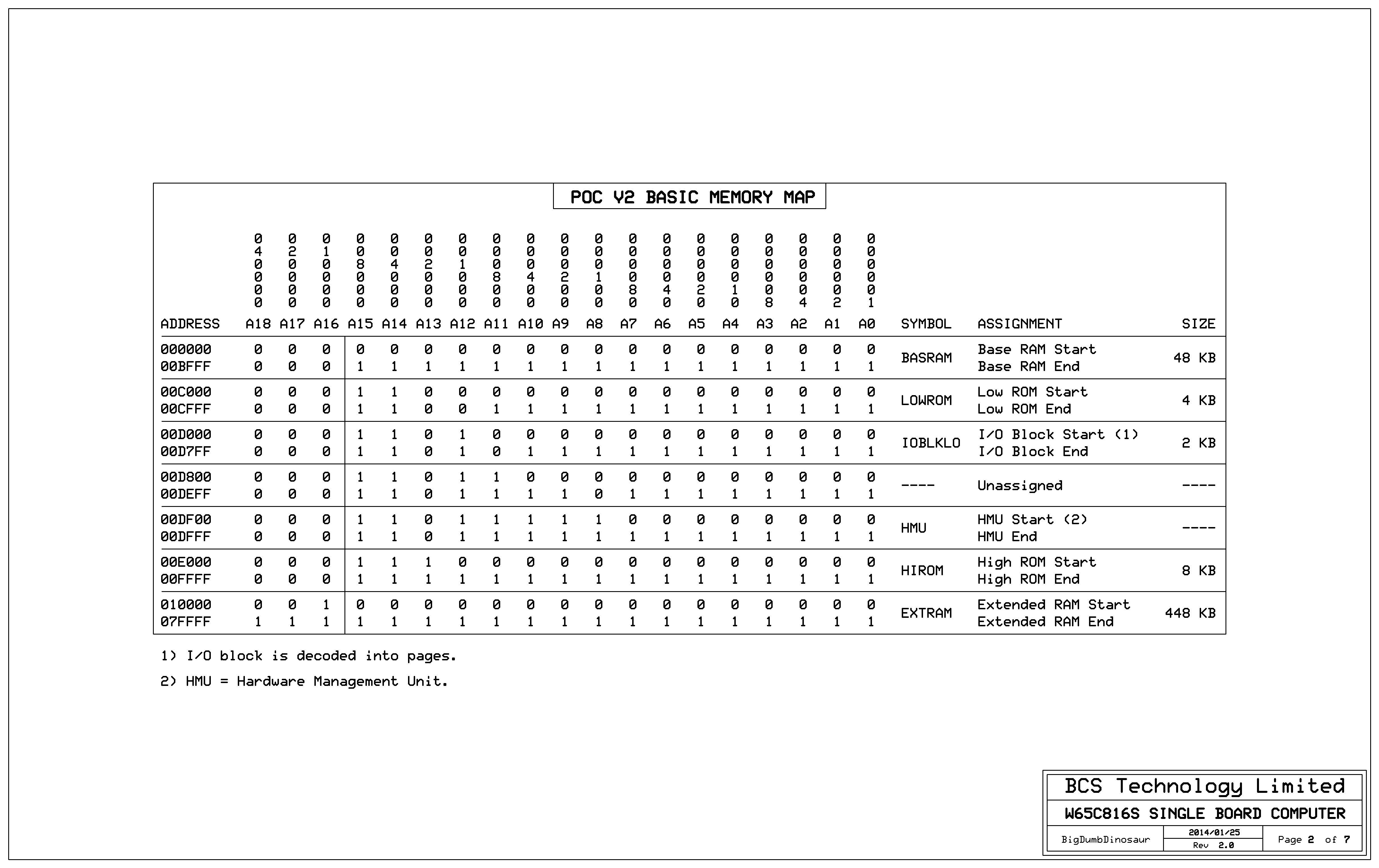

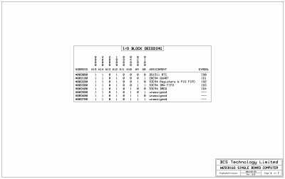

File comment: POC V2 Schematic, Page 2: Memory Map
File comment: POC V2 Schematic, Page 3: I/O Map
File comment: POC V2 Schematic, Page 4:, MPU Interface
File comment: POC V2 Schematic, Page 5: RAM, ROM & I/O

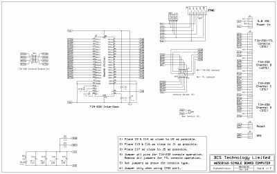

File comment: POC V2 Schematic, Page 6: External Interface

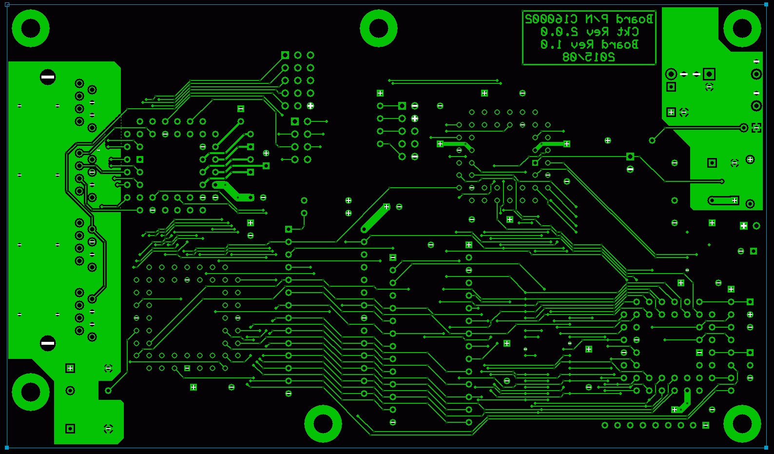

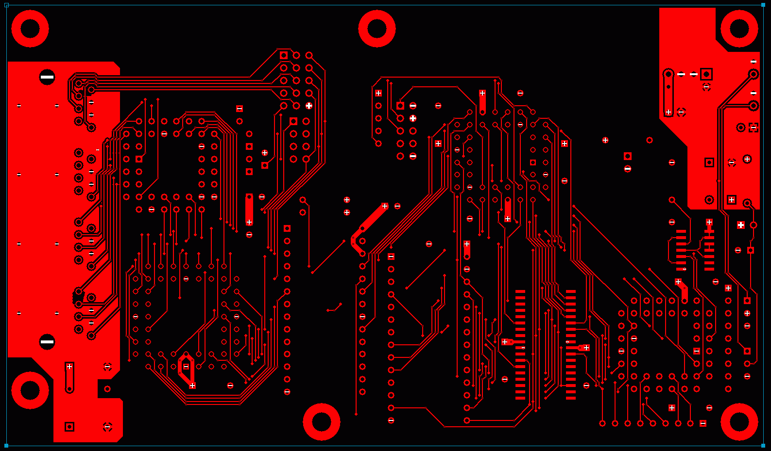

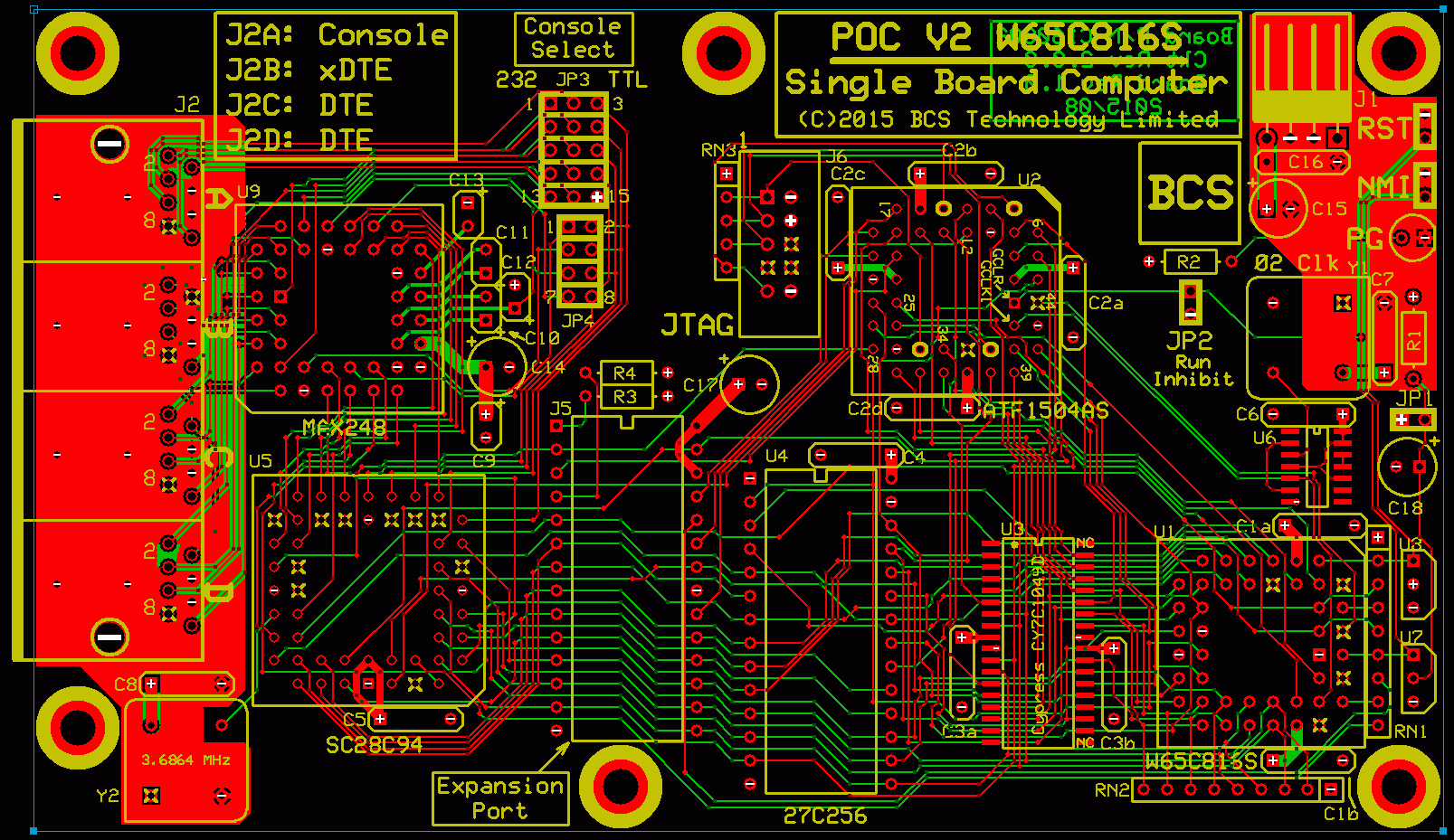

File comment: POC V2 Printed Circuit Board: Composite View

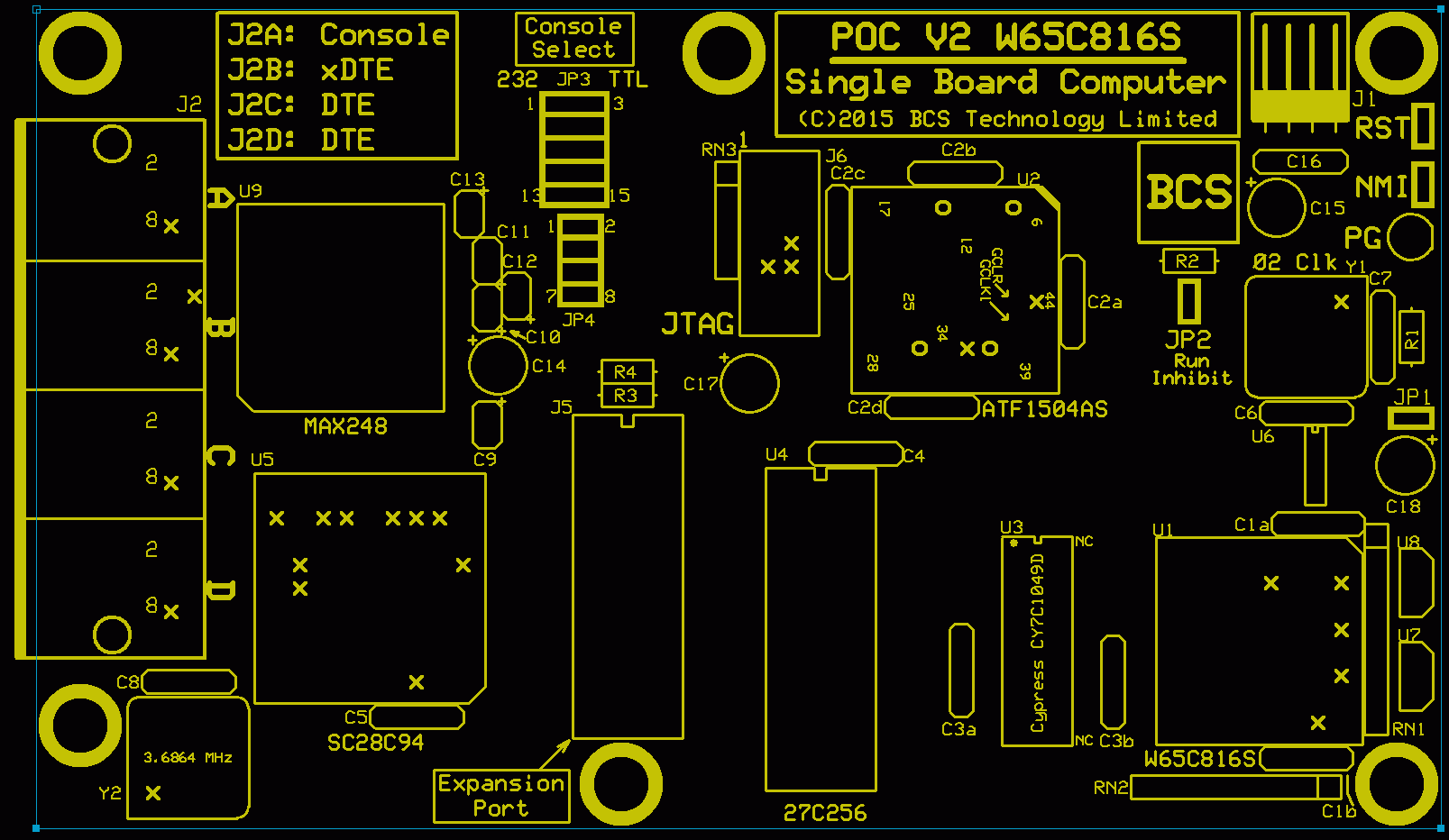

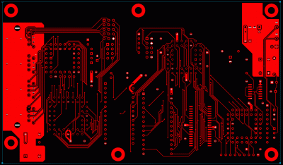

File comment: POC V2 Printed Circuit Board: Silkscreen View
File comment: POC V2 Printed Circuit Board: Top Copper View
File comment: POC V2 Printed Circuit Board: Bottom Copper View
Comments:
  • I replaced the unit's Molex 5¼ inch floppy drive power receptacle with the smaller Berg style 3½ inch floppy disk receptacle to reduce footprint. I also added a mounting hole in the vicinity of the expansion port socket for improved board rigidity.
  • The SCSI host adapter that is presently attached to POC V1 is 100 percent compatible with this unit.
  • There are four TIA-232 serial communications ports, all of which can be simultaneously operated at speeds up to 230.4 Kbps, with full hardware handshaking. As with POC V1, port A is the console port and port B is for interconnection to my UNIX software development box. Ports C and D are uncommitted at this time.
  • The UART in this unit is NXP's 28C94, which has eight-deep FIFOs on both receive and transmit. The 28C94 is essentially a scaled-up version of the dual-channel 26C92, and can be operated in x86 or Motorola 68K bus mode. Oddly enough, x86 mode is easier to interface to the 65C816, even though the read/write logic is a little more involved. :?
  • The console port can be configured to operate at TIA-232 or TTL levels by moving around some jumpers on the PCB (JP3 and JP4). This arrangement will allow me to either connect a standard dumb terminal via TIA-232, as I am now doing, or attach a MicroVGA serial controller (or similar) to the unit. The circuit is designed so that when the latter configuration is in use the DTR output becomes Vcc for powering external hardware.
  • As with POC V1, Ø2 is generated by running the clock oscillator through a 74ABT74 flop. I used an SOIC package for that device to save space. The 512KB SRAM is in an SOJ package similar to the 128KB SRAM on POC V1, which I can manually solder with little trouble.
  • In reverting back to the ATF1504AS CPLD, I had to come to grips with the relatively small number of uncommitted I/O pins on the device, 32 maximum if JTAG is to be used. The device's 64 macrocells are more than adequate for my logic requirements, but the limited pin count meant I had to choose my connections quite carefully. Also, while it was temping to assign pins on the basis of how easy they were to connect to other parts of the circuit, it wasn't possible to get the logic design to fit the device using that strategy.
    My approach was to write the logic with no pin numbers assigned, except for the reset and Ø2 inputs (which are essentially immutable), and then after successful compilation and simulation of the design, use the pins that were assigned by the fitter software. It meant a fair amount of rerouting on the PCB, but everything that I wanted to connect to the CPLD is connected and should work as intended. I also made extensive use of pin nodes to facilitate buried logic, such as the bank address latches.
  • Going back to the limited number of I/O pins on the CPLD, the maximum amount of RAM that can be addressed is 512KB. This is due to the fact that only data lines D0-D2 are attached to the CPLD. Hence the maximum number of banks that can be decoded and latched is eight, support a maximum address of $07FFFF or 524,287. Also implied, only three bits are possible in the "hardware management unit" (HMU, more on this below), since only three bits of data will be available
  • The CPLD logic includes provisions for an HMU, which will be able to change the memory map in the address range $00C000-$00FFFF. The first logic design will map ROM and I/O in that range and while the HMU will accept bit patterns it will not affect the map. Once I've got a working unit I will complete the HMU logic that will make it possible to map out ROM at $00C000-$00CFFF and/or $00E000-$00FFFF, as well as map out I/O at $00D000-$00DEFF and replace these ranges with RAM. The HMU, which will appear at $00DF00, can never be mapped out. The front ends of the interrupt service routines will have to be careful to map in I/O in case it is mapped out when an IRQ or NMI hits. As the HMU is read/write, the ISR can read the configuration, push it and do an STZ to establish the default map.
  • As only bits 0-2 in the HMU will be connected to the data bus during a read on that register, I added weak pull-down resistors (RN2 on page four of the schematic) to the data bus to sink D3-D7. Otherwise, those lines will float and likely retain their previous content during the brief period when the read operation is in progress. Assuming I'm right on this, a read of the HMU should find bits 3-7 cleared, eliminating the need to mask them to get the true HMU content.
  • Lastly, I think my physical layout is tight enough to support 20 MHz operation. Excepting the I/O hardware, everything operates down near 10 nanoseconds, and the CPLD has the logic required to generate wait-states on the I/O block. So I'm hopeful once I've got this contraption running to be able to plug in a 40 MHz clock oscillator and see full speed ahead.

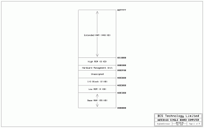

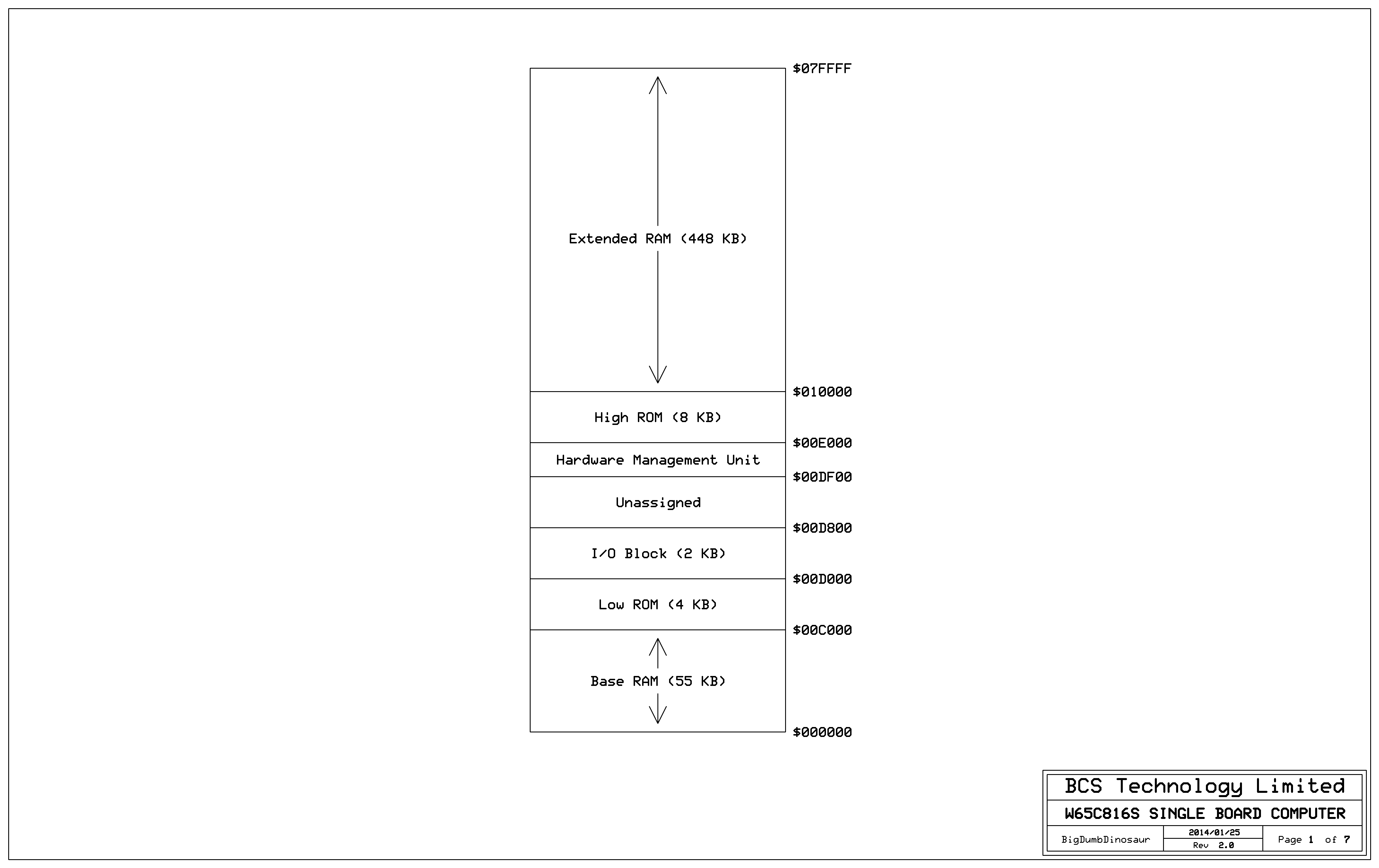

Concurrently with the redesign of POC V2's PCB, I've been working on the CPLD code needed to make it work. My goals aren't too lofty, mostly just latching of the bank address, generation of appropriate chip selects, generating wait-states on ROM and I/O hardware accesses, etc. I originally was going to make it very simple but after compiling the code and simulating it, decided to get a little more advanced.
The address ranges $00C000-$00CFFF and $00E000-$00FFFF can be made to have either RAM or ROM. Also, the range $00D000-$00DEFF can be made to have I/O or RAM. The "hardware management unit" (HMU) in the CPLD, which is always present at $00DF00, accepts a bit pattern that sets the memory mapping rules. The architecture is as follows:
           +--------------------------+ $07FFFF
           |       RAM (448 KB)       |
   +-------+--------------------------+ $010000
   | E-RAM |       E-ROM (8 KB)       |
   +-------+--------------------------+ $00E000
           | Hardware Management Unit |
   +-------+--------------------------+ $00DF00
   | D-RAM |       I/O (3.75 KB)      |
   +-------+--------------------------+ $00D000
   | C-ROM |       C-RAM (4 KB)       |
   +-------+--------------------------+ $00C000
           |       RAM (48 KB)        |
           +--------------------------+ $000000

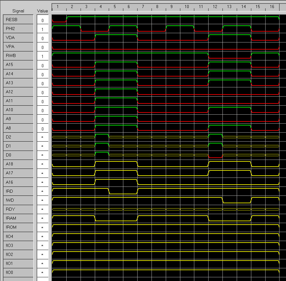

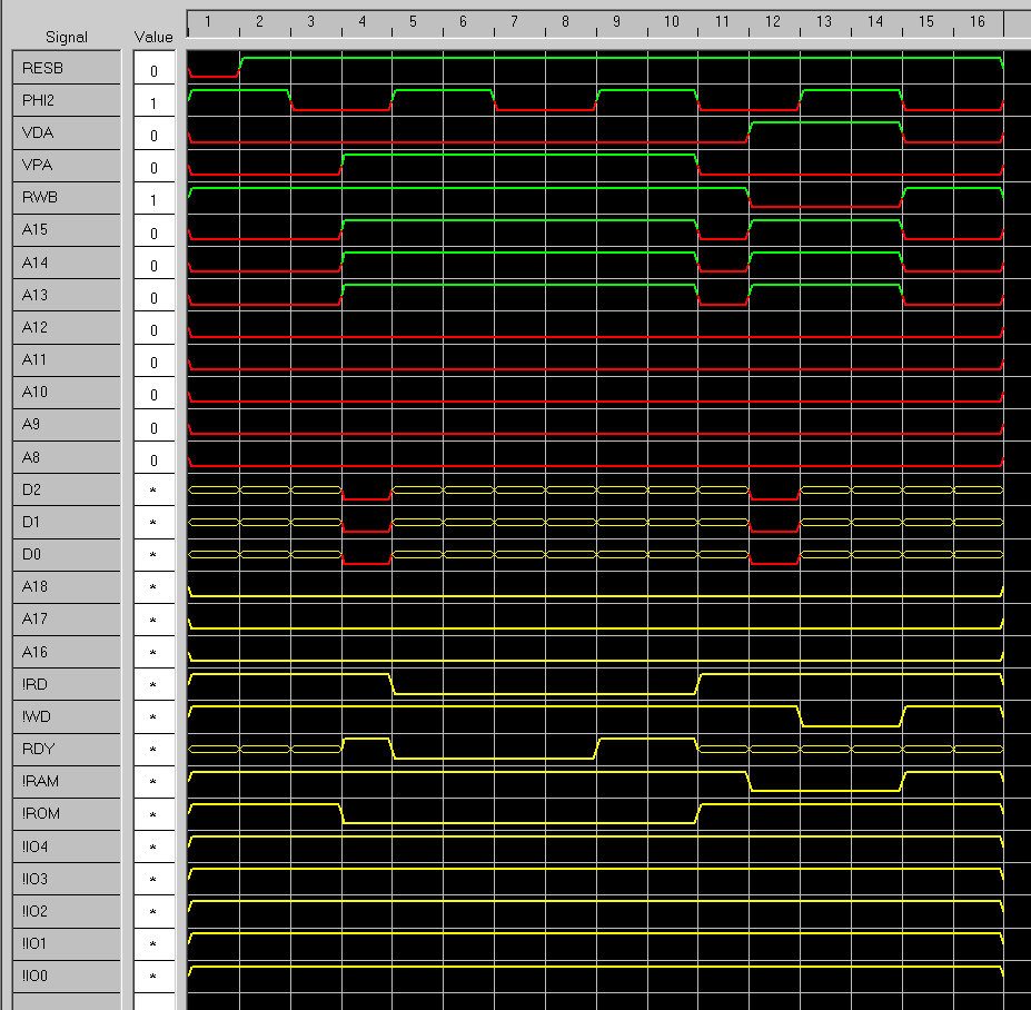

Here are some logic simulation results. Signals that are in yellow are manipulated by the simulator. Red and green signals represent inputs or outputs from devices other than the CPLD.
File comment: E-ROM & E-RAM Accesses
In the above, starting at vector 4 and ending at vector 10, a read access of E-ROM is made. Note the generation of a 1 cycle wait-state when ROM is selected. Note that D0-D2 are %000 during Ø2 low at vector 4, as the address from which data is being fetched is $00E000. It can be seen that the simulator has asserted the /RD signal, qualified by Ø2, and that the MPU's RDY input is negated for a full clock cycle, starting at vector 5. This is the wait-state that occurs on all ROM accesses.
At vector 12, a write to the same address occurs. As the logic causes a write on a ROM address to be directed to RAM, RAM is selected and there is no wait-state. Again, D0-D2 are %000 during Ø2 low at vector 12. Also note that the /WD output is asserted, as this is a write operation. As with /RD, /WD is qualified by Ø2.

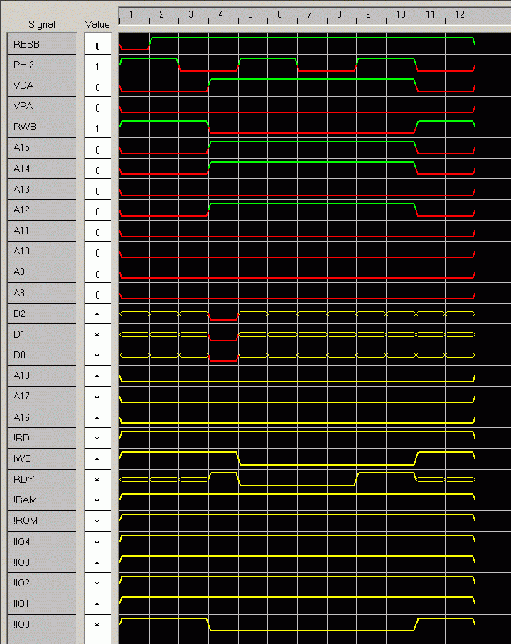

File comment: Extended RAM Accesses
In the above and starting at vector 4, data is fetched from "extended" RAM at $07FFFF. Starting at vector 12, data is written to extended RAM at $06E500. Note the conditions of the A16-A18 outputs during the operations.

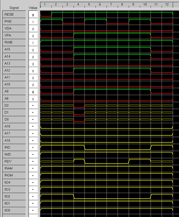

File comment: I/O Device 'C' Access
In the above, a read access on I/O device 'C' is performed. Behavior is like that of the previous simulation run, except a different chip select output is asserted and, of course, /RD is asserted instead of /WD.

MACHINE ARCHITECTURE & HARDWARE MANAGEMENT UNIT DEFINTIONS
           |       RAM (448 KB)       |
           |       RAM (48 KB)        |
                1 KB = 1024 bytes
  HMU
Register   Address   Register Description    Bit  Function
hmumcfg    $00DF00   System configuration:    0   0: I/O
                                                  1: D-RAM
                                              1   0: C-RAM
                                                  1: C-ROM
                                              2   0: E-ROM
                                                  1: E-RAM
Notes:  1) The default map following hard reset is C-RAM, I/O & E-ROM.
        2) An STZ instruction on hmumcfg sets the default map.
        3) Writing to C-ROM or E-ROM touches RAM at same address.
        4) The HMU is read/write & always present.
$DEFINE   dblkmap   hmumcfg0                      /* $00D0xx-$00DExx */
$DEFINE   cblkmap   hmumcfg1                      /* $00C0xx-$00CFxx */
$DEFINE   eblkmap   hmumcfg2                      /* $00E0xx-$00FFxx */
BURIED LOGIC DECLARATIONS
pinnode   = bank0;                                /* 1 = address is $000000-$00FFFF       */
pinnode   = basram;                               /* 1 = address is $000000-$00BFFF       */
pinnode   = cblk;                                 /* 1 = address is $00C000-$00CFFF       */
pinnode   = dblk;                                 /* 1 = address is $00D000-$00DFFF       */
pinnode   = eblk;                                 /* 1 = address is $00E000-$00FFFF       */
pinnode   = extram;                               /* 1 = address is $010000-$07FFFF       */
pinnode   = hmusel;                               /* 1 = HMU being accessed               */
pinnode   = ioblk;                                /* 1 = I/O address space being accessed */
pinnode   = iosel;                                /* 1 = I/O device being accessed        */
pinnode   = mcfgsel;                              /* 1 = HMU configuration being accessed */
pinnode   = ramsel;                               /* 1 = RAM being accessed               */
pinnode   = rdflag;                               /* 1 = data fetch in progress           */
pinnode   = rdyout;                               /* 1 = MPU wait-stated                  */
pinnode   = rhflag;                               /* 1 = data fetch on high clock         */
pinnode   = romsel;                               /* 1 = ROM being accessed               */
pinnode   = vbus;                                 /* 1 = address bus valid                */
pinnode   = vplatch;                              /* 1 = hardware vector being accessed   */
pinnode   = wdflag;                               /* 1 = data store in progress           */
pinnode   = wsflag;                               /* 1 = wait-state in progress           */
pinnode   = wsff;                                 /* wait-state flip-flop                 */
pinnode   = [blatch0..2];                         /* bank address latches                 */
pinnode   = [hmumcfg0..2];                        /* HMU hardware configuration register  */
REGISTER RESETS & PRESETS
$REPEAT i = [0..2]
    hmumcfg{i}.AR = !RESB;
/*    hmumcfg{i}.AP = 'b'0; */
$REPEND
vplatch.AR  = !RESB;
wsff.AR     = !RESB;
vplatch.AP  = 'b'0;
wsff.AP     = 'b'0;
INTERMEDIATE CONTROL LOGIC
phi1       = !PHI2;                               /* inverted system clock       */
vbus       = (VDA #  VPA) & RESB;                 /* true if valid address       */
rdflag     = RWB & vbus;                          /* true if fetch operation     */
rhflag     = rdflag & PHI2;                       /* true if fetch on high clock */
wdflag     = !RWB & vbus;                         /* true if store operation     */
/* vector pull stuff is experimental; it's not actually in use... */
vplatch.LE = !VPB;                                /* open vector pull latch      */
vplatch.L  = VPB;                                 /* indicate vector pull        */
EXTENDED RAM ADDRESSING LOGIC
Bits 0-2 of the extended address are captured during a valid bus cycle while
the clock is low.  In the event a wait-state is in progress when the clock
goes low the bank latches will not be disturbed.
[blatch0..2].LE = vbus & phi1 & !rdyout;          /* open latches         */
[blatch0..2].L  = vbus & phi1 & [D0..2];          /* capture bank         */
bank0     = [blatch0..2]:'b'000;                  /* 1 if bank is $00     */
extram    = !bank0;                               /* 1 if bank is $01-$07 */
MEMORY MAPPING LOGIC
basram    = (!A15 # !A14) & bank0;                /* true if $000000-$00BFFF  */
cblk      = A15 & A14 & !(A13 # A12) & bank0;     /* true if $00C000-$00CFFF  */
dblk      = A15 & A14 & !A13 & A12 & bank0;       /* true if $00D000-$00DFFF  */
eblk      = A15 & A14 & A13 & bank0;              /* true if $00E000-$00FFFF  */
ioblk     = dblk & !(A11 & A10 & A9 & A8);        /* true if $00D000-$00DEFF  */
/* RAM selection rules... */
ramsel    = basram #                              /* base RAM, or...        */
            cblk & (!RWB # !cblkmap) #            /* C-RAM if mapped, or... */
            ioblk & dblkmap #                     /* D-RAM if mapped, or... */
            eblk & (!RWB # eblkmap) #             /* E-RAM if mapped, or... */
            extram;                               /* extended RAM           */
/* ROM selection rules... */
romsel    = cblk & RWB & cblkmap #                /* C-ROM if mapped, or... */
            eblk & RWB & !eblkmap;                /* E-ROM if mapped        */
/* I/O devices selection rules... */
iosel     = ioblk & !dblkmap;                     /* $00D0xx-$00DExx if mapped */
/* HMU selection rules... */
hmusel    = dblk & A11 & A10 & A9 & A8;           /* $00DFxx, always present */
mcfgsel   = hmusel;                               /* configuration    */
WAIT-STATE LOGIC
wsflag    = (iosel # romsel) & vbus;              /* wait-state if I/O or ROM & enabled */
wsff.CK   = PHI2 & wsflag;
wsff.D    = wsff & wsflag;
rdyout    = wsff & wsflag;
CONTROL OUTPUT STATEMENTS
[A16..18] = [blatch0..2] & vbus;                  /* A16-A18 address bits       */
IO0       = iosel & !A10 & !A9 & !A8 & vbus;      /* I/O device 'A' select      */
IO1       = iosel & !A10 & !A9 &  A8 & vbus;      /* I/O device 'B' select      */
IO2       = iosel & !A10 &  A9 & !A8 & vbus;      /* I/O device 'C' select      */
IO3       = iosel & !A10 &  A9 &  A8 & vbus;      /* I/O device 'D' select      */
IO4       = iosel &  A10 & !A9 & !A8 & vbus;      /* I/O device 'E' select      */
RAM       = ramsel & vbus;                        /* RAM chip enable            */
RD        = rdflag & (PHI2 # rdyout) & !hmusel;   /* active low read            */
RDY       = !rdyout;                              /* MPU wait-state input       */
RDY.oe    = wsflag;                               /* active if wait-stating     */
ROM       = romsel & vbus;                        /* ROM chip enable            */
RST       = RESB;                                 /* inverted reset             */
WD        = wdflag & (PHI2 # rdyout) & !hmusel;   /* active low write           */
HMU REGISTER READ STATEMENTS
[D0..2].oe = mcfgsel & rhflag;                    /* enable output on D0-D2 */
[D0..2]    = mcfgsel & [hmumcfg0..2] & rhflag;    /* HMU bit pattern on D0-D2 */
HMU REGISTER WRITE STATEMENTS
[hmumcfg0..2].LE = mcfgsel & wdflag & PHI2;       /* open HMU latches */
[hmumcfg0..2].L  = mcfgsel & [D0..2] &            /* D0-D2 bit pattern on HMU */
                   wdflag & PHI2;
/* * * * *   E N D   O F   F I L E   * * * * */
The simulator says it will fly. Now I have to build it and hope the simulator is right!
Oh, the wonders of the Lord! :lol: The Atmel PLCC44 test rig adapter arrived this morning!
Of course, I have already reworked POC V2's design to add a JTAG port so I can program the CPLD in-circuit. However, having the adapter means I can program the CPLD externally, which is good for a first test, as it should eliminate the JRAG interface from the list of things that can malfunction. Once I'm satisfied that my CPLD logic is working I can try out my JTAG port to see if it actually works.
With the acquisition of this new adapter, I now have adapters for PLCC44, TQFP44 and PLCC84 CPLDs.
File comment: Atmel Test Rig PLCC44 Adapter
File comment: Atmel Test Rig w/PLCC44 Adapter Installed

LEDs, buttons, seven segment displays - you have everything!
 Post subject: Re: POC Version 2
PostPosted: Tue Oct 13, 2015 9:42 pm
Posts: 8505
I suspect those would be most useful when cobbling up state machines and trying them out. Each device adapter brings out all the signal pins for the relevant package, as well as directing many of them to the main test rig.

POC V2 is getting closer to being built. I've received all parts for it, except PCBs, the latter which will get ordered after I've completed a trial run on reflowing SMT parts, using a left over POC V1.1 board as the victim. I've also used the Atmel test rig adapter to program and verify an ATF1504AS CPLD, and it appears with the testing I did on the test rig that the CPLD is working.
The reflow trial run suffered a setback when the old Proctor-Silex toaster-oven I was intending to use went DOA on me. The main heating element opened up and when I looked into getting a new element, I discovered that the replacement was only slightly cheaper than getting a new toaster-oven. So a new toaster-oven is on the way and the old one is now in someone's scrap pile. :cry:
