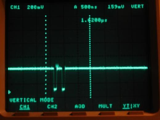

Spent almost 8 hours trying new troubleshooting angles. I'll keep it short and sweet.
Ohmed out each of the 54 pin TSOPII SRAM pins direct to the IC to negate bad soldering, or incorrect adapter spec's. No problem found.
Rechecked all wiring of the SRAM. No problem found.

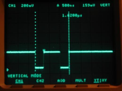

After many hours I started to focus on the copy software, and I tried to do a couple things... But my final little bit of software which finally did make itself onto the SRAM is below. I was able to run it @ 10MHz.
I was scoping out one of the MUX'd upper address lines (A14-A20), namely A14, since right now they are all hardwired to switch all low or all high. When running at EEPROM copy speed 2.5MHz, I saw a simple repetitive pattern. At 10MHz, I saw confirmation of the same pattern.
My problem is in the bank switching I know now. It is switching as shown below, but the timing must be off. It's not reading $0000 correctly. The scope pattern never changes when I try to lengthen or shorten the loop reading from $0000. For now I rest. Tomorrow a new day!
Banked A14 running from 200ns EEPROM, cpu@2.5MHz:
Banked A14 running from 10ns SRAM, cpu@10MHz:

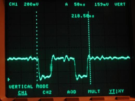

PostPosted: Tue Sep 07, 2010 8:16 pm
Not sure how reliable but it is running @20MHz from SRAM CPU @3.3V! If it runs @40MHz, I'll know if I've got issues. BRB
No luck @40MHz, thank you Jesus!
Granted it is a simple program, no ALU testing etc. But my address decode signals are good to that speed! I am using RWB with phase 2 to decode SRAM _WE
same as previous post but CPU @20MHz, and resized scope cursors for more accurate measurement. (not too accurate, I was too excited. I usually try to measure a square wave from "mid way lo to high on the rising edge" to "mid way high to low falling edge". This pic shows I was clearly off. Nonetheless the CPU was running)
EDIT #2: Added pic, and added how I measure, refixed measure.
As far as I understand it you're scoping the time between the STA $0000 and the LDA $0000: a write, three reads in ROM, and a read. What you're not measuring is the time for the actual loop, as the loop happens in the part that's "off-screen" on your scope.
Actually ... at 2.5MHz, 5 cycles should be 5 times 400ns, i.e. 2us, not 1600ns. It actually looks like you're measuring 4 cycles, two RAM accesses with 2 other accesses between them.
Anyway, try to increase the time base to include the loop. A loop with 32 iterations is about 160 cycles, which at 2.5MHz makes about 65us (or about 16us for 10MHz). Both times, 65us resp. 16us are too long for the scope setting in the included pictures. If you increase the time base to show at least one full iteration, you can then decide whether the loop works or not.
Even more, 200ns make 4 cycles @20MHz (cycle time 50ns). Maybe you should check whether your assembler optimized the "LDA $0000" to "LDA $00", i.e. from absolute to zeropage addressing. That would explain the 4 cycles:
0:   write $00
1:   read opcode "LDA_ZP"
2:   read parameter address "$00"
3:   read address $00
You should recalculate the loop timing with this in mind.

PostPosted: Wed Sep 08, 2010 4:21 pm
Brainfog is my problem. Like a long distance runner finally hitting the finish line, saying to himself I made it but so tired. I'm like that, but I still push on even further and I get brainfog. I'll explain, and Andre helped me in the brainfog moment.
The double dips in all the scope pics are the LDA $0000 and STA $0000 since I am scoping out the upper address lines going to the SRAM (A14-A20). My brainfog moment was incorrectly concentrating on the delay in between when they go low. I was busy on top speed measurements, and being so excited that I had finally had something working, I was focusing on the actual waveforms, not what was really going on.
Now I am correctly focusing NOT on the delay between the STA $0000 and LDX $0000, BUT ON THE DELAY BETWEEN LDX $0000 AND STA $0000. And @20MHz, this morning I found out it is indeed reading from $0000 correctly. As I can see on the scope, the time between both "double dips" is changing consistently when changing the value in $0000.
A few more tests/re-tests and I think I'll have it.
