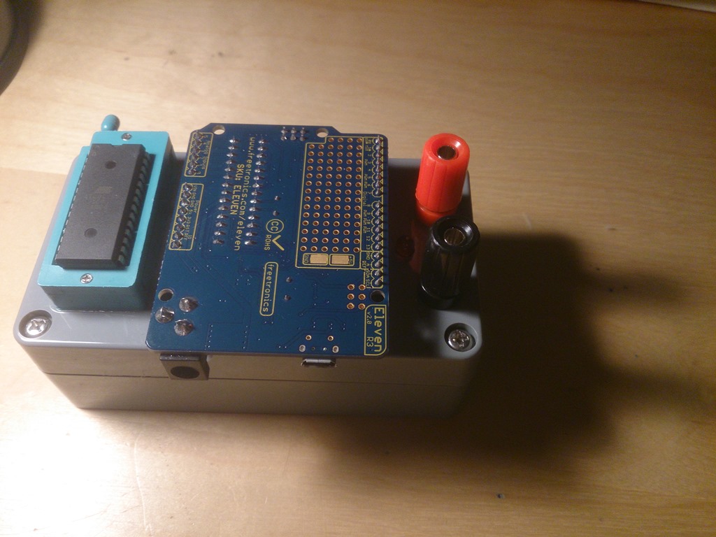

Wanted to share my results of the MEEPROMMER site; thanks again Mario! Programming those AT28C256's works like a charm. For some reason only v1.1 of the Arduino sketch works reliably though. Also I couldn't get the Java app to work (I'm running W10x64) so I am using Martin_H's windows app; works great so thanks to you as well Martin!
BTW I am desiging a SBC based on the TMS9900 CPU; it has a non-multiplexed 16bits databus so it's either adding multiplex logic or splitting hex files into even and odd bytes over 2 EEPROM's. I chose the latter and found a great tool that can do this split:
https://sourceforge.net/projects/srecor ... p_redirect
John

Posts: 8514
Hey! That's a nice-looking unit. Good job!
