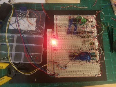

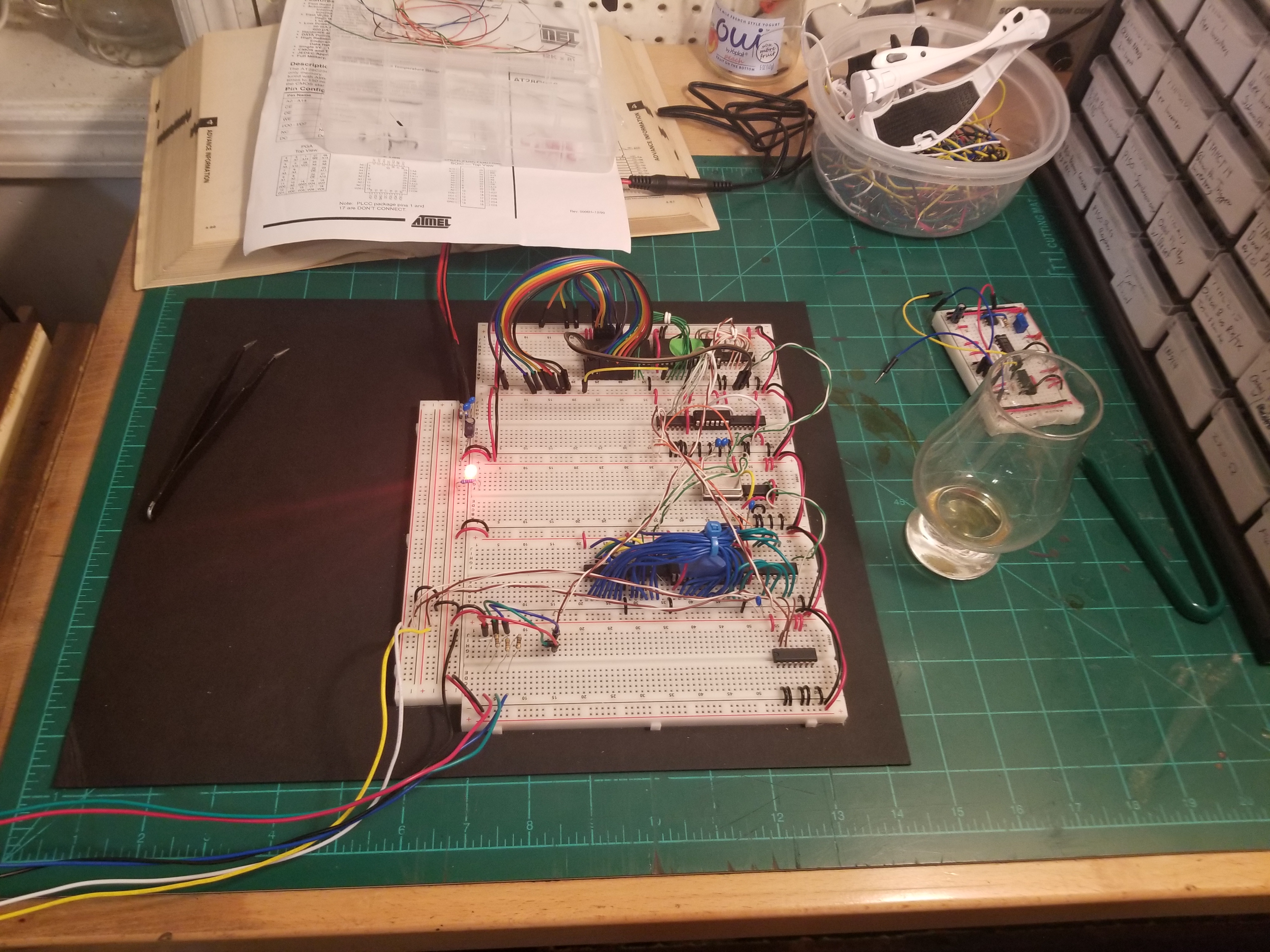

Merry Christmas, 6502 world! Here's a bit of Christmas Whisky and Wiring:
Is it a good idea to mix these two things? Well, at least today it did no harm!

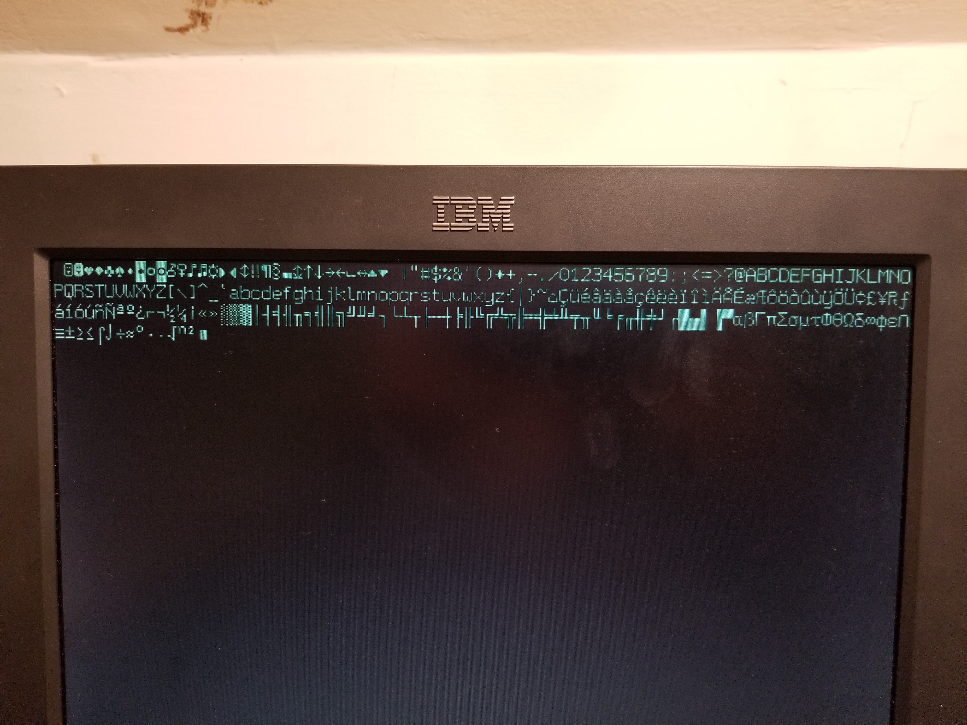

The project got *more simple* as I worked today. I kept going "wait, I'm not using that one for anything now, it came come back off!" The grand total, in terms of chip count, ended up being 9 ICs, a few ROMs, and a full-can oscillator. Here's where I landed:
I always start out tidy, but when I get into the thick of testing things I don't seem to be able to escape from the flying leads! O well. I did have to move the bypass caps back to the power rails. They were just getting in my way too much, and sometimes shorting out against IC leads. (Plus, they wouldn't fit over the ROMs or socketed ICs.) Still, it runs VERY stable now - I can poke it and prod it and jiggle the wires all I want and it doesn't react. Whee!
It's basically finished, in the sense that this is as far as I thought it out before I started building. The "framebuffer" EEPROM can be pretty trivially replaced with some RAM (the fast SRAM I have has an almost identical pinout). There are some immediate options for expansion. If you see that long green jumper wire going from the character ROM over to the left hand side of the top breadboard, that's the A14 line. Right now I just have two character sets in the ROM, and I can switch between them by manually moving that wire. But the ROM is 32k, so it can hold many character sets. I believe there are 3 address lines free for character set selection, so it could have up to 8. There are also some free frame-buffer address lines (3 there, as well), so I could maybe do some triple buffering. :lol:
I wonder how hard it would be to add some real terminal features, like a hardware cursor, to this. I think the next step is to sit down with a big pad and draw the schematic so that I don't lose the design if something bad happens to the breadboard! :shock:
