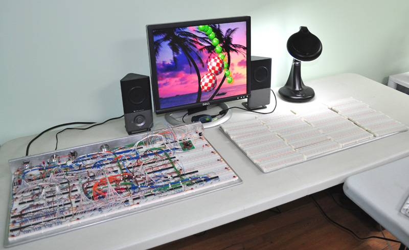

PostPosted: Sun Oct 04, 2015 10:10 pm
Posts: 690
Thanks again to everyone for the positive feedback on this project!
I never would have imagined that this thread would have even 1000 views!
I have made the last needed alterations to allow the 6502 to move into its new home.
All IO are 6502 compatible now, and the multiplexing system works as planned.
It was a bit of a challenge moving the IO from the freedom of AVR to the constraints of 6502, but it's all done now.
I had to add 4 more ICs to the board, mainly to isolate the Sprite & playfiled databus form the 6502 while they run.
Vulcan-74 now has 3 fully independent, yet bridgeable busses, each having 20 bit addressing and 8 bit data.
I also took this afternoon to hack out the other aluminum panel that will make the second massive breadboard for the sound processor.
The back panel will be drilled soon, giving Vulcan a few new ports; Audio (1/8" Stereo jack), and dual Joystick (9 pin C64 / Atari style).
Size matters when you prototype with 250 ICs!
Realizing that my computer desk was now too small to fit the dual board, I added another desk to my basement lab to make room!
Zoinks Scoob!... when placed side by side, the new Mega Breadboard is 56 inches by 15 inches in size (almost 6 square feet)!
Perhaps Guinness would put this one down as "The World's Largest Solderless Breadboard"? ..always fun to get in the record book!
Over the next bursts of free time, I plan on dropping in the 6502 and boot-loader so I can begin the IO testing under complete 6502 control.
Things are really starting to progress!

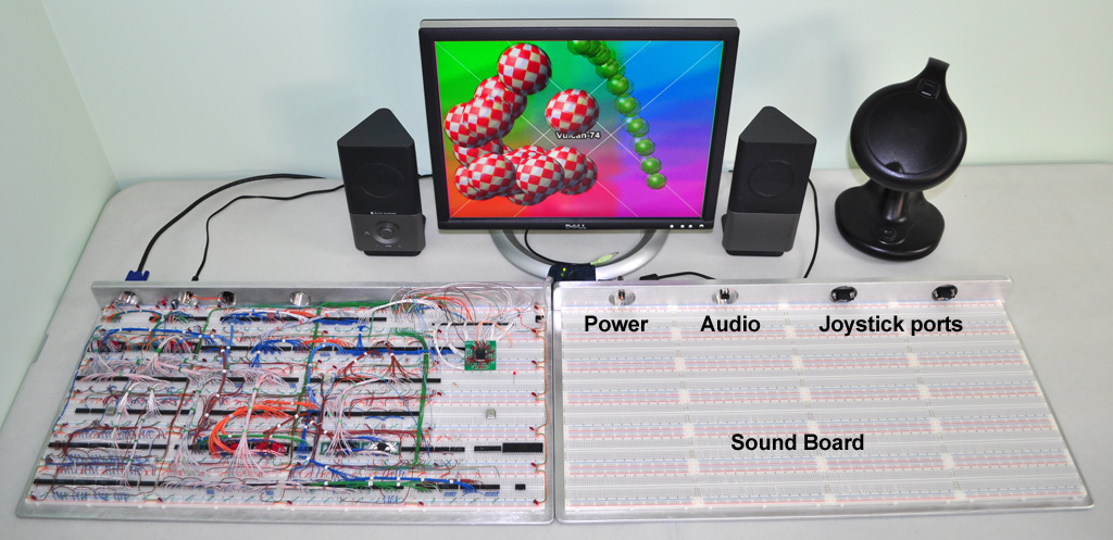

PostPosted: Fri Oct 09, 2015 2:45 pm
Posts: 690
The Vulcan-74 breadboard has now doubled in size!
The second board will contain the Sound Processor.
Because I ran out of room on what I thought would be a "large enough" board, I went and made another monster breadboard.
The new board will (hopefully) fit all of the ICs needed for the Sound Processor, and a the 6502 Boot System.
I may only be able to get 2 of the 4 channels installed, but that would be good enough, since they are all identical.
Who would ever need more than 48 breadboards???
... The same kind of freaks that need more than 640K!
Anyhow, I will be putting in the 6502 on my next free day.
Not sure about this weekend though... still have 5 cords of wood to cut and split, and its getting below zero at night out here!
Later!

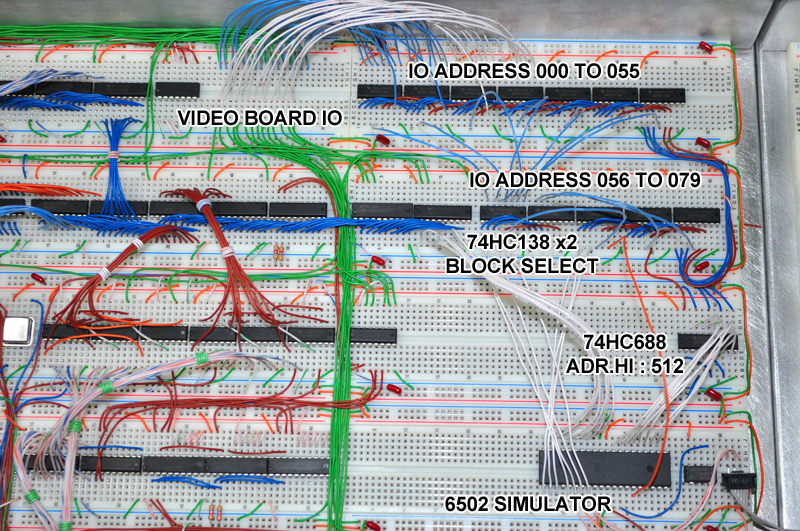

PostPosted: Mon Oct 12, 2015 7:04 pm
Posts: 690
A rainy day has given me some real time in my lab to rework the entire IO System so that it will be 6502 compatible.
Here is what was done today...
- Remove the XMega that was controlling all 30 individual IO Lines and the Address Bus.
- Add multiplexers to control up to 80 IO lines through 8 bit addressing (74HC138s).
- Add a 74HC688 comparator to detect the Hi Address value of 512 (6502 IO Page).
- Add 6502 style clock control to the multiplexer to only toggle IO during the Clock Hi Phase.
- Recode my entire XMega code to AVR ATmega to simulate the 6502 Address and Data Bus.
- Test the new IO System using the AVR 6502 Simulator code.
The IO System is now 6502 Compatible!
The AVR 6502 Simulator address the Vulcan IO System just like the 6502 will, using a 16 bit Address Bus, 8 bit Data Bus, and RW Line.
Just like the 6502, the AVR only assumes valid data send or read from the bus during the clock high cycle.
I will be basing my 6502 libraries on the AVR assembly libraries written here, as the assembly syntax is so similar.
At this point, RW is not simulated because there is no external program memory (64K SRAM) on the 6502 bus.
Because of the way the IO System functions, RW will only have the job of disabling the SRAM during mapped IO reads.
I placed my 80 bit mapped IO lines at address 512 to 592. 80 IO lines will be plenty to control all Video and Sound functions.
As usual, 000 to 255 will be Page Zero, and 256 to 511 will be hardware stack. Everything beyond 767 is program memory.
As soon as I tighten up the AVR assembly libraries, I am dropping in the 6502!!!
The AVR will remain ONLY to boot load the 64K program memory for the 6502 until my boot logic is completed.
So far, everything is working exactly as planned!
Cheers!
Radical Brad

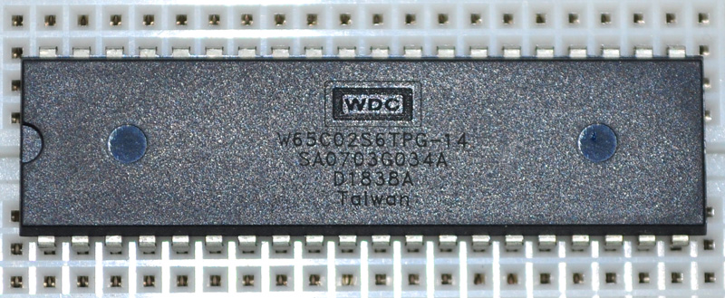

PostPosted: Wed Oct 14, 2015 12:38 am
Posts: 690
Look who came to the party!...
Now the real fun begins, as I have never used a 6502 beyond a basic RW test.
I am starting with a slow 4MHz clock and a 15ns 32K SRAM until I wire up another 10ns SRAM.
Initial testing will involve pre-loading the SRAM via AVR and then letting Mr. Peddle take the helm.
Will report back next time I have an hour to get it all wired up for a smoke test!
Radical Brad
