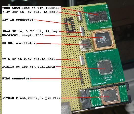

PostPosted: Wed Jun 16, 2010 7:10 pm
Well I went with the Spartan 2, and system voltage will be at 3.3V. The single most limiting factor on deciding on an operating voltage for this final stage, was the speed of the largest SRAM I could find. Large/Fast SRAM is top prioity for this last stage. I found 2Mx8 SRAM only in 3.3V. At 5V, the largest I found was 512Kx8. (The cost was $8 for the 512K part, and ~$40 for the 2M part. Quite a difference, but I am thinking ahead to very limited board space when it comes time to have boards prefab'd.)
Before, operating voltage was priority only because of the (incorrectly assumed on my part) limitations of my EEPROM programmer. I am now aware that it can burn a 3.3V device. This is the other reason I decided to make the whole system 3.3V. Although, this will limit the WDC65C02 to 14MHz...
Final speed of the CPU will depend on the max operating speed the Spartan 2. I am tapping the main Pulse Width 16-bit counter inside the FPGA for the CPU clock. I am shooting for a 12.5MHz CPU clock if the FPGA can run @100MHz. If it can't run that fast, I'll have to settle for 80MHz, and a 10MHz CPU. Either way, the Spartan 2 will be running 8x faster than the CPU and I think there will be alot of room for some interesting possibilities...
I am going to try some custom opcodes to address the 2Mx8 SRAM and 512Kx8 EEPROM. Instead of an LDA/STA to bank registers, 2 "unused" opcodes will be "read" into the bank flip flops using the: SYNC signal, an 8-bit magnitude comparator, and the Phase 2 Signal to control a 2-bit counter. Thanks to Dr. Jefyll for his help on his thread here: viewtopic.php?t=1556, all detailed info about my use of mod'd opcodes will be posted there.
I am currently in the process of re-inputting the schematic for the FPGA. Here within the next couple weeks, I hope to have something working.
(In hindsight, now that the system is @ 3.3V, I maybe should have used the current Spartan 3 family in 100-pin VQFP... Still, the Spartan 2 is 5V I/O tolerant. It may be useful for something in the future...)
Here is what I have assembled so far in this, the last! chapter:

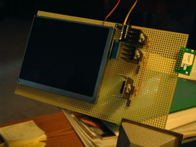

PostPosted: Wed Jun 30, 2010 8:47 pm
Virtex 2 would probably be a nice choice for a 6502 on FPGA, since no logic level converters are needed... Although, I can't find any!
I received the new NHD 5.7" 640x480 display yesterday, so I was able to finalize socket positions and start wiring it up. Today I completed wiring: the 12V-in connector, the 5V, 3.3V, and the 2.5V regulators. The heat sinks are from old circuit boards. They may be overkill, but I prefer large safety margins. The 12V-in connector feeds the 5V regulator. The 5V reg feeds the 3.3V AND the 2.5V regulators. All tested OK...
Next step is bypass cap's and power connections to all IC's...
Like the last display unit I received from NHD, it is factory jumper selected for an 8080 style interface. The soldered jumper is easily changeable to 6800 style interface as shown here thanks to NHD: http://www.newhavendisplay.com/forum/vi ... ?f=6&t=356
Question: Should I stay with .1uF bypass cap's? I've seen the formula's saying to use bypass cap's in the nF range. I'm not comfortable with that. I can see maybe .05uF, instead of the .1uF I have been using.
A pic of what has been assembled so far:
EDIT: Grammar, spelling.
Last edited by ElEctric_EyE on Thu Jul 01, 2010 12:47 am, edited 2 times in total.

 Post subject:
PostPosted: Wed Jun 30, 2010 9:56 pm
Posts: 8460
If capacitors were perfect and you did not have significant stray inductance, then .1µF would always be better for bypassing than .01µF. Common hobbyists' projects typically have a lot more stray inductance (mostly from lead length) than SMT production stuff though, so they'll get better high-frequency bypassing with the .01µF. In many cases, if you want to increase the capacitance, you'll do better putting a few .01's in parallel than using a .1µF. There was some discussion of that here.
