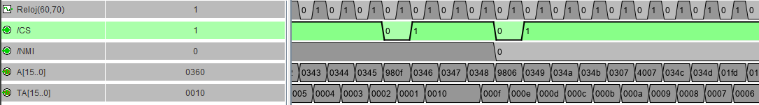

I've been testing and testing today, both with a C64 and with the SBC6526, and I've narrowed down all issues to two.
The one we already knew about, TIMERB bug has spreaded to all other interrupt sources. Good this is, as I have to fix it for TIMERA, I will have the option to fix it for TIMERB if needed. I still need to figure out exactly how it is happening, but I'm planning anything to have a quick way of activating/deactivating it on the CB.
Second issue, has been a bit more elusive. One of the tests I am running is testing for TIMERB counting TIMERA and then measuring how and when reloads and interrupts happen.
The test starts CIA1 timer A at 0x00FF. CIA2 TIMERA at 0x0013 and CIA2 TIMERB at 0x0007.
When TIMERB underflows and triggers an interrupt, CIA1 TIMERA value is compared against known good values taken on a real CIA.
In between, and before the interrupt arrives, TIMERB is sampled too to verify reload. There are around 1200 values checked on this tests. The 74HCT6526 passes all of them, except one.
One!!
When TIMERA is set to 0x0010 and TIMERB is set to 0x0000, it fails.
With this setup, TIMERB underflow is triggered when TIMERA underflows (maybe next cycle, I need to check). The peculiarity of this test is that, the loading of TIMERB happens more or less at the same time has to fire. Right on the same cycle, maybe one cycle later or sooner.
The end result is, on a real CIA, the interrupt is missed. On the 74HCT6526, it fires, so it arrives 0x0010 cycles earlier. For a real CIA, we need to wait for another TIMERA underflow.
Test does not fail with TIMERA at 0x0011 or 0x000F, only at 0x0010.

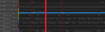

Wrong!
After a couple of days spent with the logic analyzer, I've positively identified the problem. When a ForceLoad is issued to a timer, when counting anything other than PHI2, if the ForceLoad is done one cycle before the timer underflow, the underflow is missed, and so is the interrupt.
On the left of the red bar, is a real 6526, on the right, the 74HCT6526. The cycle highlighted in red is the cycle next to the forceload command. You can see /CS going down the cycle before, with the register 15 selected (Control Register B). TimerB output is active on PB7, and even though a ForceLoad was done, the underflow takes precedence. A Timer pulse is sent, and this also triggers the interrupt.
However, on the 74HCT6526, no TimerB pulse is present on PB7, so no interrupt either. We need to wait to the next TIMERA underflow 0x10 cycles later to trigger a TimerB underflow, and then, the interrupt.

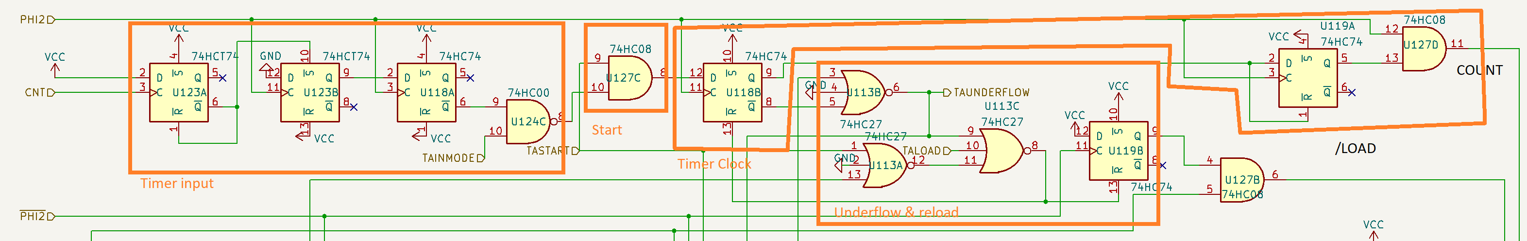

The issue comes from the "underflow&reload" segment of the timer pipeline.
Oddly enough, the underflow triggers on my Logisim model.

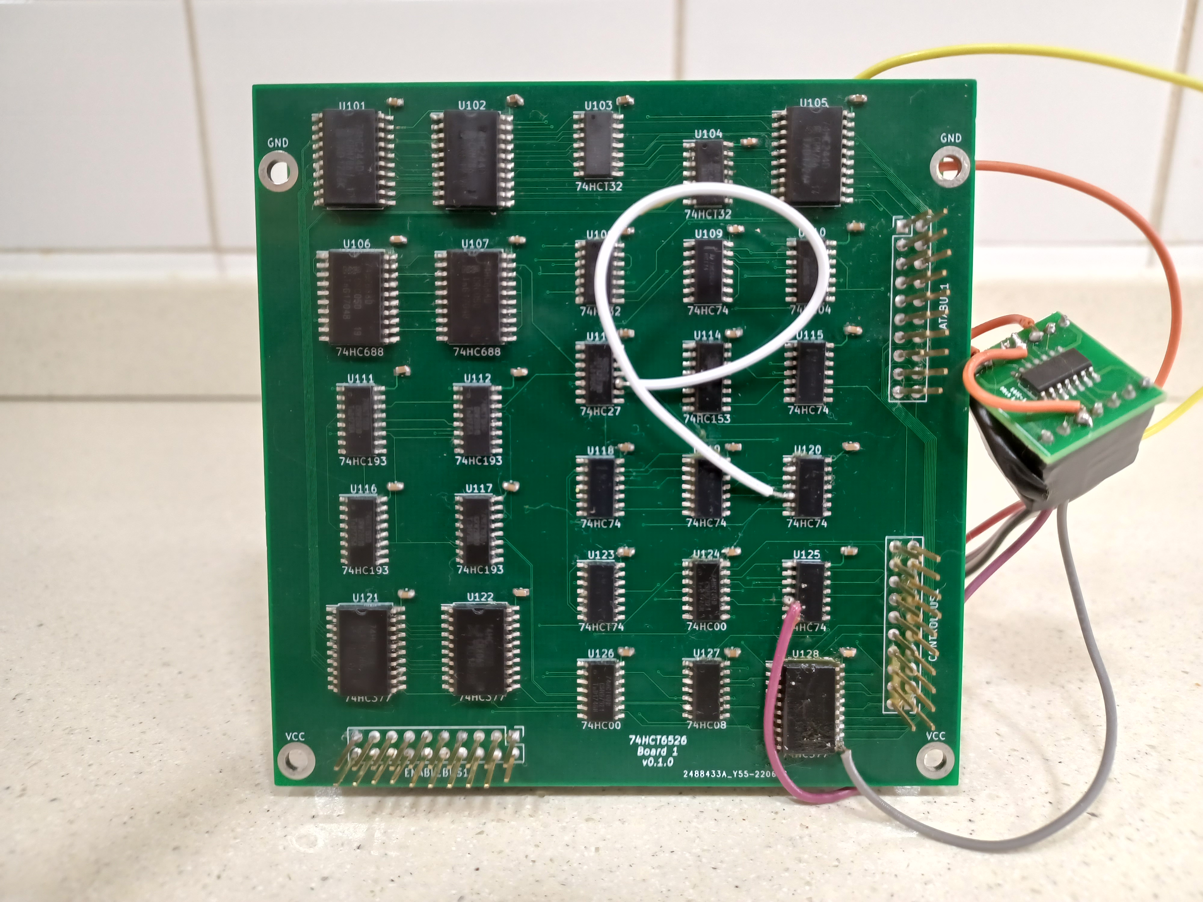

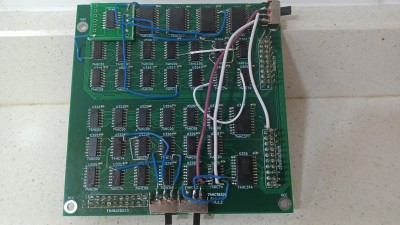

Hi everyone. I'm back to "work" after a mandatory two months break, due to some family stuff going on (Nothing bad! Some good stuff actually, that needed my attention for some time).
And today, I bring a story of failure and success. I left here:
Right before this little break, I found a possible solution to this issue that worked, at least on logisim. In order to create the counting pattern found in the timers, (Remember, no 0 is ever read, but on reload, the starting value could be read twice : 4-3-2-1-4-4-3-2...) Whenever an underflow happens, a clock is removed from the pipeline the very moment the reload is triggered.
However, this same clock was being removed on any timer reload. If timer is stopped, a write to THI triggers a reload. This is not a problem as the timer is not running here.
Also, when a ForceLoad is issued, the pipeline was also cleared, and this, is what's preventing the interrupt to fire. So by not resetting the pipeline on a ForceLoad, the issue should be fixed.
The only downside is that this requires ForceLoad to be delayed one cycle, requiring a new FF.

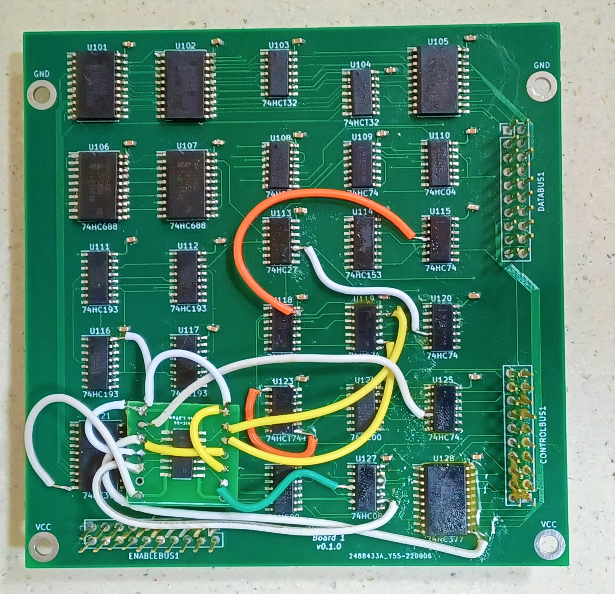

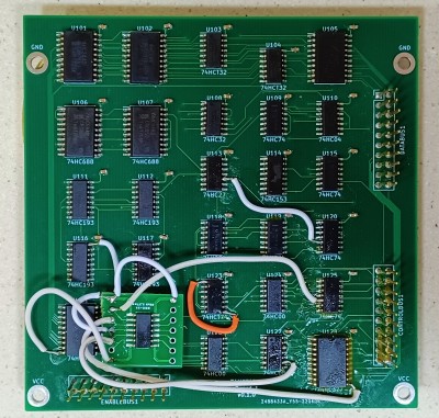

Back from the break, I devised a way to upgrade my current B1 Board from its current form (v0.1.1) to the version with this fix included, (v0.2.1).
This is how the board looked before starting the conversion. There's already an extra FF hanging from the board, with the second FF on the IC used by another fix in the ICR... So ugly!
Much better now. This is in fact the same version as before, but with a dedicated 74HCT74 for B1. I also tidied up the wires on the board.
And the, the final version, with the second FF added to delay ForceLoad, and with a few cut traces and bodge wires to amend my problems.
Now, time to test comes.... and with it, a sounding failure.
I first tested the full stack on my SBC6526. All good, hopes are high. Time to test on a C64... and boom. Nothing works. The whole stack misbehaves. Failures are intermittent. It kinda works... for a few tests then everything falls apart.
All the work has been done on B1, so I removed all the bodges, reflow all the ICs, added and rechecked all connections... and I was getting the same misbehaviour!
After two days of headbanging against the walls and no progress... I decided to give the board a deep and nice cleanup. All the works I've been doing, there was flux all over the places.
Unexpectedly, everything worked. It seems all the flux on the board was adding enough resistance that the LS logic in the C64 was not able to handle it, but all the CMOS parts in my SBC could.
So... clean your flux! That was two days lost! Shame on me!
But after the clean up... the success. With all the changes to B1, everything still is as cycle accurate as it was before, which is amazing. I still have the issue with the missed interrupt, just because it's TIMERB the one skipping it. I chose to make the changes to TIMERA first, as the board was already heavily modified.

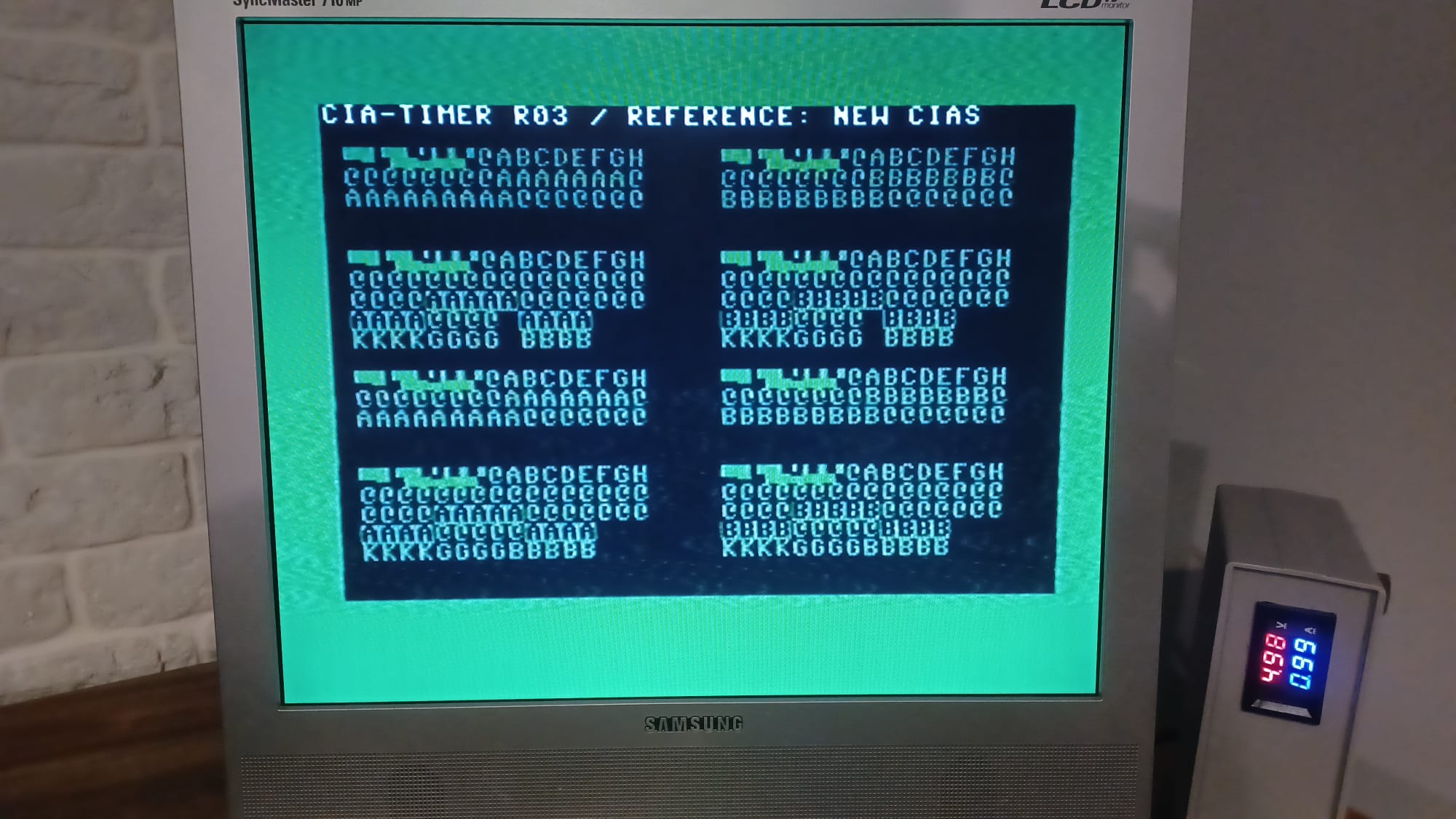

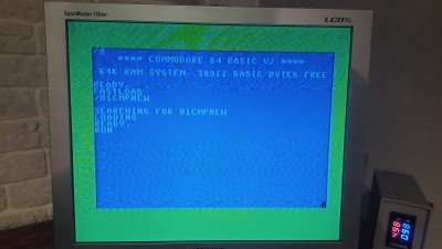

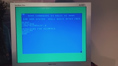

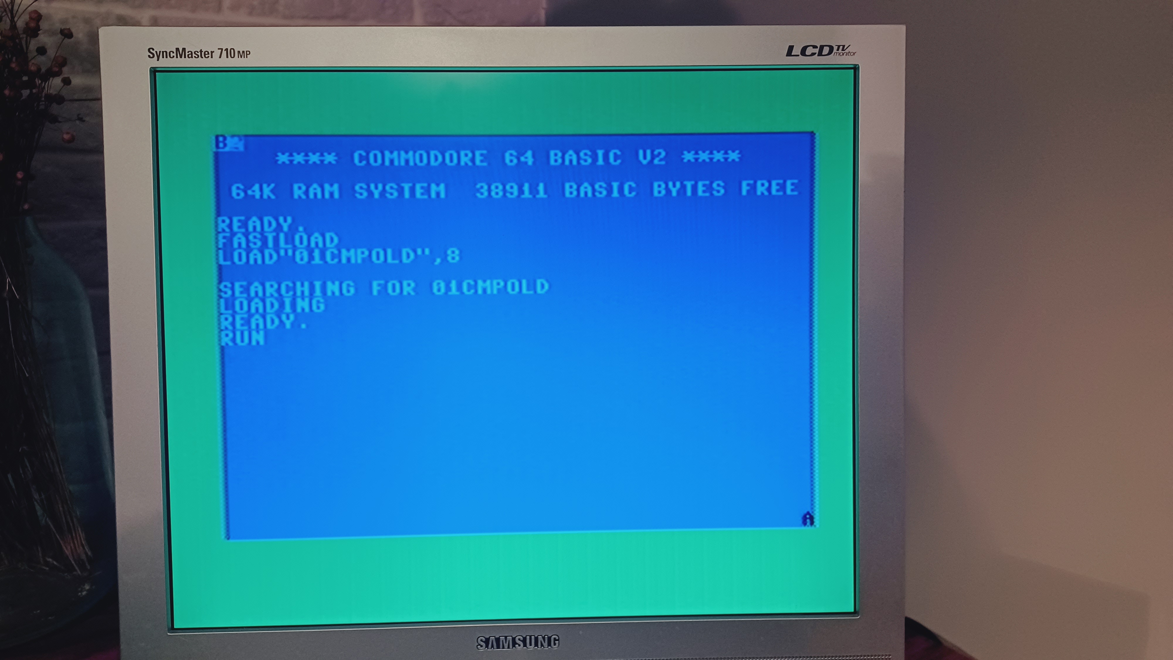

This, even though it may not look like much, is the first test of the CIA test suite succeding. Yesterday, with all the test I did, there was something that was bothering me, a lot.
One of my unit test for the timers involves ForceLoad. I start the timers, issue a forceload, and stop the timers. Then I read the value in each of the timers. This way, I measure if the ForceLoad happens right when it should (previous tests have already proven that start and stop are accurate).
Even though both timers are the same (At least, regarding this test) TB was stopping one cycle late.
Why? Well, during my board surgery this weekend, at some point I cut the wrong trace! Duh! After repairing this trace, and cutting the proper one... the test succeded. Remember, this is running both timers cascaded on very tight loops (TA = 0x13, TB=0x07) and after each test, values are decreased until TB=0x00. Tests checks for read values on small loops, and also the cycle when the IRQ fires for TB. I still have plenty of tests to run but, this means, that I'm probably cycle exact. With no "but"s or "if"s this time.
I will now consolidate this fix on my schematic, and v0.2.1 will be released with it.

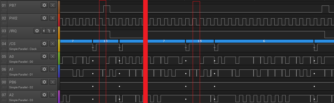

After getting close and personal with CIATEST 02, I've managed to get one step closer to full cycle-exactness.
The test starts Timer (both a and b, it test both) in a sort and tight loop 0x101 cycles. The test loop seems to be 0x102 cycles long, so each cycle, the timer underflows one cycle earlier.
The test is run twice per timer, with IRQ enabled, or with IRQ disabled. With IRQ DISABLED, ICR is read twice in rapid succesion, and the results print to screen. (@ for 00, A for 01, B for 02). Test on the right is TA, on the left, TB.
So it seems, my ICR0 and ICR1 bits are now cycle exact! This is OLD cia behaviour. For NEW Cias, TIMERB has same behaviour as TIMERA. The difference comes not for the bit set, but from the bit reset. In OLD CIA, TIMER A is resetted one cycle before TIMERB is after reading the register.

IRQ signal follows ICR7, so NEW6526 fires the interrupt one cycle earlier. (It's actually half a cycle earlier, but for all purposes, it's one cycle earlier for the CPU)
So I have 3 switches on board to flip this 3 bits one cycle ahead or behind. In the final release, I will probabley have a quad 2-input mux (74HC157), so I can select all of them with a single switch.
Now, let's go back to earth.
Not everything is cycle exact. SDR fires a bit earlier on my design. And TOD, (Still not ordered) will definitely be different. But with the Timers, and the interrupt register being 99% exact, I think some little celebration is in order :)
This last changes are not committed to the repo, they will be shortly. The plan has not changed though. There are still quite a few tests to run, before I can confirm I'm done with this.
But I'm so close.... almost there... :D
