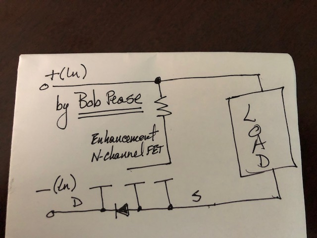

The famous Bob Pease once described a circuit for reverse polarity protection using an N-channel Enhancement Mode MOSFET. The circuit was something like that one I sketched in the attached figure. Search EDN Design Ideas/Electronic Design for the article.
File comment: Bob Pease MOSFET-based Reverse Polarity Circuit

That's a great idea, although I might be inclined to use a P-channel MOSFET in the positive instead, because with everything in a system being ground-referenced, it would be too easy to have a connection somewhere else bypassing that N-channel one.
The world of electronics sure lost a valuable giant when he was killed in a car accident! I've kept many, many articles of his that I cut out from industry magazines.
