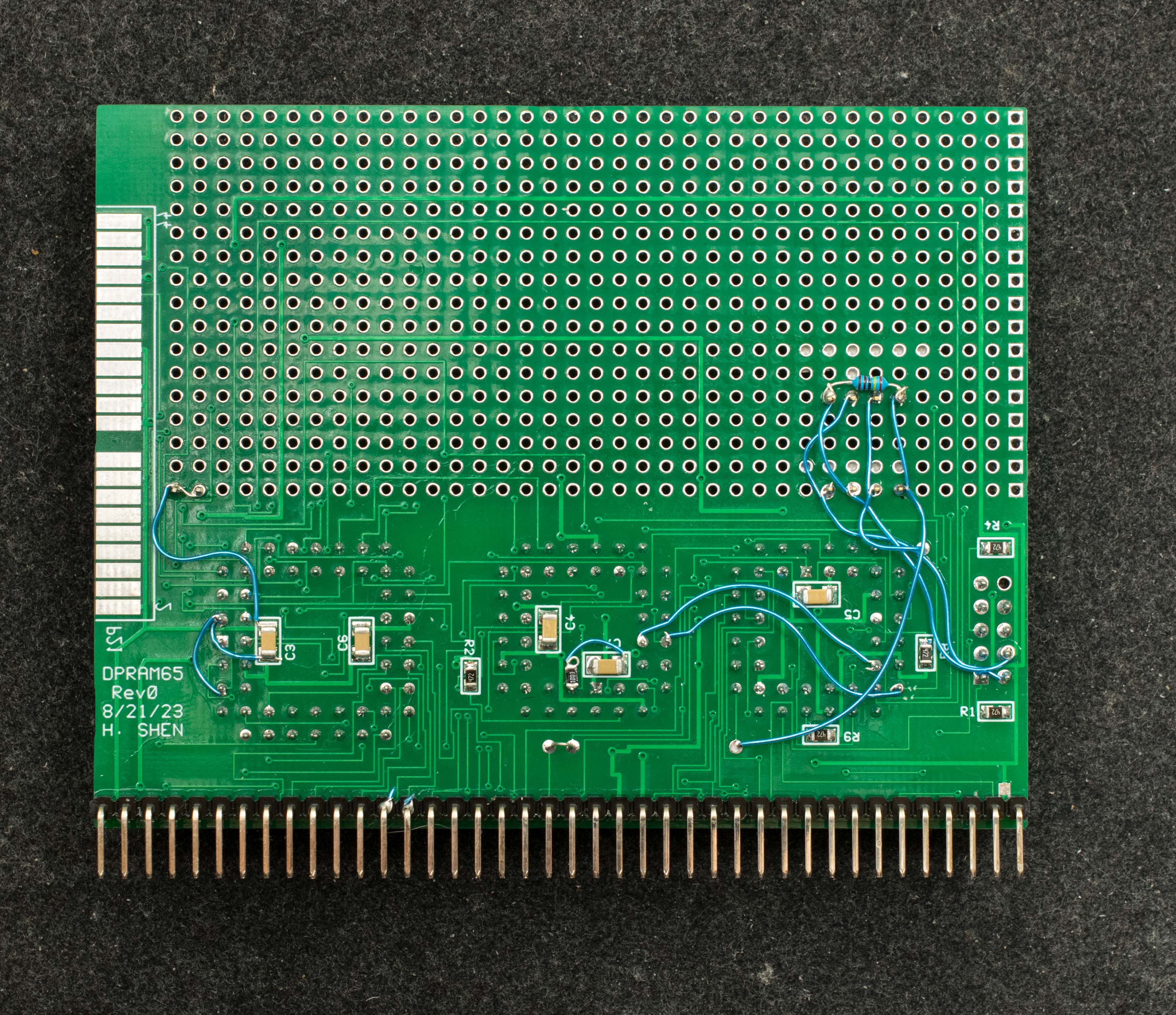

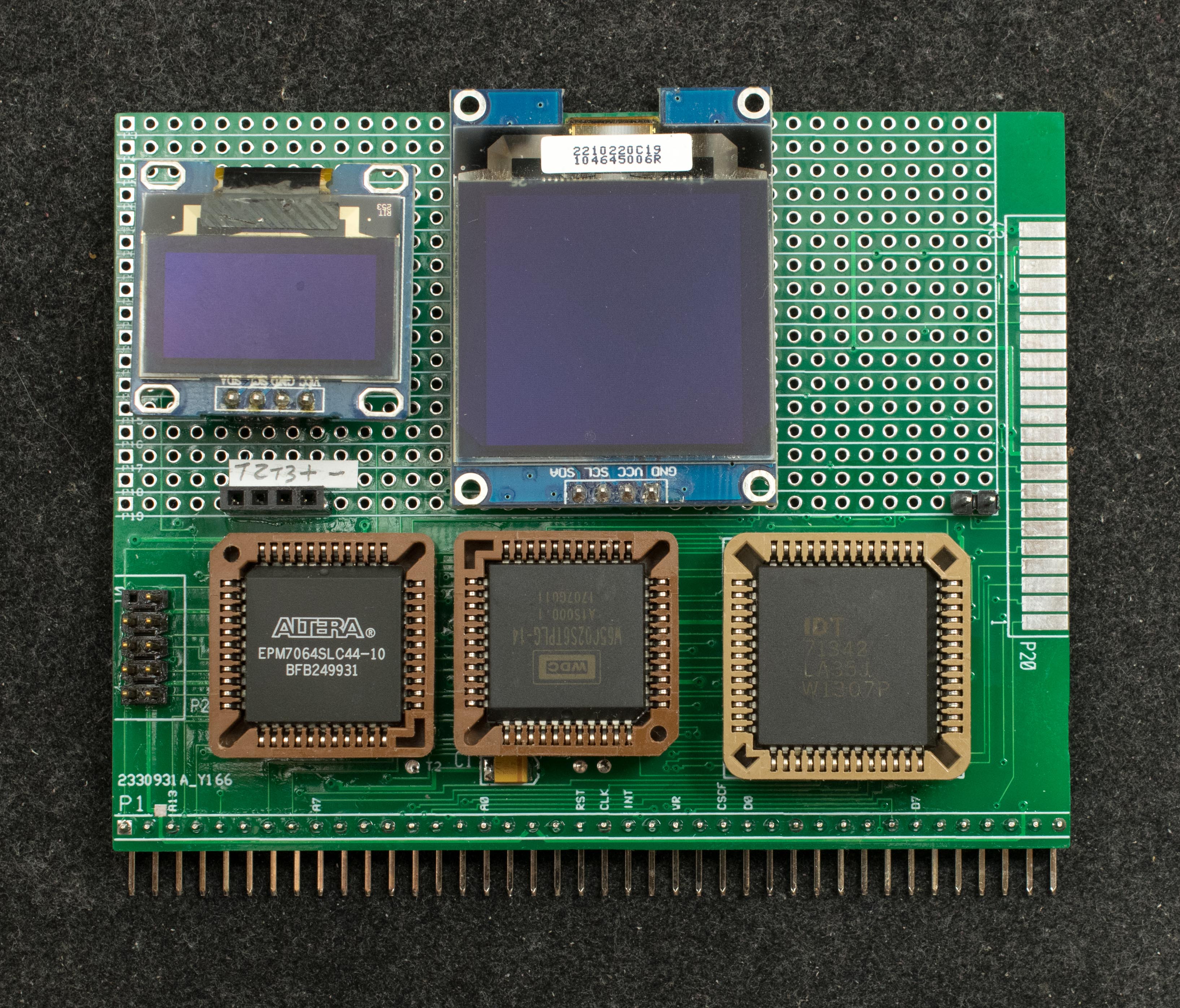

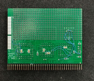

I want to do a few real world applications to find out how well this dual-port-RAM coprocessor concept works. Well, there are lots of room for improvement. In the pictures are the 2nd board I built because the first board doesn't quite fit mechanically. There are more problems than mechanical; I'll describe them later in this post.
The first application is a bit-bang I2C display. It seems to make sense for the coprocessor to handle serial protocols like I2C, SPI, NeoPixel, audio, etc. I have two I2C displays, the left is 0.96" 128x64 that needs 1K of data to fill the screen; the right is 1.5" 128x128 4-bit grey scale display that needs 8K of data to fill the screen. Both displays are persistent so they don't need to be refresh constantly. They both use I2C protocol, but annoyingly the pin definitions are not the same--the power and ground are switched. So I have two headers for these two displays. I want to start off with Game of Life, then BadApple.
Back of the board shows lots more rework than I've thought for such a simple I2C interface. I have plenty of logic in CPLD, but I'm pin-limited so there are cuts and jumpers to free up some pins. I discovered to my chagrin that I only designed in one clock input. I really should've separate clock for two sides of the dual port RAM so the coprocessor can run at different clock. Right now the coprocessor is running the same 14.7MHz clock as the main processor.

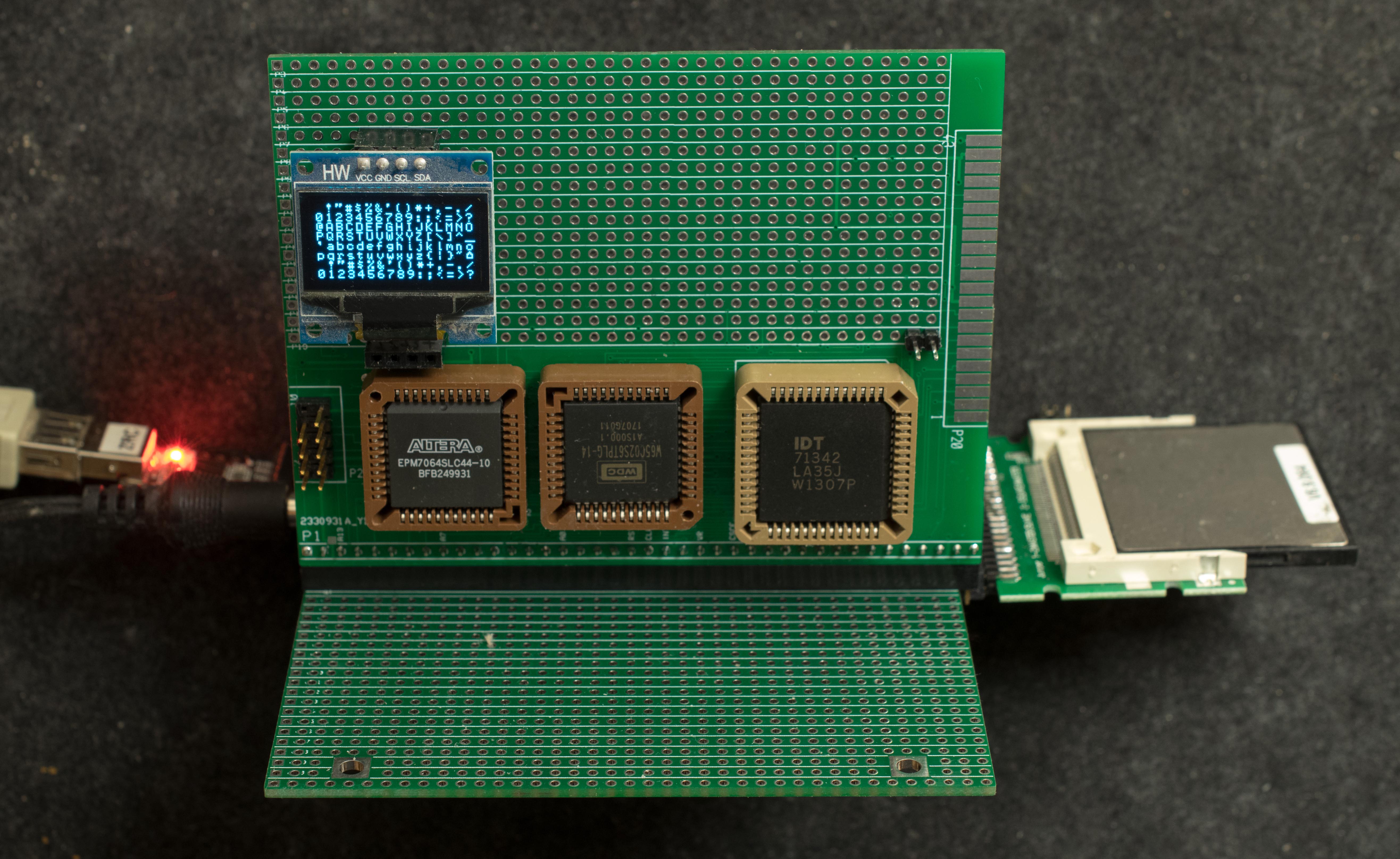

This is a small program running in 6502 coprocessor that bit-bang the I2C to display an image on 128x64 OLED display. The coprocessor is hosted by CRC65. I load the program to CRC65's $E000-$E700 which is also accessible by the coprocessor side at the same addresses. Coprocessor is initially held in reset until CRC65 wrote the reset vectors and interrupt vectors to $EFFC-$EFFF. There are 2K region, $E800-$EFFF that CRC65 and coprocessor can communicate with each other, but I'm not using them in this program.
