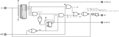

Most likely you'd need A3 to actually be in an external D flipflop rather than in the counter. You could try to do the trickery you mentioned, but you also want A0-A2 to count up at the same time, which is obviously very complicated and the whole point of using the counter is not to have to do that!
I decided to try your idea of using an external D flip-flop and it worked pretty well. It replaces A3, '163 drives A0-A2, and the rest of the circuit is implemented according to my equations.
It fits in 4 chips with no spare gates remaining:
- '163
- '02 quad 2-NOR
- '10 triple 3-NAND
- '74 D flip-flop

Andrew, isn't that '74's set input tied to the wrong rail? It sets/clears asynchronously on low, I think.
PostPosted: Fri Nov 03, 2023 8:26 am
Posts: 8504
Good observation.  /SET, also called /PRE, has to be high in order for the Qs to respond to inputs.  Ditto for /CLR.
PostPosted: Fri Nov 03, 2023 9:59 pm
Posts: 163
Location: Lviv, Ukraine
Neil, BDD - thanks for catching that! I was not aware that /PRE & /CLR are low-active in '74, since the software that I'm using ("Digital") has D triggers with active-high inputs. Luckily, seems like the timings in my schematic are OK even with inverted /CLR, as long as /SET is tied high when used with real '74 as you mentioned.

Andrew another consideration is the reset being asynchronous, does that place some constraints on the timing of /WSE? It may not be a problem but its worth being clear about.
PostPosted: Sat Nov 04, 2023 1:28 pm
Posts: 163
I don't think that's a problem, since the sole purpose of resetting the first D flip-flop is to prevent Q'3 from counting when /WSE is inactive, which only has effect on the rest of the circuit every 8 cycles. The flip-flop is cleared by MPU releasing /WSE or '163 overflowing, so they can safely occur in any order (since they both set it to 0).
I've also noticed that reset input did need inversion to be fully compatible with '74, so here's the updated schematic:

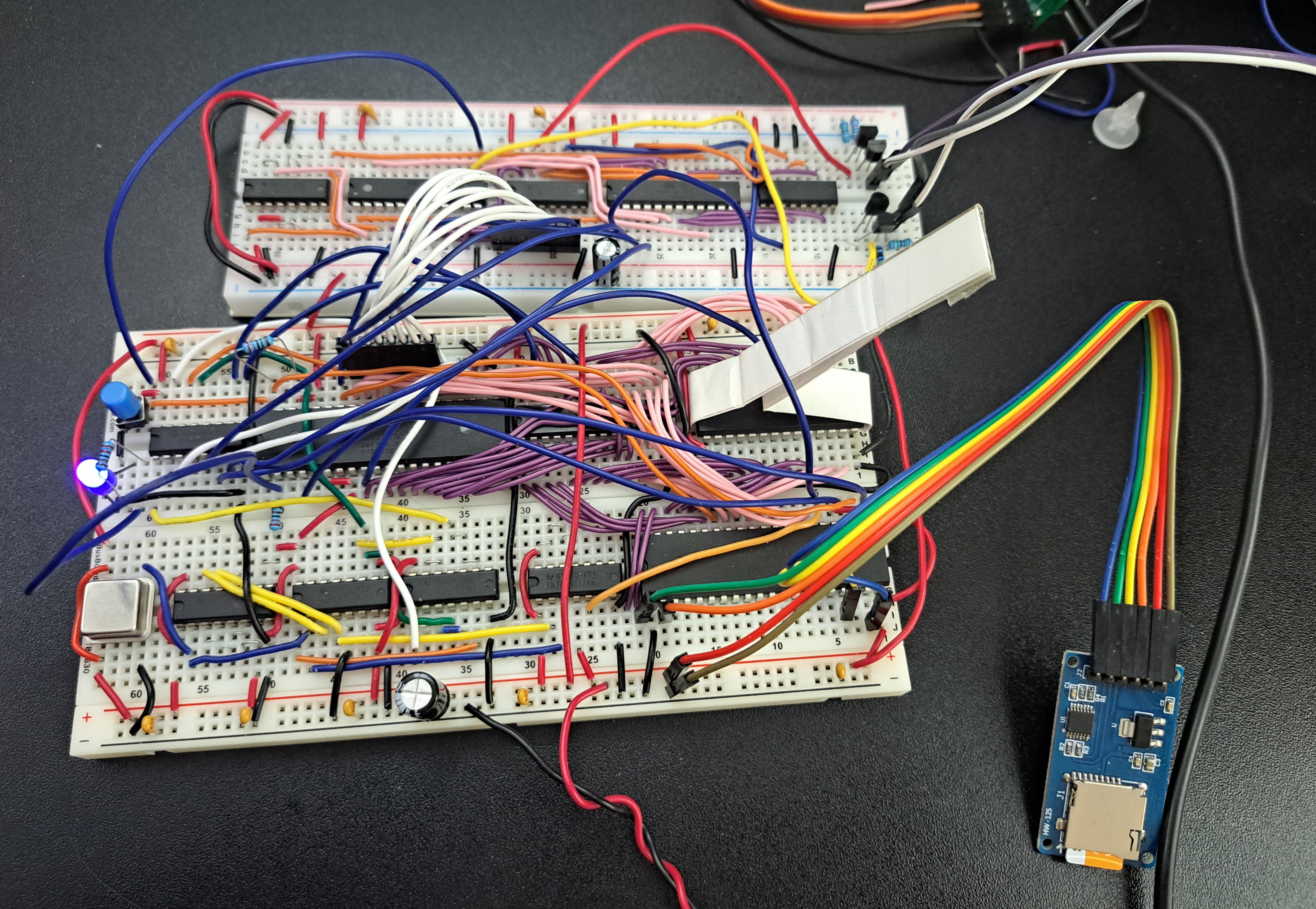

A little update on this - I have actually been using the little test system I built (see schematic in my first post in this thread) quite a bit recently, for general 6502 experiments. It is running very well, at 16.384MHz, on solderless breadboard - consistently passing all the Dormann tests running repeatedly in a loop. This is the version that only divides the CPU clock down by 2 for slow device access, so the 65C22 VIA is running at 8.192MHz, and I think the ROM is also accessed at that speed.
When I first built the system it had some problems, but it was once again due to poor signal integrity. Some operations on certain addresses would occasionally corrupt other addresses - the specific case I found was repeated operations on $00FF sometimes causing $01FF to get set to $FF. It is odd how rare yet specific these failure cases can be - in a loop cycling through different values, it seemed to only ever fail when the value being written to $00FF was $80 or $40, and regardless, the value written to $01FF in error was always $FF. The same test applied to $00FE and $01FE didn't fail. I remember a similar case occuring with my "Fast PDIP" system a few months ago, which in that case also only happened for certain CPU instructions.
The cause, this time, was that the ground pin of the 65C02 had to take a really long route around the breadboard to get to the ground pin of the RAM. It just goes to show how important signal return paths are, even in the relatively uncontrollable environment of a solderless breadboard.
I've now used this system for various experiments - PS/2 keyboard interfacing to the 65C22, experimental new SD card routines for NormalLuser, and a few other things. It was only meant to be test circuit, but it looks like it will be a more permanent fixture now, and perhaps deserves a bit of tidying up.
Here it is with a serial board and SD card module attached. The blue LED lights when RDY is high, which is a nice way to show activity; if the program uses WAI in a loop to wait for interrupt-driven I/O, or STP when it's finished, then the light goes out.

I misremembered how the circuit works, and got the CPU clock speed wrong earlier - it's actually half of what I originally said, so I've edited the past. Not as amazing, but still nice and stable!

I tried some other crystals and it worked well up to about 20MHz CPU clock speed, 10MHz ROM/VIA/Serial clock speed. Above that I suspected the slow clock was too fast for the ROM, so I upgraded the circuit to the one from my second post, where the slow clock is a quarter of PHI2. This worked well and seems stable up to 28MHz CPU speed, judging by memory test and Dormann test results - so I think this divide-by-4 clock stretch design is fine too. The tests failed quickly at 30MHz, so overall this is comparable to what my "Fast PDIP" system managed on a breadboard.
