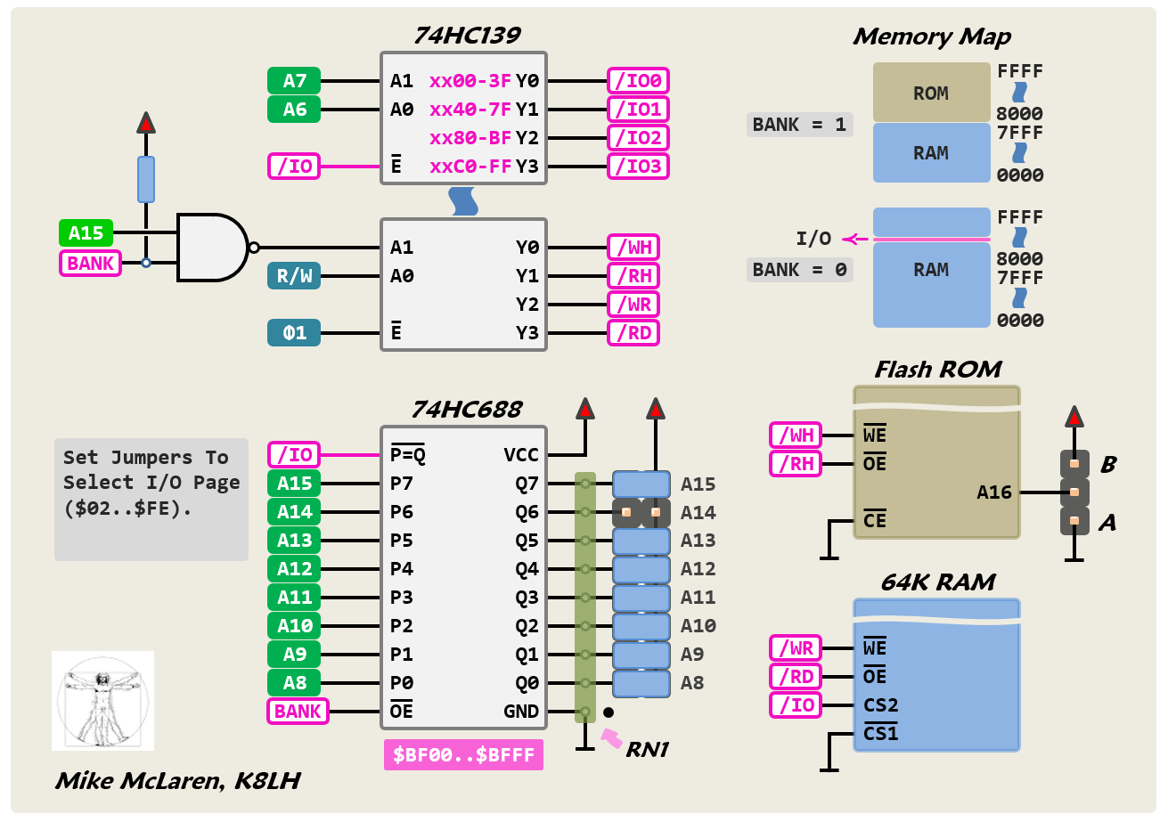

BTW, if your design is meant to copy ROM to RAM and then map out ROM first thing then the following variation allows for inserting an I/O page anywhere in address space (pages $02..$FE, inclusive) instead of just in pages $02..$7F. The I/O page is mapped out of address space when ROM is active to avoid contention when the I/O page is in the $80..$FE range.
A question, if I may? How are you using this banking method? Does your ROM code copy a block from ROM to RAM in lower memory, turn off ROM, then copy a monitor or bios into the RAM now available in upper memory?
This is similar to what I started with; I made a couple of changes for two reasons: first, I only want a half-page of I/O space so that I retain the option of mapping it into Zero-page; and second, I wanted to have 8 device selects so that there would be some spares available for future expansion.
Since this system will mostly run from RAM, I think the most sensible thing to do is keep the RAM selected all the time and have decoded read/write signals, the way you have it a couple or so schematics ago. However, I will need clock stretching to interface with my ACIA (it's a 4MHz part) and also for the initial copy-from-ROM. The clock stretcher needs a (fairly early) enable signal, so I would have to do all that decoding anyway. Later today (or maybe over the weekend) I'm going to try a "clean room" redesign from the same concepts see if I can keep RAM enabled all the time.
I haven't written it yet, but my plan is to do it in software more or less like how you describe. In my imagination, the RESET code will install a little program in the lower 32K of RAM that will copy the upper 32K of ROM into the upper 32K of RAM. I can imagine two versions: one that uses a buffer (say 16K) of lower RAM so that the data path goes ROM -> LOW RAM -> HIGH RAM. A variation of this one uses a (tiny) ZP buffer for more compact / faster code. On the other hand, it's really easy to bank the ROM in and out, I might could just do the whole job one byte at a time using a register.

I whacked this out this afternoon:
Glue-v3.pdf [97.36 KiB]
Downloaded 97 times
I think it would work, but I don't think it's an improvement. The bottom line is that every access is bounded by how long it takes the `688 to decide whether or not we're doing I/O. As long as the rest of the decoding logic is done by the time the `688 finishes with that it really doesn't matter if the RAM is selected all the time or not. I do kind of like in this version how the I/O signal flips back and forth between the line decoders though. For some reason that's very satisfying. :)
Edit: Actually, as I'm going over this again, the limiting factor is the entire I/O select logic, not just the `688. Chip selects have to be finished before Ø2 for the VIAs to work, so no matter what happens with RAM/ROM, the top speed with this design is going to be 12.5MHz. I must have been sleepy when I did the math yesterday to think I could get away with a 30ns pulse width.
