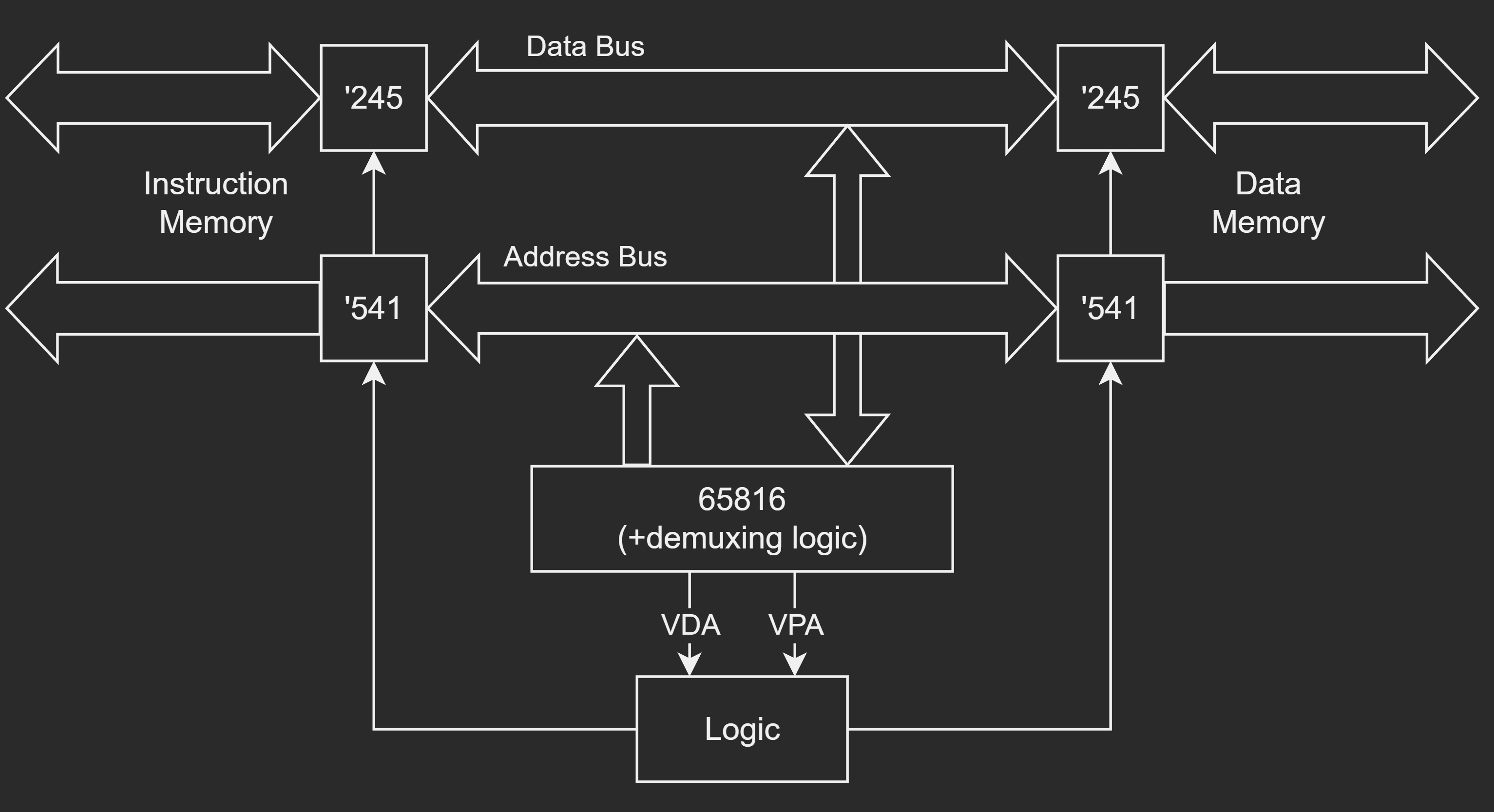

PostPosted: Thu May 11, 2023 5:54 pm
Posts: 746
wayfarer wrote:
Im still thinking Harvard arch... to me, the Program Counter should be completely removed from memory access.
even with the harvard architecture you still read instructions from memory. sure it's not using the same external bus as for data, but it's still accessing memory. (side note, RAM and ROM are both types of "Memory")
plus in such a harvard system, you'd still want the DMAC to be able to access the CPU's Instruction memory as well as Data memory. so you can copy from data memory to instruction memory or vise versa.
wayfarer wrote:
Opcodes should mostly come out of ROM, and Data should mostly be in RAM... to me at least
eh not really, you also want the ability for your CPU to execute from RAM. so you can load programs at runtime without having to reprogram a ROM. which is overall just a very very useful ability to have (just look at any 8-bit home computer that runs software/games without cartridges).
on a side note, couldn't you create a "pseudo-harvard 6502" using a 65816 (VDA/VPA) and some logic?
main benefit is that you technically double your address space. but downside is that you require a DMAC or similar to be able to load programs into instruction memory as the CPU cannot do that on it's own.
...damn, why am i so easily distracted by new ideas like this?
anyways, on the note of a CPLD for a DMAC, if it's for the 65816 you'd likely need full 24-bit address registers to be able to copy between banks, though the counter could stay 16-bits wide, which would limit the DMAC to only being able to copy <64kB of data at once, which i think is more than enough. also, do you really need a full 8 bit control register? i think for a very basic DMAC you'd need only 3 bits in total.
1 bit to start the operation. (which also acts as a status bit, so as long as it's 1 the DMAC is still running)
and 2 bits to select if the counter should be added to the source/destination registers when reading/writing. (basically this allows the DMAC to copy from/to a single non-advancing address which is useful for filling areas of memory with 1 value, or when copying from/to/between IO devices)
i think ideas for such devices deserve their own topic over in Programmable Logic though.
