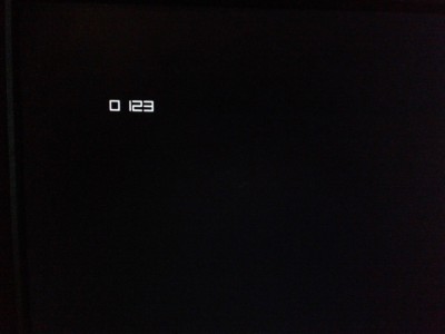

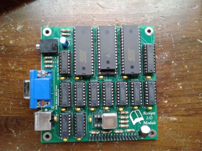

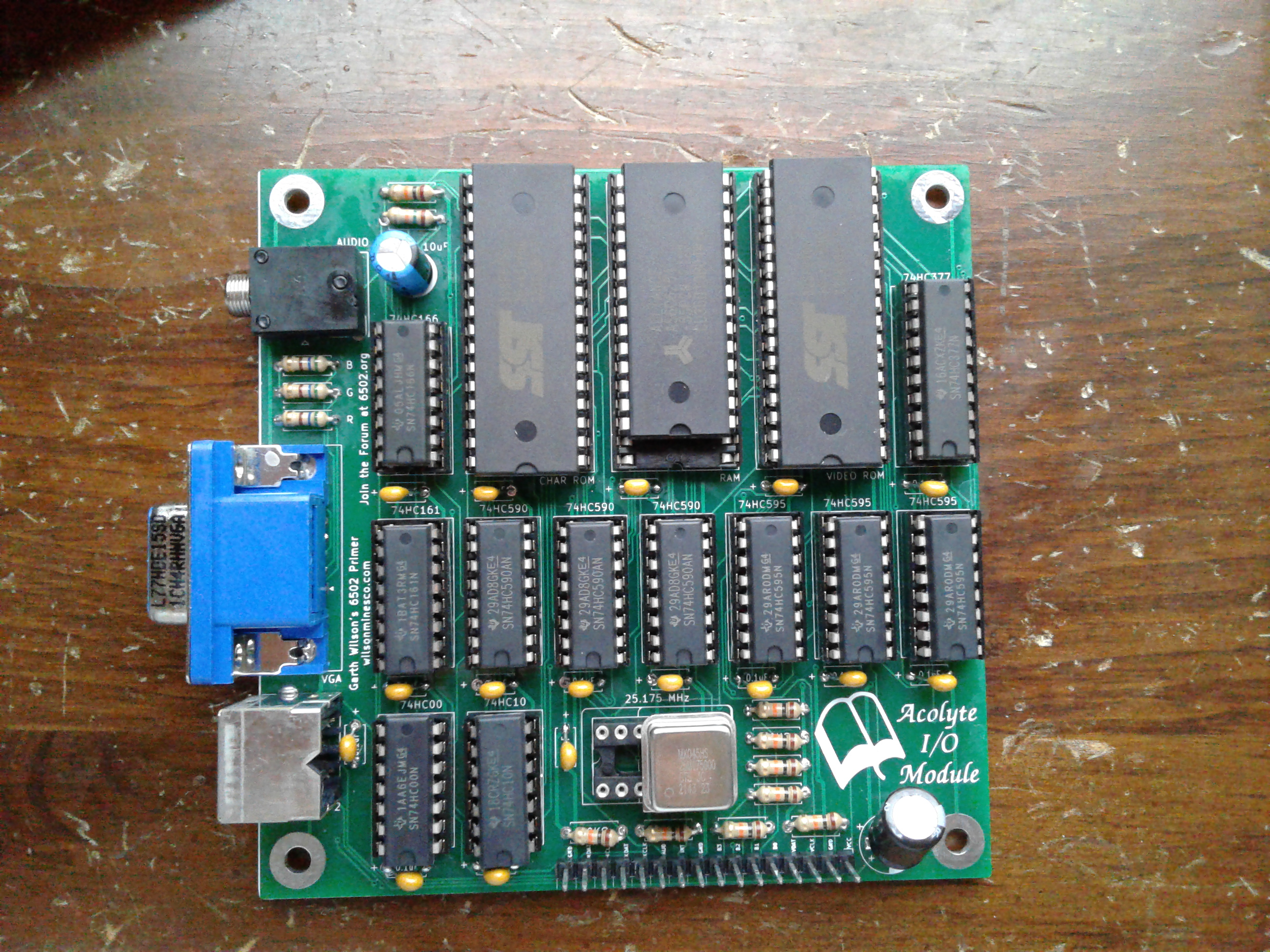

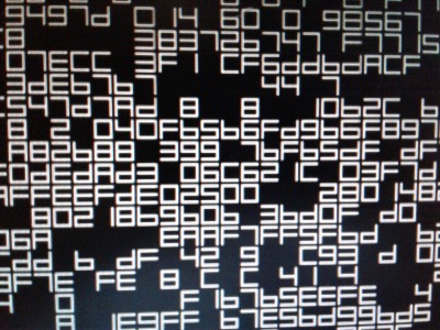

Update: The board came in, and I soldered it already! Look, it works! The video quality is really good and crisp.
I tried to interface with it by using those shift registers, but I don't *think* anything changed? I thought I saw something change slightly, but maybe that was my imagination.
I will be testing it a lot more tomorrow. So far so good though.

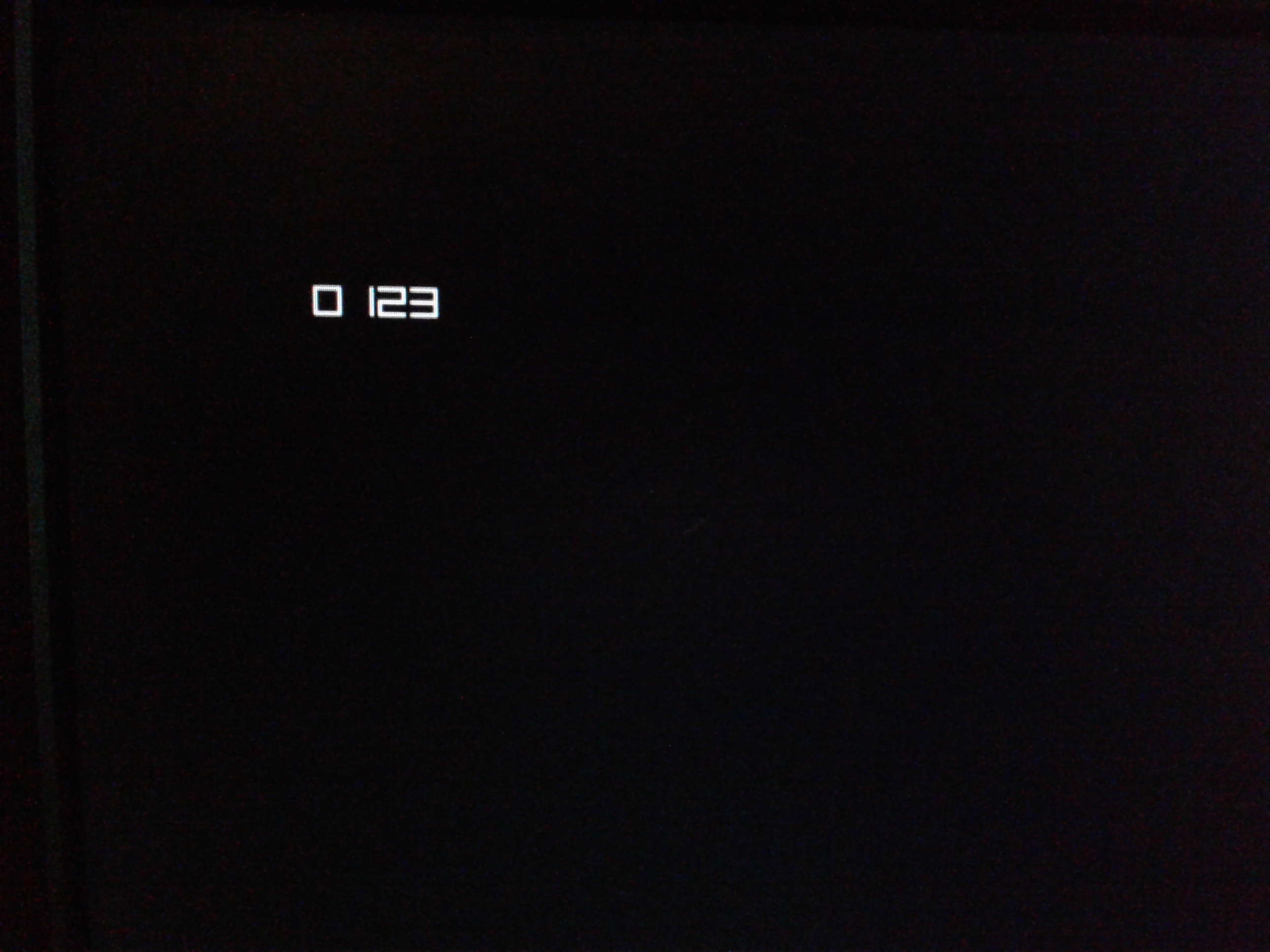

Alright, it works as expected! I cleared the screen and then posted a few characters to the middle of the screen. (see attached picture below) Perfect!
Some things I need to do now:
1) Adjust the visibility timing a bit, it's only showing 79 characters across right now.
2) Create an actual character ROM, not just some calculator style hex codes.
3) Post to Github for all to use!

So to put a character on the screen, you would do something like:
; Testing character
   LDY #$84
   LDX #$08
   LDA #$40
   JSR sendchar
Neato! Glad this worked on the first try without any bodges. I'm very happy about that. And, now the past Chad would love to have this module with his "V2" 6502 board.
Thanks to everyone here who has been patient and worked with me over the months, and even years now. This victory goes to you guys :D
I'll post more when I have more to show. Thank you everyone.
Chad

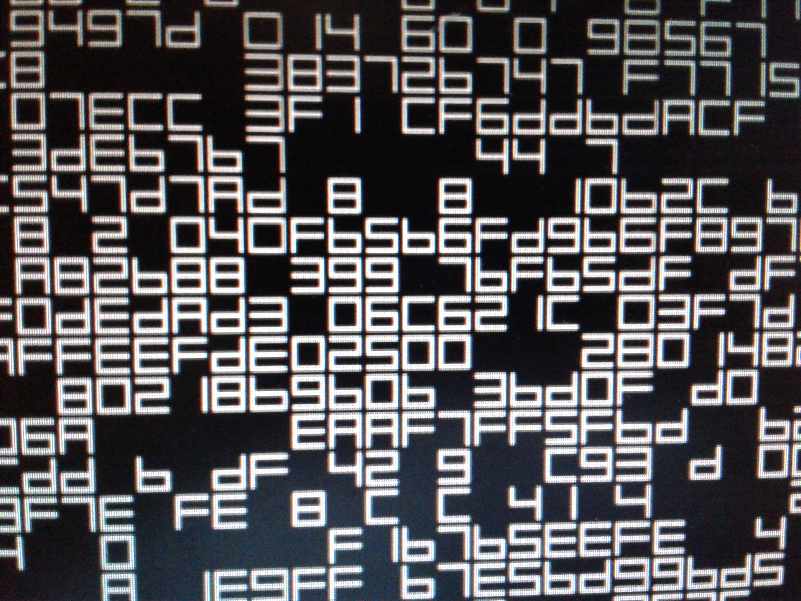

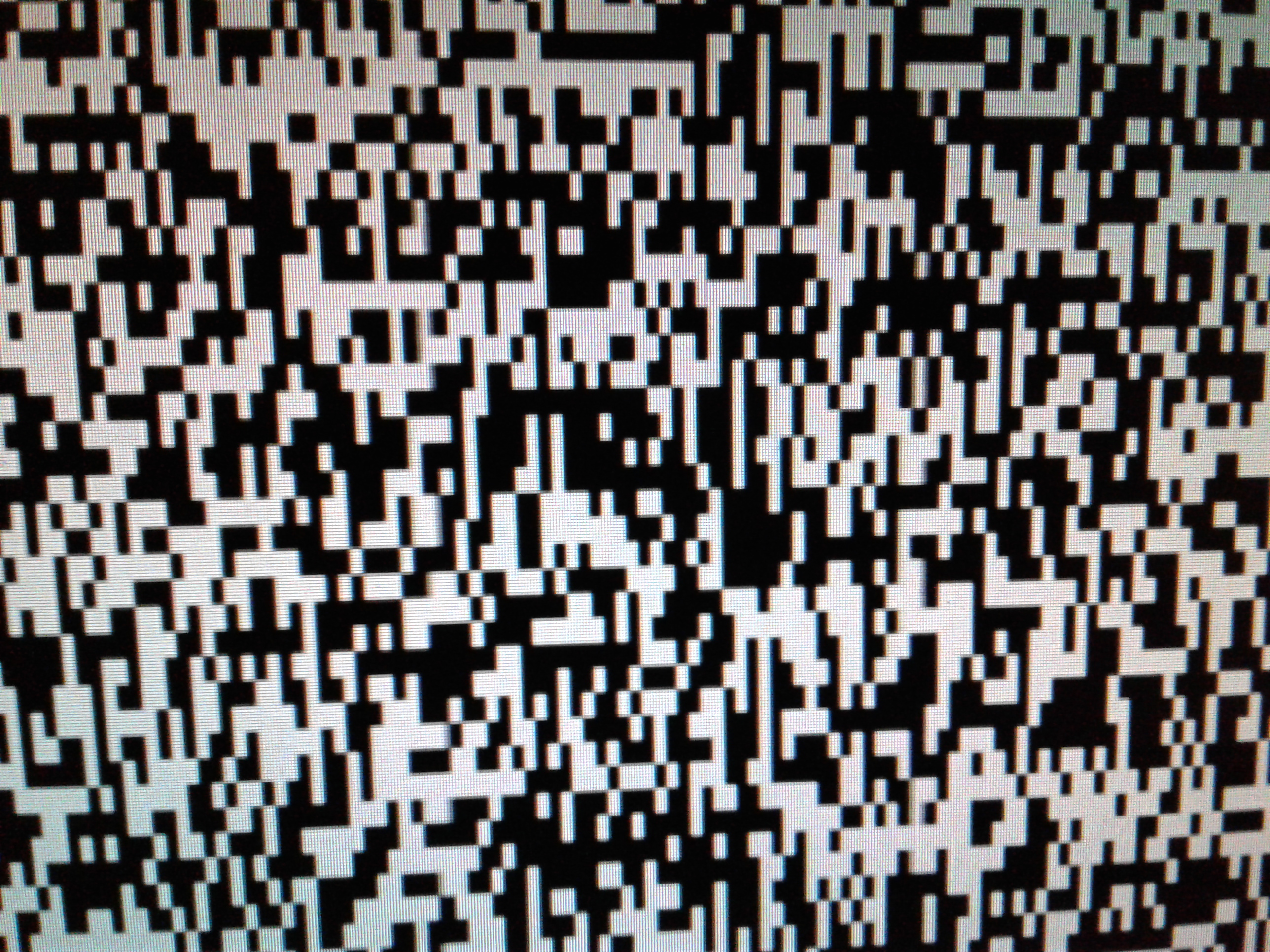

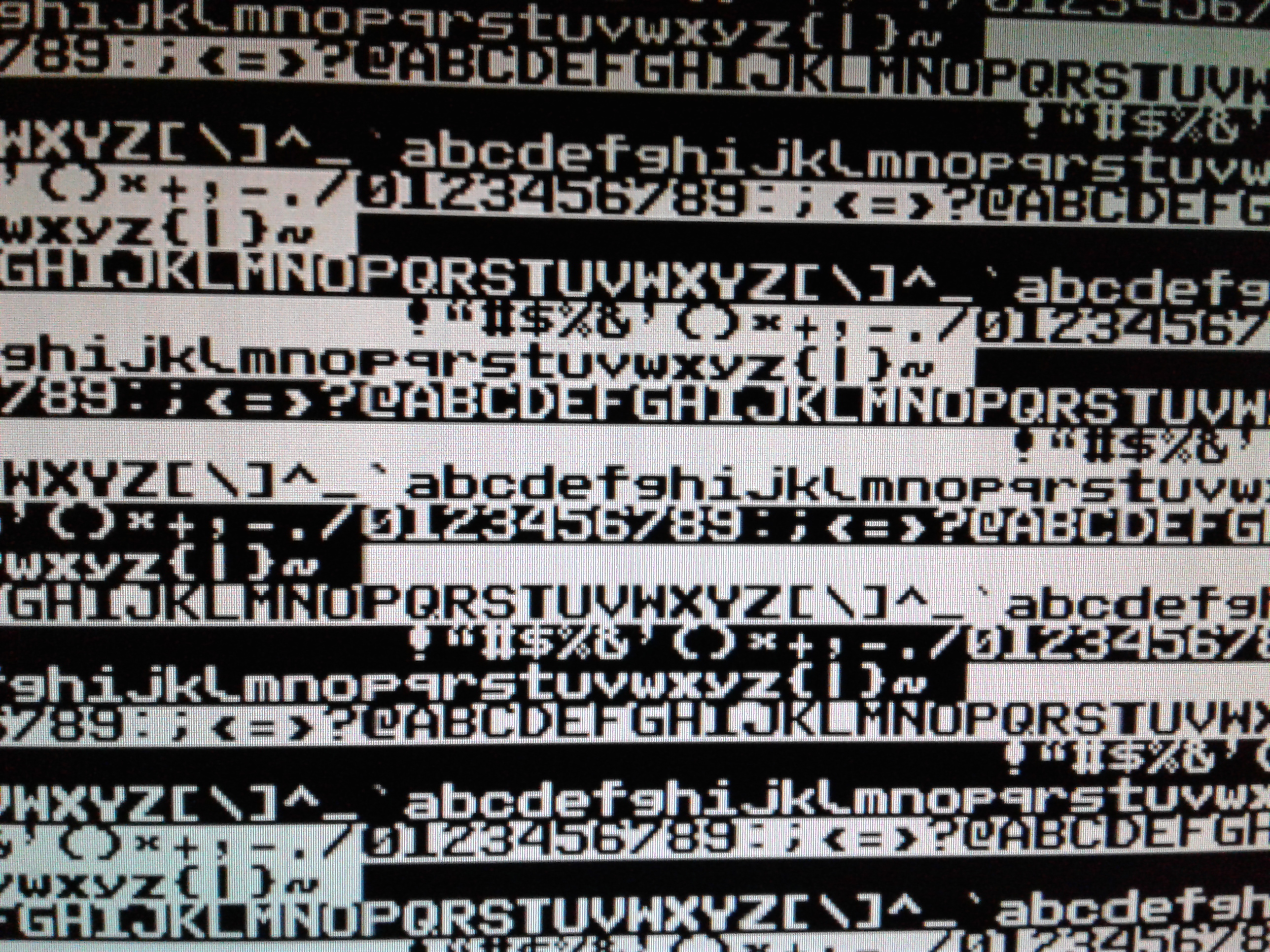

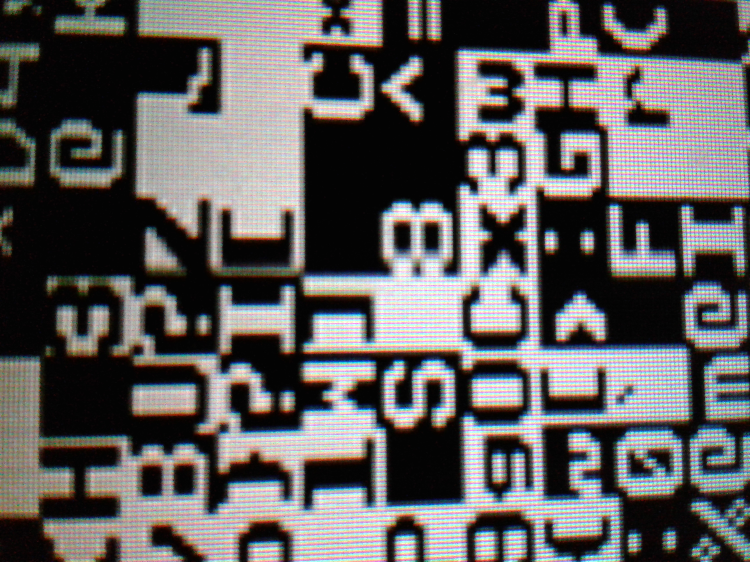

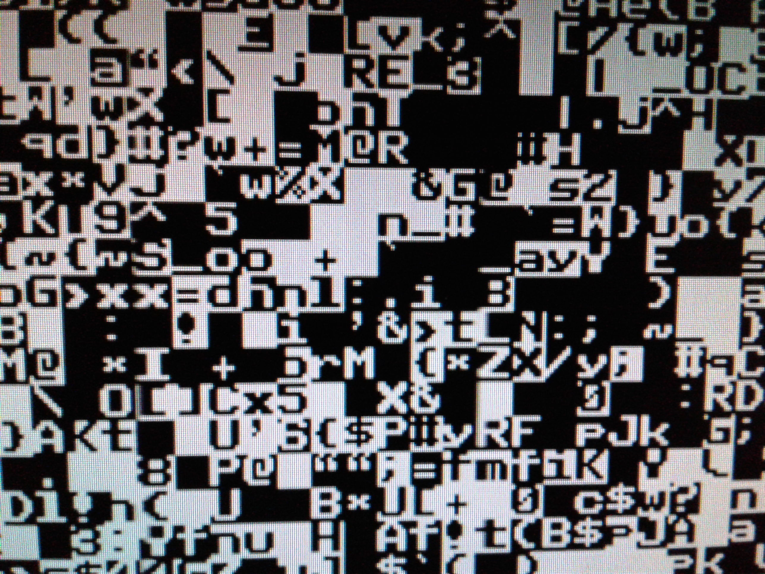

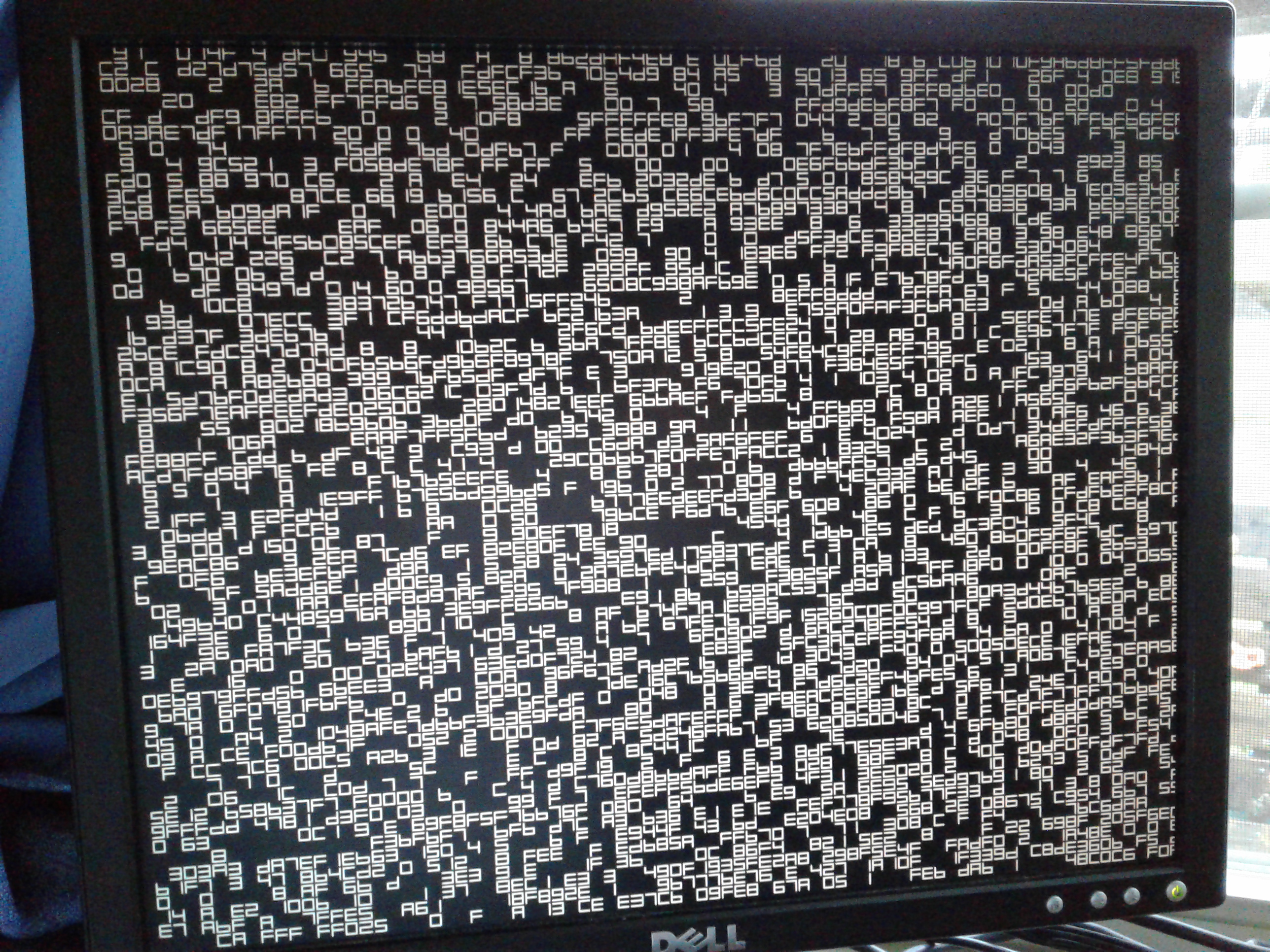

Update:
I filled out the Character ROM with actual characters on one bank and tall pixels on another bank (see attached). I have 16 possible banks, so I guess it could hold other languages or something. I haven't tested the "pixels" font much, so I don't really know if I am duplicating redundantly or something. More of a proof of concept.
I then adjusted the Video ROM some, and found that my logic doesn't, um, cleanly allow for 80 column mode. I either have 80 columns but clip 16 pixels in the top-left corner of the screen (only barely affecting 2 characters), or I have 78 columns without any issues. I went with the 78 columns and my monitor resized to make it fullscreen anyways, so I guess that works. I also tested it on my VGA-to-HDMI adapter and it worked flawlessly.
One thing my monitor is picking up on is a bit of noise on about 4 vertical lines throughout the screen. I tried to take a picture up close, it is between the I and [ symbols near the center of the picture. It is barely noticeable, but I'm trying to be picky here. Otherwise the image is super crisp. The TV through HDMI looks as crisp as it possibly can through a dinky adapter.
Lastly, I removed 8x 10K resistors from the board layout and replaced it with a resistor network. That saved a lot of space! I'm running auto-router right now, looks great.
I plan on posting all of it to GitHub later today. I probably won't post another reply here, so look for "SerialVGA" on my GitHub page (here https://github.com/stevenchadburrow/).
Chad

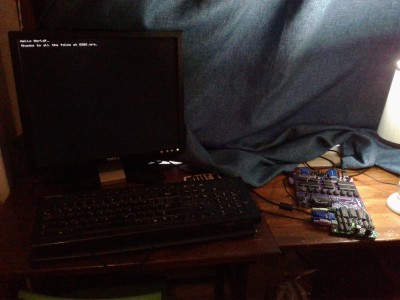

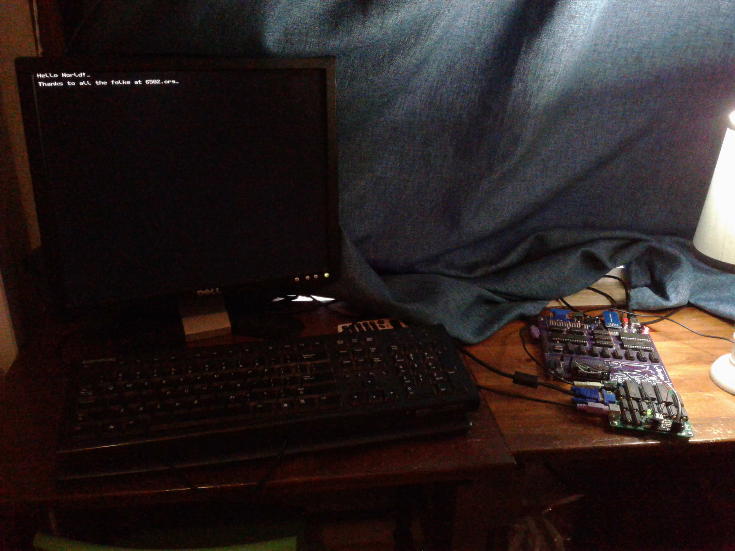

Update:
I have been working all morning on getting the keyboard to work through the VIA. And eventually I did! I was copying old code, and that was fine, but some of my newer code was just breaking everything. Eventually I sorted it out after about 5 hours, yay. Then I tested the audio and it worked within 5 minutes, yay.
My hookups:
PA0 = Video Clock
PA1 = Video Data
PA7 = Keyboard Data
CA1 = Keyboard Clock
PB7 = Audio Output (using free-run T1 Timer)
I need to clarify, this is NOT a terminal! When I am hooking a keyboard up to this thing, it is only the PS/2 Connector with some pull-up resistors. It acts more like a breakout board. The keyboard is NOT creating the characters on the screen directly. The keyboard clock is interrupting the 6502 which reads the keyboard data, and when a full byte has been sent, the 6502 then sends a character back to the monitor through a separate serial connection.
I posted all of my schematics and gerbers on GitHub (here https://github.com/stevenchadburrow/SerialVGA), along with my example assembly code file using all of the features. I hope to eventually make a "User's Guide" for it, though it is honestly VERY simplistic to interface. The hardest part is deciding what you the user wants to do with it. But that's also the fun part :)
This should easily interface with an Arduino, Raspberry Pi, or any particular microcontroller. The idea was to have something easy to use for newbies, particularly those who have built Garth's "Potpourri" computer (or Ben Eater's 6502 kit, which simply copies Garth's plans). Given this module, they should immediately be able to display a ton of information on the screen, use a full keyboard, and have simple audio. Though this module lacks hardware scrolling, software scrolling is very possible because the total memory used for this module is only 8KB. If the user were to store their characters to RAM and to the module, they could easily run back through RAM to re-write the characters on the screen to a different location. Slow, but effective, and still very simple.
I have no plans on making this any better, because I think it's the best it can be for it's intended purpose. If I were to do a bitmap graphics version, it would need a different way to interface it properly. I also do not plan on making this controlled with a CPLD because the idea was to have the newbie solder this themselves, and then program the ROM's themselves. If I decide to one day make a solderless version, I'll reconsider and use SMT parts instead.
Thank you everyone. Another successful project complete! So, what's next? :)
Chad
