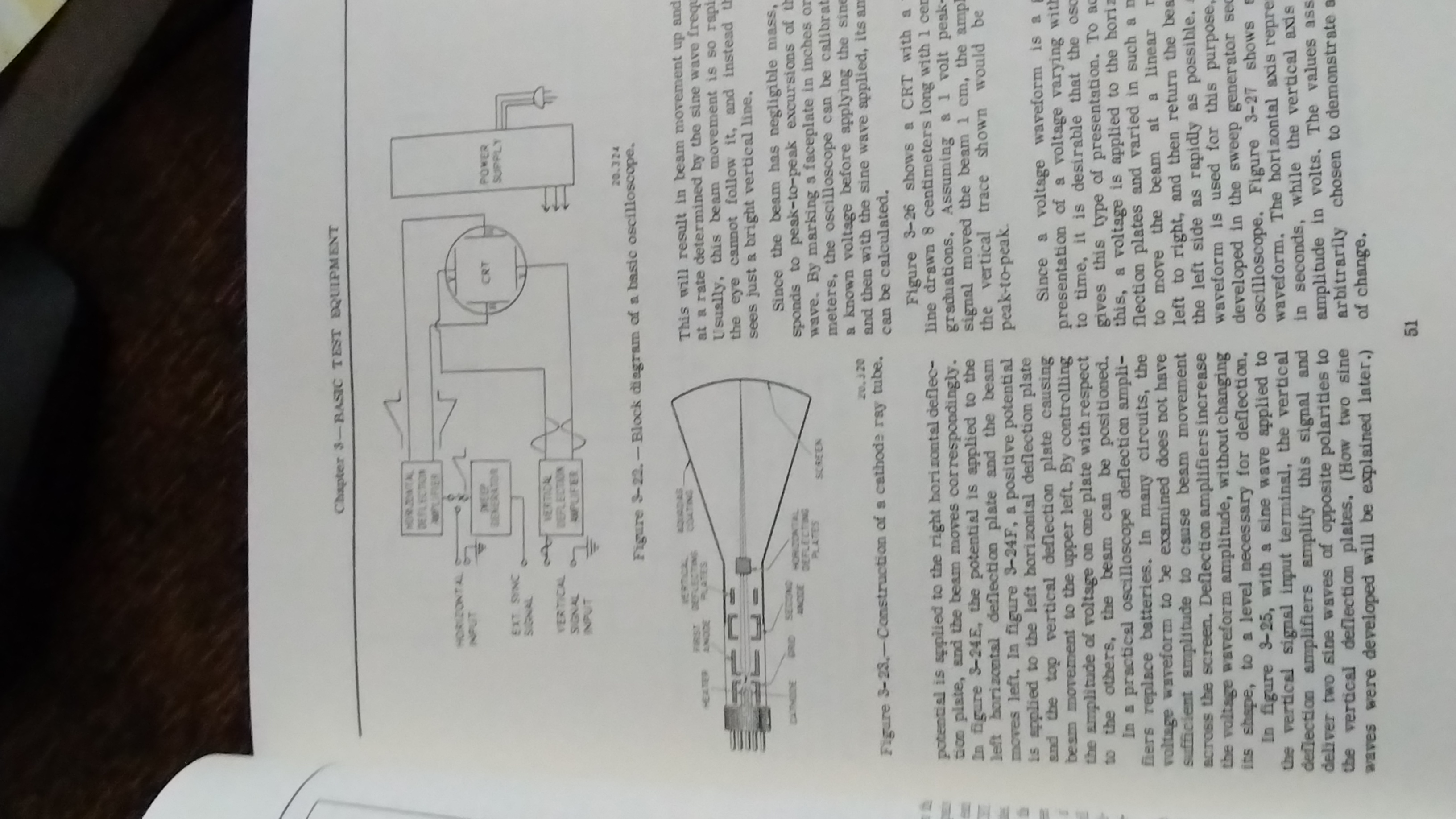

So I was looking around the board, among other things I read that you are octogenarian. Awesome. I also read you are ex navy. You probably know this book better than I ever will
I also read some of your experiments in timing control systems for these devices. I hope to learn all I can from you.
One of those the ngs I learned in college, when I got my bachelor's degree in interdisciplinary studies, while I enjoyed my time in the ivory tower, was that words have different meanings in different areas of study. Consider the word shear, and how it means different things to a graphic designer, a geotechnical engineer and a sheep herder.
If I have somehow trampled a colloquialism, pardon my naivety. I was referring to these old apple docs I'll get you a link to that reference once I'm not on my phone. It refers to these registers in different 'modes'; even eyes and letchy on page 60 talk about addressing modes. I understand the importance of being succinct. While I disagree with Hume on many things, preserving the distinctness of language is something I do find important.
I heard you talk about your "uncle" max. I knew a guy named Howard used to go down Dallas ham meet for parts, he worked for Ti on a chip used for hard drives. He taught me PC repair. You remind me of him. I hope to learn everything I can from you, you GiantGeniusReptile.
