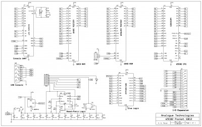

Just realize that the AT28C256 has the same pinout as a typical 32KB SRAM. The chip select line (CS) must be active for any data to be transferred. The OE is basically a read line and WR is a write line. Using the AT28C256 (and any SRAM), you should use some logic to generate separate Read and Write lines from the CPU CLK and R/W lines. I've included a jumper on my boards so I can prevent accidental write to the EEPROM or, with the jumper set to connect the WR line, so I can update it insitu.
Also, I always use complete address decoding on my systems, so there's never any chance to have phantom addresses that attempt to access other devices. I've attached the basic C02 Pocket SBC schematic. Note that I use a single glue logic (ATF22V10) for address decode, I/O selects and CLK2 qualified Read and Write signals, which are used for SRAM, EEPROM and the UART.
Hope this helps.
