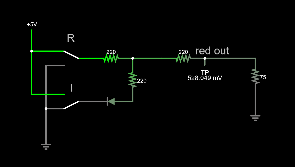

Spot on George. I tested that configuration and it is quite pleasing! I had to modify some values to accommodate for my grounding the monochrome and 4-color resistors, but the setup is a good one. I got R+I=(250,82,82) and R-I=(168,0,0). So basically a deep red and a dull pink. There is good contrast between them, and yet they both still look "red". Also the two greys are different enough from one another, and different from white and black. Thank you!
As for the diodes, I also tested that one:
https://falstad.com/circuit/circuitjs.h ... hv7dkBkGgA
And I'm finding a configuration that would supply R+I=(250,0,0) and R-I=(153,0,0). A full red and a mid red. Like you said, 'bright black' is still just black, so only 15 colors, BUT those 15 really pop!
My biggest worry is which diodes to use, based on:
1) Switching Speed
2) Resistance
3) Thresholds
I see from falstad that it would need to be able to push 1.9V through the diode, I don't know if that's a good thing or not (and I know I'm not using correct terminology here, I'm new, forgive me). Also the resistance the diode has must also be considered, as the diode circuit is much more sensitive to these values.
I have some signal switching diodes at the house. I definitely want to breadboard this to make sure there is enough of this and that to make it work. Any particular suggestions for which diodes would work best for this application? I haven't worked with diodes very much so far.
Thank you all! Good discussion!
I don't really understand the circuit with all the switches, but great if it works!
1) Switching Speed
2) Resistance
3) Thresholds
I haven't put these diodes in before so I'm not sure, and don't know much about choosing diodes. I might experiment a little later, it'd be a good excuse to get my electronics stuff set up again!
But you're right, you'd need to choose well. Generally the diode will have a fairly specific voltage drop. One option here is to go very simple and just make a regular voltage divider for each channel, but also connect each output to the intensity input through a diode with a low voltage drop, e.g. 0.3V (note this is lower than you get from most silicon diodes). This means that your high-intensity output will be at 0.7V, and your low-intensity output will be 0.3V lower, i.e. 0.4V. This would probably look quite good - a little too dark perhaps. Here's an example of that:
https://falstad.com/circuit/circuitjs.h ... FIJs0s+iAA
File comment: minimal
Another option is to do the diode bit at a higher voltage range, then divide down again afterwards. My old circuit kind of already does that by having the extra 220 ohm resistors before the output goes to the monitor. In this case you can use a diode with a higher voltage drop and still get a good result like this:
https://falstad.com/circuit/circuitjs.h ... kxCNJvmwgA
File comment: more resistors
I can't vouch for this being a good idea though, and you will need diodes that can switch fully at the right frequency.

gfoot wrote:
The attachment circuit-20220428-1803.png is no longer available
The attachment circuit-20220428-1803(1).png is no longer available
Looks great George, thank you. Yes, that's what I'm thinking about. I'm still debating if I should go with all resistors (your previous model) or the one with diodes (this model). I also experimented with RRGB 4-bit colors, and what that would look like using GIMP. I really like that one, it gives a REALLY nice variety, but it doesn't have grey, so... take some, lose some.
Sorry my link is full of silly extra switches. I have 7 shift registers going into these 3 colors, and I have to account for all the extra grounded values. 330 ohms total is the sweet-spot for each of my three 'color modes' it seems, so I change accordingly.

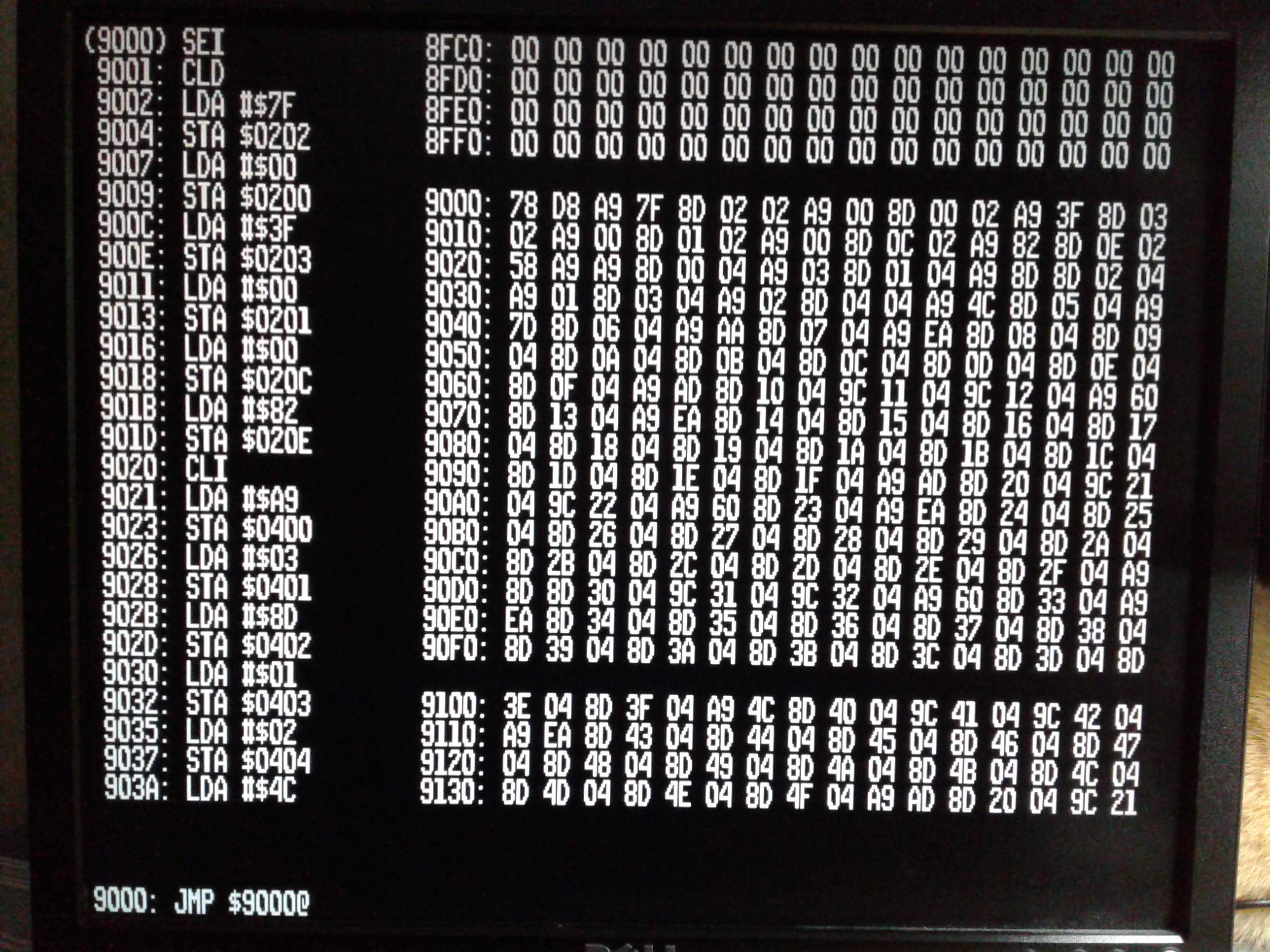

Attached is an updated Monitor program, and requisite picture.
It now has a 'full' disassembler built in! The ! command makes the start of the code happen wherever the (XXXX) cursor is currently.
It does not yet contain any zero-page instructions. Mainly because I'm lazy, but also because their addressing modes confuse me :)
I've been pondering how to do the Assembler part. I think the parsing would be easier now that I know how these addressing modes kind of function. My biggest issue is: How do I display an error? Currently there is never any errors, it just ignores things that are weird or incomplete. But obviously there could be wild errors when actually typing Assembly. Do I ignore only that instruction? How do I know if the next one is ok or not? How will I know if I messed up while coding? Lots of issues besides just parsing.
I also plan on adding a ? command that displays a helpful guide on how to use this program. Would be nice built in!
Thanks everyone. I'm starting to make a miniature operating system here :)
Chad

PostPosted: Fri May 06, 2022 11:13 am
Posts: 718
After a bit of helpful critiquing here:
viewtopic.php?f=2&t=7110
I'm back to present a MUCH better 'monitor'. I don't know if I'd call it a monitor at this point though. It is closing in on an 'operating system', maybe just an 'assembler', definitely a replacement for BASIC.
I switched the Disassembler to the left side where it is more important. I removed all that 'cursor' and 'selection' stuff for the memory, instead going with straight 4-letter commands that expect addresses and stuff later.
I took hints from SMON (https://www.c64-wiki.com/wiki/SMON) and others for the Assembler mode. It's not a copy/paste at all, but it does mimic functionality. You can type Assembly code in, and it will accept wild variants as well. For example: LDA#44 will work just as well as LDA #$44, and STA4444X will work just as well as STA $4444,X. So it is a flexible Assembler. You can also 'realign' the top of the code at any time, and also write out a sequence of hex bytes. Because the code and memory are drawn independently, this speeds up coding a LOT.
Any zero-page assembly and disassembly functions are still not included at this point. That will come later.
There are currently no 'find' or 'hunt' or 'compare' commands, mainly because that would have to return a value to the user, and I'm not exactly sure how I want to display that at this time. The command HELP shows all that I currently have available.
Creating the Assembler code was actually VERY easy, once I had a good idea of what to do. Sometimes I type code at work in Notepad, and because I can't test it, I have to be very careful, and go through it a few times before I'm happy. Then I come home, and it mercifully works nearly every time! At least it works enough. :)
The attached code is NOT YET COMMENTED. It's still a work in progress, I'm only including it for posterity sake.
Thanks everyone!
Chad
