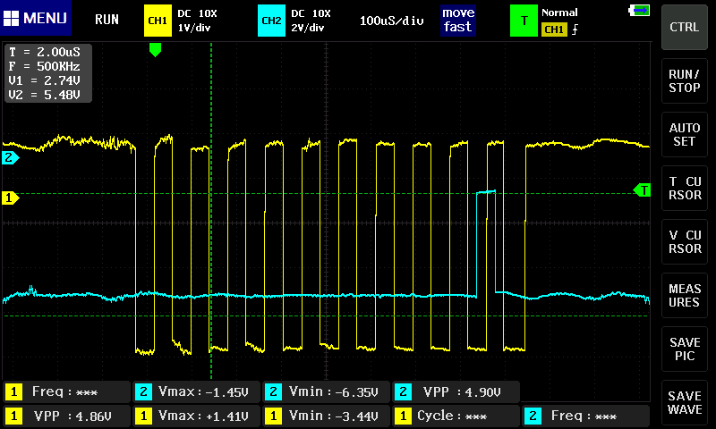

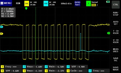

Inverting and without the long ISR sadly didn't make much of a difference. I'm still getting bad data - like 1 bit off every second or third keypress, more often than not only 1 nibble is incorrect(?).
Shifting and sampling seems to happen at the correct time, but the data doesn't agree (see screenshots attached).

PostPosted: Wed Apr 20, 2022 10:03 pm
Posts: 741
What are the signals hooked up to the oscilloscope in each trace?

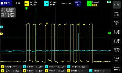

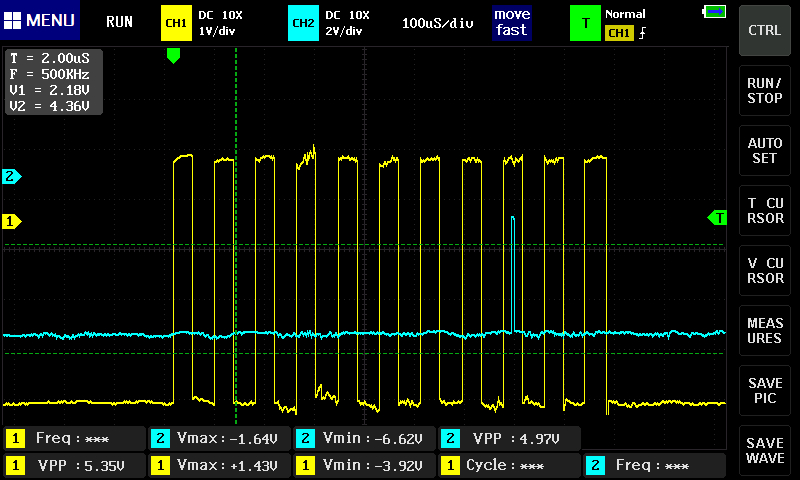

The scope capture is PS/2 clock and the debug bit 8 on the $5000 output register. The ISR is horribly long but when I convert the keymap to LSB in MSB the juggling is fixed.
