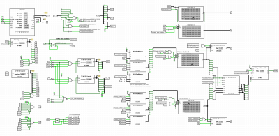

So... I had a brief moment this morning while I was waiting for a client to tell HOW something didn't work rather than just saying it's broken and urgent; and I may have gotten a bit carried away with (2) the frame buffer thing.
I'm fully committed to frame buffer style video so this was also a bit of learning for myself as I haven't gotten around to laying out framebuffer access yet. Hopefully you'll find it helpful, or at least if there are bugs they'll be spotted.
Diving straight in there are two 1KB chips that form the framebuffer. They're swapped each time V492 ticks and are selected by the flip-flop in the bottom right. When FRAME_BUFFER_0 is high then output from 'Frame Buffer 0' is fed to the shift register by the line driver. When FRAME_BUFFER_1 is high then 'Frame Buffer 1' is fed to the shift regisiter.
This is all in theory, the simulation of the 6502 is not accurate (I really only use the 65816) and the screen size is WAY to big for Logisim to simulate in reasonable time.
The six multiplexers allow either the address from the 6502 or the counter's address to be sent through to the 1K video memory. The bus transceivers keep the data that's being output to the shift register off the 6502's data line and also allow data to be written into video memory.
I've also randomly mapped some ROM in but in reality it won't work at 12MHz. The clock speed either needs to be halved again or the clock needs to be stretched when doing reads from ROM.
I think that's about it. Still seems pretty complicated for getting video out but I like it and it doesn't involve a microcontroller. Again, hope this helps!
[EDIT - I forgot to mention. I mostly use LVC chips and they won't play nicely with HC chips so if you do think of using this you'll need to swap them out for their HC equivalents]
