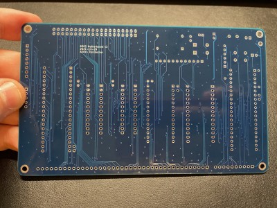

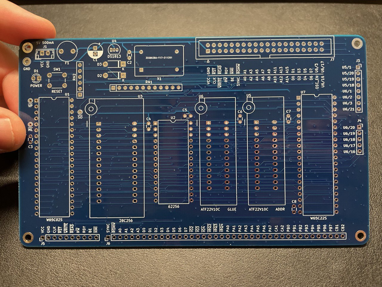

In other news, PCBs arrived today! :mrgreen: Just in time for some week-end soldering.

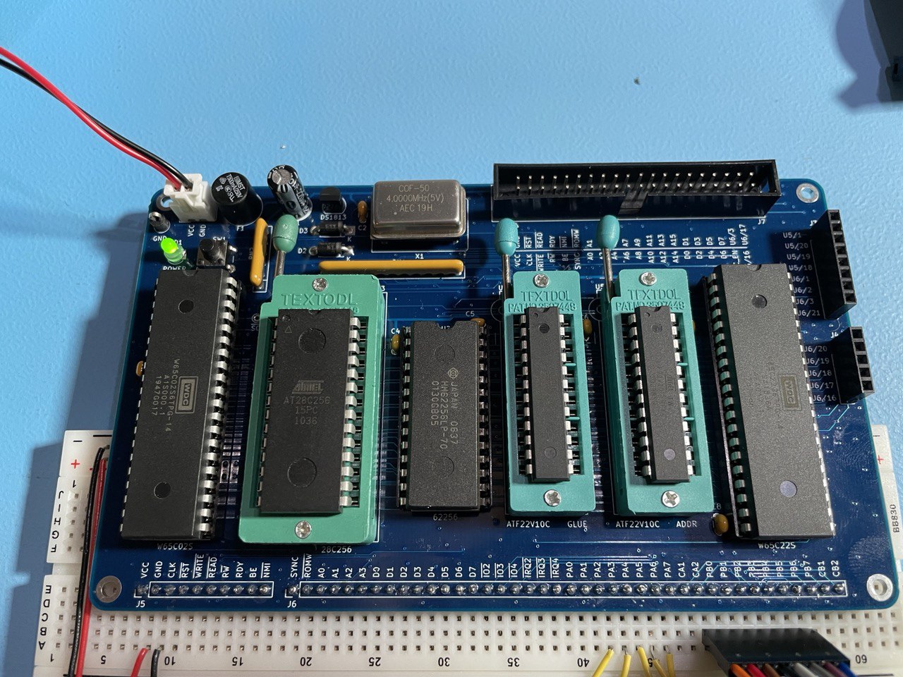

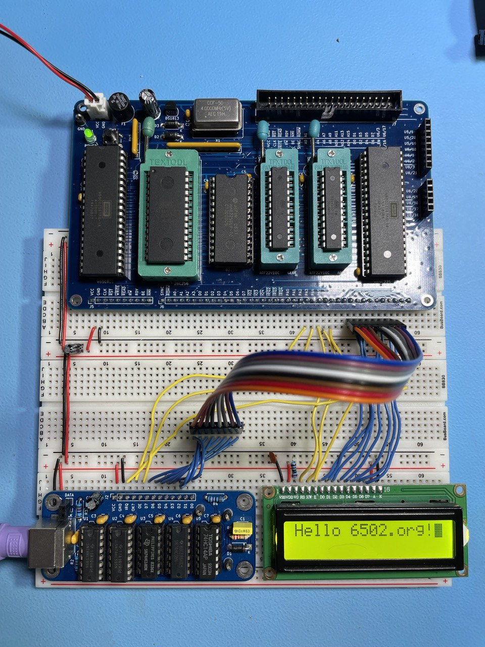

UPDATE: It's alive! I had it soldered for a few days but it didn't work on the first try. Had to spend some time troubleshooting, but it turned out to be a software issue and not hardware.
X.oe
in WinCUPL is active high, not active low... Once that was fixed, it booted up like a charm.
I need to wire my keyboard module and LCD properly, and test it with my VGA card next. Pretty happy with the results!
