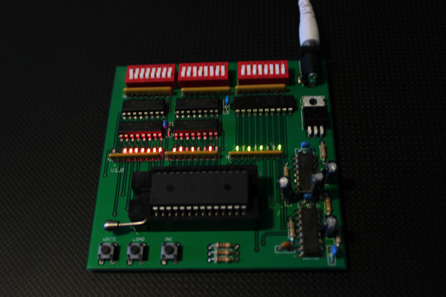

I'm interested to hear other ways of building ROM-less EPROM programmer using retro hardware. It is a chicken-and-egg problem.
This was my solution. It's designed for the AT28C256. I could have bought a programmer, but for that project I wanted to do things the hard way.
The first draft didn't have the "increment address button". That turned out to be the much too hard way. This version isn't too bad to use. Set up the address, press "load", set up the data, "write", then "inc" and set up the next byte. The data LEDs show the current contents of the ROM, so it serves as a verifier as well.
