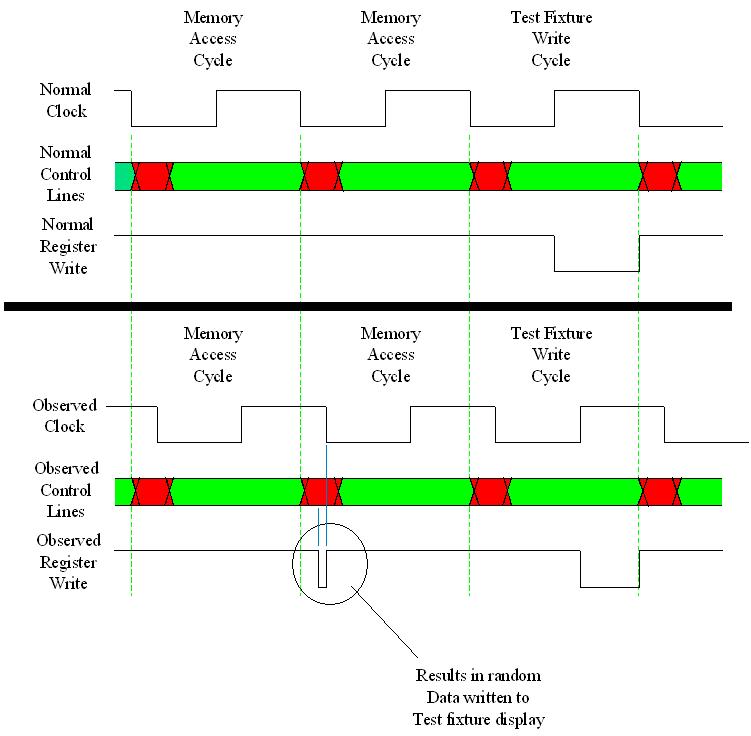

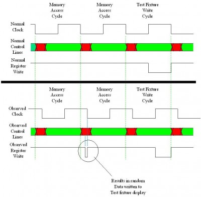

Regarding PH2 clk - I ran into an issue with a test fixture on select Rockwell CPUs. The PH2 clk did not match the data book timing in a few cases. My first attempt at a test fixture many years ago worked for most CPUs but failed rather badly with a few CPUs that had no apparent problems.
Turns out the clock was skewed by quite a bit. I was qualifying the address, RdWr and PH2 clk for a quick and dirty latch. Sometimes the address & RdWr lines would be valid-ish during the undefined period and with the clock skewed - I got sporatic read/write values.
You can tell from this old timing drawing where the error popped in.
Had link to my website here but I forgot that I had 'hotlinking' blocked on my website so that didn't work.

You did it right, but if I go to the URL, I just get the message, "You do not have permission to view this directory or page." Do you have to have an account and be logged in? What you could do is download the image, then attach it to your post.
We sold a product with a Rockwell 65c02 for 13 years using the phase-2-out and never had any problem. We would not be able to use the phase-2-in without using more parts though, because of the analog levels, as we were using just an RxC hung on the processor for controlling the clock speed, rather than an external oscillator.
