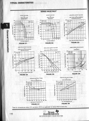

I agree with Billo that Voh spec is exceedingly conservative. If you still have TI's TTL databook, look into the first section where it talked about typical characteristic of TTL logic family. I attach characteristic of LS family and look at figure D5. 74LS has no problem getting to 3.0V with 15mA output.
I'm a big user of Altera CPLD. Their data sheet also says 2.4V minimum Voh, but buried in the datasheet is this output drive characteristic. It can drive to 3.0V with 30mA output.
