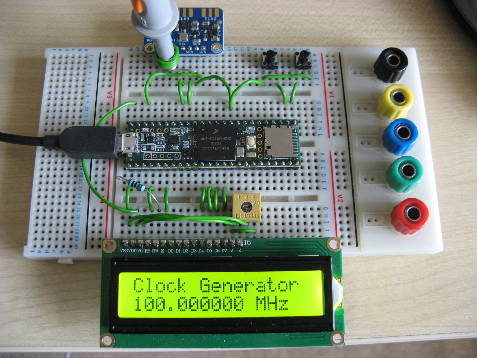

We've been using the Si5351A for a few days now as a flexible clock source for Beeb816.
It's actually been working quite well.
Here are a few snaps.
It's currently just sitting on a breadboard being driven by a spare Teensy:
This is the code that's running on the Teensy:
https://github.com/hoglet67/si5351stand ... dalone.ino
You can set the frequency using the push buttons (in 100KHz steps) or by sending a number over the USB serial port.

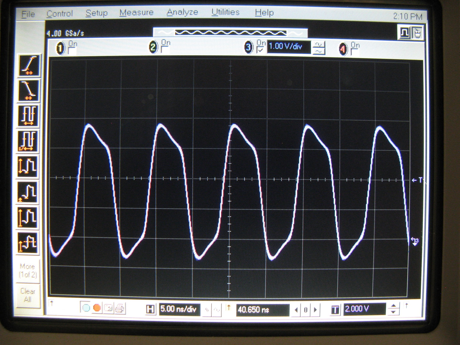

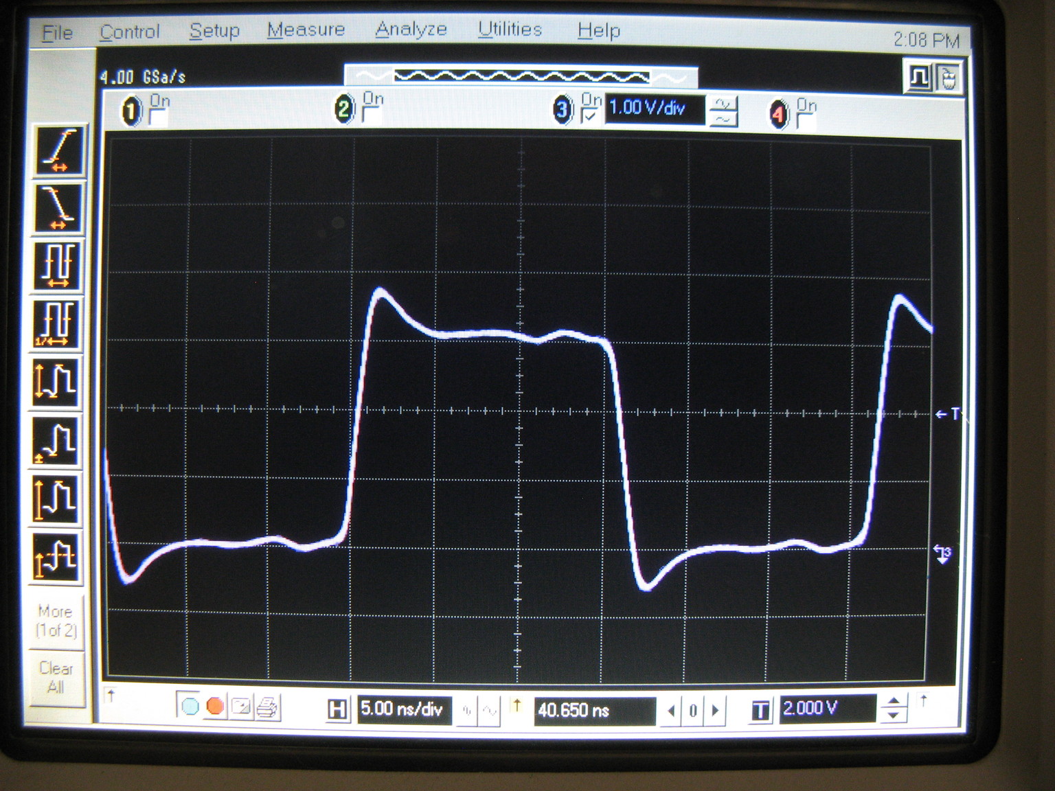

Here's the output at 32MHz:
And at 100MHz:
The jitter is about +/- 100ps, and this doesn't seem to vary much as the frequency changes.
You can also seem to be able to change the frequency without the clock glitching.
The edge time is ~1ns when the drive is configured to the maximum of 8mA.

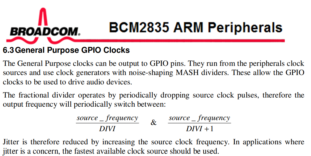

However there is actually a programmable clock output on all Pi's, so use that instead.. You can select which internal oscillator drives the divider and the divide ratio although I don't have notes to hand about the actual range of frequencies but its been used to create FM radio signals in the past...
Are you referring to the General Purpose Clock outputs (GPCLK0-2):
https://www.raspberrypi.org/app/uploads ... f#page=105
You can choose any of the PLLs as the clock source.
PLLC (the ARM clock) on a Pi Zero defaults to 1,000MHz.
This should result in a jitter of +/- 500ps, so about 5x worse than the SI5351A, but fine for many applications.
