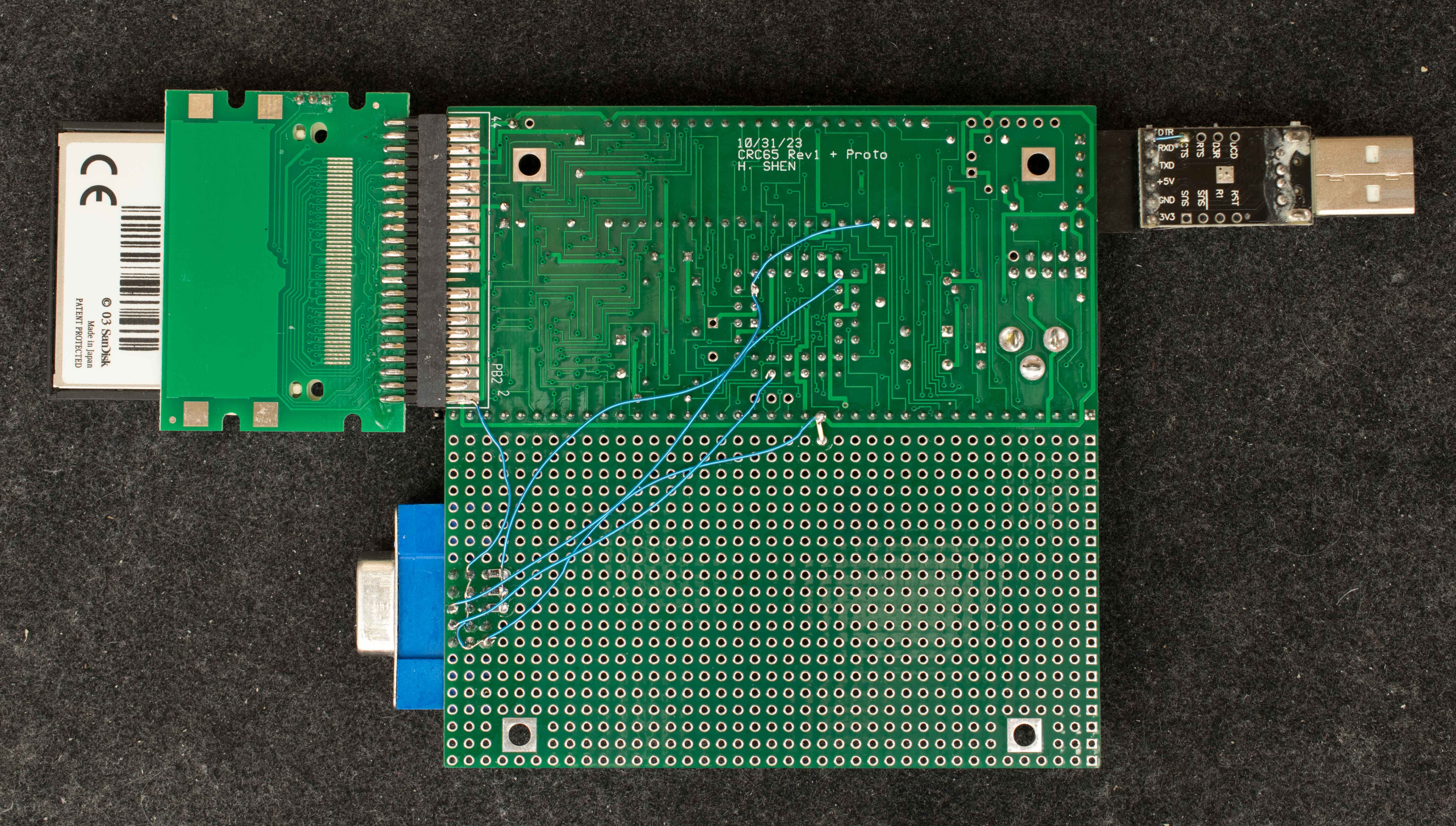

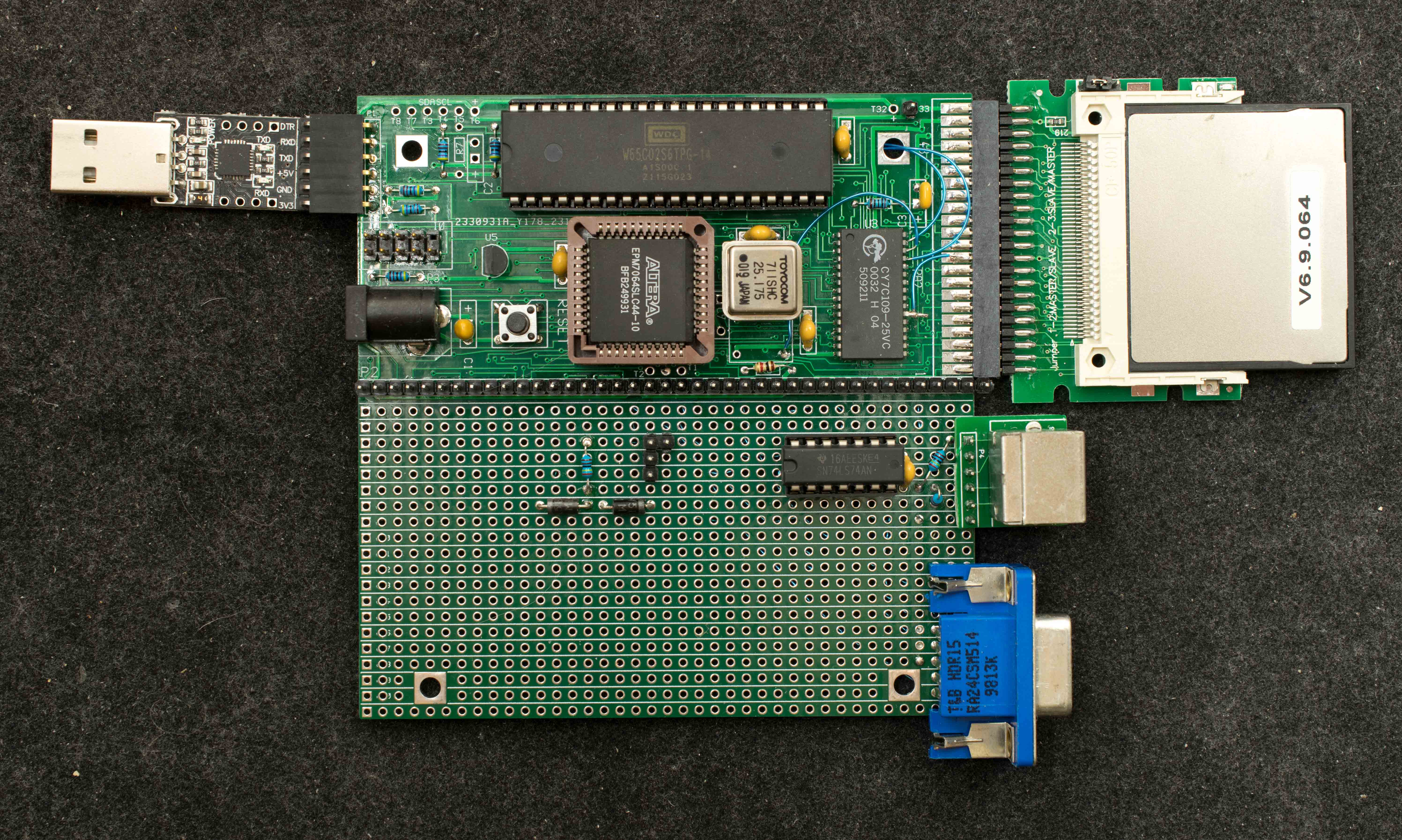

Returning to this topic because I've learned a few tricks in the last few years and it is slowly dawned on me that I can trade speed for hardware complexity. W65C02 can run reliably at 25MHz so it is time to take advantage of that capability to reduce the complexity of hardware.
In my first attempt with VGA beam racing, I wanted a capable serial port but had to sacrifice the CF function to fit the logic in the small CPLD. The idea now is to simplify the serial function to the simplest bit-bang implementation and keep the CF function. In fact, the plan is to expand the memory to 2 banks and find a way to have PS2 keyboard function as well. I can have it all if I keep it simple but paid with degraded performance and more memory.
Enough about ideas, here is what's possible: CF interface, 640x480 VGA, bit-bang 115200N82 serial and possible PS2 keyboard. The modifications to the existing CRC65 is minimum, most of the changes are in the CPLD which is 77% utilized and there is one spare pin to drive 2nd bank of memory.
It still takes 90% of CPU and 40K memory to paint the 640x480 screen. Swapping in 2nd bank of 40K should alleviate the memory shortage. I have to work with the remaining 10% of 25MHz 6502, or a 2.5MHz 6502.
CF can supply the graphic files instead of uploading them serially. I'm exploring different fonts right now. It seems to me 30 rows, 80 columns of 8x16 fonts is a good fit.

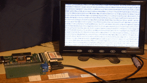

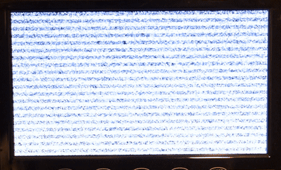

I read this recent topic "Displaying an ASCII spiral in 6502". I want to try that on the 6502 VGA controller. I started out with random video contents in $4000-$ef00, then I start from the center of the screen, spirally fill it with incrementing values translated into 8x15 fonts; then spirally erased it starting from the center; and then spirally filled it again with different values. This is all done during the vertical retrace period. The program is slowed down to about 1/4 speed so the spiral filling can clearly be seen. I'm please to see that 2MHz equivalent 6502 is reasonably quick even for graphic applications.

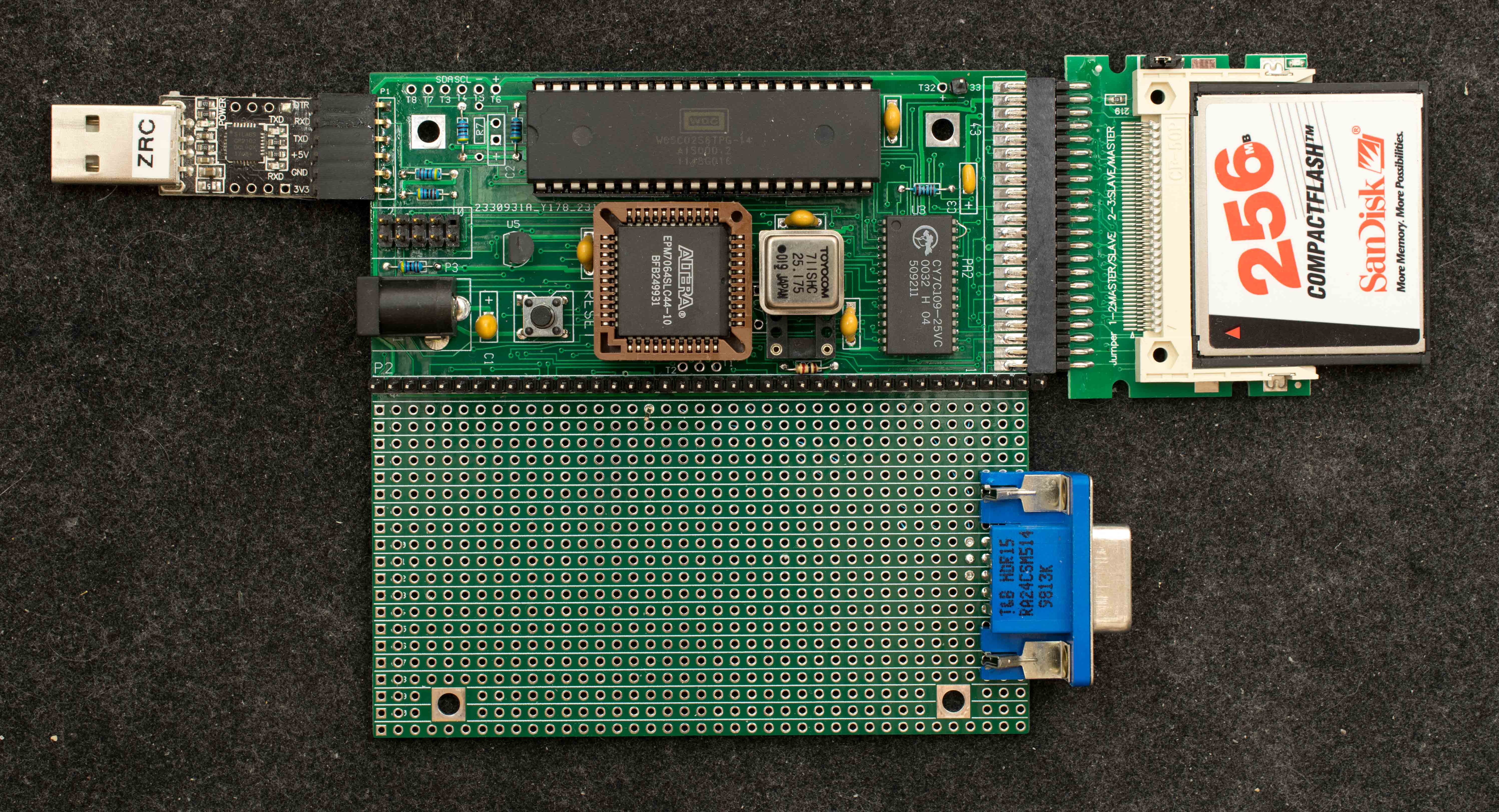

Built up another CRC65_prototype modified as a VGA controller. I managed to find another spare I/O pin by externally derive compact flash chip select using a 7474 flip flop. So now I have enough pin for PS2 keyboard as well as 2nd 44K memory bank ($4000-$EFFF). This is a barebone standalone 25MHz 6502 computer with serial port, CF interface, PS2 keyboard, and 640x480 monochrome VGA. It is not a pampered hardware with I/O data nicely formatted and presented to it on a silver platter; it has to bit bang serial, PS2, and chase VGA beam to display data on screen. The poor thing is working 90% all the time just to keep up with the regular housekeeping functions dealing with display and basic I/O.
Currently it can serially load and run programs via TeraTerm and display image on VGA display with data from memory or CF disk. I'm testing the PS2 keyboard function now. My immediate plan is a monitor that receives input from keyboard and displays it on VGA. I want to find out what it can do with the 10% of leftover throughput.

How do you access that CF disk? It is parallel correct? Do you use the CPLD, or is there some other method through the 6502? I went through your schematics and CPLD pdf and didn't find anything specific to that. Am I just missing something?

The CF interface was in the original CRC65 design. It is basically 8-bit parallel data interface with 3 addresses. CPLD generates the CF select, CF read, and CF write. You probably can generate the equivalent control signals using VIA although it may be slower. My CF design is memory mapped with 4 wait states; CF itself is capable of tens of megabyte/sec transfer, but without DMA and with 6502 only active 10% of the time, 100KB/sec is likely the limit. In my BadApple demonstration, it is sustaining 60K/sec transfer of video data.
Replacing the CF select with discrete flipflop is likely temporary in order to try out PS2 function. In the finished design, I'm likely to sacrifice one address line to eliminate the external flipflop. I am able to combine PS2 and serial port in 3 CPLD I/O pins; it looks like I'll be able to sample PS2 input with spare capacity in the 31.5KHz horizontal sync interrupts so bit-bang PS2 is not too costly in this particular implementation.
