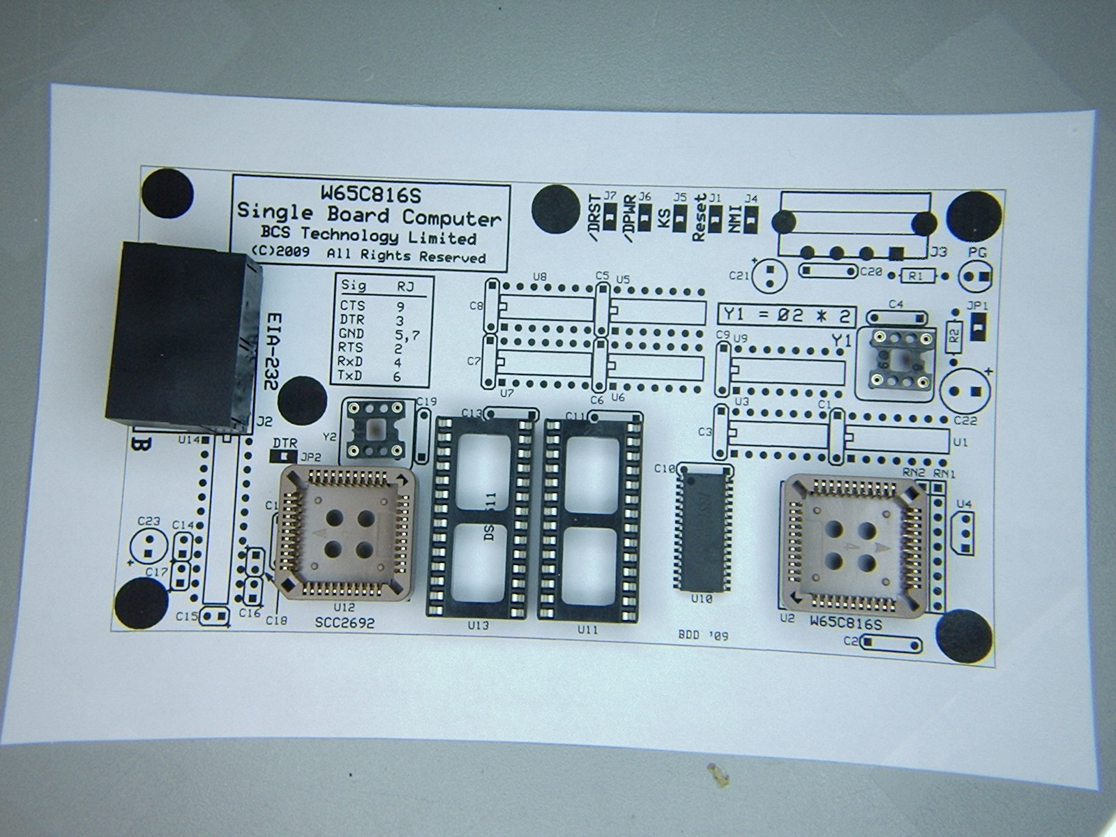

Drass wrote:
Drass wrote:
I was saved from a similar fate by a comment I read somewhere about using a scale-accurate printout of the PCB to check all the footprints prior to sending the Gerbers off.
That might have been me who advised that.
That seems to me very likely BDD. I recall studying your POC units carefully, and more than once applying your recommendations. All very much appreciated! :)
File comment: POC V1.0 on Paper
PostPosted: Thu Mar 04, 2021 12:36 pm
Posts: 229
Doing a PCB printout on paper, 'fitting' actual components on it, then checking for any physical problems, is a procedure that comes highly recommended. It can also help to smooth out the layout a bit more ('I can move that a little bit more that way'). The PCB design itself, as I always say to myself : "check, double-check, triple-check, quadruple-check". Same thing for the related schematic (if that's not okay, your PCB won't be either !).
And then still mistakes slip by occasionally. Which can be very disheartening after you unpack your PCBs. But when everything is hunky dory, it is all the more satisfying ...

working in an electronics company I have seen things only god knows what happened there....
one client specified a schematic and the exact BOM, we made the PCBs accordingly to the BOM and schematic, ordered a prototype and found out they specified smaller parts than they were intended to use. I'm talking about specifying QFP packs when they wanted to use PLCCs....
but since the pcb was quite elaborate and hat to be made with REALLY special requirements (also it was 8 layers...) single run costs were close to 5 figures.. so... it was actually cheaper to dissolve the package in acid, glue the die to the board and bond it directly onto the footprint...
all I know was that we were issued a redesign with the correct footprints and that version went into production, but I quit during the redesign process so I don't know if it ever got finished... an ex colleague said the client cancelled the job the day before sending the files, but I googled the product later and it was available...
but yeah: always make a real-size printout and test all the footprints. saved my butt a lot of times

On my TIM-1 board I added an expansion slot connector, which I've never used, but it turned out to be really useful for debugging. I slid an unmounted socket over the slot and then had convenient pins for for inspecting the entire bus.
My worst mistake was the first board I made, a long time ago. The microcontroller came in a PLCC package, which was quite new back then. My design software didn't have a PLCC footprint so I made it myself, but I got the pin ordering wrong on two sides. It was recoverable with quite a bit of cutting and patching, but was a good lesson in checking everything. Looking at the Datasheet now makes me feel a little better. The pinout of the PLCC doesn't show how the pins are ordered on the socket.
