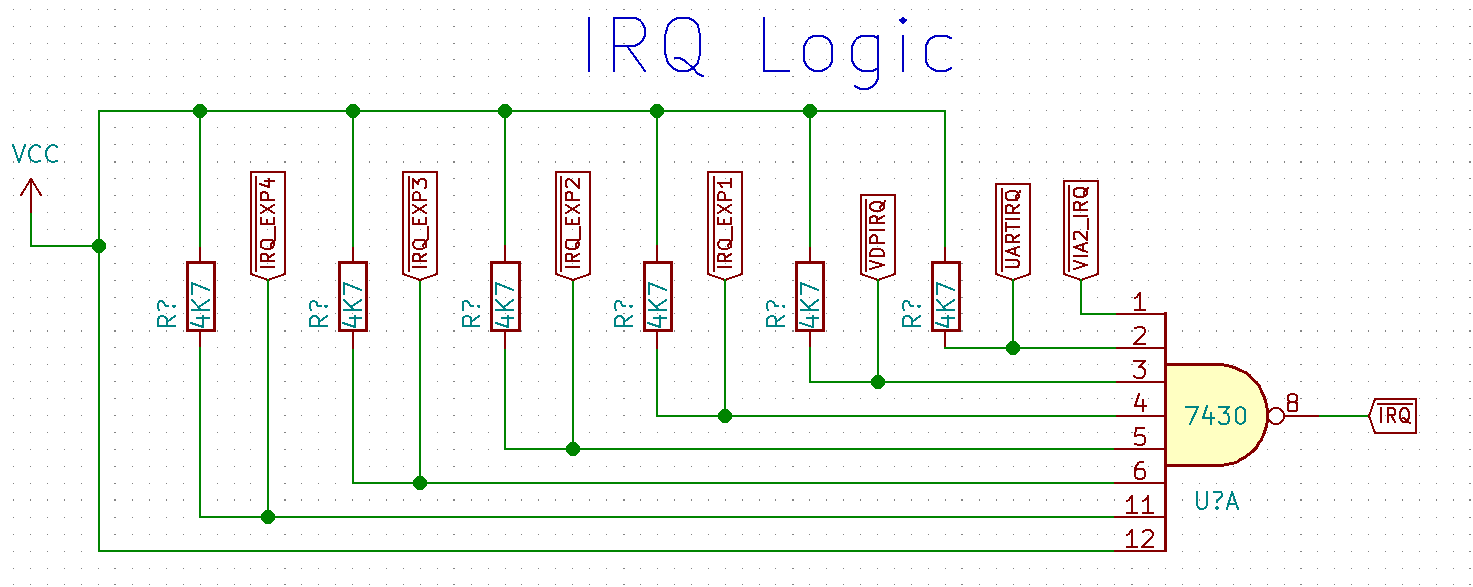

UPDATE:
OK, so just a brief recap. I will have two VIA's, one ACIA, one TMS9918 and FOUR slots that could cause an interrupt.
One of the VIA's is wired to /NMI because it will drive the PS/2 keyboard and SD Card. I figure keyboard input should at least always have priority to allow to (possibly) recover from a crash, etc.
So that leaves 7 IRQ devices. My target speed is between 1 - 4MHz tops. I don't think the TMS chip can handle much greater than 2MHz without wait-states. Which made me think that I might want to arrange everything like the picture below.
I assumed anything approaching 2-3MHz should probably use a totem-pole arrangement but I'm not 100% on that. However, it also bothers me a little that only one device is really using that totem-pole arrangement! In fact, /VIA2_IRQ is mostly to drive audio chips and joysticks.
So I think this is a wasted effort to go totem-pole unless you guys think differently. I've already got 19 chips on this design! :-) It's going to be a big board.
At the end of the day, I will still be happy to restrict the machine to 1-2MHz tops. I guess my question now is, is it worth the effort to use totem-pole like I am doing?
Thanks again!
Remember that the NMI input is Edge triggered - and the VIA flags interrupts from multiple sources by keeping it's IRQ output low, so you'll only see one interrupt to the 6502, so the NMI handler will need to poll the VIA at some point if you are expecting interrupts from more than one source on that particular VIA.
PostPosted: Thu Feb 25, 2021 7:14 pm
Posts: 8468
In keeping with Gordon's note, I don't recommend using NMI for anything other than a single event. Although the VIA may be only one device attached to the MPU's NMIB input, it can produce multiple interrupt events, which must be treated as asynchronous in nature. Your NMI handler would have to be careful to check everything in the VIA that could generate an interrupt, even if not intentionally configured.
Trouble will come if during the tail end of the NMI handler's execution something in the VIA interrupts. Your NMI handler will never know about it and NMIB will remain low. The MPU will likewise never know about the new interrupt and your system may deadlock. Even if you check the VIA's IFR more than once, there is no guarantee you will detect a newly-generated NMI, since some time will elapse between when you make the last check and the NMI handler terminates. If the VIA generates yet another interrupt during that time your goose is cooked.
Bottom line, I would not do what you are contemplating.
In my POC units, I use NMI solely to regain control if a program gets stuck in a loop. A Maxim DS1813 is attached to the NMIB input, along with a pullup and push button. Code in the firmware's NMI handler sniffs the stack in response to the NMI and if it is determined the MPU was executing instructions from RAM when the NMI came, execution is terminated and control is given to the machine language monitor (which is in firmware). Use of the DS1813 works well in this application precisely because NMIB is edge-sensitive.
If you have truly crashed your machine (harder to do with a 65C02 or 65C816 than with a 6502, but not impossible), your keyboard isn't going to do anything for you, since there is a strong likelihood the VIA that polls the keyboard will not be getting serviced. That's when you reach for the NMI push button and hope you regain control. If not, there's the reset push button...
As for the chip count, what all do you have in this thing? You definitely need to get a priority encoder circuit in there to manage interrupt sources. Otherwise, your ISR is going to be eating up a lot of Ø2 cycles figuring out who's interrupting.
Thanks to both of you for your response.
Actually, I think I misspoke. My intention was to only have one true /NMI and the idea was to tie it to a keyboard. But the more I think about that, the more it doesn't really make sense. I was thinking you could press some keyboard sequence (much like the RESTORE key on C64) to interrupt just about anything and return to BASIC. I think it does make more sense to tie it to a "monitor" button. So pressing it would load a system monitor or something similar. I'll see about going with that.
This is my most ambitious project to date. My third SBC and the goal is to pay homage to the computers I most adore. C64, VIC-20, Apple II, TI-99/4A, etc. I think most of the design is nearly complete. I'm finishing up the smaller details like the IRQ, etc.
It will have: TWO VIA's, 6551 UART, MAX238, TMS9918, two AY-3-8912 audio chips, 32KiB RAM (minus I/O), 32KiB ROM, 32KiB video RAM (two banks controlled by VIA) and a couple handful's of glue logic (the TMS9918 takes a lot of glue) and SD Card (using Ada Fruit breakout board).
YES! This is what's holding me up at the moment. I'm re-reading through the primer, etc. I'm studying other designs too. But I'm always interested in a concrete example that uses all these interrupts.
As for priorities, the top priority will always be VDP. There are timing things I want to do at the end of the vertical blank and need to make sure it takes priority. Second would be UART.
Thanks for all the input!

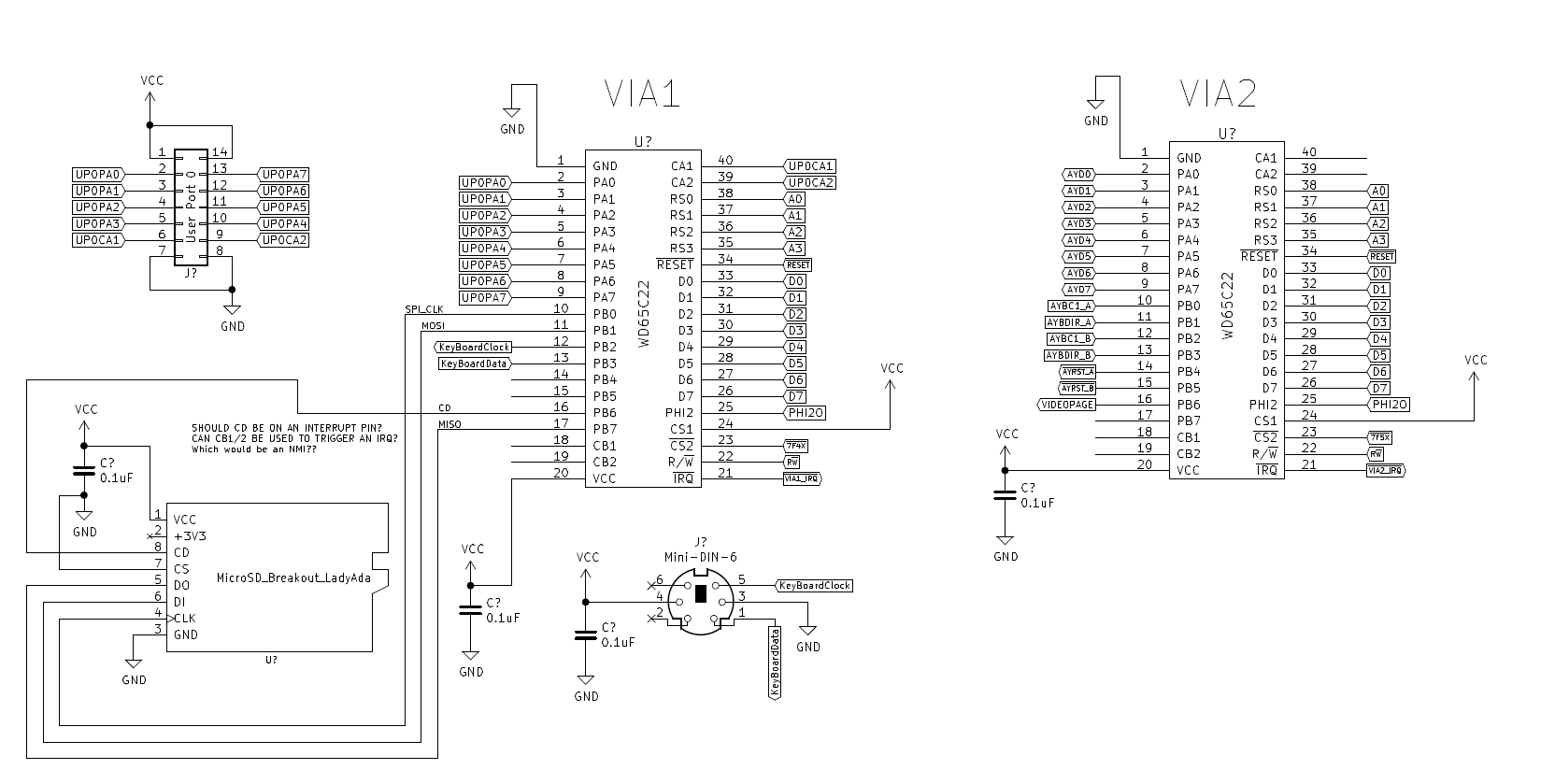

Thanks everyone for such great information and comments.
For the record, this whole project is educational for me. With the added benefit of (hopefully) creating a computer I wanted back in 1980. Other than a few modern conveniences (like SRAM, SD and EEPROM), this computer could have been built in 1980 (albeit expensive).
Anyway, nothing is really set in stone at the moment. My schematics are 90% done. And you know the last 10% is always the hardest. For example, I have two VIA's. Well, even after adding an SD card, TWO audio chips, etc. I have a few pins left over for the VIA's that I'm struggling to find something to use them for. Mainly pins like CB1/2, etc.
So then I noticed...that one of my VIA's is mostly devoted to audio. So why do I need an IRQ on it at all? I guess because I hate leaving any pin unused.
I may start a separate topic on "what to do with unused pins?". LOL
Example of my VIA setup below:
Back to the topic on hand...if I decide to ignore this VIA's IRQ...I would then only have one VIA (keyboard, user port and SD card) a VDP (IRQ ever 1/60th of a second for raster interrupts) a UART and expansion slots.
So I guess I am wondering...is it bad practice to just simply ignore IRQ pins if I can't find a legit reason to use them?
I think I like the idea of having a "heartbeat" that occurs X times per second. That could then maybe read from RAM for the audio. Maybe handle the SD card, etc.
File comment: Example
PostPosted: Tue Mar 02, 2021 5:21 pm
Posts: 10971
Hmm, if you have a VIA and don't connect the IRQ up, you're certainly losing out on some future possibilities. It seems like it shouldn't cost much to add it. (I wouldn't always be in favour of adding things just because you can.)
cron
