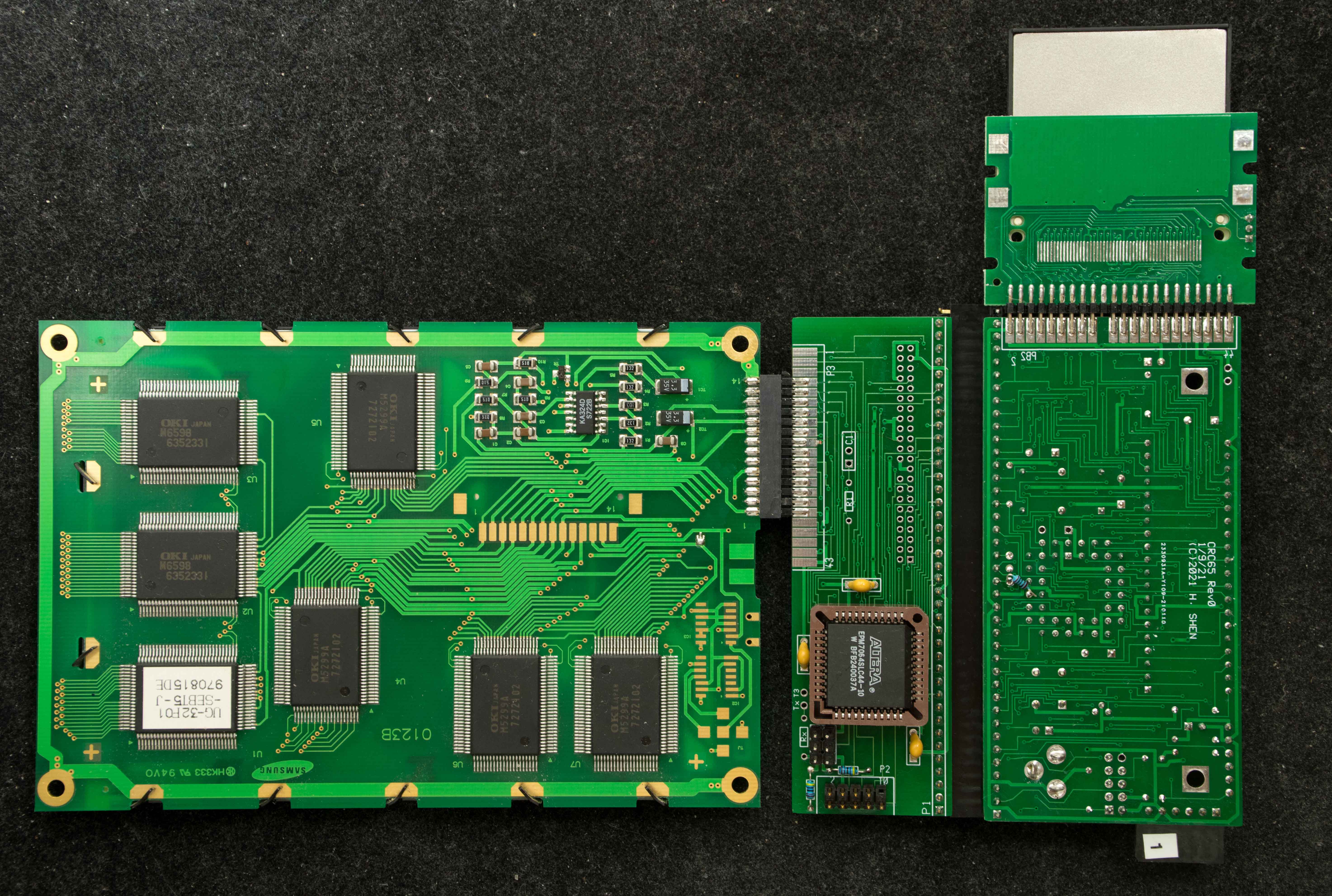

In the Z80 world I probably would use a Z280 which has 4 DMA channels built in. Since this is 6502 forum, I thought I'd try it again using my newly developed 6502 SBC with the help of a CPLD I/O board. The CPLD I/O board was a CF drive interface board re-purposed as LCD interface. I'll need to make some cuts and jumpers and reprogram the CPLD, but conceptually it looks like the attached photos.
File comment: CRC65 SBC with CPLD I/O board driving the UG-32F01 320x240 LCD display

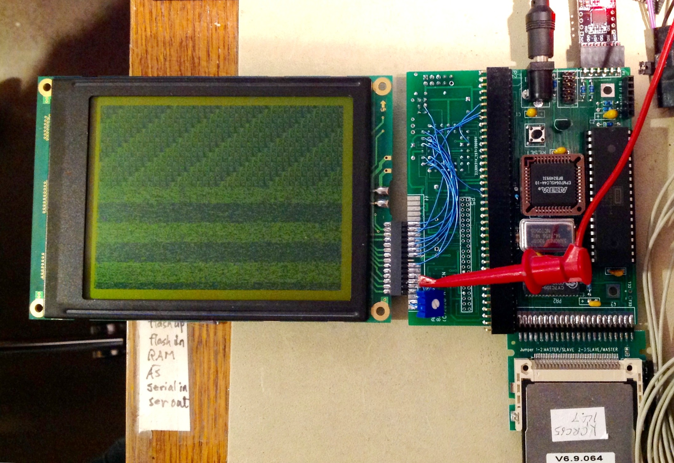

Sometimes just KNOWING that I'm on the right track is enough to solve the problem. Before I dive into your ATmega program trying to understand yet another assembly language, I thought I take another fresh look at my LCD interface logic and software since I'm using a new CPLD board with 6502. I found a couple mistakes and fixed them. Now I can actually display a pattern on the LCD! This is very encouraging.
File comment: UG-32F01 displaying a pattern

PostPosted: Mon Feb 01, 2021 1:38 am
Posts: 1120
This is the program driving the display in my previous post. The display memory is 10K from 0xC000-0xE7FF. It started off with random display data and then filled it with one-byte pattern every frame. It took 2 minutes 10 seconds to fill the entire display this way. So that's 10K frames in 130 seconds or 74 frames per second, which is what I measured with a scope. This is 6502 is running flat out moving display data to the LCD display, not very good use of a 6502, but now I understand how it works, I can start to replace the software with hardware.
