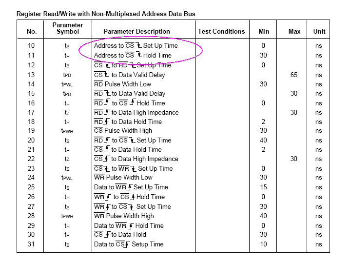

My code was treating those registers as being in little-endian order and my mention of the XBA instruction was erroneous. So the 16-bit write to registers $00 and $01 should have worked.
Hmm, alright... without the XBA the byte order of the 16-bit write would be correct.
Instead it could be something about the 16-bit write itself that's problematic -- I mean the fact that there are two consecutive accesses to the device. Time to look at the datasheet!

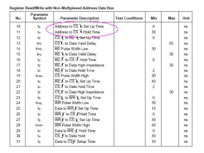

Somewhat unexpectedly, it's seemingly not OK for /CS to remain low throughout two consecutive accesses. tPWH is supposed to be at least 30 ns, but I suspect POC's decoding is such that /CS simply remains low. That's something that could be changed, but probably the payoff is too small to make it worthwhile, given that it's a low-priority issue.
Edited to add: tS and tH (below) make it clear that the address gets clocked in by the falling edge of /CS. We recently encountered the same thing in this topic: Using FM1808 as RAM
AM53CF94_AM53CF96.pdf [572.19 KiB]

Instead it could be something about the 16-bit write itself that's problematic -- I mean the fact that there are two consecutive accesses to the device...it's seemingly not OK for /CS to remain low throughout two consecutive accesses. tPWH is supposed to be at least 30 ns, but I suspect POC's decoding is such that /CS simply remains low.
I/O decoding in POC is fully qualified by VDA and VPA. So in theory, a chip select should not occur during the early part of Ø2 low and hence the CF94's /CS should be released for a brief time. I don't know that that is actually happening. At the time I was looking at this problem I didn't have the means to watch all the relevant signals to see exactly what was going on with /CS. I do now, so at some point I will revisit this as a matter of "professional curiosity."
As noted, it's a low-priority thing. Being able to configure the DMA transfer count with a single write makes for aesthetically-pleasing code, but has virtually no effect on performance—the setup is done only once per SCSI bus transaction.

The SCSI controller needs to accept an 8-bit write to address $00 followed by another 8-bit write to address $01. By my reading, the datasheet says we'll need /CS to have one falling edge that clocks in the $00 and another falling edge that clocks in the $01. That implies it must go high in between (and the diagram shows that). Am I missing something? Or is there confusion between BDD's project and tokafondo's?
