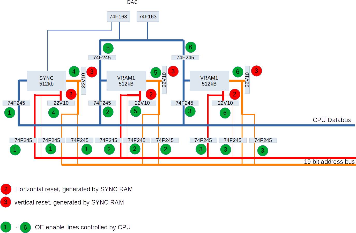

Now that I solved my monitor problem I went back to the drawing board to give more details to the design of the VGA generator. Here is a block diagram I came up with:
In a second step I detailed it out in KiCAD.
PDFs both in color and BW are attached.
Theory of operation:
I have 3 static RAMs. One holds sync information, the other two 6bit video signals (2 bit for each color). Each RAM can either be addressed by a counter, or by the 19 bit address bus. X and Y counters are created by 22V10 (10 bit counter each). I decided to give each of the 3 RAMS its own counter pair rather then routing the signals and separating them via 245 chips. The address bus is separated from the RAMs by three 74F245 (or 74HC245) chips. The counters have separate output enable controls.
All RAMs 'share' a databus, but again 74F245 chips will separate the bus into segments.
The 163 counters at the output are simply used as registers (they never count) - but I can use their CLEAR signals to enforce complete blanking.
During operation the main CPU first sets up the sync ram. This RAM generates both H-sync and V-sync for VGA and resets the X and Y counters. At any given time one data RAM provides in parallel to the sync RAM all information needed to display the signal. CPU (and additional block-copy hardware) will set up the new image in the second ram, then the 2 data RAMS switch places and the next round begins.
For the switch I probably will need some additional flip/flop to prevent switching in the mid of drawing a picture.
comments?

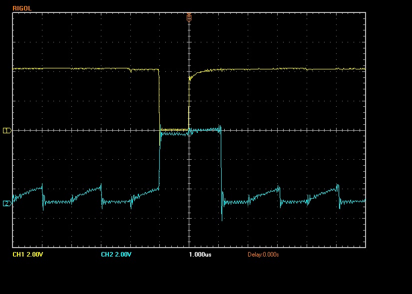

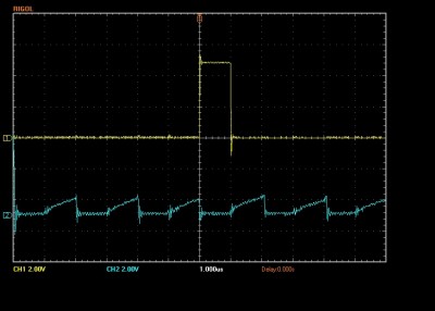

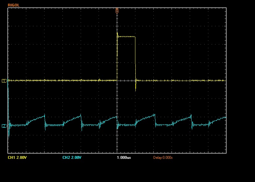

PostPosted: Fri Aug 07, 2020 4:42 am
Posts: 60
babysteps... or baby crawl?

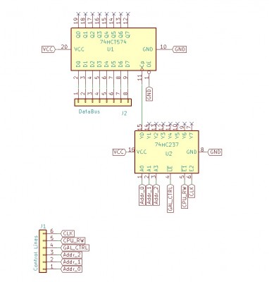

I added a 74HC574 buffer to the computer.
A 74HC237 3-to-8 decoder is attached to address line 0-2, as well as clock and R/W signal. The final piece comes from the GAL controlling the memory layout. Any access to address 0x0340 should trigger output line 0 of the 237 decoder. This in turn would on the rising edge trigger the 574 buffer and store the contents from the 6502 databus.

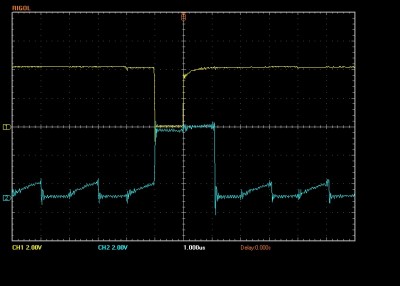

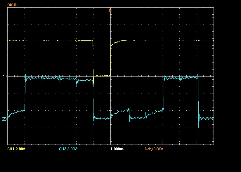

Worked like a charm, EXCEPT.... the output of bits 0 and 1 ALWAYS was 1.
Analyses with the oscilloscope soon showed the reason though. When writing 00 to 0x0340 I got these images
Bit 4 looks as expected, but Bit 0 shows
that the data lines are still high from previous operation (sta #$00 #$0340). Solution - swap out the HC237 which gives an active HIGH signal with an 74HC138 which is active LOW. The 574 will still act on the rising edge, but that happens now half a cycle later. Here are oszi-trace of bit 0 and bit 4 when writing 0xF0 to the port:
The bits seem to stay up through the next half cycle, so I hope this will work.

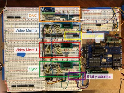

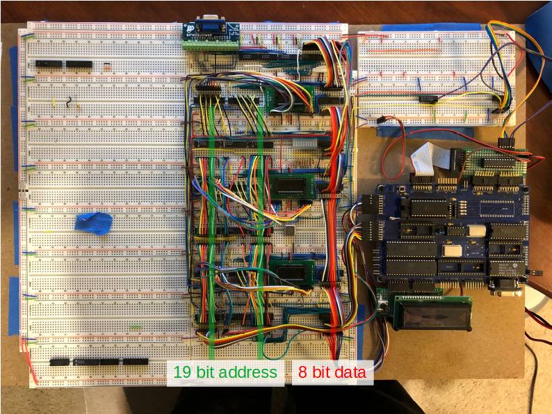

Update time. I finally finished my wiring on the breadboard. The final layout has 4 blocks:
On top I have a DAC. Two 74F245 chips select from which of the 2 video memories data is transferred to the three 74F163 chips. Those counters are only used as buffer, to ensure data remains unchanged until next clock pulse.
There are 3 blocks for sync memory (generates Hsync/Vsync/Blank signals as well as counter), video buffer 1 and video buffer 2. They are pretty identical. One 10-bit counter for X, one 9 bit counter for y. Three 74F245 allow to alternatively set memory addresses from the CPU. Another 245 chip regulates access via the general databus.
The three blocks are connected by 2 buses - one for address and one for data. 8 bit of the address bus are implemented via a 74F574 chip, the remaining 11 will come from the CPU directly. There is one control chip (another 574) to regulate which counters/245 blocks are used at any given time.
Next step - take out a multimeter and test all connections :)

Update after a long long debugging session ..... I came up with a very strange error in my GAL (Atmel 22V10C) used for chip selection.

With this code - whenever I put anything (even just an OSZI probe) on pin 21 (aka !WINDOW), the whole systems becomes erratic (probably only for the code that activates !WINDOW). LEDs active only for short amounts of time drop in intensity over the whole system (I suspect the average time they are on drops), and the code starts to behave differently. Now the bummer - if I change that last line to
N_WINDOW = WINDOW;
everything behaves as expected.
Any ideas welcome :)
