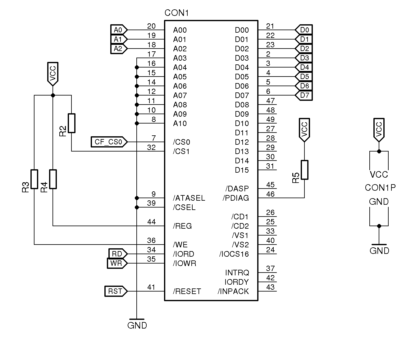

Trouble in a new project often is the result of a wiring error. The CF card itself probably has several pins which serve as Ground, and all these pins are connected together... inside the CF card itself. So, suppose on the CPU side there's a data line (or other) which, due to error, connects to a socket pin which in turn is bused together with the other Grounds inside the CF. That means the data line (or whatever) gets shorted to Gnd whenever the card is plugged in. But the short disappears if the card is physically removed from the socket.
This theory makes sense, but I checked connections on my schematic multiple times. It looks identical to the one from this site. So if if there is no error there, the only explanation will be that some neighboring pins are bridged somewhere. But I also examined connections under magnifying glass and everything looks fine.
Well... There is one difference. In my circuit pin 45 (LED ACTIVITY) is not connected. I assumed it is just an output and left in unused. Is it possible that this is the cause of my problem?

I’ll ask the obvious... are you sure that all lines that are grounded, are in fact tied to ground and the same for for VCC?
As you can see on the schematic above. If there is no faulty connection, everything should be fine.

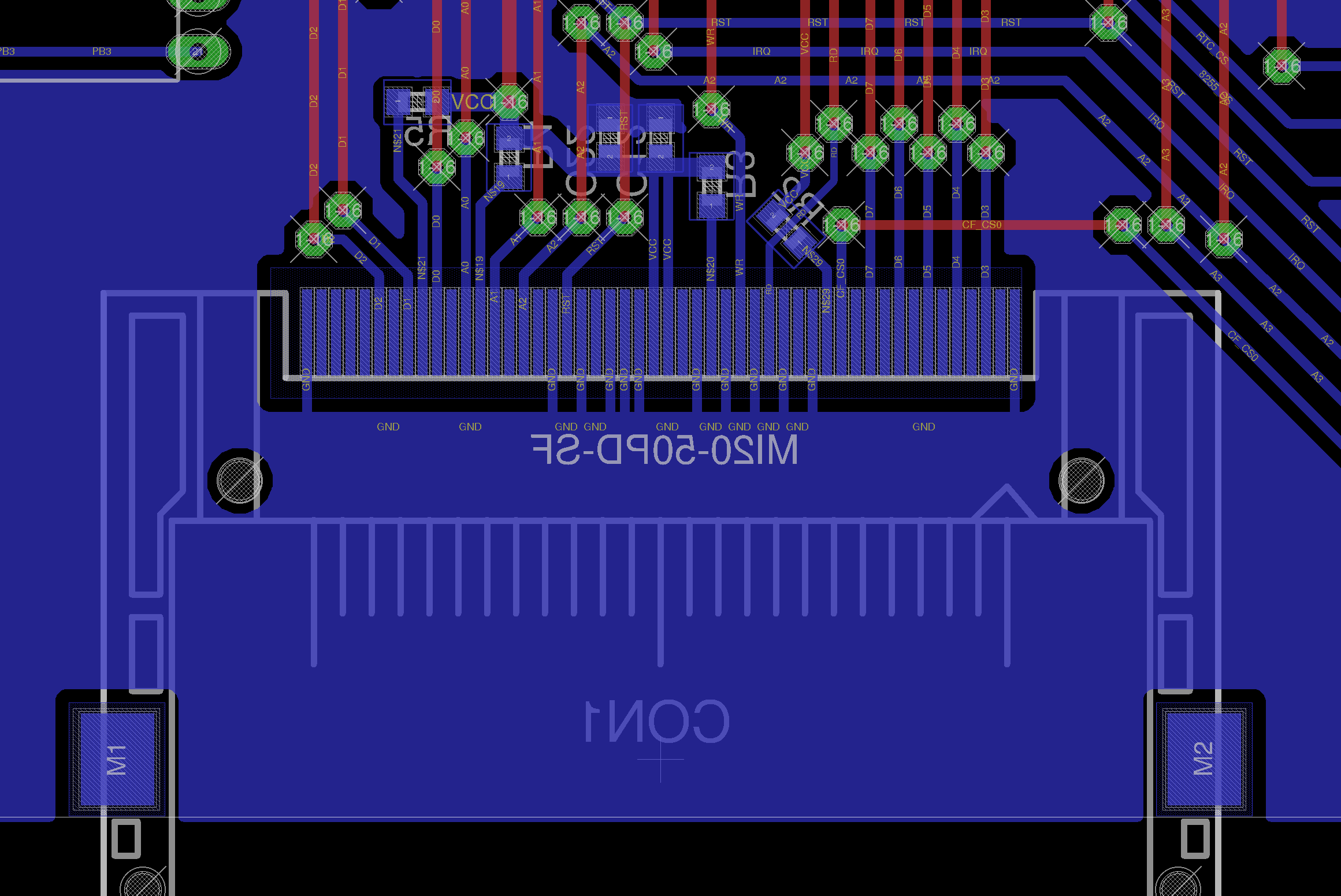

About the PCB design, it looks like this.

Well, the PCB layout looks correct, good news there!
There is the slight chance of a hairline short between pins 2 and 26 however. Note that when the CF card is inserted, it grounds pins 25 and 26. As these are not connected to anything, a slight short between pins 26 and 2 would result in databus D3 shorted to ground. It's worth taking a closer look there just to be safe. The same can be the case on the opposite side, with pins 25 and 49, but that "shouldn't" keep the board from booting up.
Beyond this, perhaps you really do have two defective CF cards.
PostPosted: Thu Nov 07, 2019 8:50 pm
Double-check your PCB layout and ensure the lines are correctly routed to the CF socket.
Yes. And remember, as part of the double-check, to verify that the layout for the CF socket hasn't accidentally been created backwards -- a mirror image. That kind of error can arise due to confusion between the component-side view of an item and the copper-side view.
Don't forget to also question the documents you're using for reference, as they may happen to be easily misread or, in rare cases, just plain incorrect. In a head-scratching case like this, I would consult a second document for verification.

There's one other possible gotcha as well. You can get an inverse socket. If you look closely at compact flash media, there is a slot down each side, but they are different widths. This is how the media is keyed to the socket. Some manufacturers make an inverse socket, where the slot keys are reversed, so the media pops in backwards, i.e., flip it over and insert it.
Based on the PCB layout, pin 1 is towards the right side, looking from the back where the socket is soldered to the PCB. Based on this, the label on the top of the CF card would be showing when inserted, even with the socket on the back side of the PCB. If this is not the case, then it's an inverse socket and there's a (big) problem!

Things are getting even weirder. I decided to solder different CF card slot. So I removed the old one and cleaned pads with solder wick. Using the opportunity, I inspected pads with magnifying glass. There was no sign of short circuit between neighboring pads.
After mounting new socket nothing had changed. Computer behaves in exactly the same way as before...

Atlantis, can we be certain it's not the case that the old CF socket and the new one you installed are both inverse?
Knowing how tricky it can be to write (and to read) a physical description like the one floobydust provided, maybe you should provide us with a photo of the card in the socket. Then he can directly determine whether you have the inverse style. Just a suggestion. :)
If the sockets really are OK then I agree the next theory to consider is that you have two defective cards.
