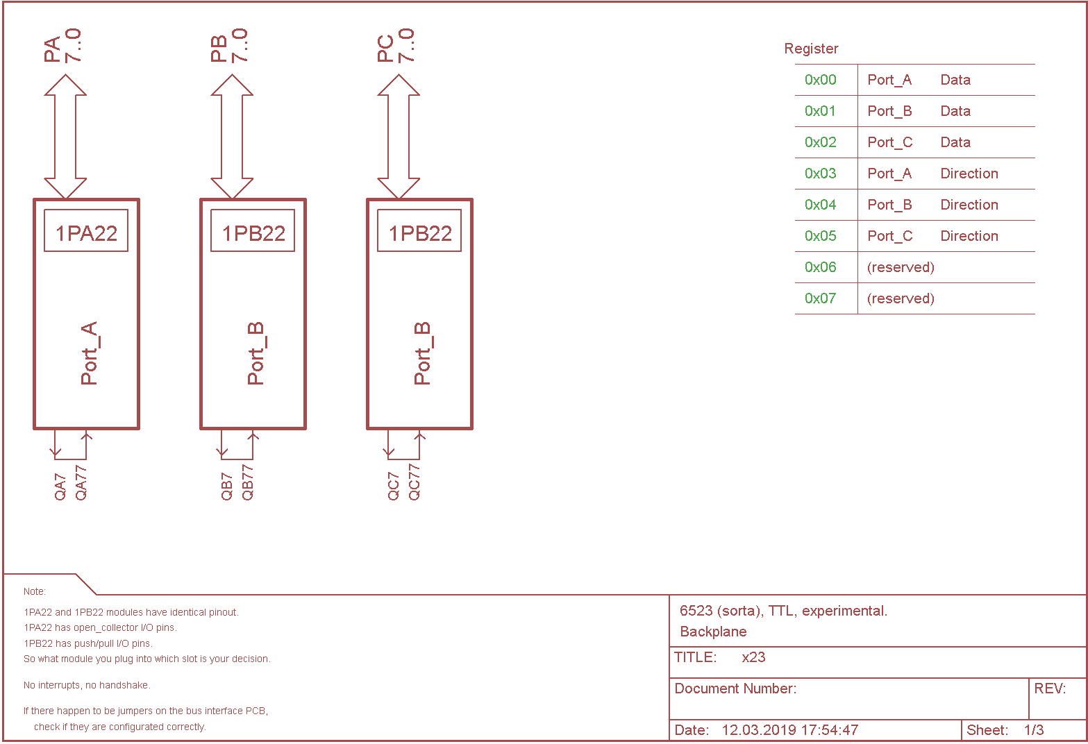

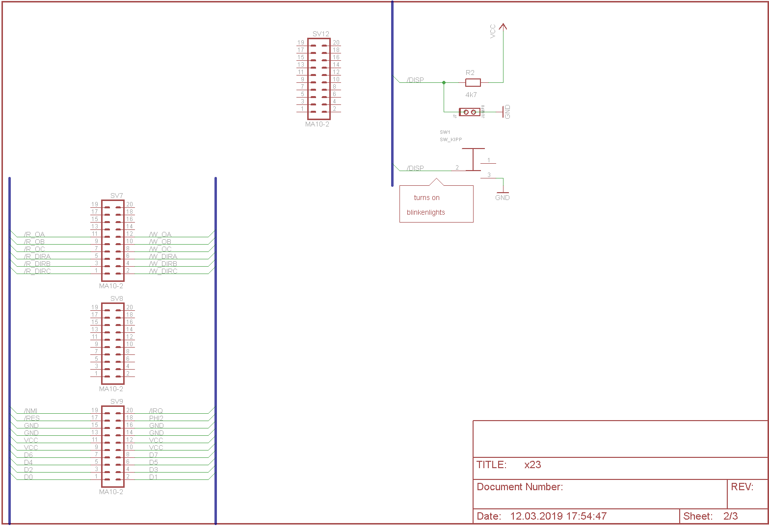

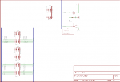

Since I don't know, for how long I'll be able to open Eagle 3.55 project files,
I think it's a good idea to post the rest of it... as spare time permits this.

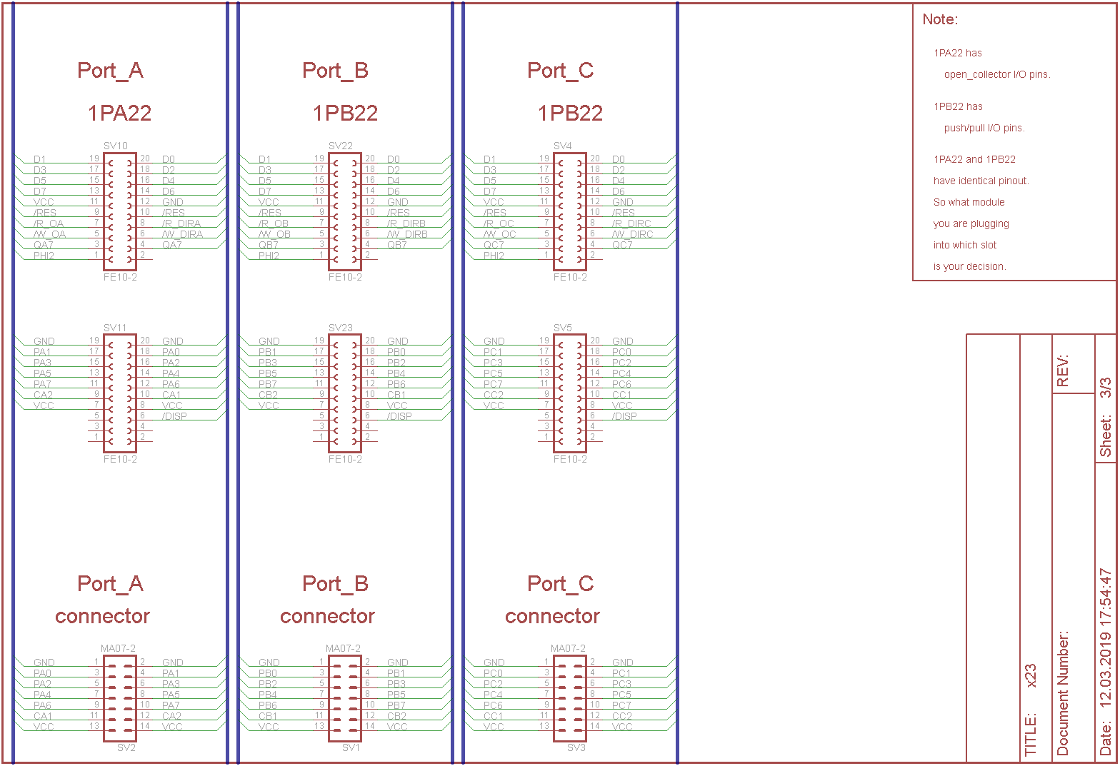

X23 was sort of an "experimental 6523", which had three I\O ports.
The X23 backplane was plugged on top of the 2B22 bus interface from the X22 TTL 6522 project,
jumper settings on the 2B22 bus interface just were different from "X22 mode", of course.
For the I\O ports, 1PA22 and 1PB22 modules from the X22 project were used too.
BTW: pinout for 1PA22 (open collector outputs) and 1PB22 (push/pull outputs) modules were identical.
It was my test adaptor for the 2B22 bus interface and the 1PA22\1PB22 I\O modules,
because it took less current from the power supply than X22 when running loop_back tests
with a ribbon cable between two I\O modules.
Oh, and I forgot to mention:
IIRC the I\O connectors on the X22, X21 and X23 backplanes were supposed to be compatible to Daryl Rictor's SBC2.

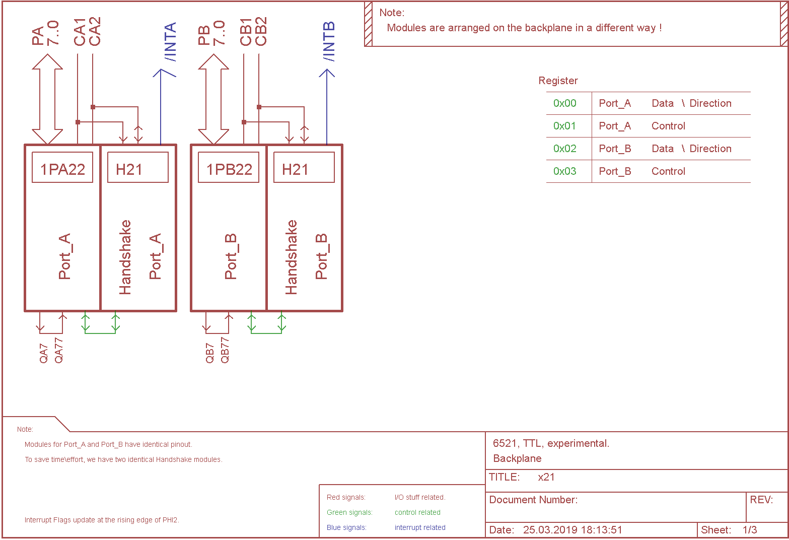

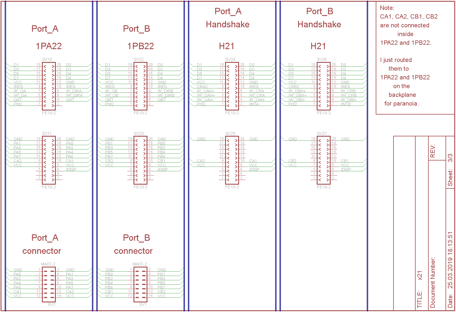

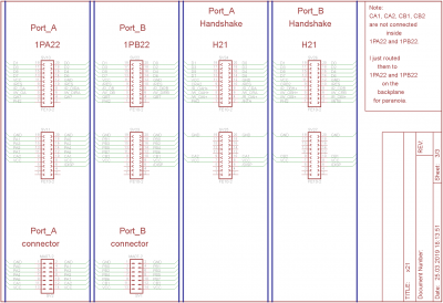

X21 was an experimental 6521\6821 implementation.
From the datasheets, I failed to see a noticable difference between NMOS 6521 and 6821.
2B22 bus interface from the X22 project (6522) is plugged into the 6502 computer.
X21 backplane is plugged into the 2B22 bus interface (which has different jumper settings from "6522 mode" and "6523 mode", of course).
Plugged into the X21 backplane, we have:
1* 1PA22, Port A module
1* 1PB22, Port B module
2* H21, handshake module
PostPosted: Mon Mar 25, 2019 5:18 pm
Posts: 1431

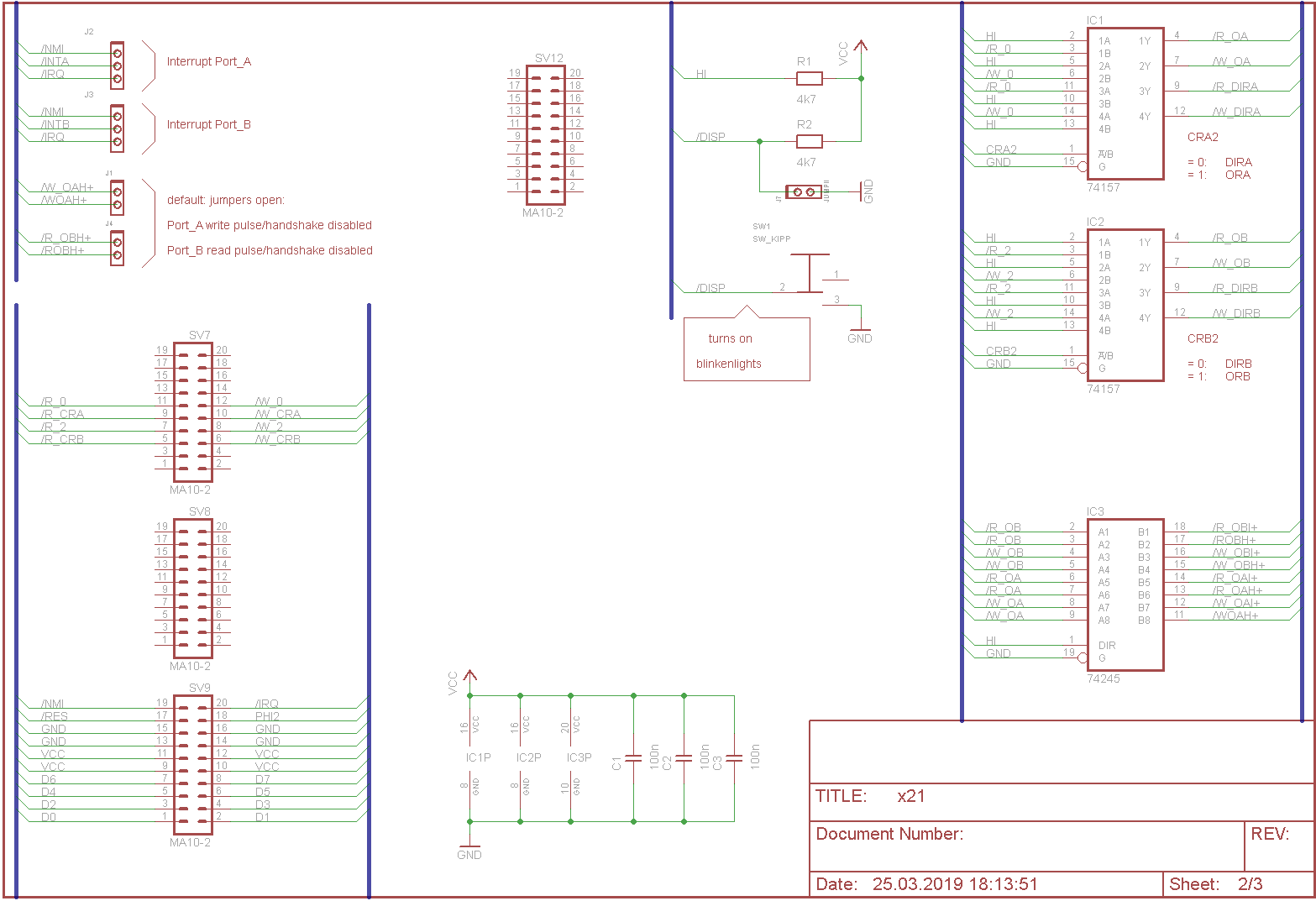

We got 2B22, 1PA22, 1PB22 already covered up in the thread.
So I'm posting the X21 backplane:

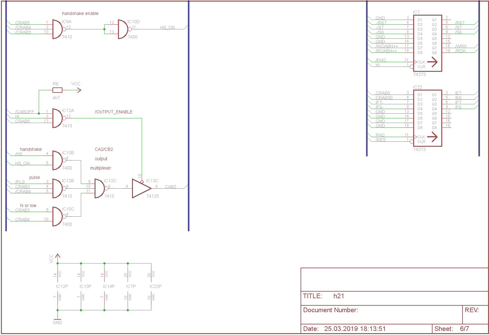

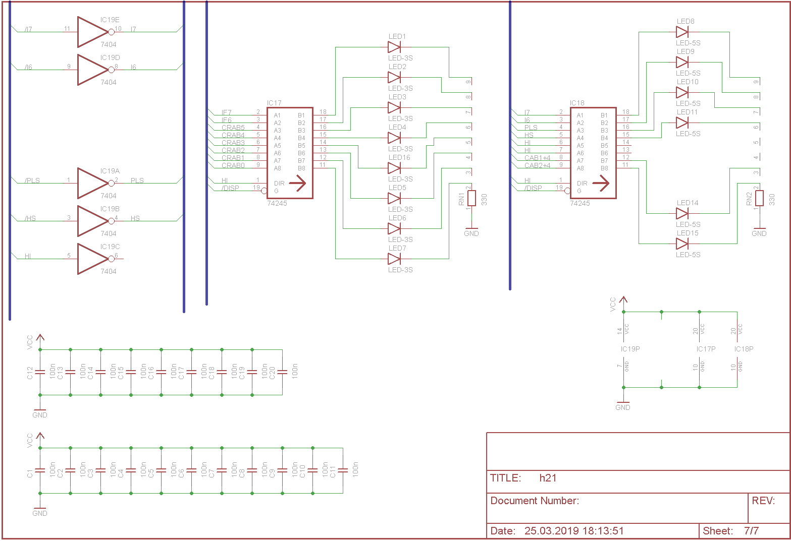

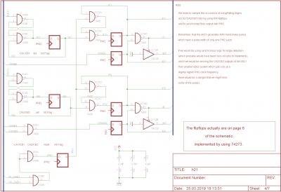

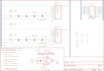

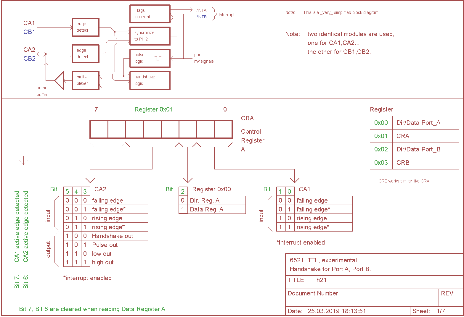

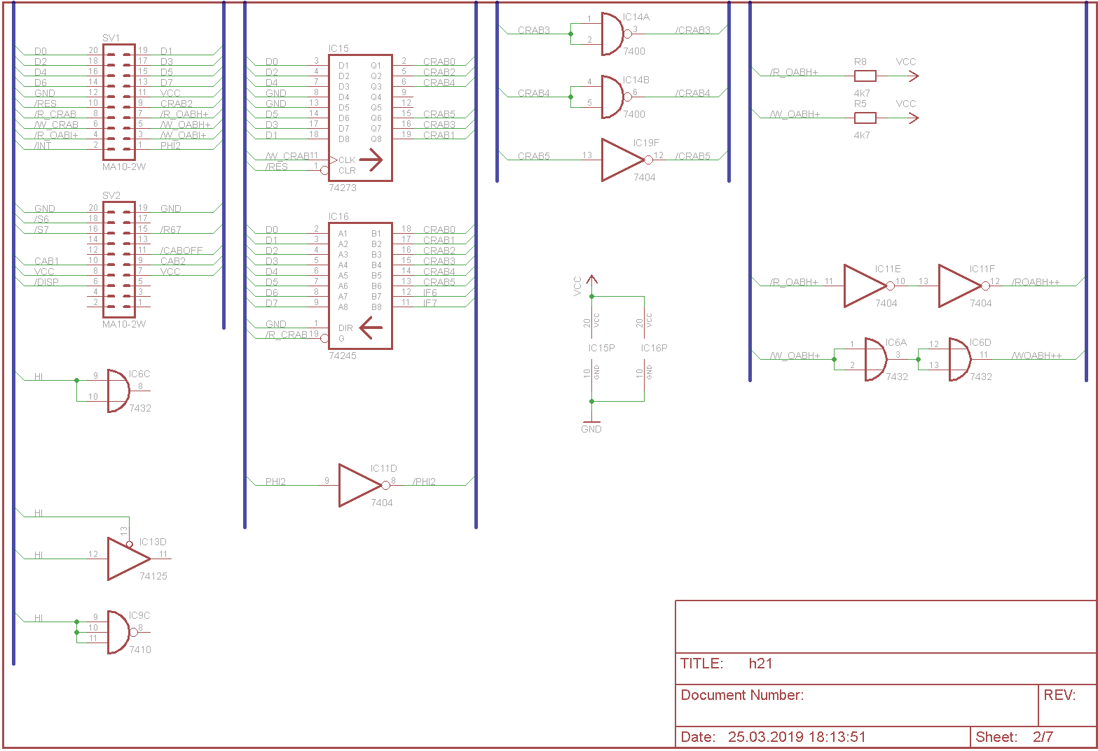

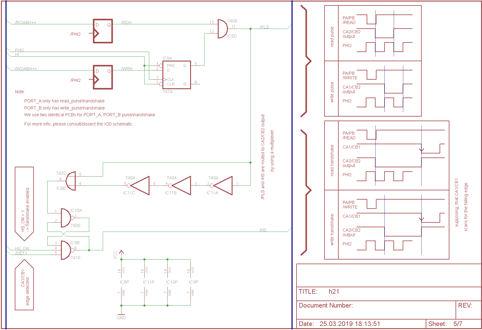

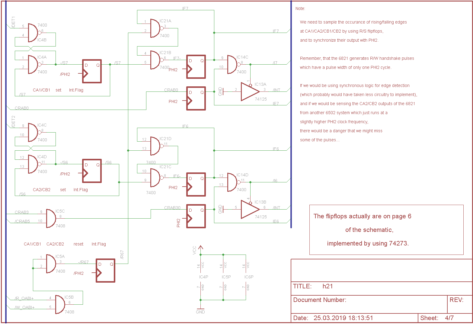

H21 was the handshake module, two modules required.
The H21 handshake modules also had contained the interrupt logic.

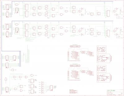

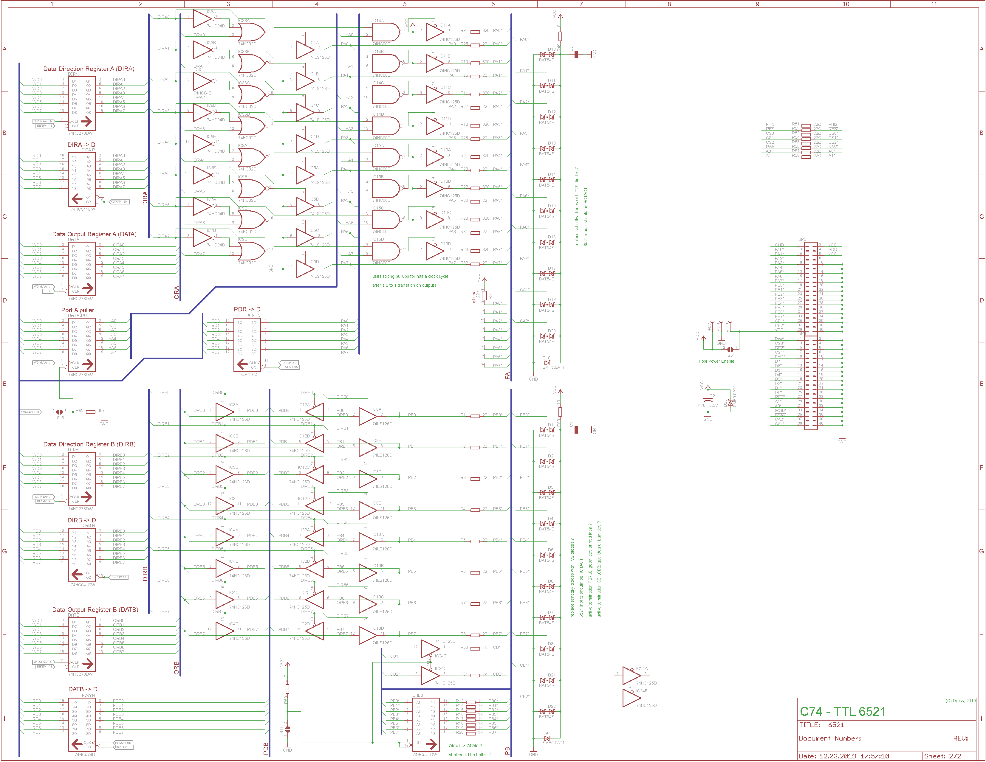

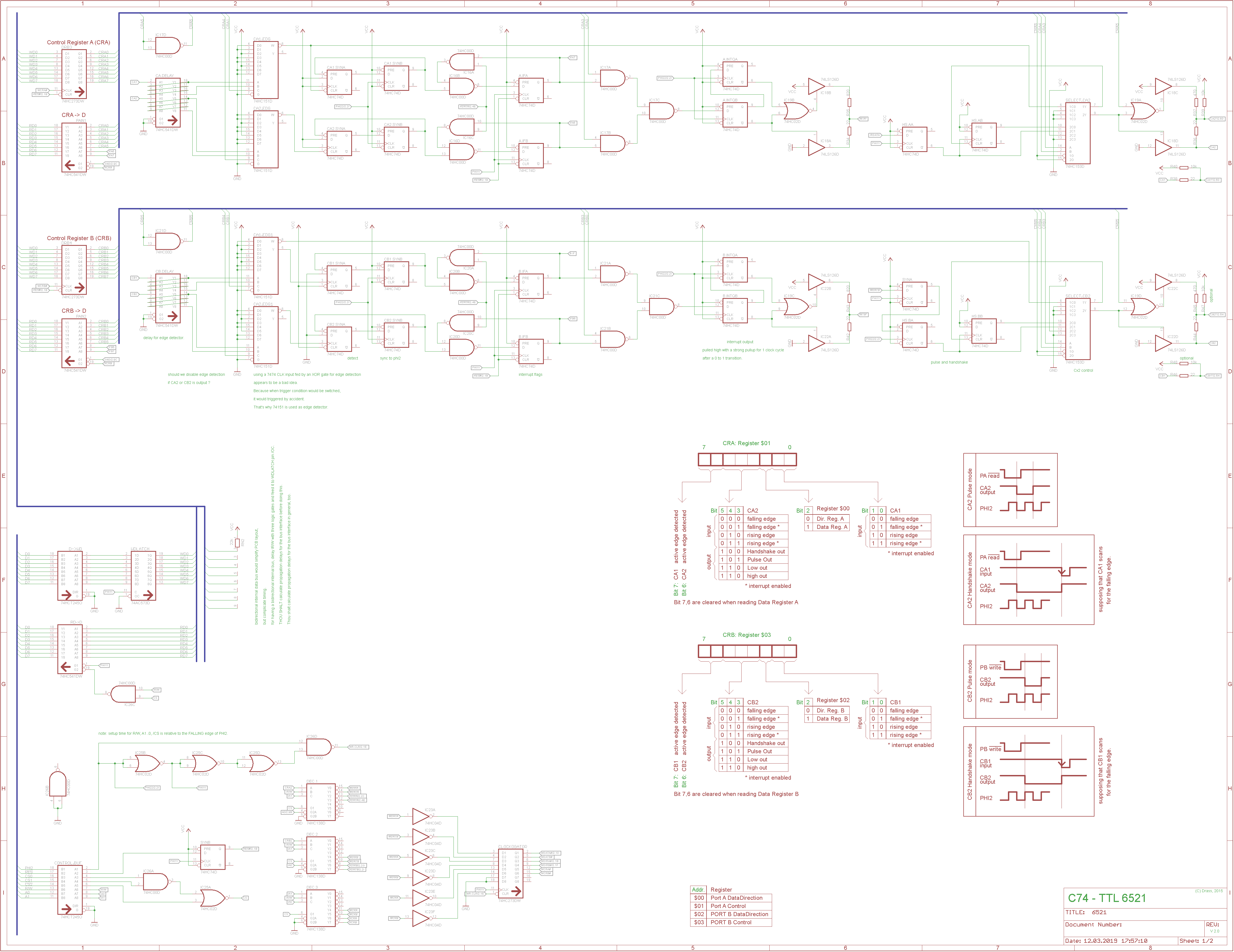

Now for another untested paper design,
an experimental TTL 6521 which is supposed to be able to make 20MHz.
You better carefully check and re_think everything before trying to build something based on these old schematics.
...And that's enough for a day. 6532 will be next.

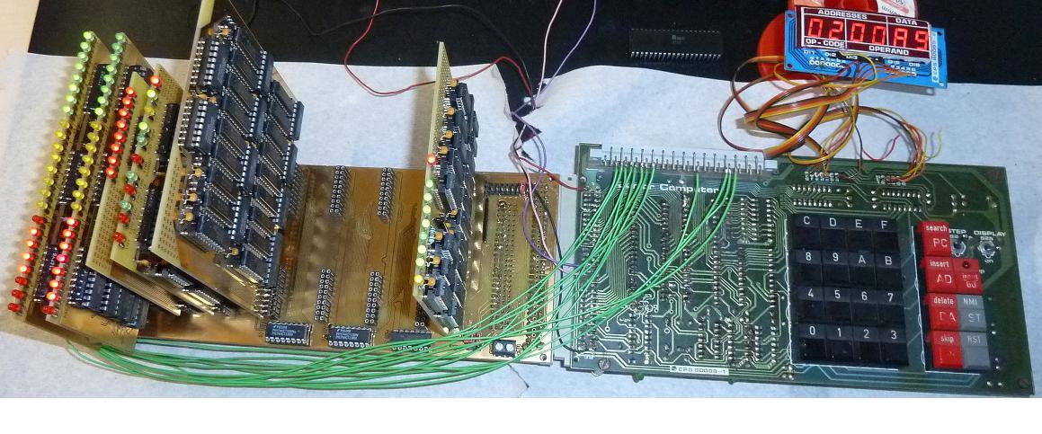

Thanks for the kind words.

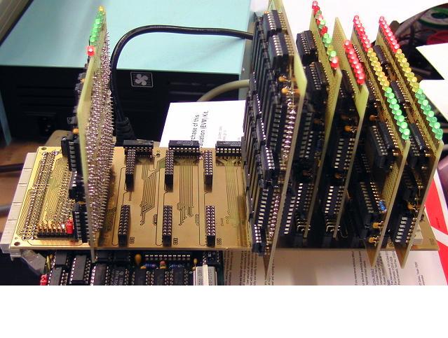

Right: 1980, my first hobby computing project. Elektor Junior Computer hobby kit.
Left: 2015, my last hobby computing project. X32, experimental TTL implementation of the 6532.
X32 had some bugs, be warned.
Plugged into the X32 backplane, we are supposed to have:
1* T32, timer module
1* I32, timer control and interrupt module
4* R32, 4* 32 Bytes of RAM that is... (only 1 module was built)
1* B32, bus interface
