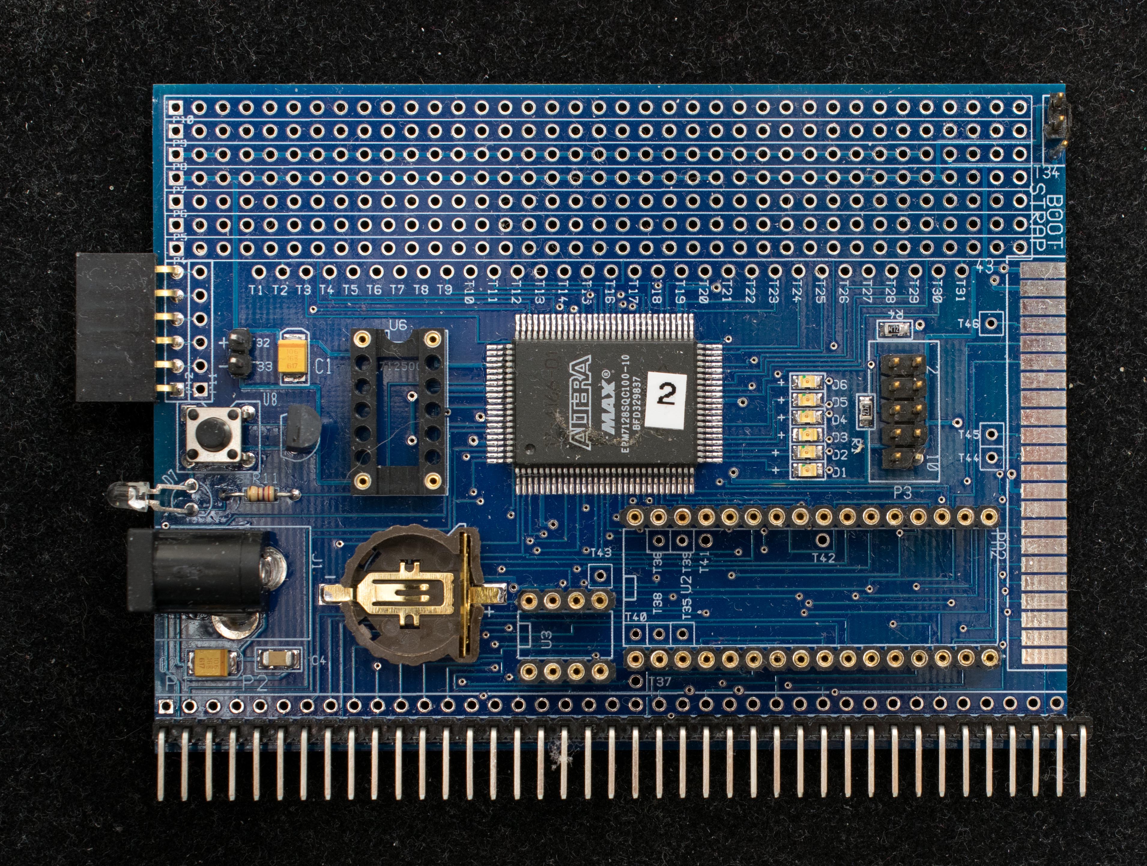

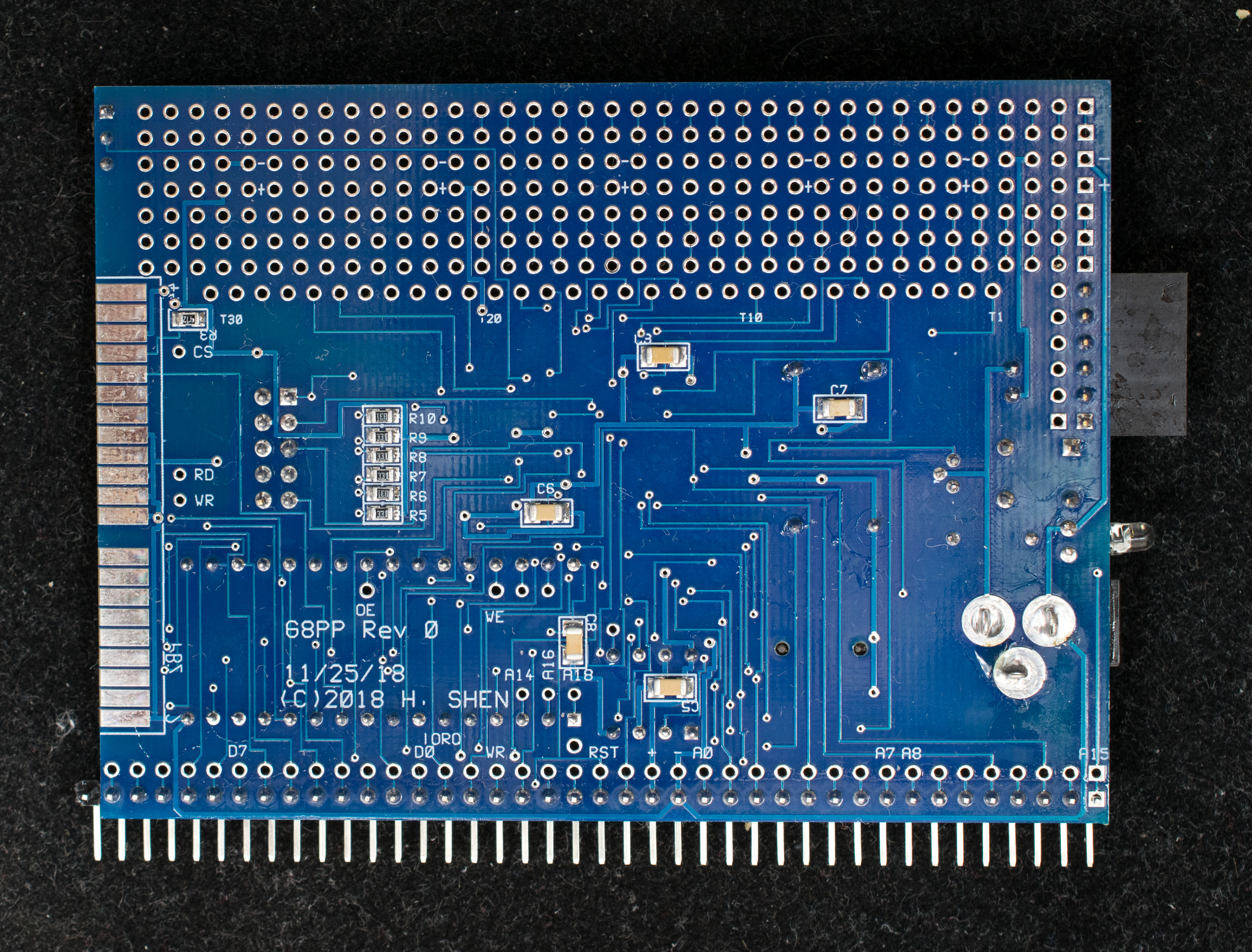

Let see if I can load decent photos to the forum:
This is the baseline G8PP board I started from yesterday.

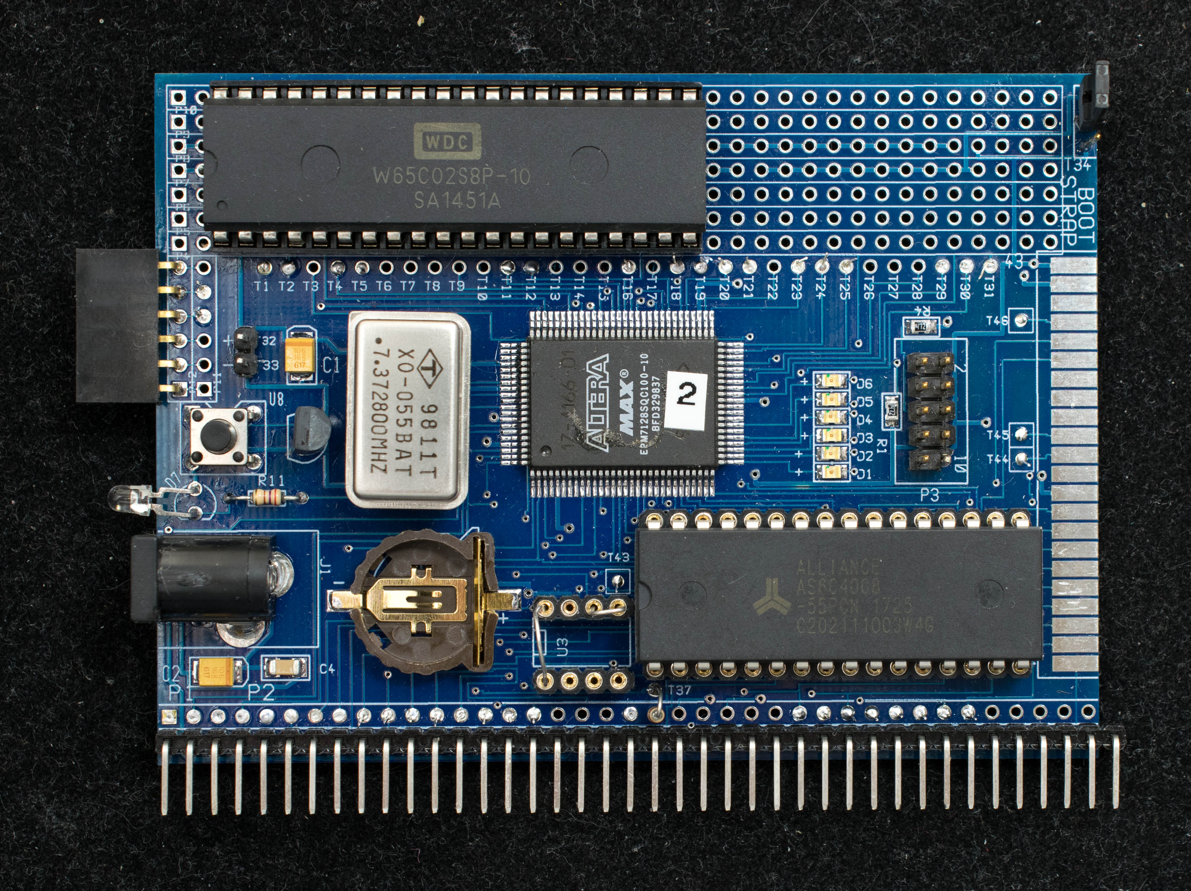

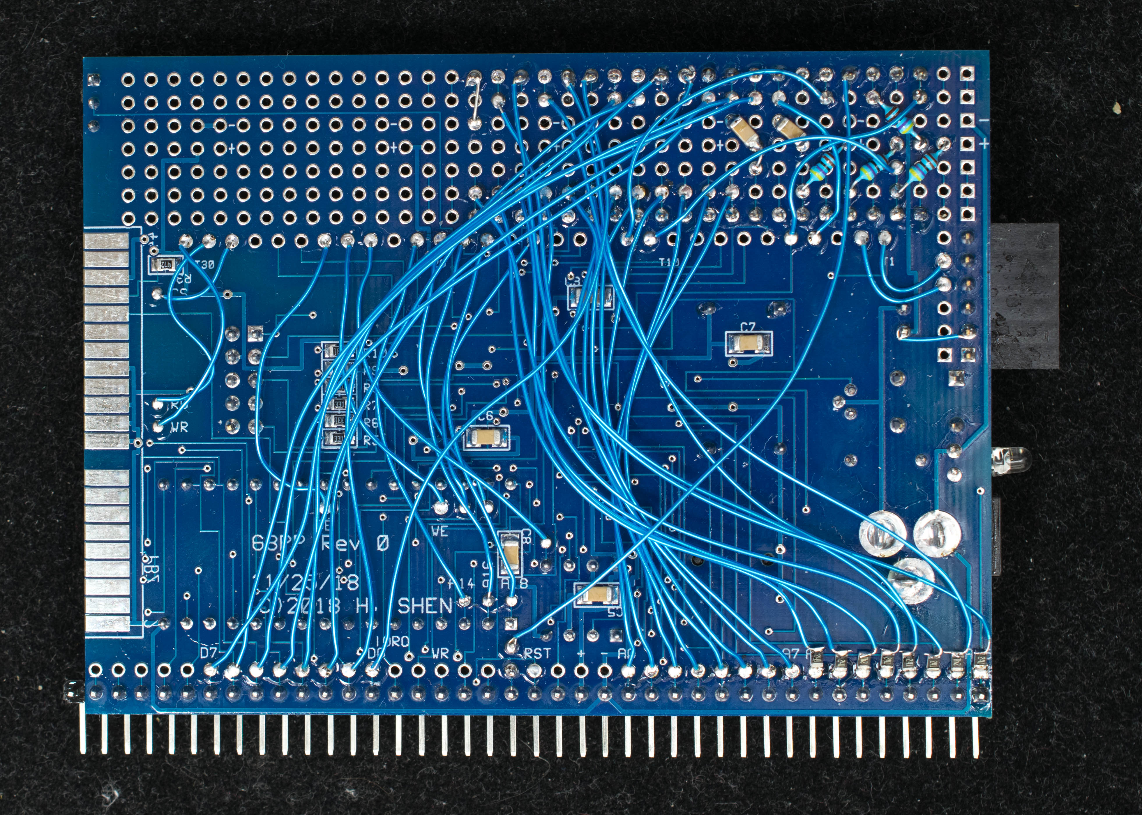

This is the G8PP+6502 as of a couple hours ago. The series resistors on address lines are not yet added in the photo. Clock is 7.37MHz. Signals look reasonably clean on the scope. I think I'm loading serial data into RAM and observing it bootstrapping after 255 bytes, but it is not executing correctly. There are many moving pieces to this puzzle, one of them is that I don't know much about 6502 assembly instructions. Climbing a steep hill but having fun!

The logo on the chip doesn't look right - starting to think you may have a dud...
