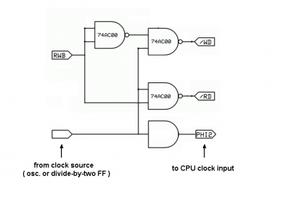

PostPosted: Sun Jun 17, 2018 7:12 pm
Posts: 660
Location: North-Germany
That's really interesting: the data hold timing of the WDC65C02 (and presumably that of the 65C816) is so small that a few ns delay - the necessary gating of RWB with Phi2 - is too much. Perhaps a few pF on the data bus may help as well. This was probably not intended by the designer but with slower CMOS processes (> 0.6µ) perhaps never observed.
Glad that I could be helpful.

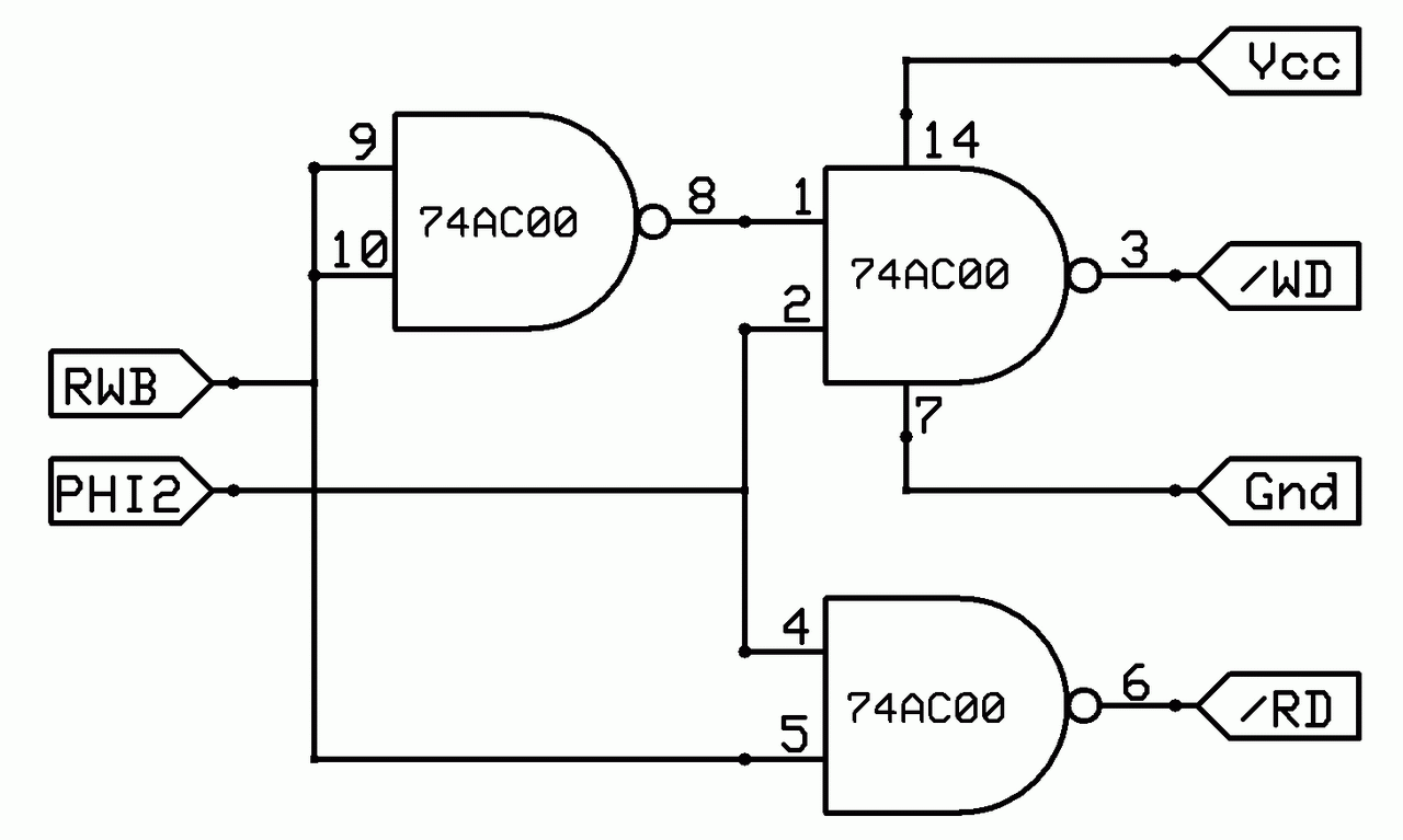

PostPosted: Sun Jun 17, 2018 8:29 pm
Posts: 8514
BillO wrote:
BillO wrote:
I'd like to see the schematics for the system clocks of some working projects.
The attachment clock_gen_2phase.GIF is no longer available
Above is what is in my POC units. I don't actually use the PHI1 output—I illustrate it for anyone who might need it.
Thanks for sharing BDD.
What do you use to qualify your write signal with Phi-2? What is the estimated timing cost?
Below is a variation of what I used in POC V1 (all discrete logic). The variation is one section of the 74AC00 is being used as an inverter—an actual inverter was used in POC V1.
File comment: Read/Write Qualification
Assuming a 5 volt circuit, each section of the 74AC00 has a propagation delay that will vary from 1.9ns to 6.6ns over the full commercial temperature range. In my design, I worked off the worst-case of 6.6ns, and could boot the unit on a 15 MHz clock, despite use of a 55ns EPROM.
As can be seen, both /RD and /WD will lag Ø2 by one gate delay. This worked out well with the 65C816. The 65C02's read-write timing is like that of the '816, so I'd expect to see similar results.
EDIT: Fix gate delay reference relative to Ø2.
Last edited by BigDumbDinosaur on Mon Jun 18, 2018 6:02 am, edited 1 time in total.

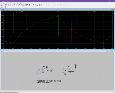

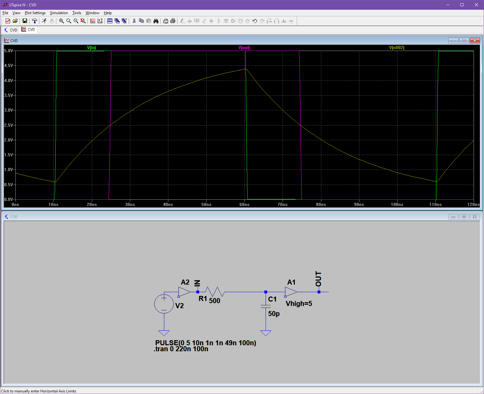

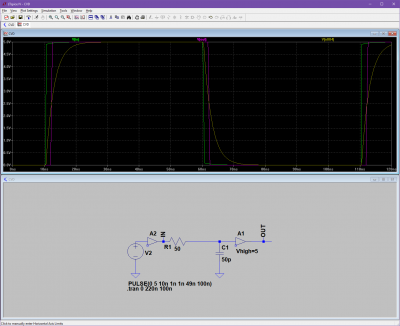

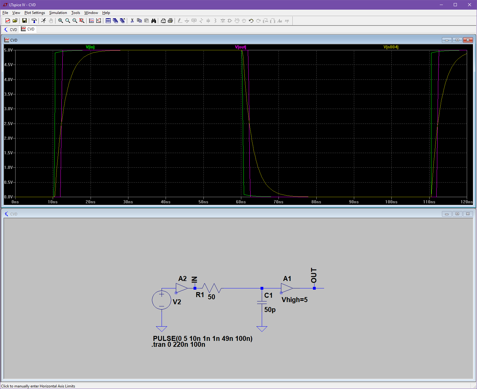

PostPosted: Sun Jun 17, 2018 10:36 pm
Posts: 660
A RC-network plus a buffer should work:
50 Ohm / 50 pF gives approx. 3ns delay:
500 Ohm / 50 pF yields 15ns:
In a real circuit this may vary due to the behaviour of the real buffer. Using a trimpot should work to adjust any desired value.

PostPosted: Mon Jun 18, 2018 3:43 am
I endorse the circuit BDD posted, as it's the same arrangement I often use myself. That's assuming the node marked PHI2 is the same node that attaches to the CPU clock input (PHI2, aka pin 37 on a 40-pin WDC 65C02). It should be just fine. I'm not aware of any reason a variable delay should be added, but I haven't been closely following this topic, and may've missing something.
By the way, BDD, I suspect you posted in a hurry, or failed to proofread. I think you know /RD and /WD both lag Ø2 by one gate delay. (It's RWB which incurs two gate delays to /WD -- and the extra delay is inconsequential, since it's PHI2 which will time both the falling and rising edge of the low pulses on /RD and /WD).
As can be seen, /WD will lag Ø2 by two gate delays, whereas /RD will lag Ø2 by one gate delay
PostPosted: Mon Jun 18, 2018 6:10 am
Posts: 8514
Correct assumption. Per WDC guidelines, all timing in my circuits are based solely upon the clock generated by the (earlier published) Ø2 generator. As the 65C816, has no clock outputs, that is the only way an '816 design can be clocked.
By the way, BDD, I suspect you posted in a hurry, or failed to proofread. I think you know /RD and /WD both lag Ø2 by one gate delay...
Yep! As vision in my left eye fades to unfocused blobs of light, I am finding myself making more errors of this type. I try to carefully proofread but seem to be missing a lot as of late. You can only imagine what fun it can be trying to debug a program that won't run due to nothing more than some errant typing. :evil:
PostPosted: Mon Jun 18, 2018 6:29 am
Posts: 8514
BillO wrote:
Actually, you have a 2 gate delay on start of the qualified write which I think is not as critical, but only a single delay at the end. Your write will end 6.6ns after Phi2 goes low. It's this back end that seems to cause the problems.
The two gate delay on /WD caused by the inversion of RWB should not be a significant timing factor, since during a write cycle, RWB will be driven low before Ø2 goes high. Practically speaking, the gating of /RD and /WD is slaved to the rise and fall of the clock.
I'm guessing that the combination of a W65C02 (or other ADC CPU) slower RAM will be a bit more tolerant.
The read-write timing for the 65C02 is actually more relaxed than for the 65C816, as the latter drives D0-D7 during both clock phases. My circuit keep peripheral silicon off the data bus during the low clock phase during a read cycle, since the '816 is emitting the bank bits during that time. Here the gate delay inherent to following the rise and fall of Ø2 eliminates (in theory) a potential bus contention issue that is peculiar to the '816 during read cycles.
IIRC, your RAM is running at ~60ns, right?
The RAM in POC V1.1 is 12ns. The RAM in POC V2 is 10ns.

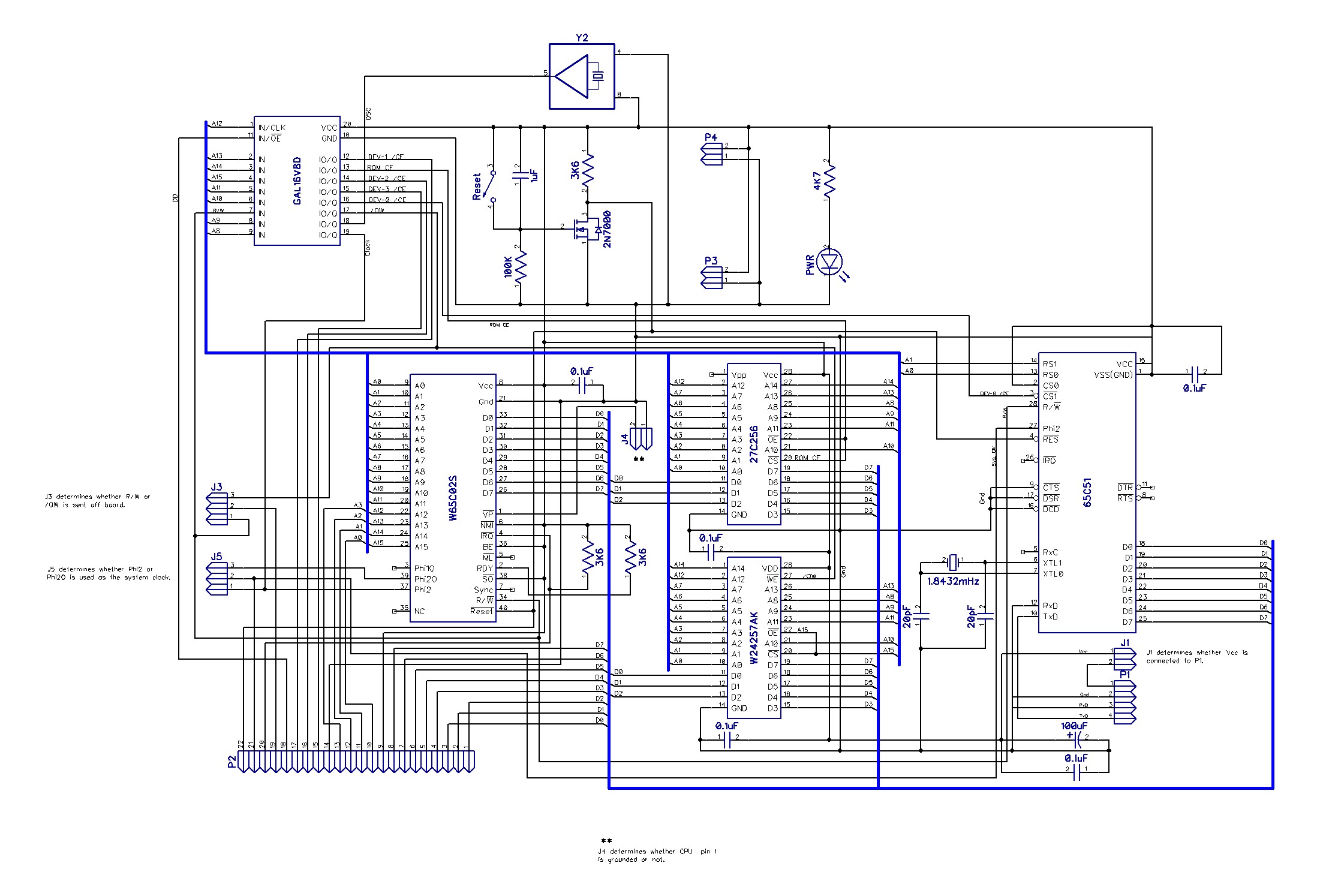

PostPosted: Mon Jun 18, 2018 5:01 pm
Posts: 1007
Here are my updated schematic and CUPL code.

PostPosted: Tue Jun 19, 2018 2:44 am
I think your trouble arises from a simple omission -- a design error. You just need to finish implementing the widely used circuit that BDD & I prefer. You've already got half of it -- the part that drives the RAM's /WE pin low only when Phi2 is high and RWB is low. You need to add the part that drives the /OE pin of both memories low only when Phi2 is high and RWB is high.
Presently, address line A15 is attached to /CE of the RAM (okay) and also attached to /OE of the RAM -- which is not really 100% OK, and here's why.
Imagine a write to RAM (ie: a write to an address below $8000). Near the start of the cycle, shortly after PHI2 goes low, a valid address appears. A15 will be low, and so too will be the RAM /CE and /OE. The RAM begins reading from the address. In fact, RAM is fully driving the data bus. Then eventually PHI2 goes high and...
  • the CPU commences to drive the data bus
  • an instant later, the GAL brings the RAM's /WE pin low, and RAM ceases to drive the data bus
It should be clear this is not an elegant situation. It's unrealistic to expect a clean handover of the bus. Instead, you face a short -- or not so short! -- period of bus contention before the RAM "lets go" and allows the CPU to be undisputed boss. This contention consumes a nasty jolt of current, thus transmitting noise on the Vcc and Gnd wiring.
A vintage CPU is likely to lessen the effect. :!: It will be slow to begin driving the data bus, thus allowing more time for RAM to let go. But a modern WDC CPU is quick to begin driving the data bus -- so quick that it grants less forgiveness to the design error. (Also, a modern CPU has more current capability on its data bus drivers, thus increasing the current which results from the contention.) I believe this explains why your project prefers older CPU's! :)
Edit: hm, I overlooked the fact that the ROM is presently allowed to drive the data bus during PHI2 low. That too could cause trouble, but it's my #2 suspicion, not #1. Luckily the same prescription treats both! Drive the /OE pin of both memories low only when Phi2 is high and RWB is high.
BTW, I don't find that the timing diagram in the data sheet (pg 6) implies that the rising edge of /CE can be coincidental with or lag /WE but not the other way around. I can kinda see how you might infer that. But it just seems wrong to me -- not how RAM's work. Plus, I think they'd be a lot fussier about specifying such an odd restriction (odd in the sense that it contradicts the Truth Table, which says /OE and /WE are don't-care anytime /CE is high).
