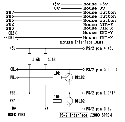

Something I've been toying with is using a 6522 for both a PS2 keyboard and a quadrature mouse.
There is a standard interface for a 3-button mouse for Acorn computers, and a common PS2 keyboard interface.
A mouse needs two interupts, two direction states and a number of button states.
A PS2 keyboard needs one interupt and three data lines.
With an Acorn-standard 3-button mouse you can fit the available data lines, but at least one of the mouse interupts would need to share with the PS2 interupt. I've sketched code that would be able to tell what the interupt source would be, but I'm not certain how to arrange things electrically.

I'm not sure how the mouse interrupt signals work there, are they just halves of the quadrature signal, so could idle in either the high or low state? It's difficult if that's the case, especially if they can idle low.
A couple of things might make that circuit more compact - firstly you don't really need PB4 and the transistor, you can use DDRB to swap PB3 between being an input and an output, to get the same effect. If its an input then it will get pulled high, and if you make it a low output then it will drive the line low. This is how I controlled the clock in my circuit.
Second, CB2 can be used as an output, so similarly you can simulate an open drain I/O line by toggling it between output-low and interrupt input, in the PCR. It may be better to use this for the keyboard clock rather than CB1, then you don't need PB1.
I guess you don't want to use the printer port where I think one of the CA1/CA2 lines is unused?
Another option for a falling-edge triggered interrupt is PB6, with T2 in pulse counting mode, and setting T2 to zero so you get an interrupt on the next pulse.
When using a VIA I always connect MOUSE-CLK to CA2 and MOUSE-DATA to PA6. The reason for this is the mouse needs you to send data back to it in a VERY specific way to initialize it. CA2 can be an output! Thankfully the keyboard doesn't need that to initialize, because CA1 cannot be an output.

PostPosted: Thu Nov 09, 2023 5:48 pm
Joined: Sun Feb 22, 2004 9:01 pm
Posts: 108
The two interupt lines interupt when a motion happens on that axis. The two data lines indicate which direction on that access the motion is, fed from the two quadrature disks. So, eg:
CB1 interupt, moving left/right, read PB0=0 moving leftwards, PB1=1 moving rightwards.
CB2 interupt, movng up/down, read PB2=0 moving downwards, PB1=1 moving upwards.
see eg Mouse.src
CA1 is PrinterACK, and CA2 is PrinterStrobe. And that would need two plugs on the lead. ;)

In that case I think PB6 may indeed be your best option for an additional interrupt trigger, leaving CB1 and CB2 free for the mouse. I had a play with it just now on a BBC Micro, with the PS/2 clock line connected to PB6 and PS/2 data connected to PB7 - it works fairly well but the OS interrupt latency causes a lot of problems. As Chad cautioned, the window for reading the bit after the clock goes low is rather small - maybe 50us - and if the OS is servicing some other interrupt (e.g. keypresses) then my handler doesn't get called quickly enough to reliably capture the bit from the keyboard. The only way I could really get it to read data reliably from the keyboard was using an interrupt to start the operation, but then blocking in the interrupt handler to read the later bits. So then we block for about a millisecond on every keypress... and twice on every key released... not very good! And I still get some errors, probably due to the OS being mid-interrupt when the key is pressed, meaning we miss the start bit.
