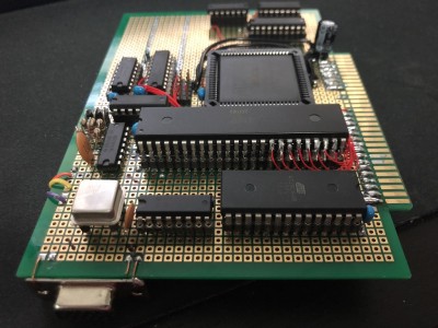

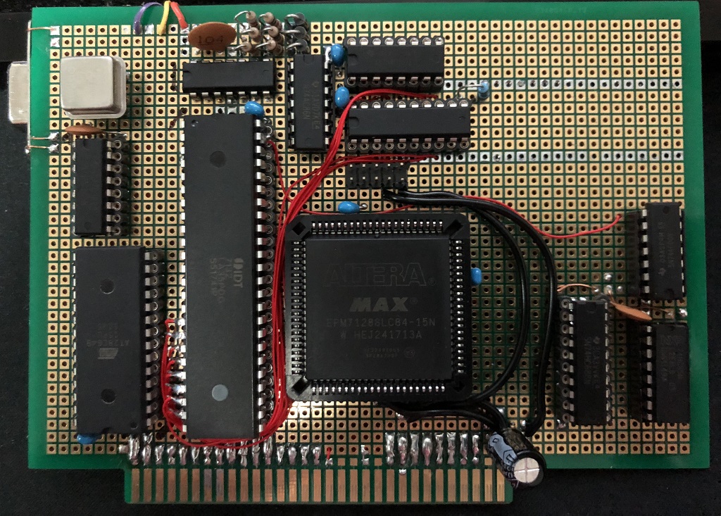

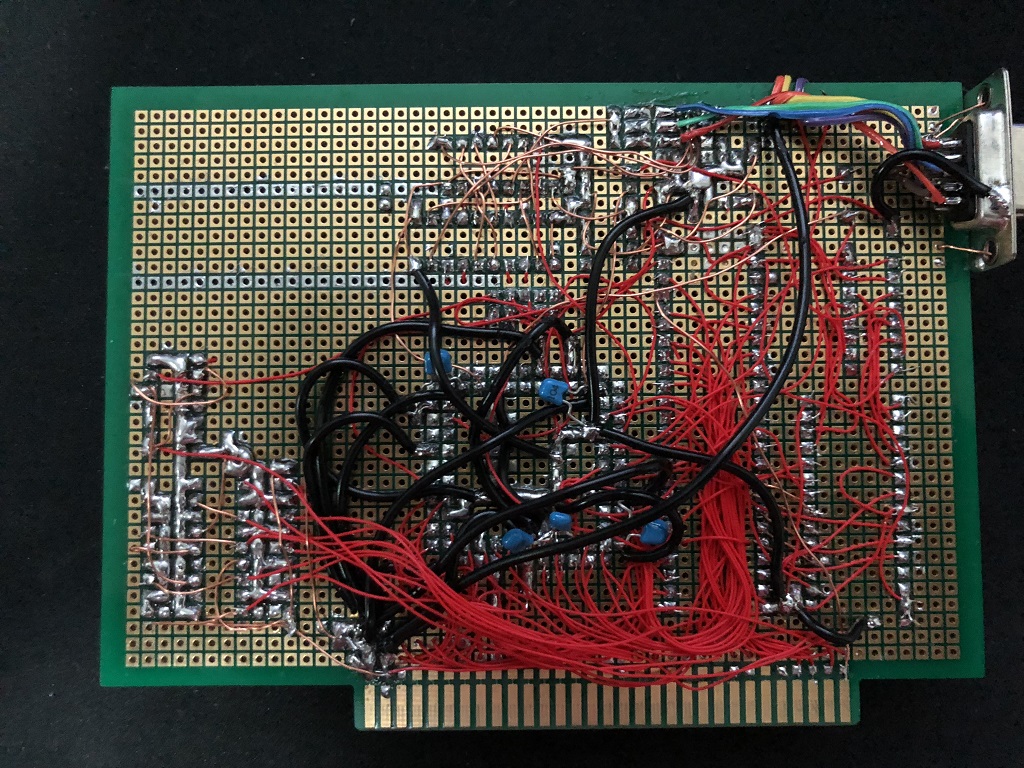

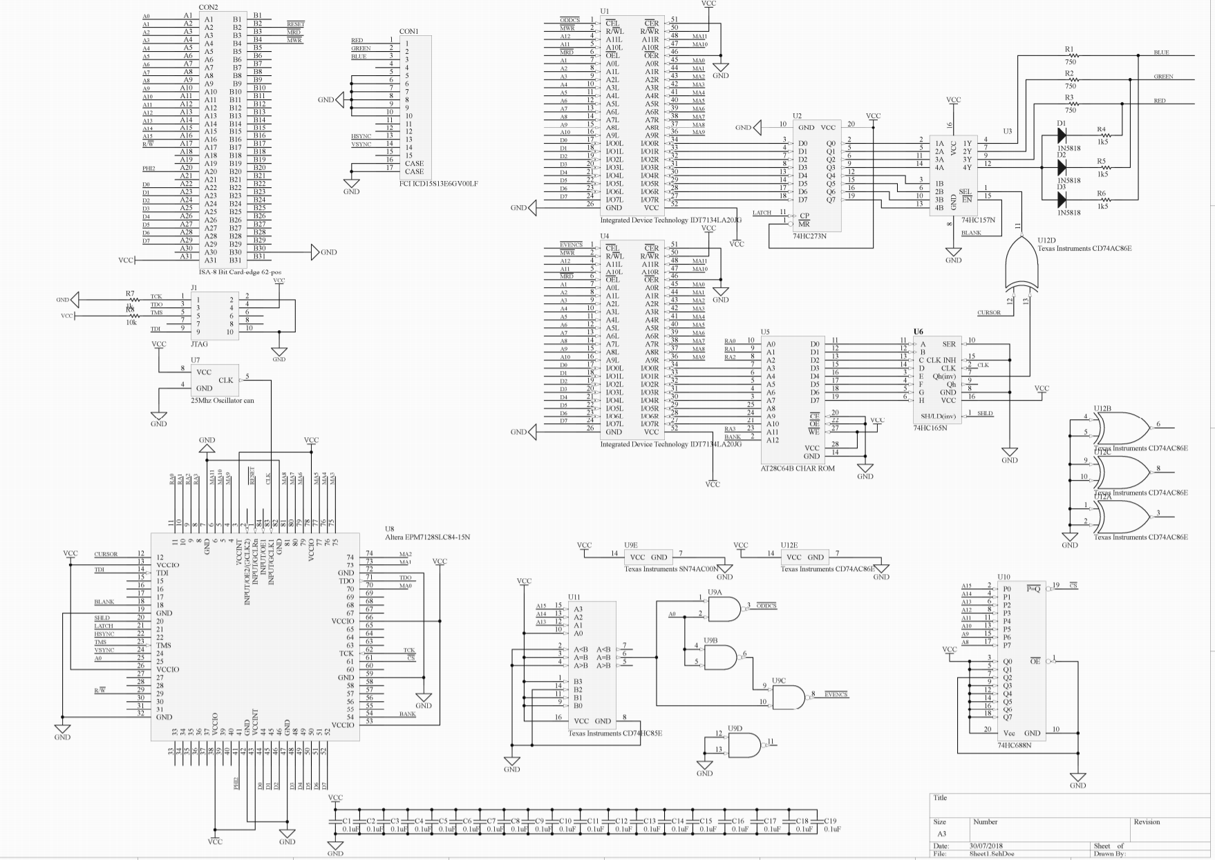

PostPosted: Mon Jul 30, 2018 10:05 am
Posts: 172
Location: Sweden
Just thought I'd update this since I've made more progress recently.
I should note that I did try various different things to handle porches differently etc but it never made a difference to the macrocell usage etc, I ended up just moving up to a 128 macrocell CPLD which meant I could add a hardware cursor and hardware scroll
The schematics and some photos are attached. the prototype card is a disgusting monstrosity and it took me a full day to solder everything but amazingly it works!
Characters are stored on even addresses, color is stored in odd addresses
The prototype card has IDT7132's instead of 7134s which means it can only do 25 rows as it's a little short on ram. You can see they're stacked here to save me some effort & space.
I've already created a proper PCB for this, when I have the money I'll order it
Here's the current VHDL: https://gist.github.com/LIV2/eac150ffd1 ... 1c12e5c9e4

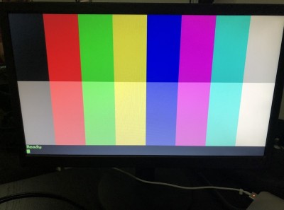

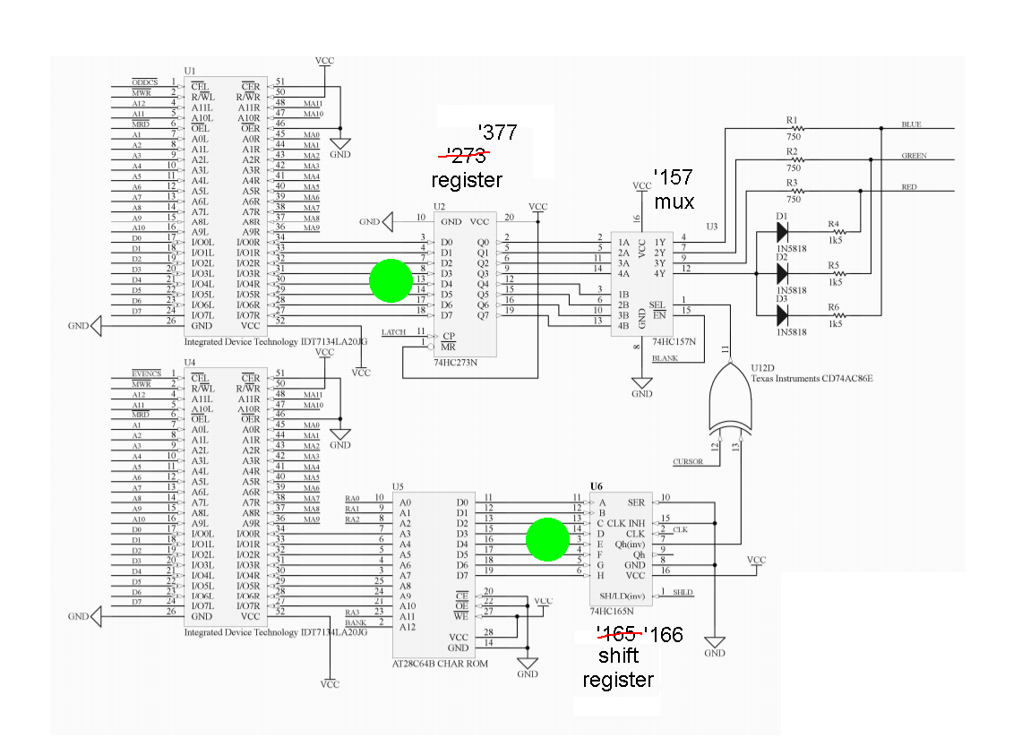

Still struggling to get timing just right with this
Since the ROM access time is so slow, this leads each character being displayed 1 character time late which is fine & accounted for in the CPLD
The colour ram is not that slow though so if I load the colour latch at the same time as the shift register this results in the wrong colour being displayed for each colour
I've been stupidly dealing with this by using a 74AC latch with the latch signal generated on the rising edge of the character clock so it's loaded just before MA increments and the RAM has time to output the next byte which looked fine due to the adjustment of my monitor.
After playing with it for a bit I hit the auto adjust button on my monitor and discovered that it had a visible effect of the very edge of the characters to take on the colour of the next character...
I've added another latch now so that the colour data is simply delayed by one character so it matches properly but I now noticed that depending on the adjustment of the monitor you can see a column of pixels in the foreground colour that shouldn't be there between characters; once the auto adjust is complete though it disappears.
Clearly there's some weird timing going on still which is extremely frustrating and demotivating. I would be tempted to think VGA is too much to push through discrete logic but that can't be the case when we have members on this board pushing 640x480 colour graphics.
I'm tempted to replace the discrete logic with another smaller CPLD (I've just about filled the EPM7128) but that idea feels like admitting defeat.
PostPosted: Thu Aug 16, 2018 5:59 am
Cool project! And I guess it's the '273 register which you added to do the delay and make things match, as you say. Generally you have one character whose color and pixel data have been loaded in the '273 and the shift register, and you have another character whose color and pixel data is waiting to go in the '273 and the shift register. So, you've set up the pipeline appropriately. The green dots (below) indicate the character that's waiting (its color data and pixel data).
When the pipeline advances you'll want the '273 and the shift register to load simultaneously, and I assume that's what you're doing (I admit I haven't read all the preceding posts). And, after the two registers load, the shift register does a series of shifts (I assume it's 7 shifts, making the character 8 pixels wide). So, the pattern for the shift reg is load shift shift shift shift shift shift shift [and so on]. But here's the thing. For a good looking display you need the timing of those eight events to be entirely regular... which is almost impossible with a '165 shift register but quite easy with a '166 shift register. That's because the load input on a '165 takes effect immediately, and thus the timing of the load signal is critical. But on a '166 the load input doesn't take effect immediately -- it simply alters the function of the next clock edge (when it arrives) from shift to load. Thus on a '166 shift timing and load timing are one and the same. The load is synchronous.
Having swapped the '165 for a '166, you may find it convenient to also swap the '273 for a '377. With such an arrangement both chips' clock inputs can be driven by the 8x clock (the pixel clock, at 8 times the character rate). Also, once per character when the pipeline is about to advance, a brief (ie, one pixel time) active-low pulse is applied to both the load input of the '166 and the enable input of the '377. Thus the '377 does a "load idle idle idle (etc)" pattern while the '166 is doing its "load shift shift shift (etc)" pattern, and the two chips are operating from identical signals.
Finally, because of delays resulting from the XOR and the mux you may find it beneficial to insert a register between the output of the '157 mux and the resistors etc of the output circuit. That register, too, would be clocked by the pixel clock. I hope the explanations are clear, or at least not too bad. Sorry to recommend so many changes but I think the payoff will be a great looking display.

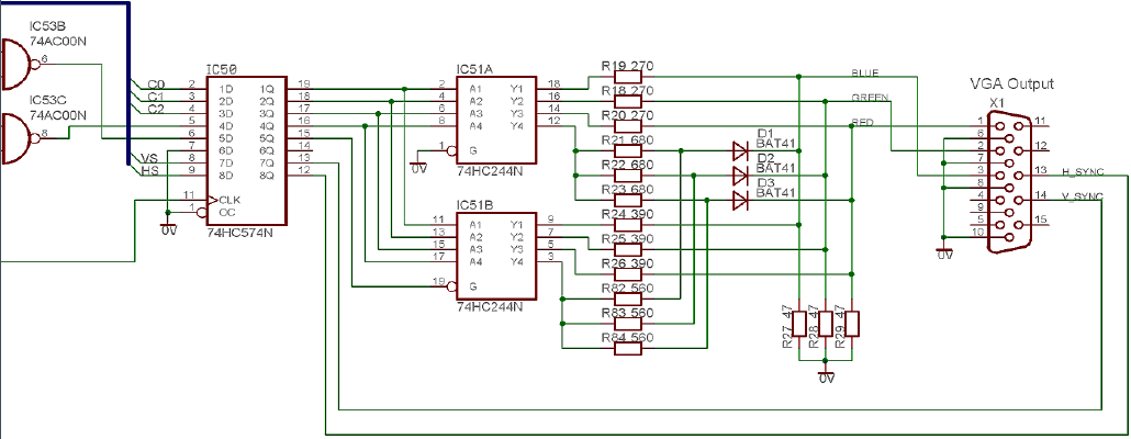

PostPosted: Thu Aug 16, 2018 6:29 am
Posts: 1429
Thanks Jeff, you already got the problems covered. :)
That 74157 multiplexer controlled by the 7486 XOR gate gives us some propagation delay,
and I think this won't look good in the RGB output signal.
I'm also suggesting to insert a 74574 latch or such (clocked with the dot clock) at the 74157 outputs.
If the outputs of the latch won't give you enough current, add a buffer too.
Dennis Kuschel did a TTL based VGA graphic unit some time ago, and the circuitry at the RGB output had looked like this:
PostPosted: Fri Aug 17, 2018 6:15 am
Posts: 172
Location: Sweden
Wow thanks!
That makes perfect sense, without synchronous registers & synchronous load the shift register and the latch will never meet up correctly
I've ordered a couple of '377s,'166's and a couple of '574s though they're going to take a while to get here.

I hope when you ordered the parts you included some fast logic such as 74AC or 74AHC for the signal paths that are critical. The path that has the most to accomplish between pixel-clocks is the path through that XOR gate. Ideally the '166, the XOR, the '157 and the new output reg should all be fast parts, but you can maybe relax that requirement, depending on the pixel-clock frequency.
BTW, a '163 counter can be used as a 4-bit synchronous-load register if you simply let the load function override the count function. Using a '163 as the new output reg might save some space for you, as it's only a 16-pin device. The '173 is another 16-pin option.
Edit: OTOH, if you use an 8-bit reg you can use one of the extra sections to condition the other input of the XOR gate, which might be important.

The '157 and '86 at least are already AC, I just neglected to update the schematic on that so by the looks of it.
I was silly enough to order HC versions of the '377, '166 and '574, looking now I can't find anything in DIP except for the 574 but I can probably stick some SOICs upside down on the protoboard and solder wires to it. Thanks for the tip re: synch counters as a latch I'll use it!
In the meantime I've tested the theory by replacing all the external logic with another CPLD and it looks perfect (but it's a bit of a waste of a CPLD!) so I can't wait to get the new ICs

PostPosted: Sat Aug 18, 2018 9:54 am
It does save some space. But are you sure you don't need some extra flipflop sections (as you'd get with a 20-pin device such as '574)? Just checking -- I haven't carefully examined what you're doing. I already mentioned in the edit added to my last post that the signal called Cursor (which drives pin 12 of the XOR) had better be run through a flipflop. But maybe you've managed the same thing using a flipflop inside the CPLD. If so, that flipflop should ideally use the pixel clock (but only enabled 1 out of 8 times, like what the '377 is doing).
Looking again, I notice the same concern applies re the signal called Blank, too (which drives pin 15 of the '157).

Ahh yep sorry I missed that, CURSOR isn't running through a flip-flop inside the cpld, BLANK (aka viden) is described as follows
VID_ENABLE:
process(clk,V_BLANK,H_BLANK)
begin
    if falling_edge(clk) then
        if (V_BLANK NOR H_BLANK) then
            viden <= '0';
        else
            viden <= '1';
        end if;
    end if;
end process;
Which I know understand isn't suitable, this needs to be latched at the same time the shift register and colour latch do. same with the cursor
I could do that in the CPLD but the timing would be slightly different to the output '547 so I may as well pass them through the same latch as the video output.
