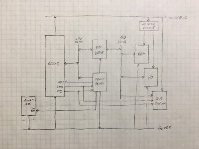

When designing mine, I disconnected the uP when the front panel is activated. In fact my main intent was to be able to load memory without a processor.
I thought about having a separate processor just for the front panel, which would have met my design criteria, but I chose to drive the buses directly from the switches (via transceivers) anyway. The obvious downside is that every time "Deposit" is pressed, the address switches all have to be correct. This makes data entry three times as tedious as the normal tedium.

So, the more I dig into the processor as counter concept, the more complex it becomes. It can't really be made modular, because you have to split the data bus with a bidirectional transceiver and gate it correctly. You have to count cycles from the last sync so you can gate the correct things to the processor. You have to store a number of predefined bytes to gate onto the data bus. You can select increment/decrement by replacing the NOP with a BRA $01 or BRA $FF, and you have the logic to do multiple bytes for the JMP case, but past a certain point you want to put all these bytes into a PROM and address them. At that point, why bother with the switches?
Maybe this trick works better with the 8080, but I'm not going to investigate further. I was hoping to be able to stop the processor, do stuff, and continue at a particular point in memory, but maybe that's not really necessary. I can set the reset vector to whatever I want, so that's probably a better way to go for controlling execution. Now I need to look at 74HC up/down counters...

If I were doing this, the motivation for a toggle-switch bootstrap would be to toggle in a more user-friendly bootstrap, which would allow for general peek and poke and maybe checksums. So the idea would be to make the hardware minimal with the understanding that it's used rarely - preferably only at power-on. If you have some RAM which you can write-protect that makes it safer - if you can add a battery backup then the bootstrap could stay in place for weeks or months.
Steve Furber of Acorn (and later ARM) fame did something like this: the lights-and-switches interface was used only to load a slightly more convenient program. Once you've loaded a program which supports LEDs and a keypad, or a serial interface, or indeed if you've loaded the program and then written it to non-volatile storage, you don't need to use it again.

So, I've done some sketching using the reset/BE and external counter concept, and it really doesn't do what I want. For boot loading it's clearly the superior solution, but I'm more interested in controlling the µP and being able to single step through small programs. Deadstart loading is necessary, but not sufficient. Therefore, I'm going back to the Altair concept for the front panel. It isn't practical, but it's great for demos and I'm interested in the design problem. Studying the 8800's schematic shows that it's less extra circuitry for the Altair because it already has bus drivers everywhere, making the bus easy to gate. A 65C02 doesn't use external buffers, so I'll have to add what I need to get that functionality. Sadly, BE doesn't help me, because I need to isolate the data bus but leave the address bus intact.

Done traveling for the holidays, and still thinking about the front panel design. Here's a block diagram of how I think it will go at this point. I want to keep the clock local on the processor board, so the front panel will inhibit the processor clock and generate its own clock pulses for its actions. (probably at a kHz rate instead of MHz.)
